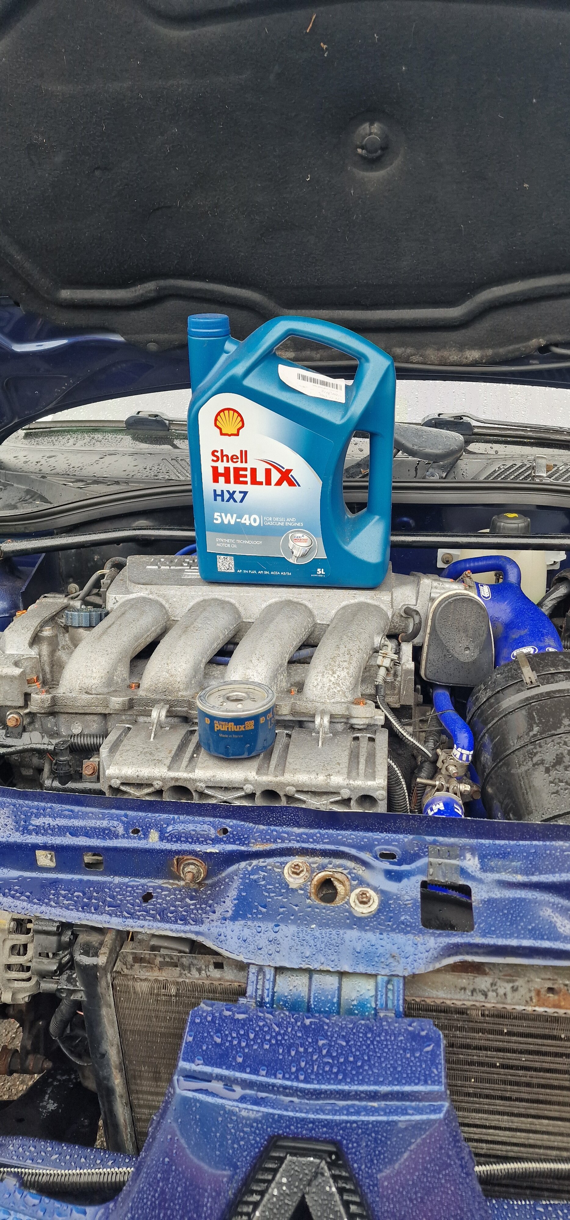

I started out running the car in gear, making sure it goes through them all. Everything went fine and dandy. I remembered to drop the passenger window this time too🤪
But my brain got the better of me after running the car up. Since it was already warm I decided to change the oil and filter

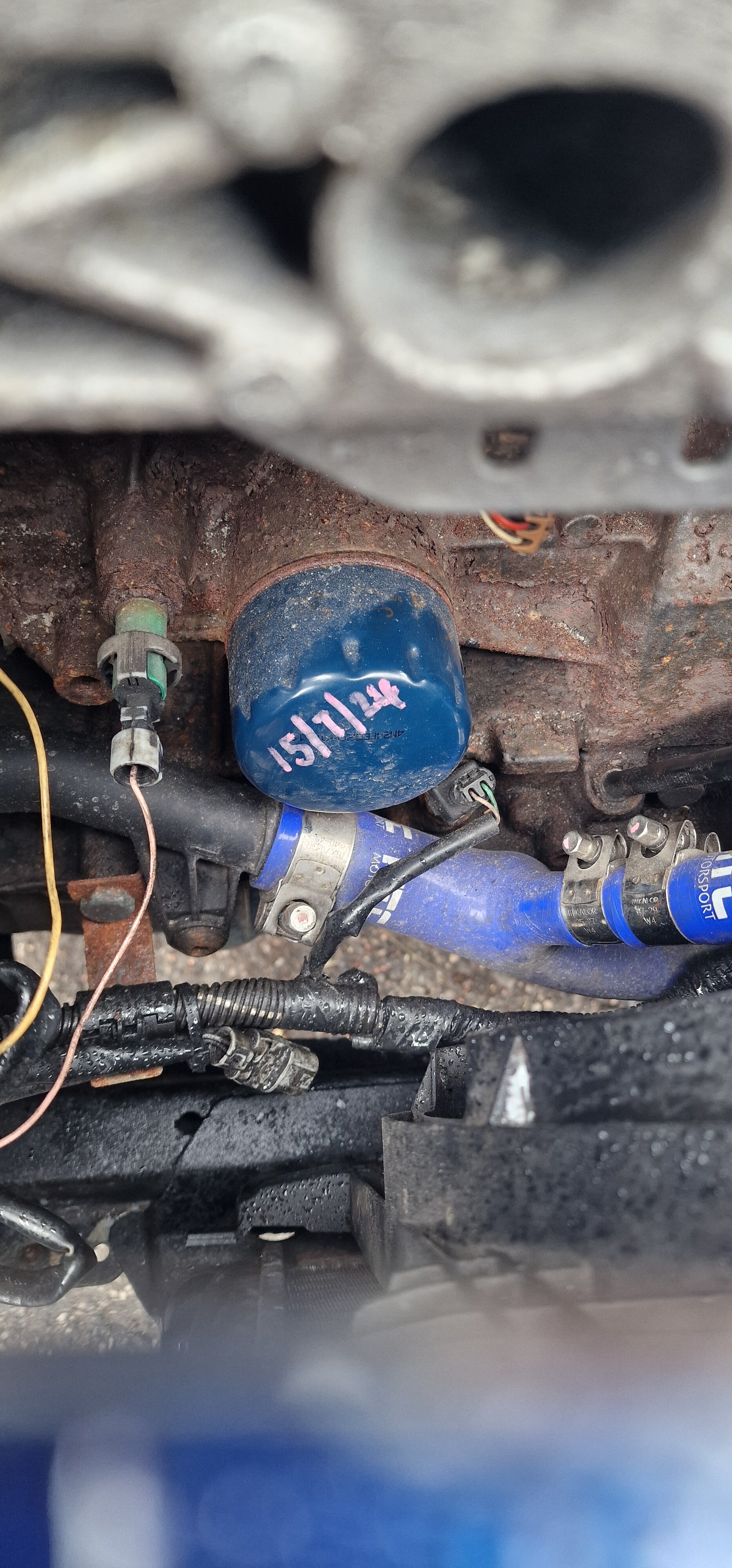

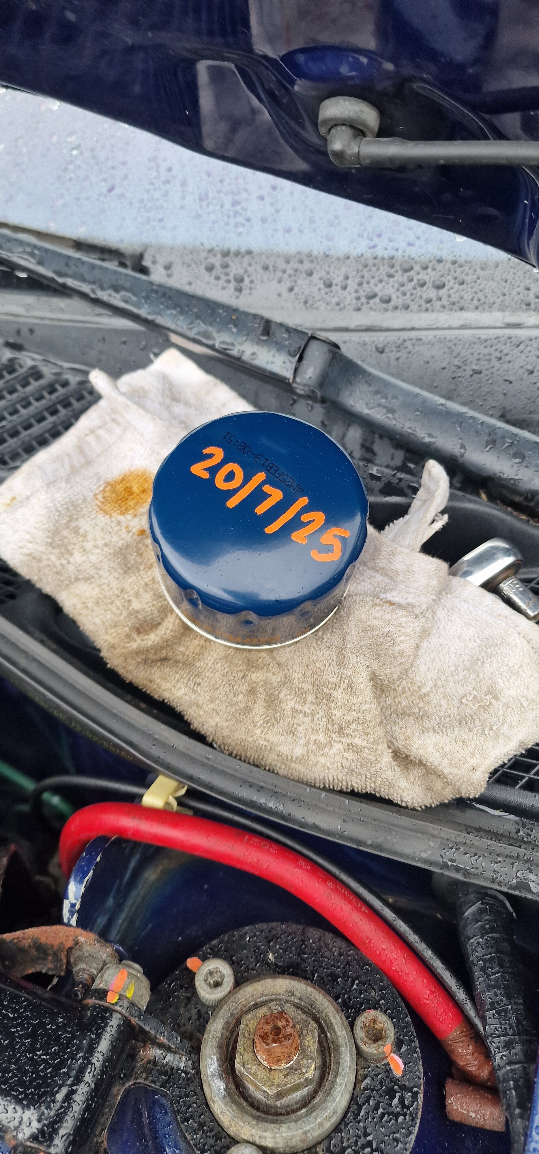

New oil and Purflux filter
Been 1 year since the last service
Marked the filter up

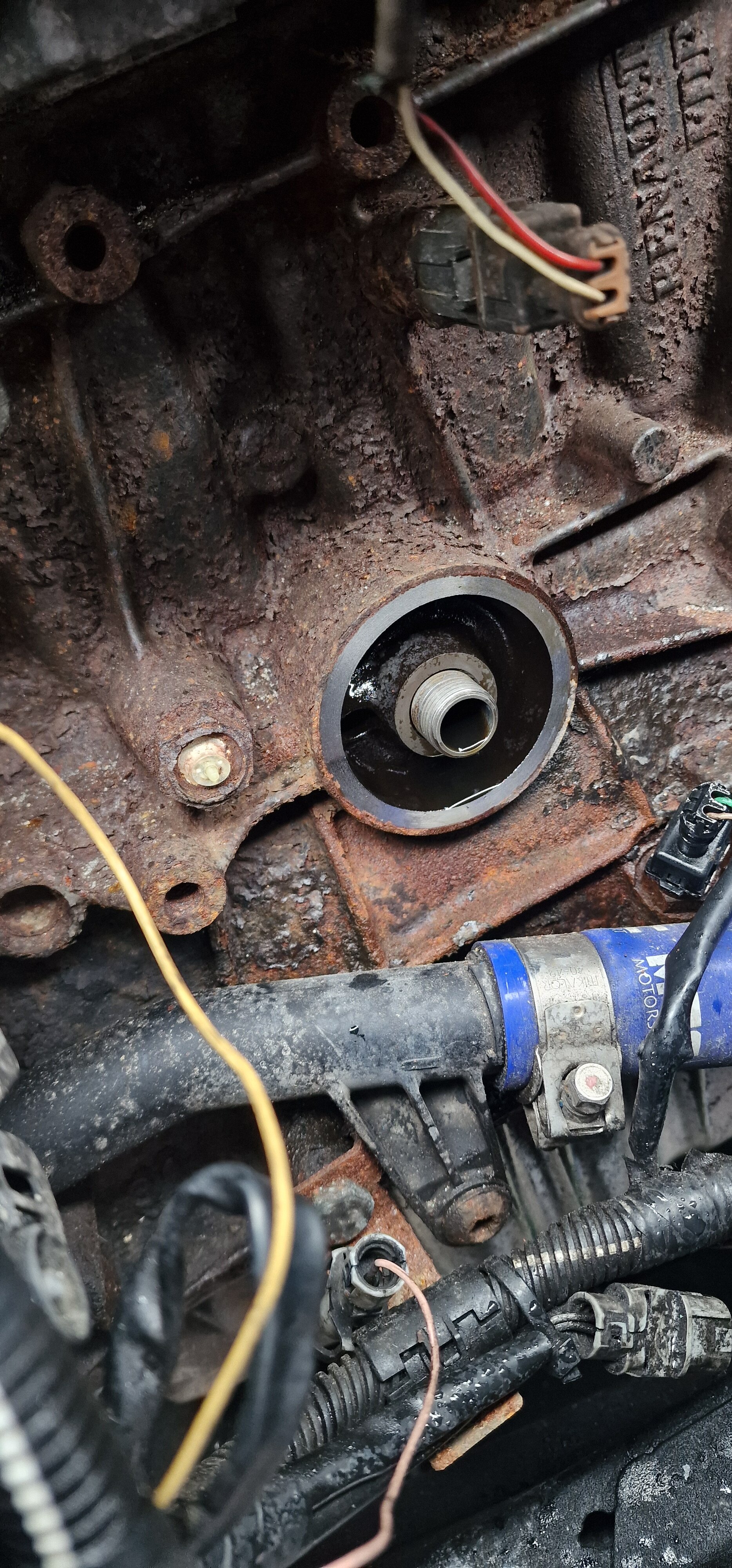

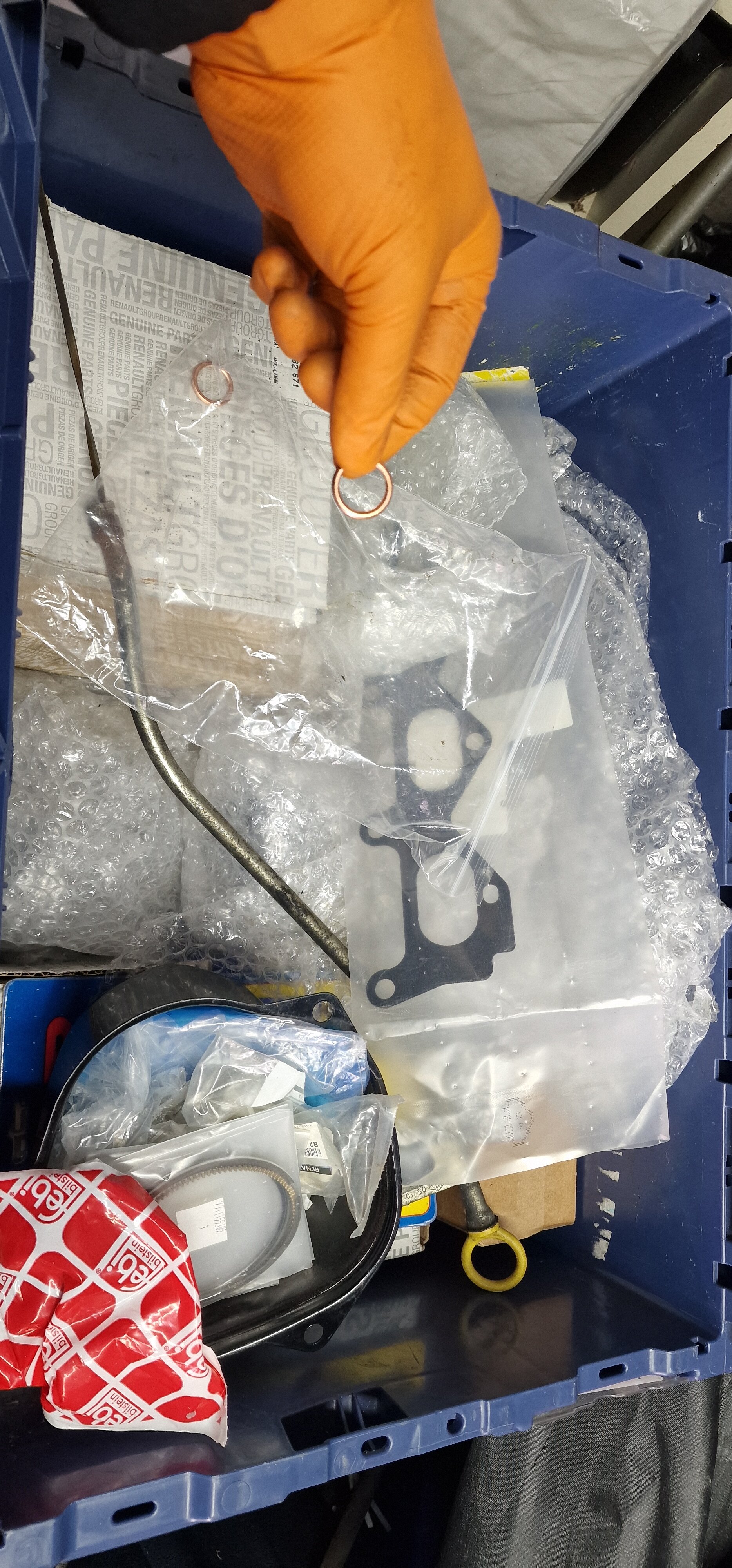

At this point the oil was flowing out and I had no issues. I couldn't find any dowty washers in my filter box... s**t
I was in luck that I hoard everything. I had 2 copper washers in my engine build box... You know, that engine I've been saying I'll build for the last 3 years🙃
Copper washer found I was back on track. It's a good job I had them too because the copper washer assortment pack only went up to M14, looks like I'll be buying in some M16 ones

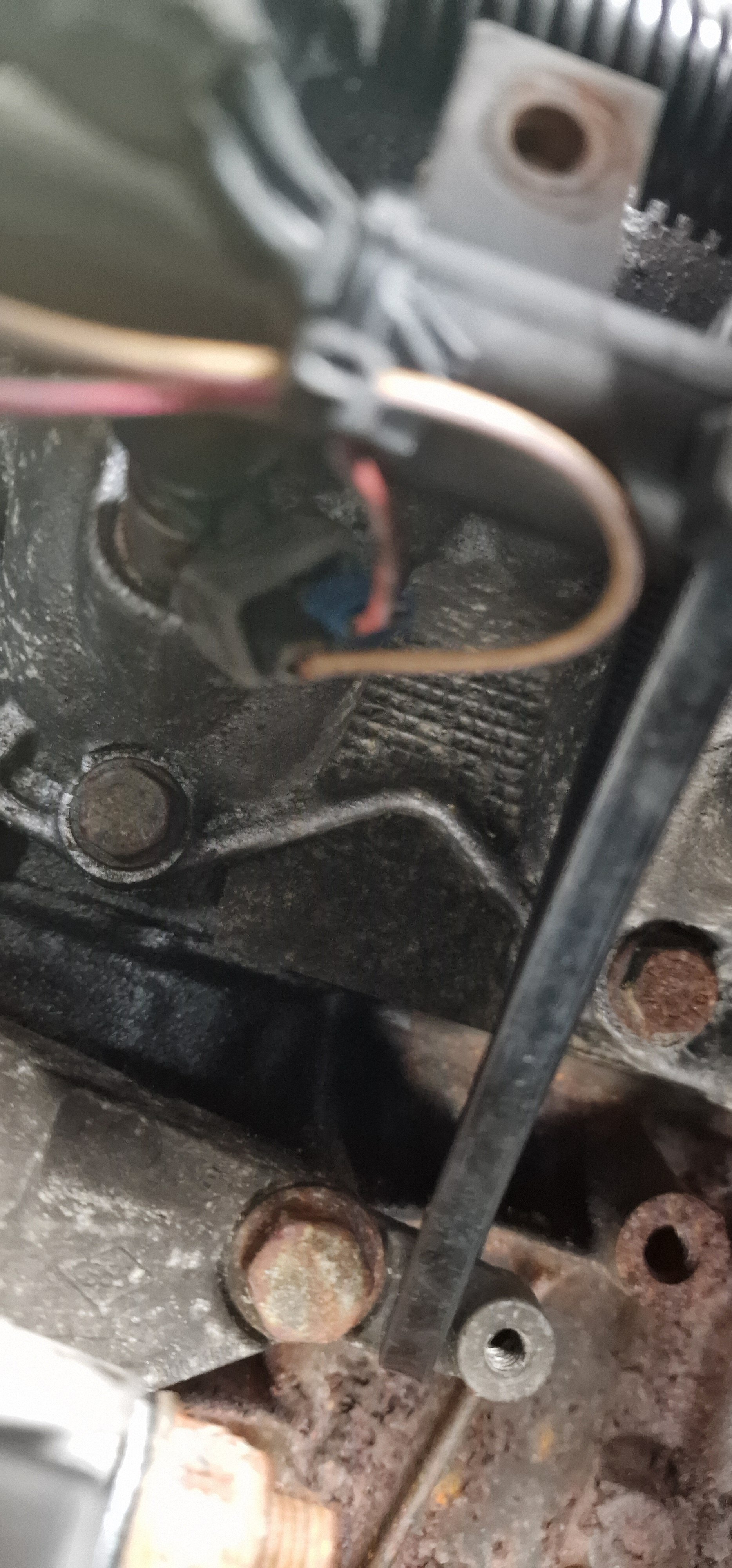

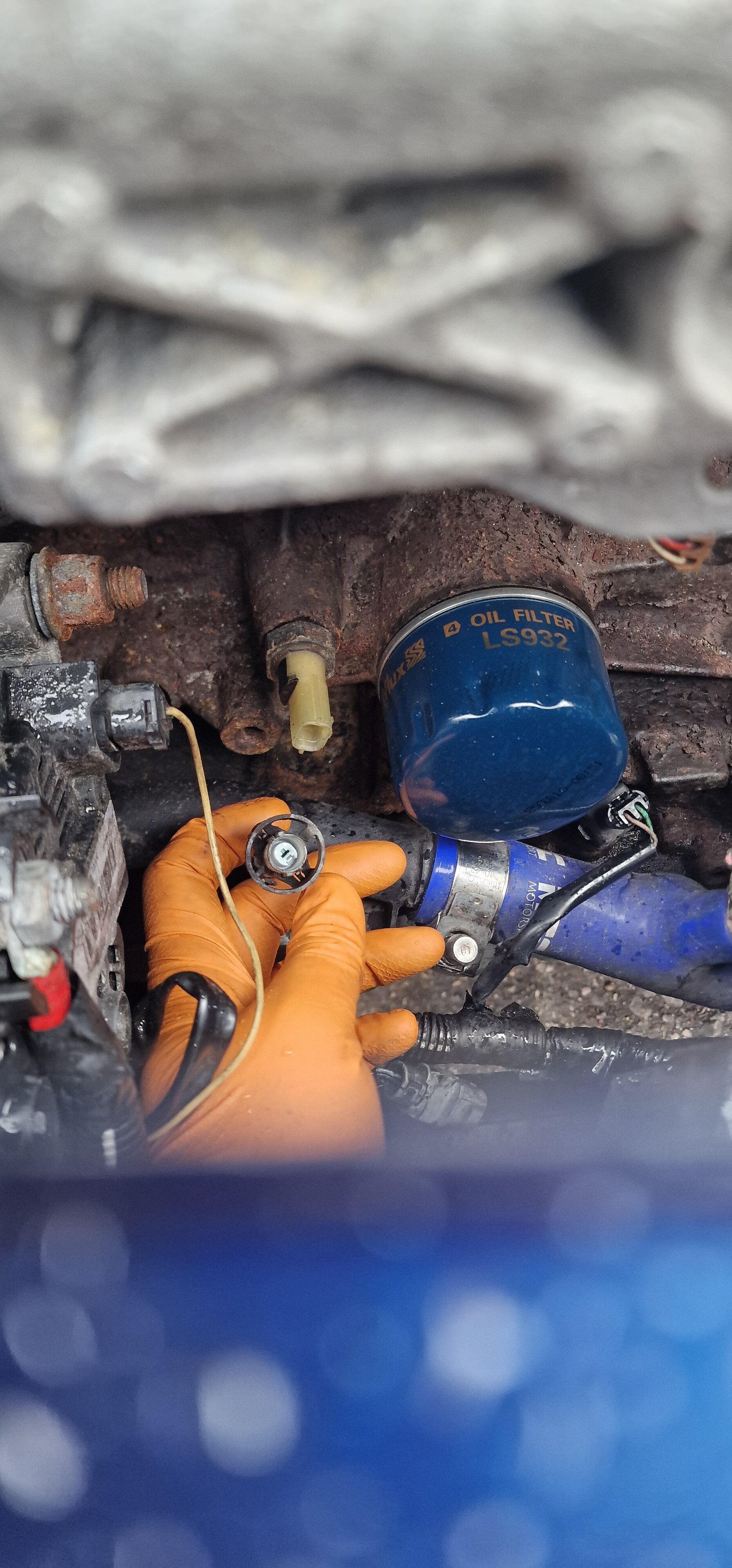

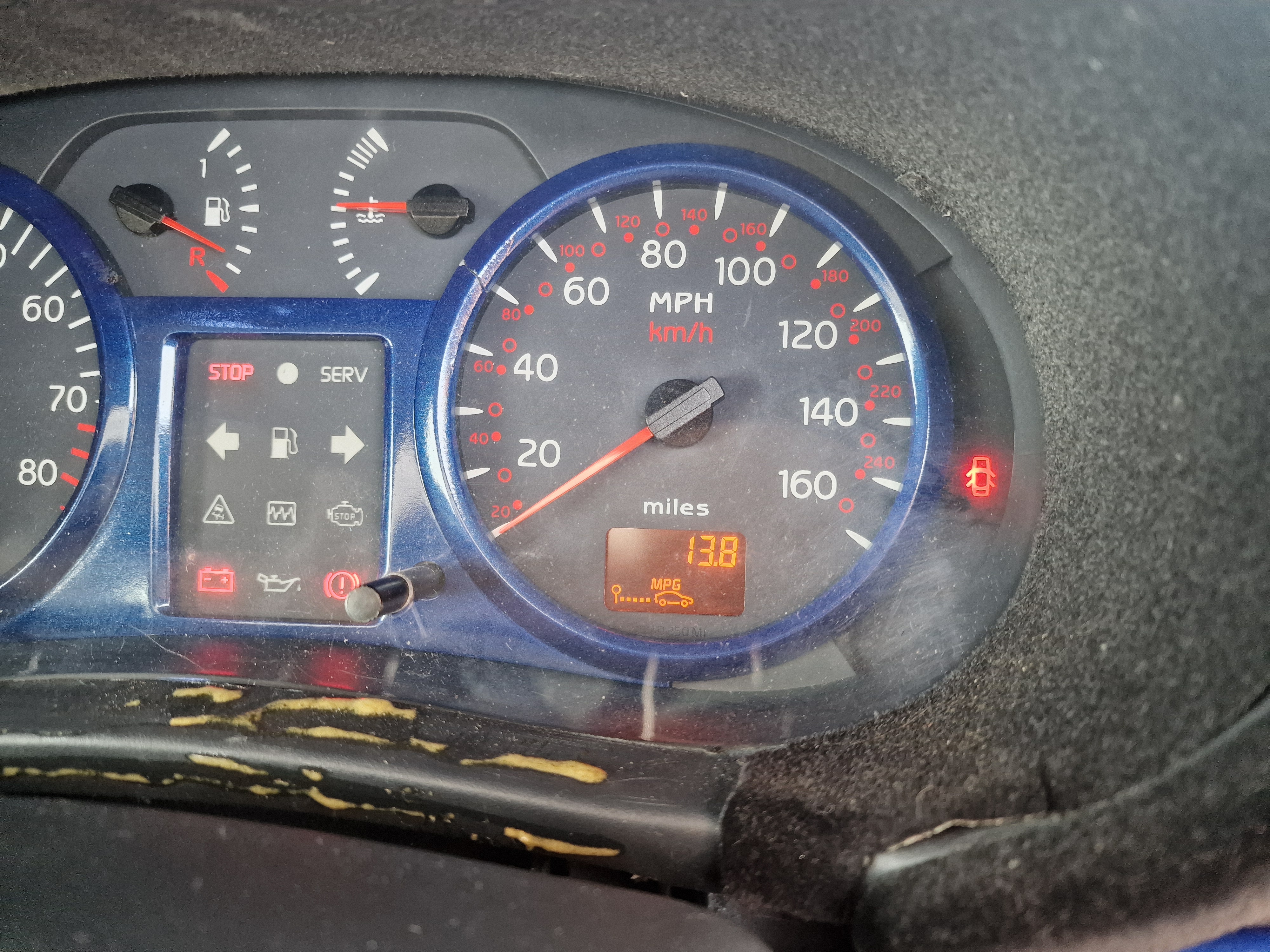

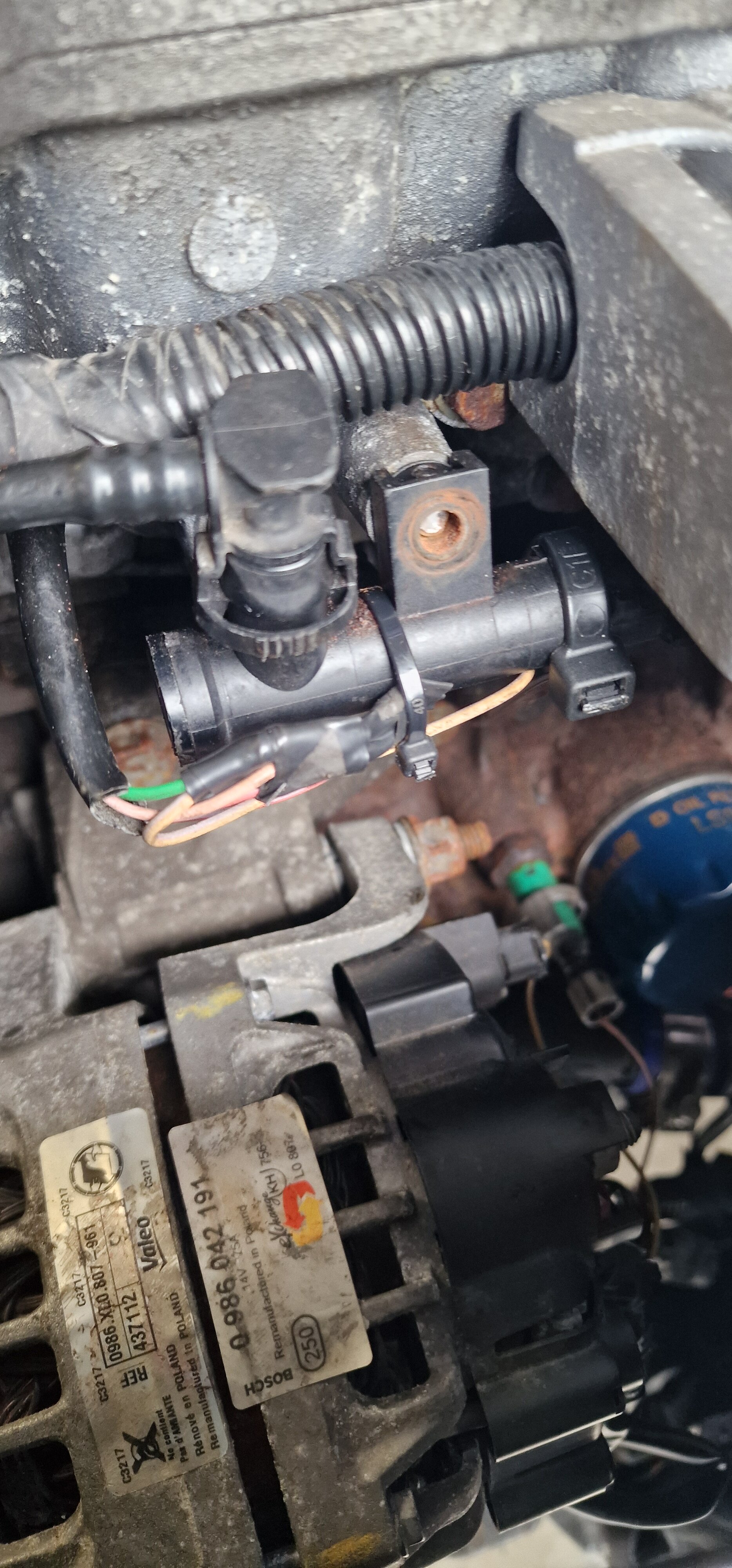

Oil filter off, this was a doddle. But then as soon as I went to remove my oil filter pliers I knocked them into the the oil pressure sensor and it gave up. You can see just how crusty the 23 year old sensor is
Not to bother. I had a Clio 200 engine in the back of the garage so I pilfered the sensor out of the bag of parts
Except that didn't go too well since Renault decided to change the connector from the F4R736 to the F4R830. t***s
Gonna get a sensor from one of the engines at work tomorrow. If not they're only £7 so it's not the end of the world. The eagle eyed viewer at home will notice the date mark isn't on the filter, it smudged so I wiped it off and rewrote it whilst the filter was on the car.

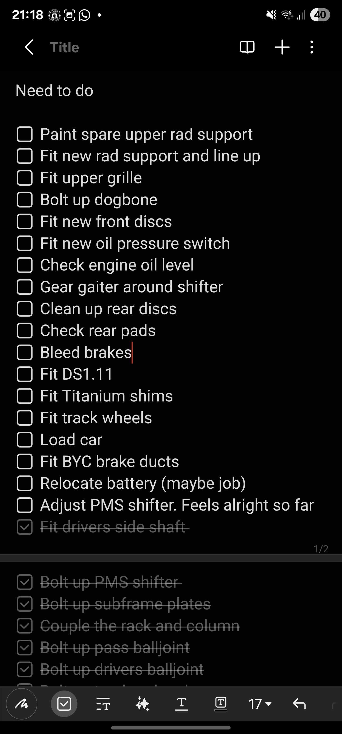

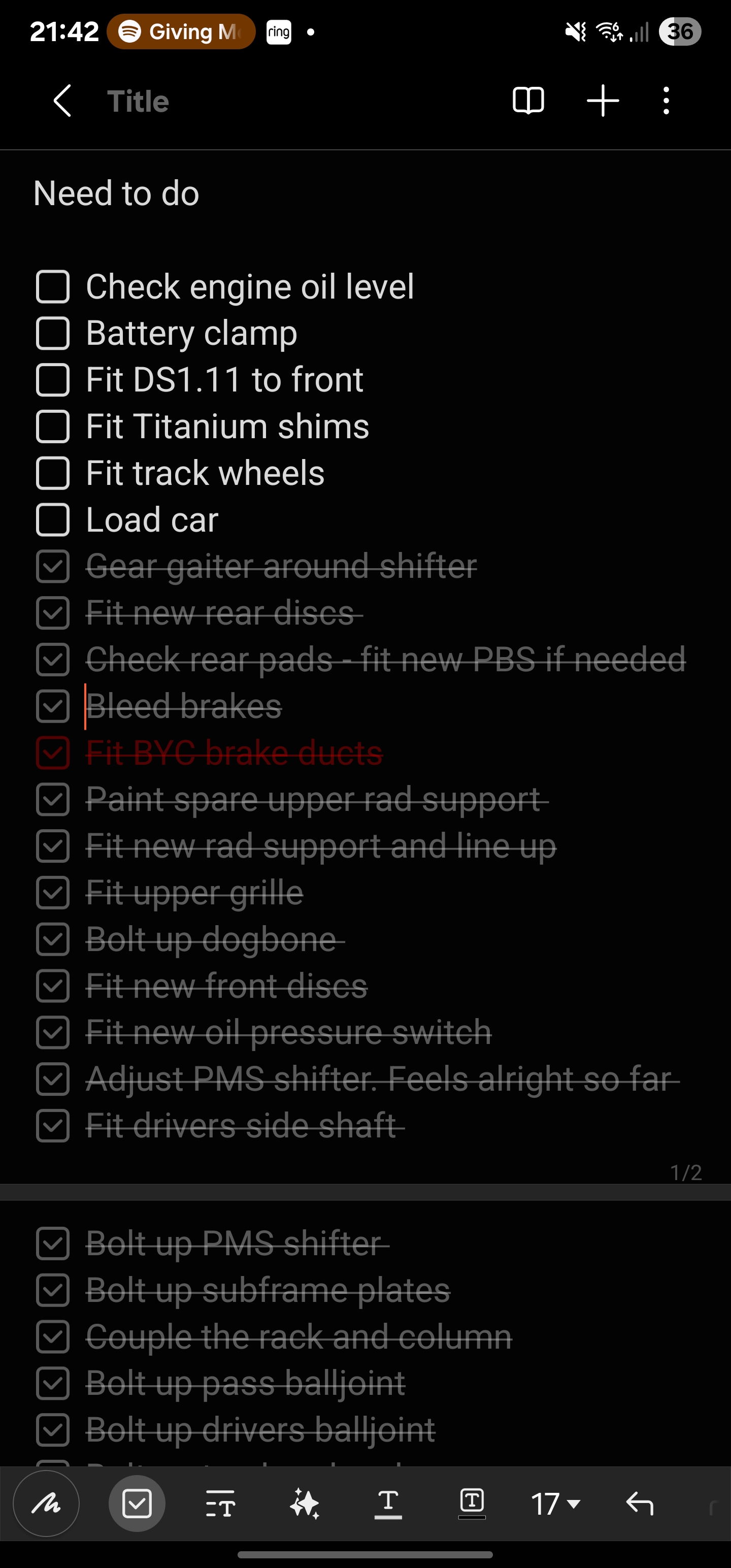

I've re-written my list now so I've got some stuff to work on. Now we're getting to the finer details

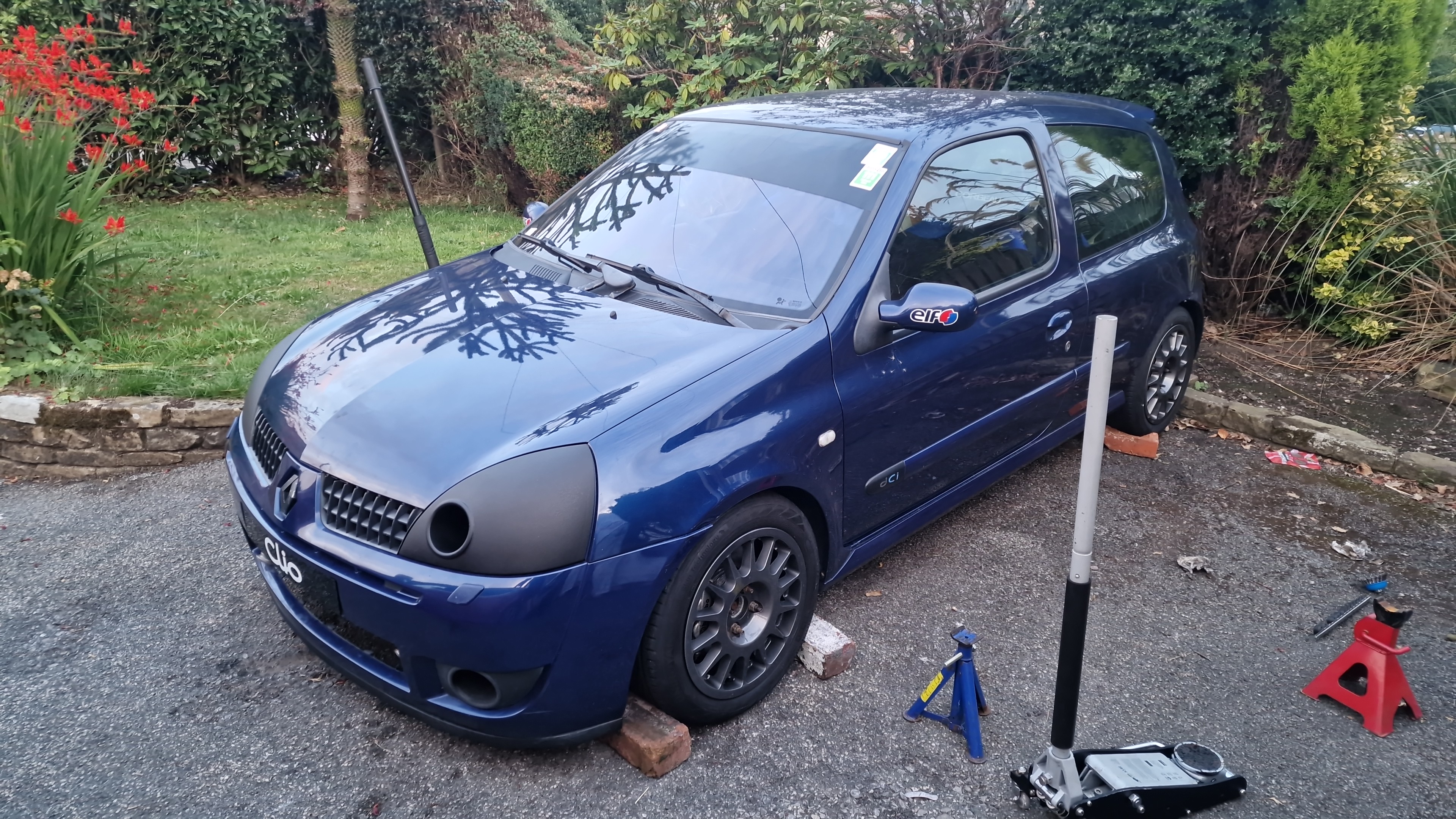

Last night @Louis came over to give me a hand and to bring me some parts
Before he turned up I got the oil pressure switch swapped out. Managed to steal one from one of the engines I have at work
After that we were off to a flyer as you can see... Got the upper rad support bolted in, it fitted perfectly

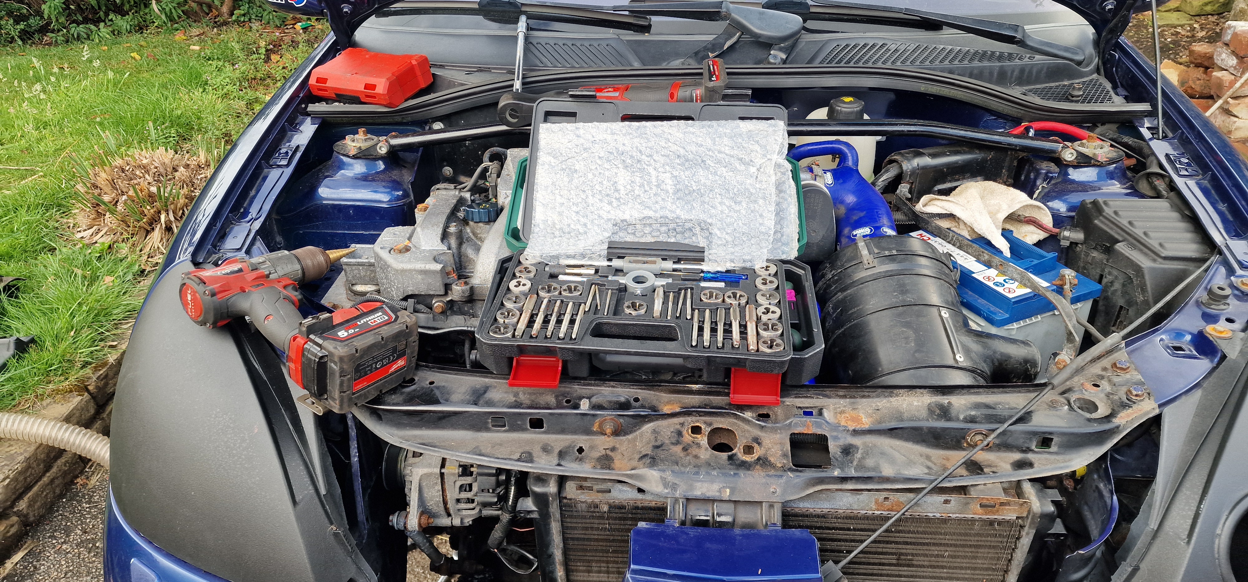

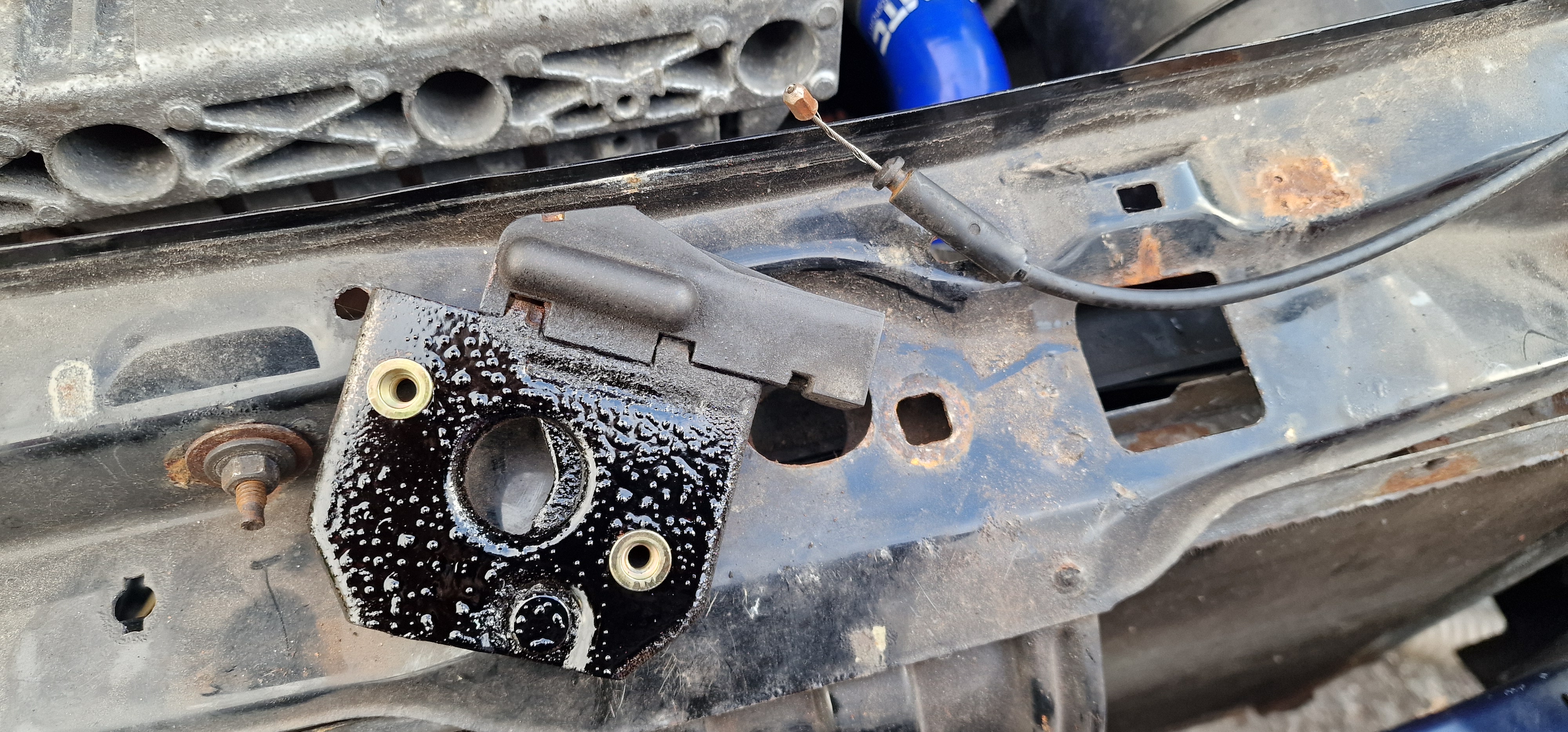

One of the bonnet latch bolts went from slightly tight, to slightly loose, to 'get the tap and die set out chief'
The metal is piss thin so I opted just to drill through and send a pair of M6 rivnuts into it instead

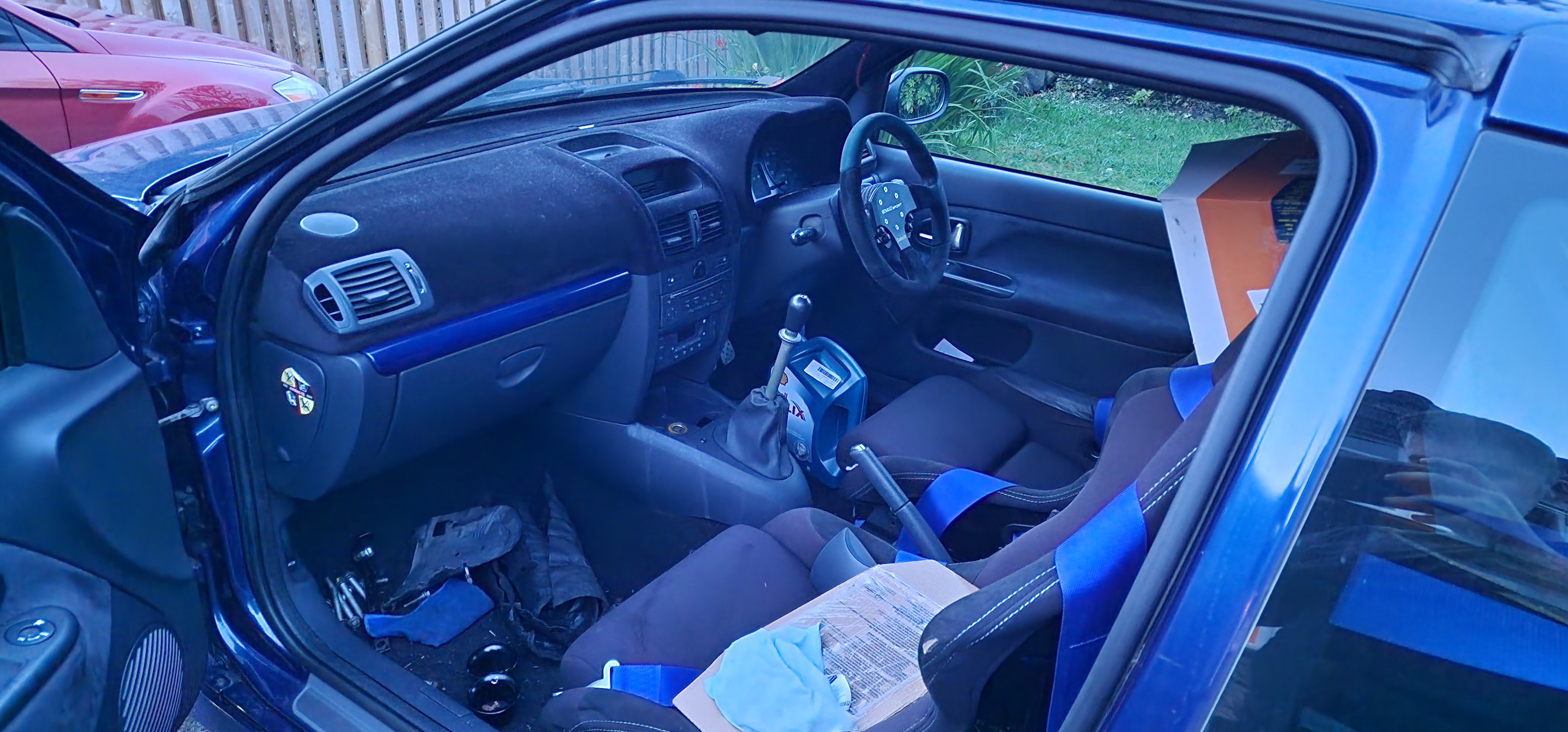

Whilst I was f**king about sorting that balls up Louis had got the new to me EVOL dogbone mount in, the gearbox drip tray, cleaned up the spare discs he brought over, fitted those and started fitting the BYC Brembo ducts
It was at this point I asked him to try the shifter and see if it felt right. It was a bit s**t to go into reverse, which meant the PMS shifter magician had to get his cloak on and we he set about adjusting it. Took us about 15 mins to get it spot on
It actually looks like a car again now, the bonnet shuts too (doesn't line up though🥴)

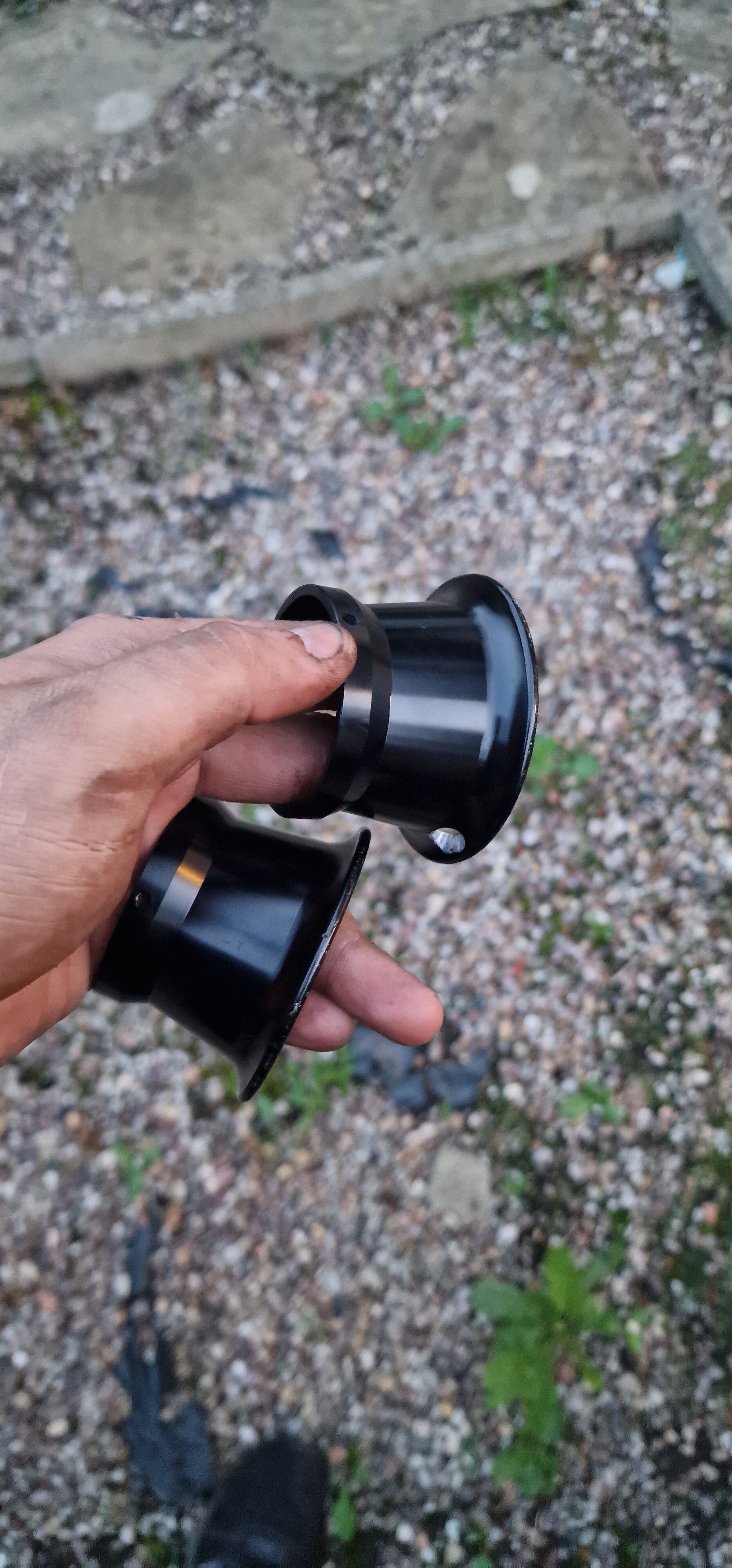

Tonight I'll be tackling the jobs in red. I ordered some 50mm bass ports for the BYC ducting. The Ali ones that came with them look a bit naff
Speedo Gonzales
Started the evening by removing the bottom grille

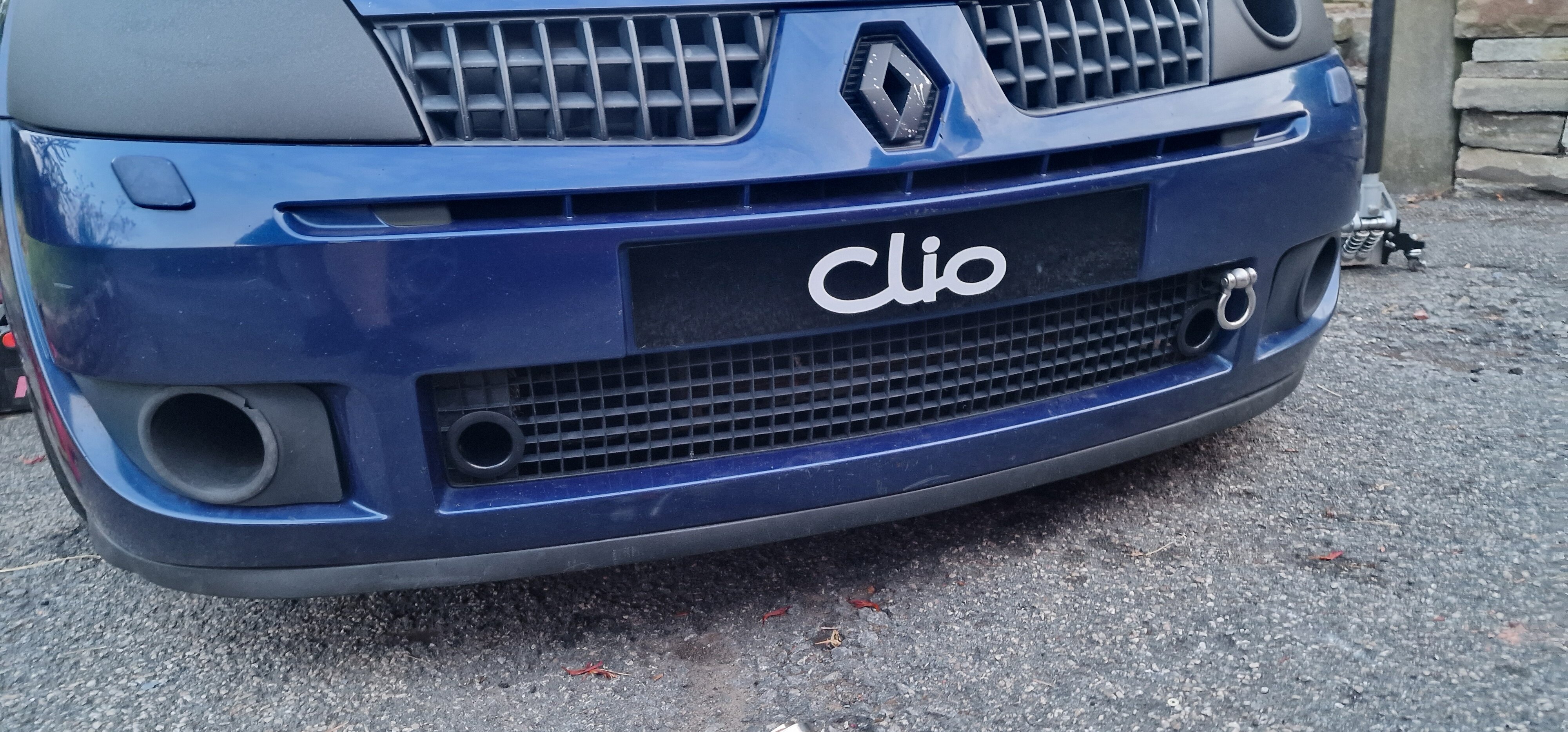

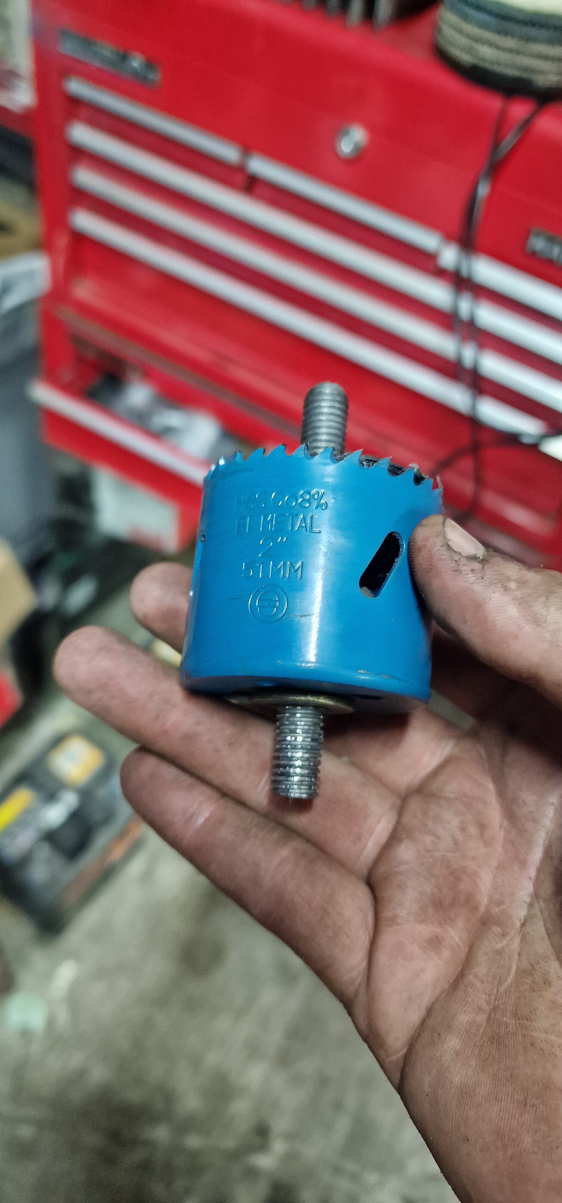

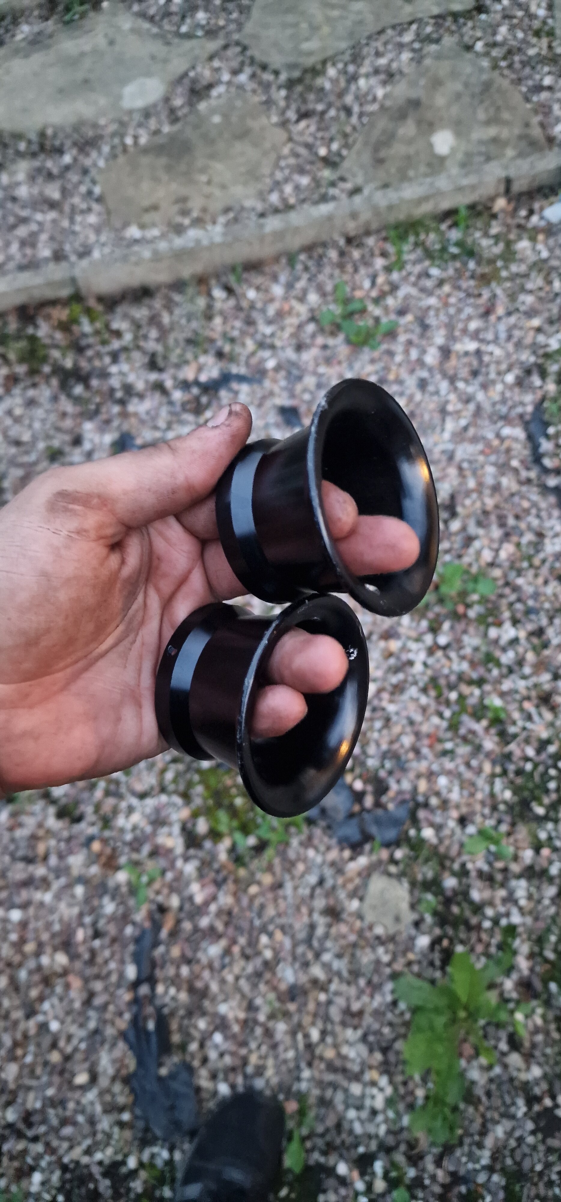

My hole saw arbour was MIA. So had to improvise and make my own arbour for the drill. The 13mm nut centres on the bolt. Precision engineering
I bought some different bass ports on Amazon last night too. These ones that came with the BYC ducts were shite
Marked out the grille, drilled 2 holes and popped the bass ports in, slapped some mastic on the back of them to keep them in position.
Got the grille fitted back up and it looks decent

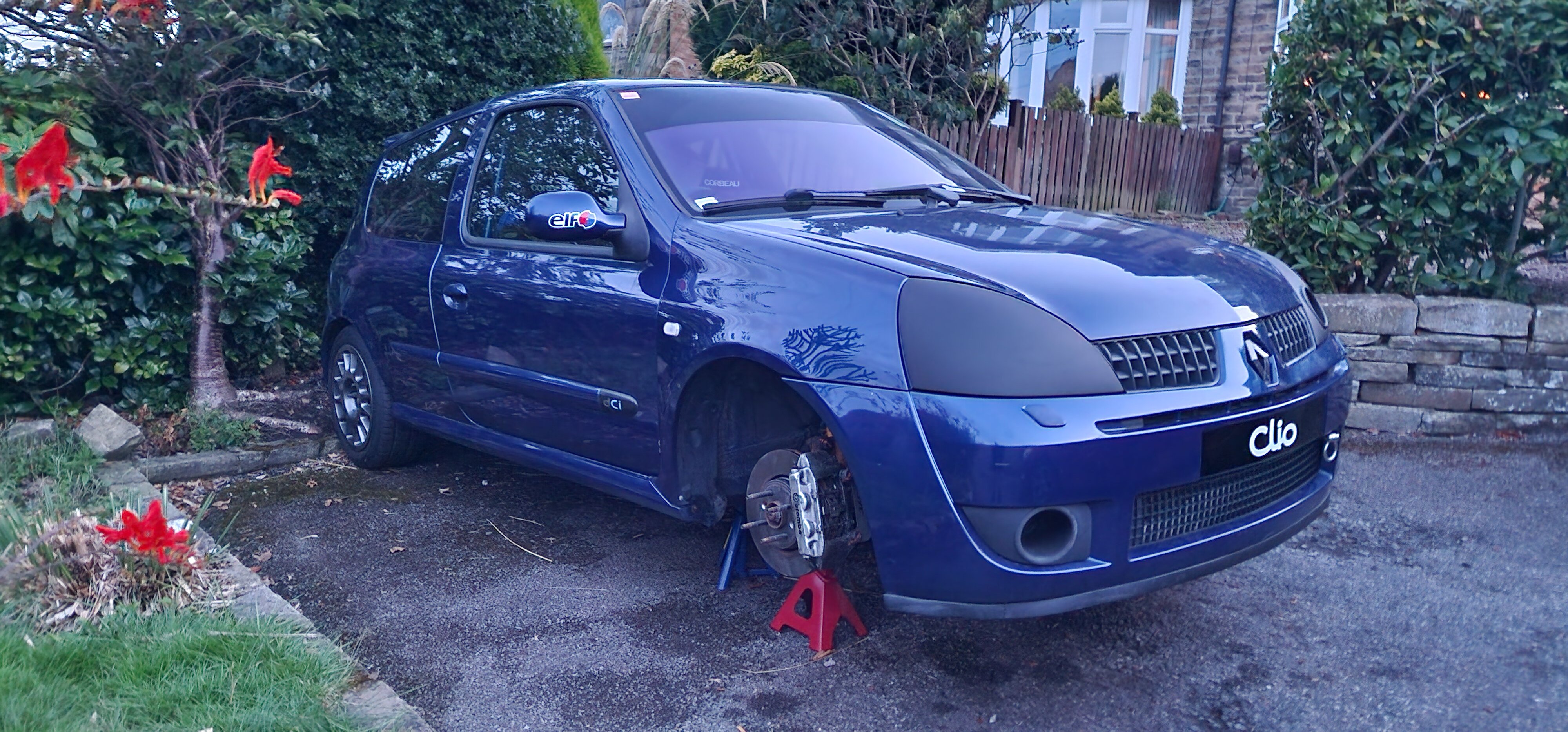

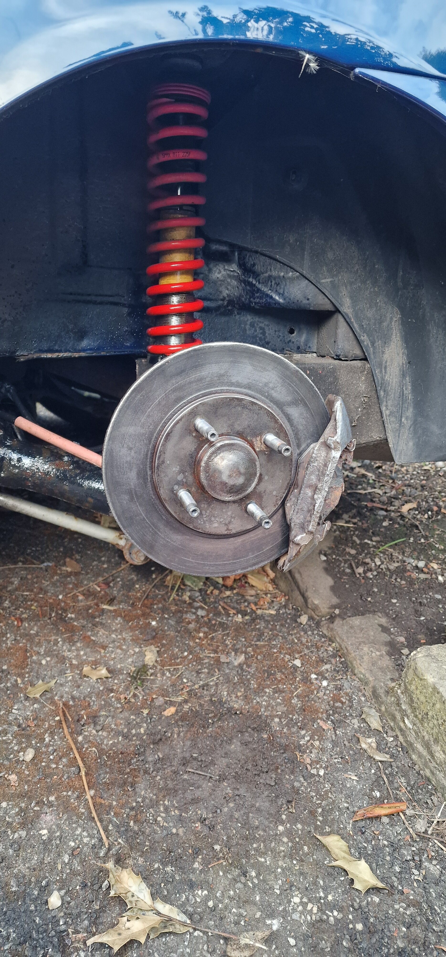

Moved onto cleaning up the rear brakes. I got a set of discs from @SharpyClio just incase mine were too far gone from being sat. Thankfully, all the corrosion cleaned off and they came up decent, even just using a wire cup on the grinder. I'll keep the others as spares
Finally. The car is back down on all 4 wheels
Moved it from that position and I can already tell the gripper is mega even from just moving it with the wheels turned🤣

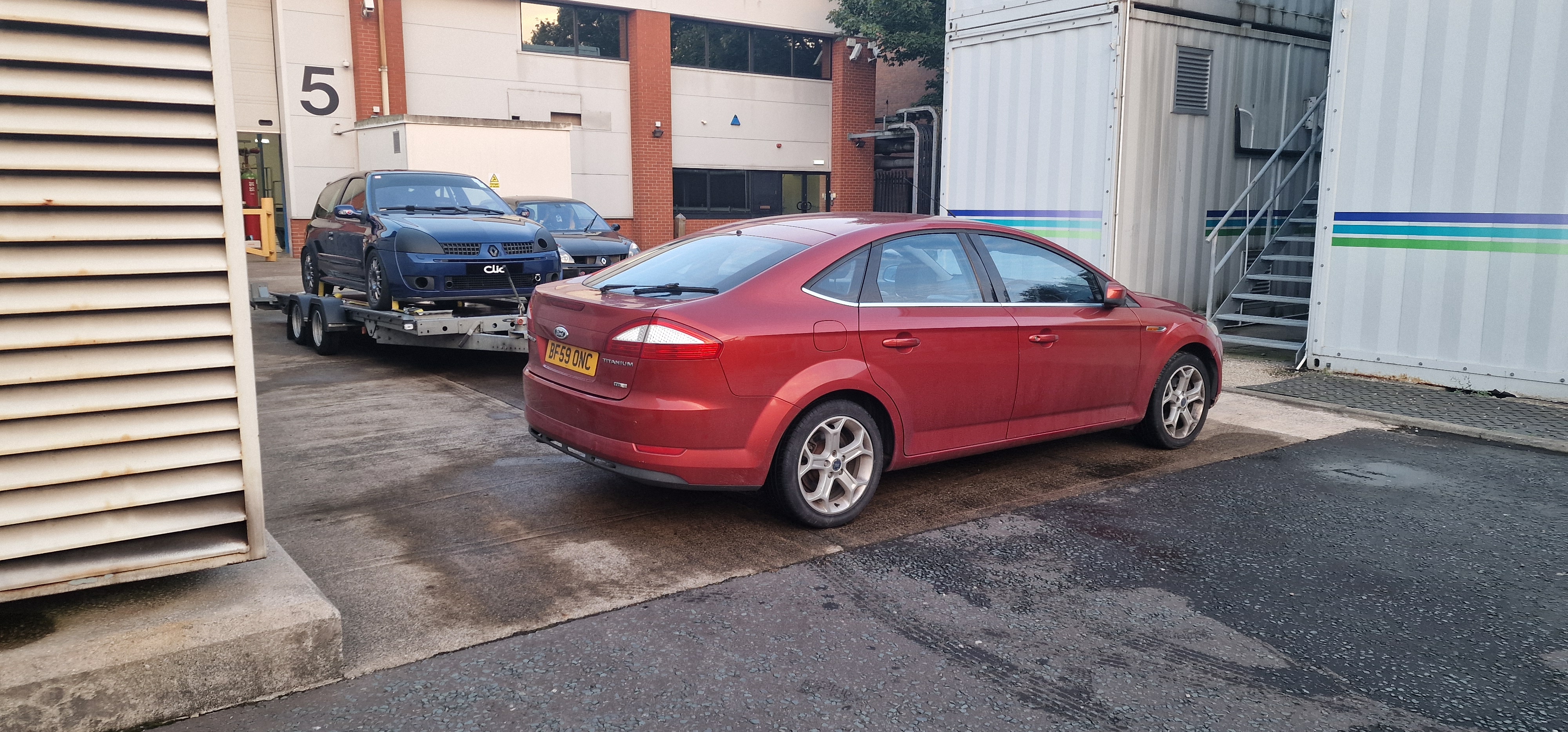

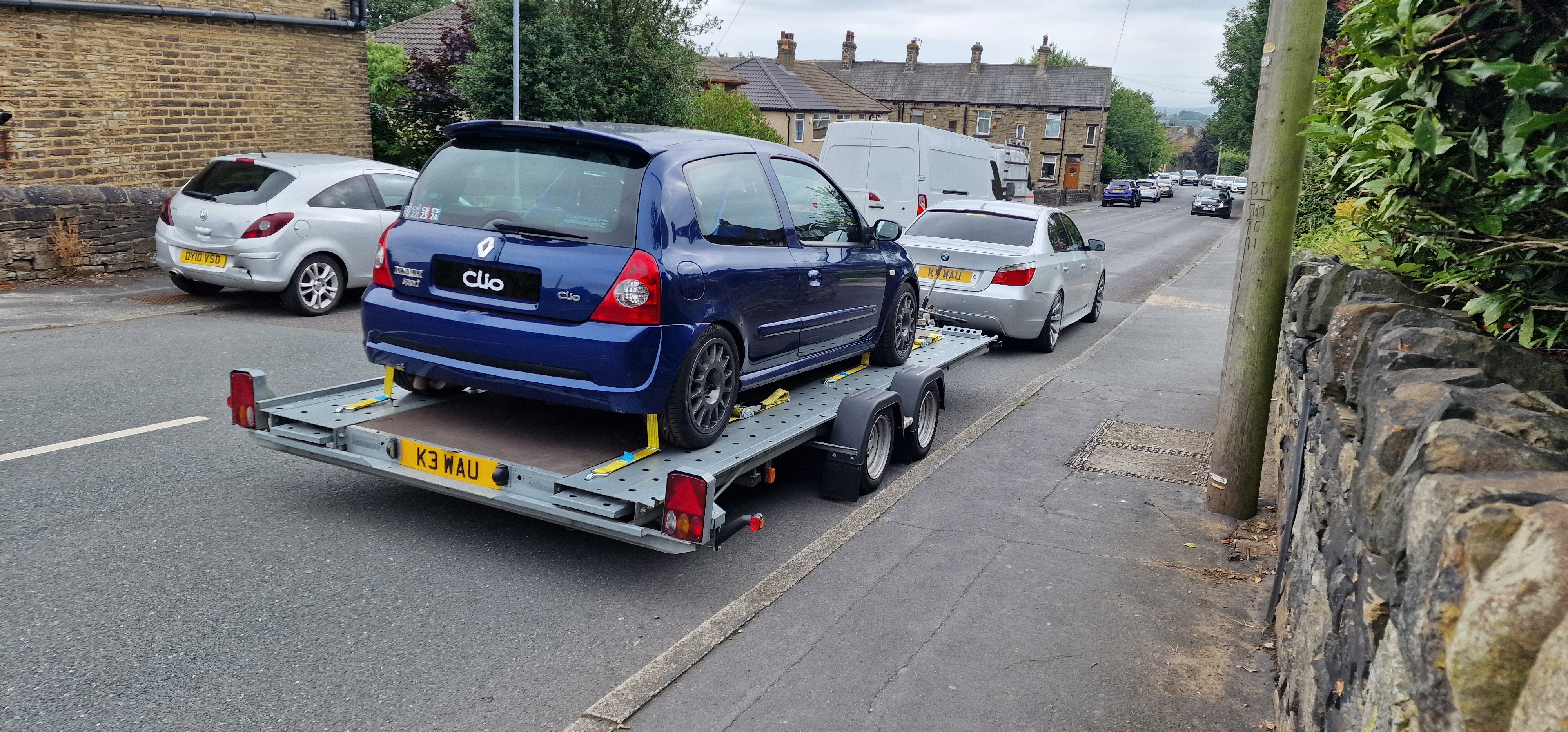

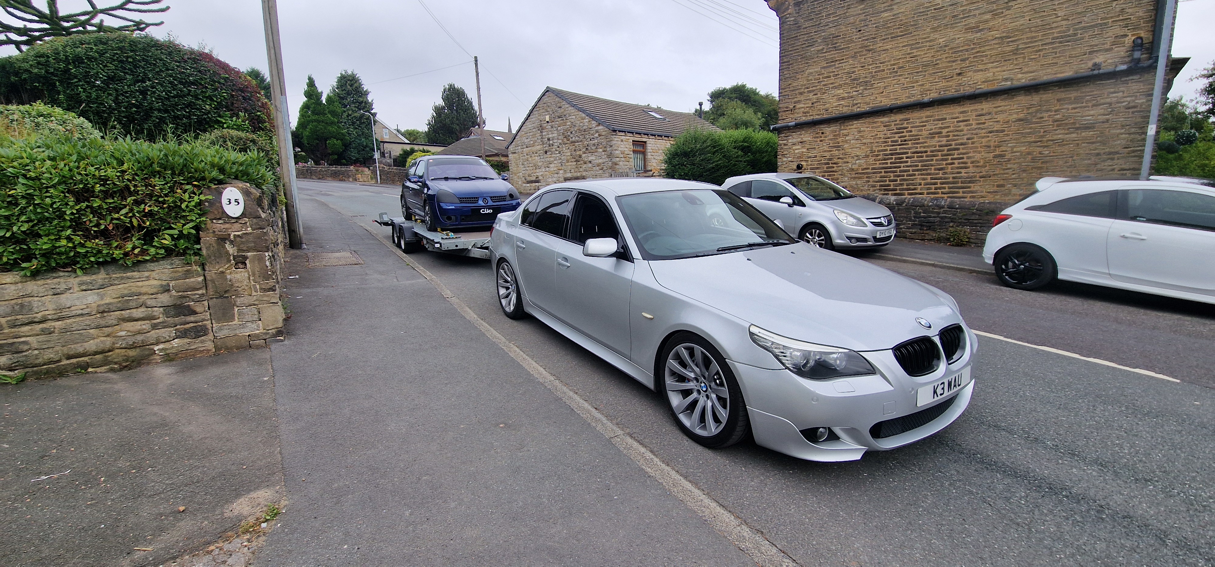

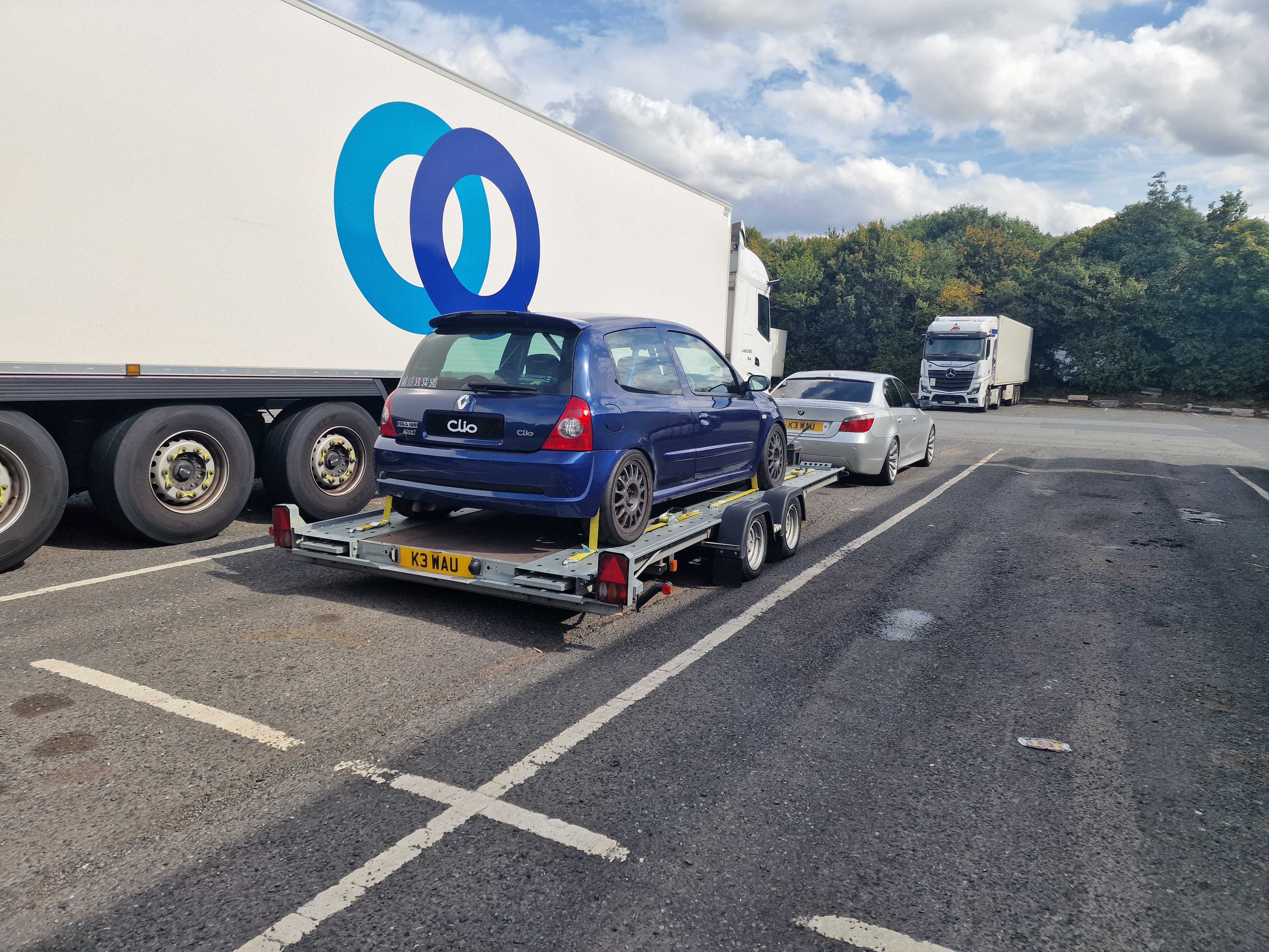

Loaded on the trailer yesterday
Set out today to swap over my pads to the DS1.11, put my track wheels on and load the car up for tomorrow

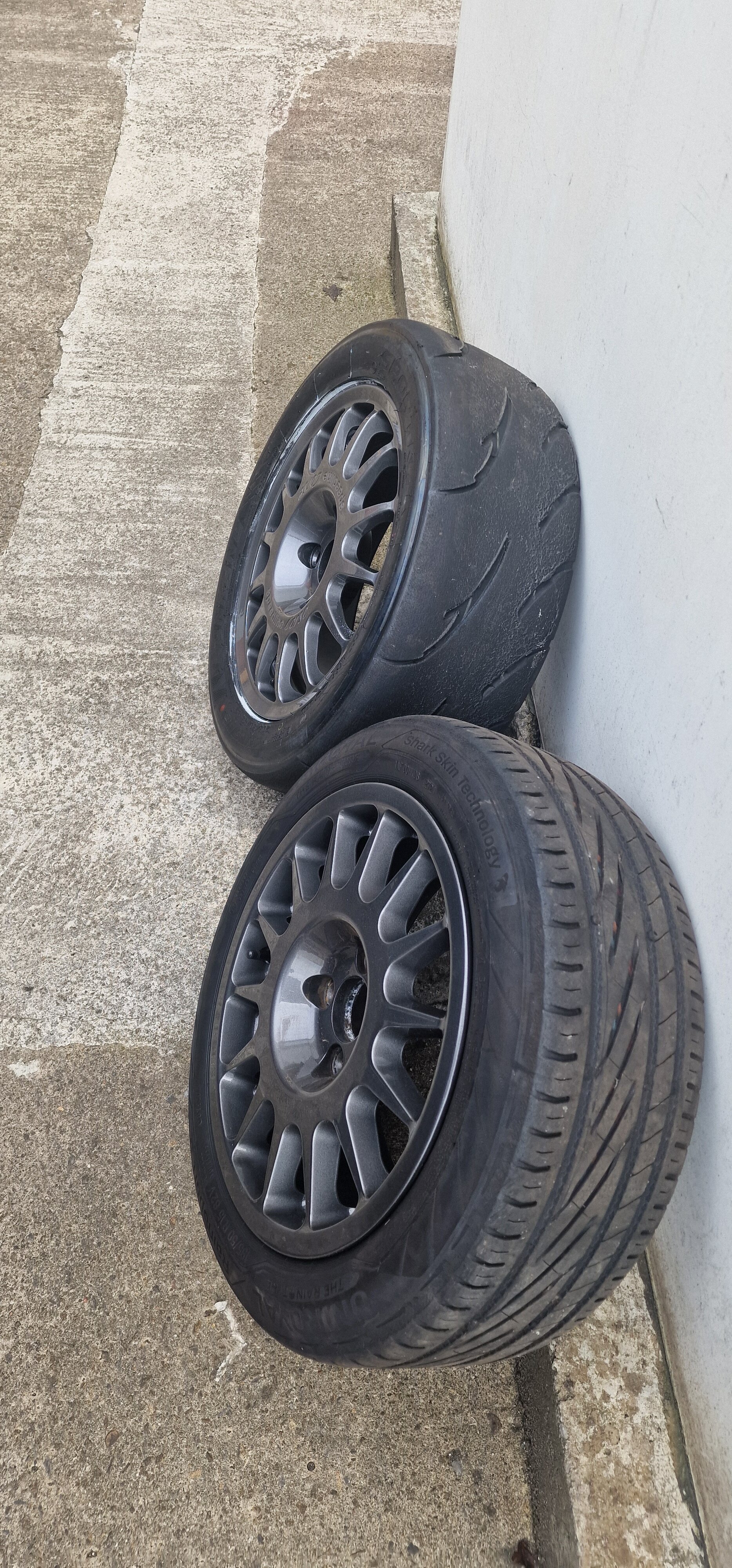

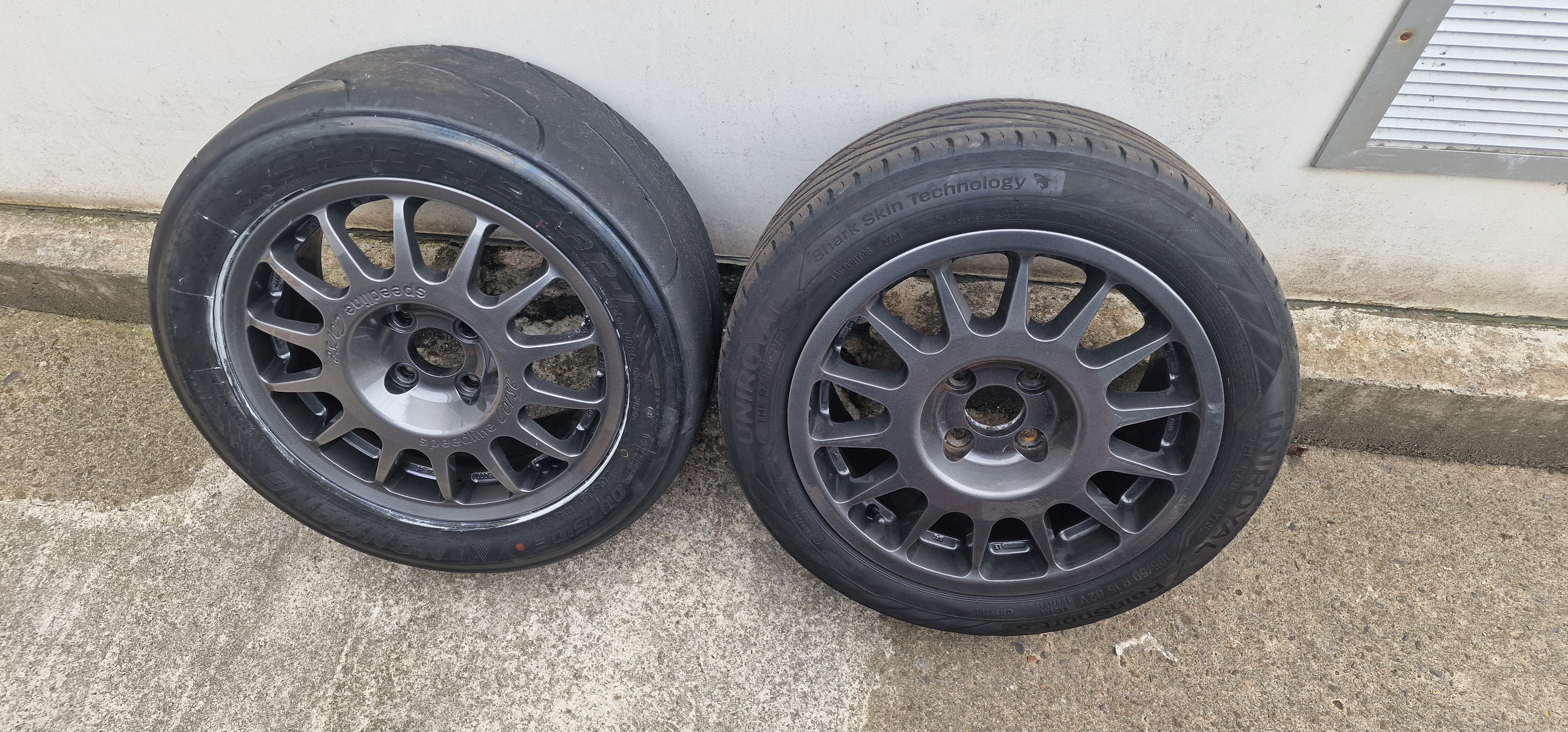

New track wheels. Genuine X65 Cup racer speedlines, quite a bit different to the 2118 you can buy anywhere

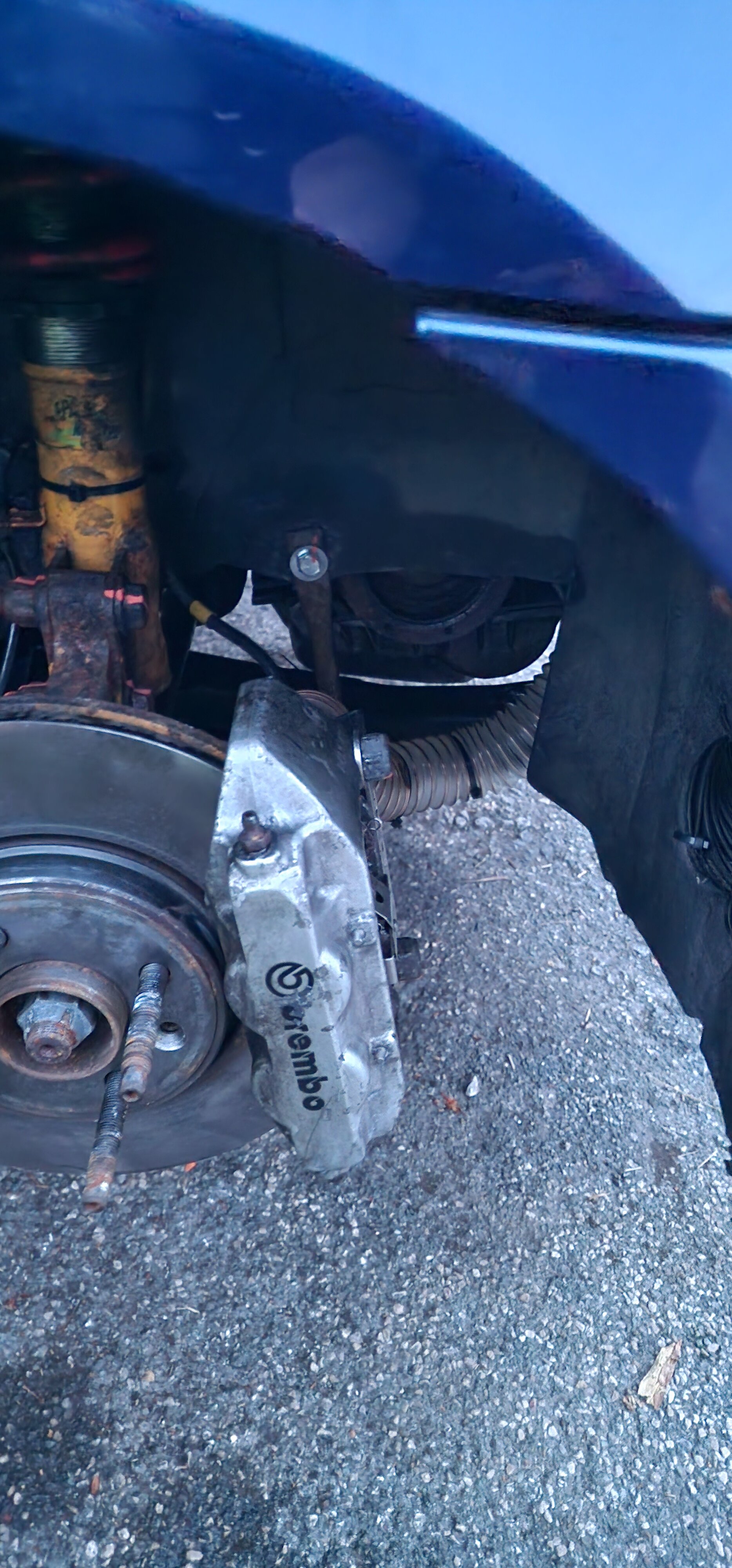

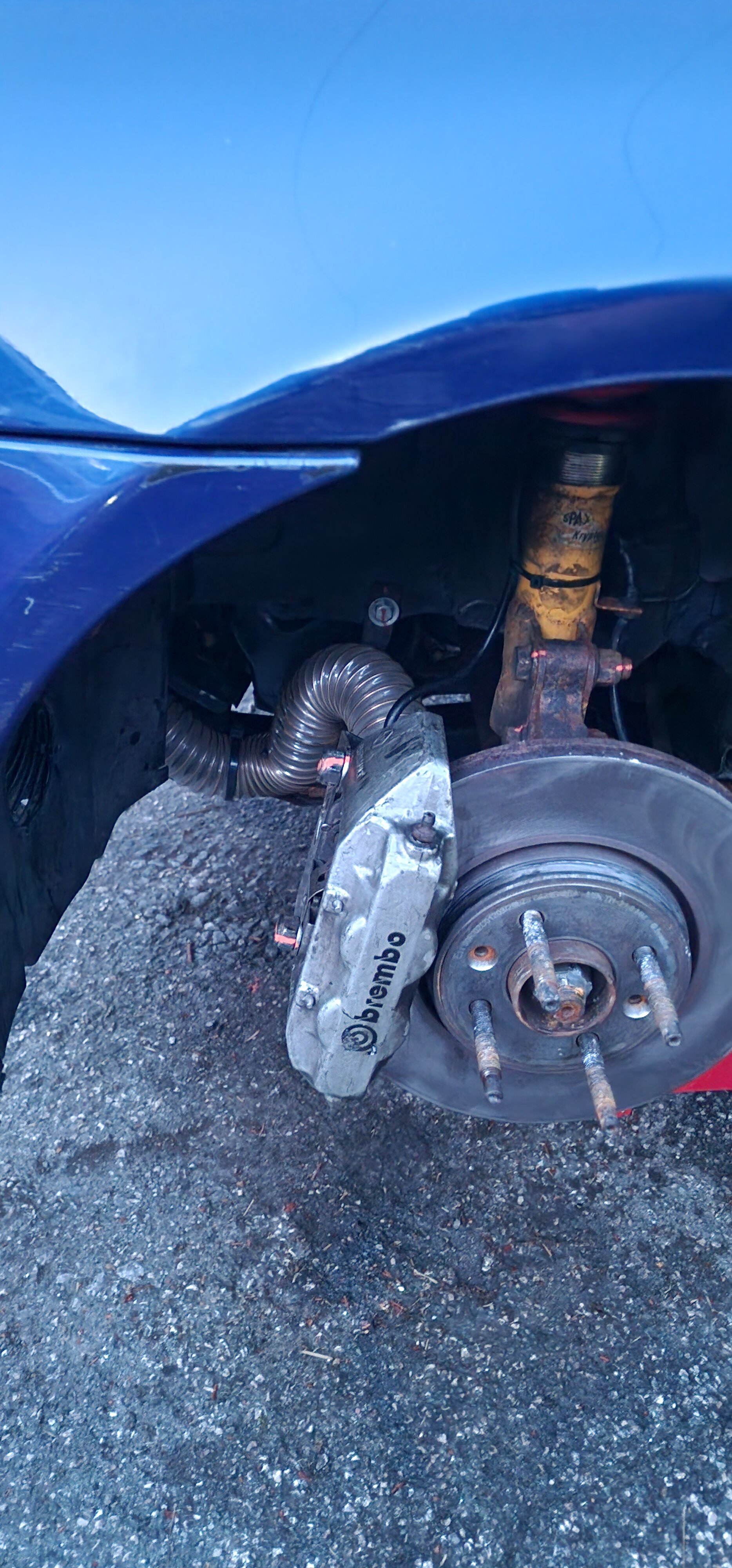

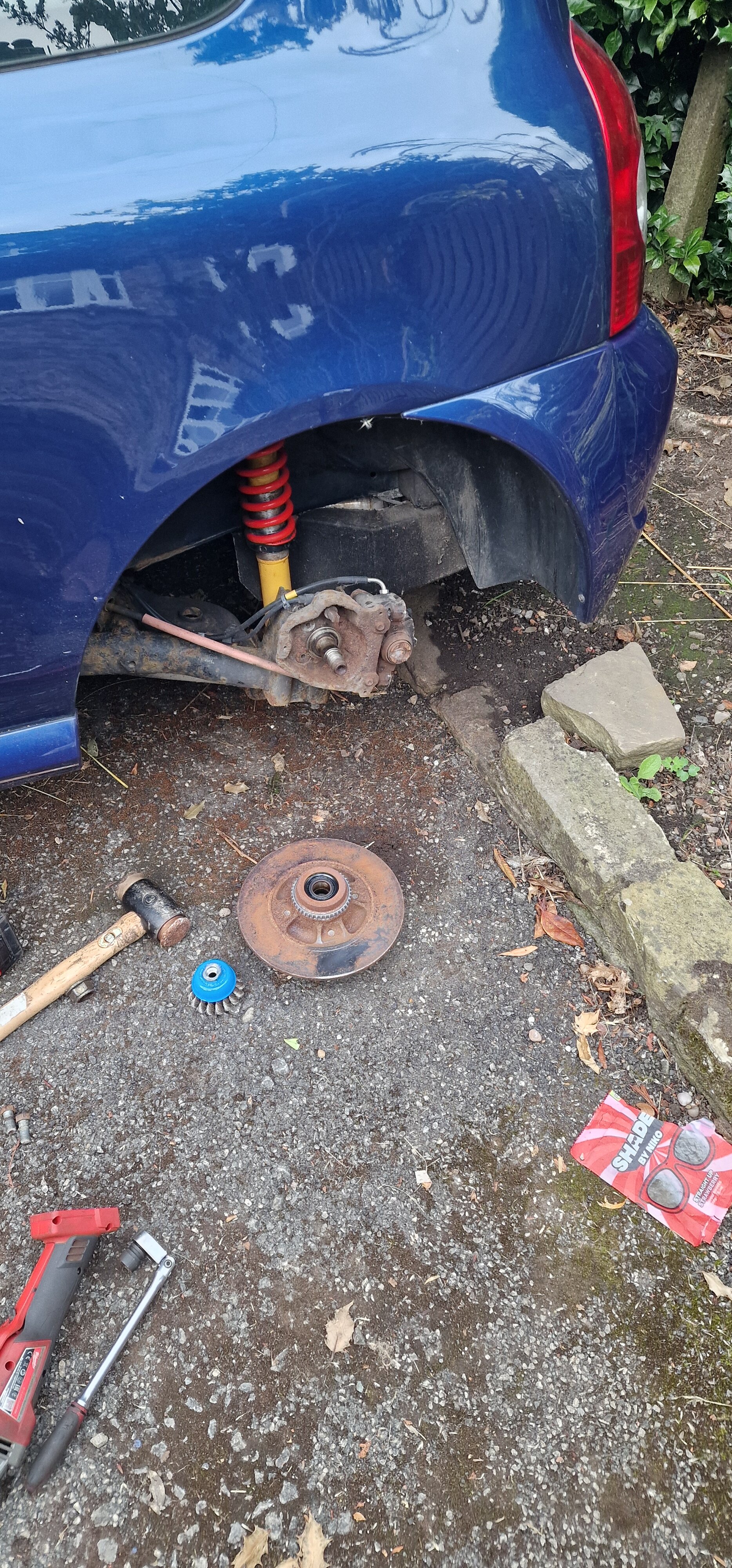

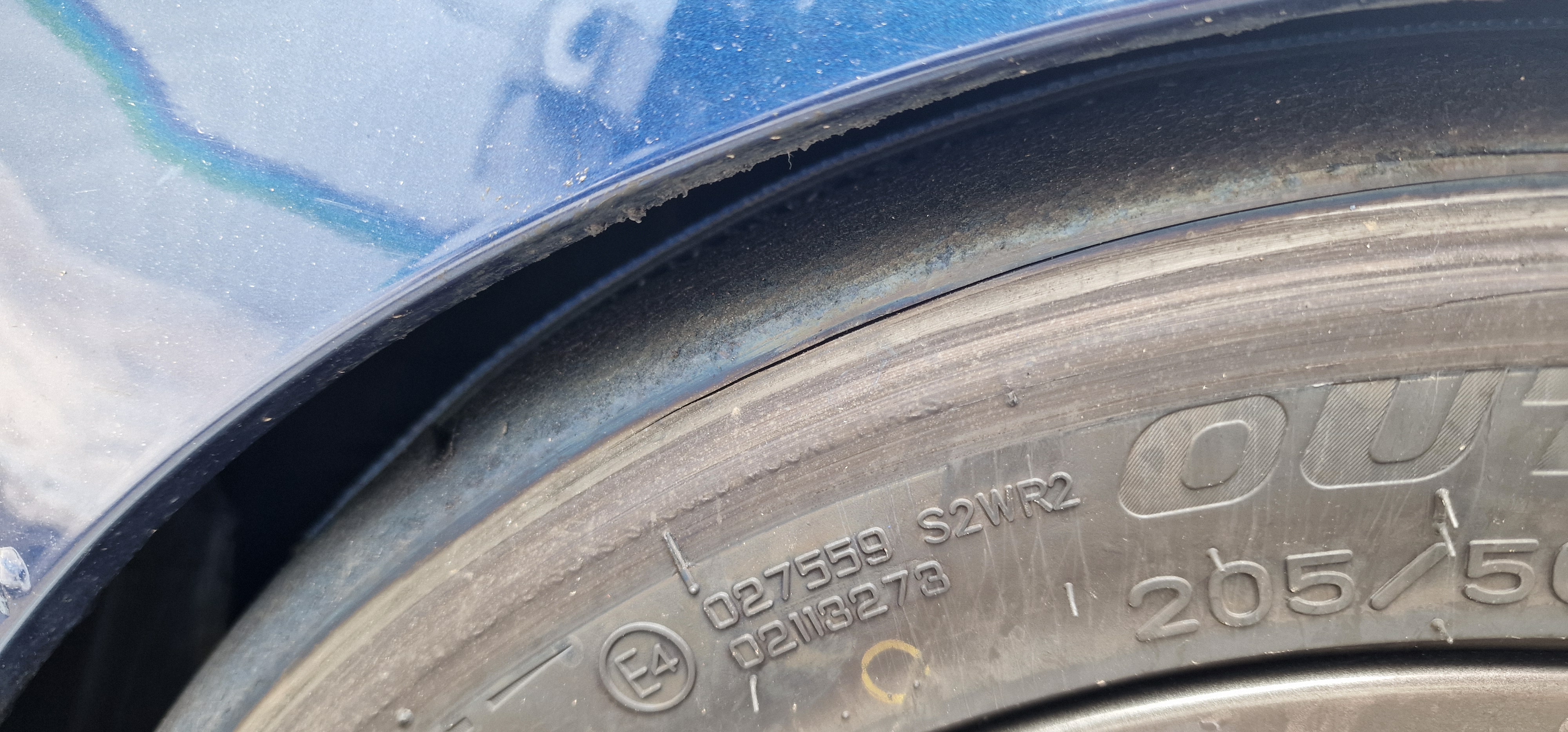

Swapped the pads over, fitted my Titanium shims. Pulled it forward, noticed a tapping/knocking
The wheel weights were catching the nuts for the Brembo brackets. I thought they'd self clearance but after driving it I had to knock them all off

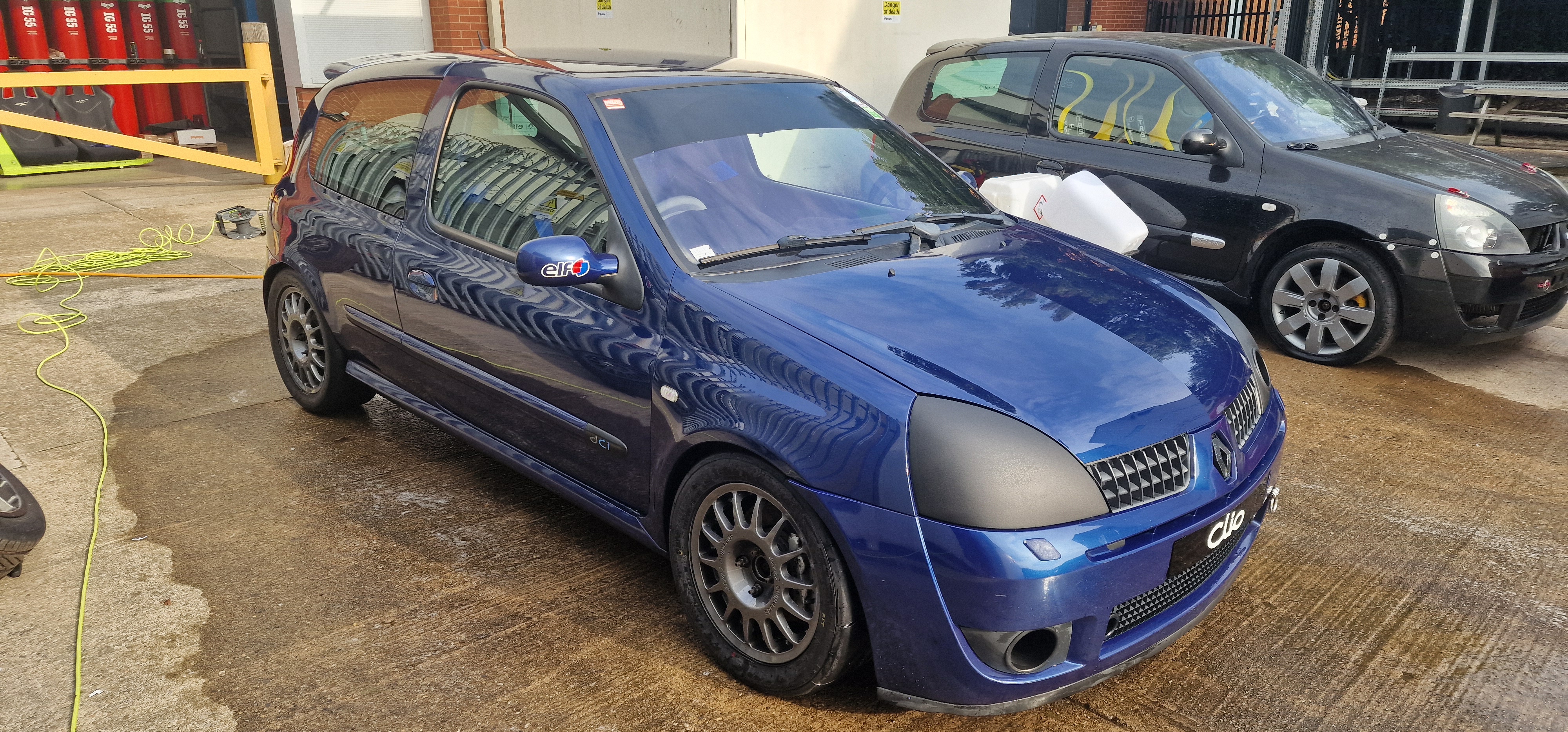

Gave it a good wash

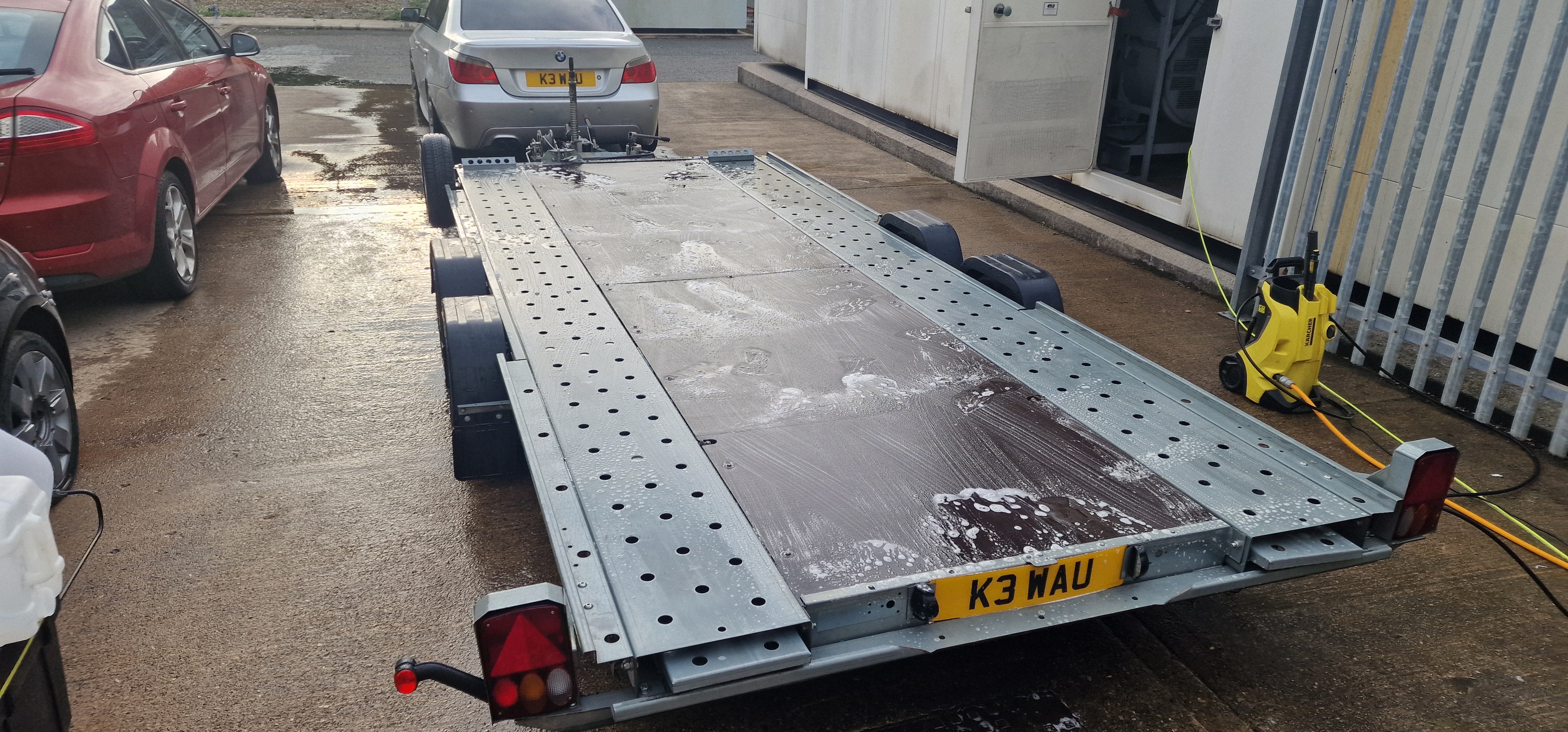

Gave the trailer a scrub down, had a few cars on it since and there was oil and fuel on the buffalo boards

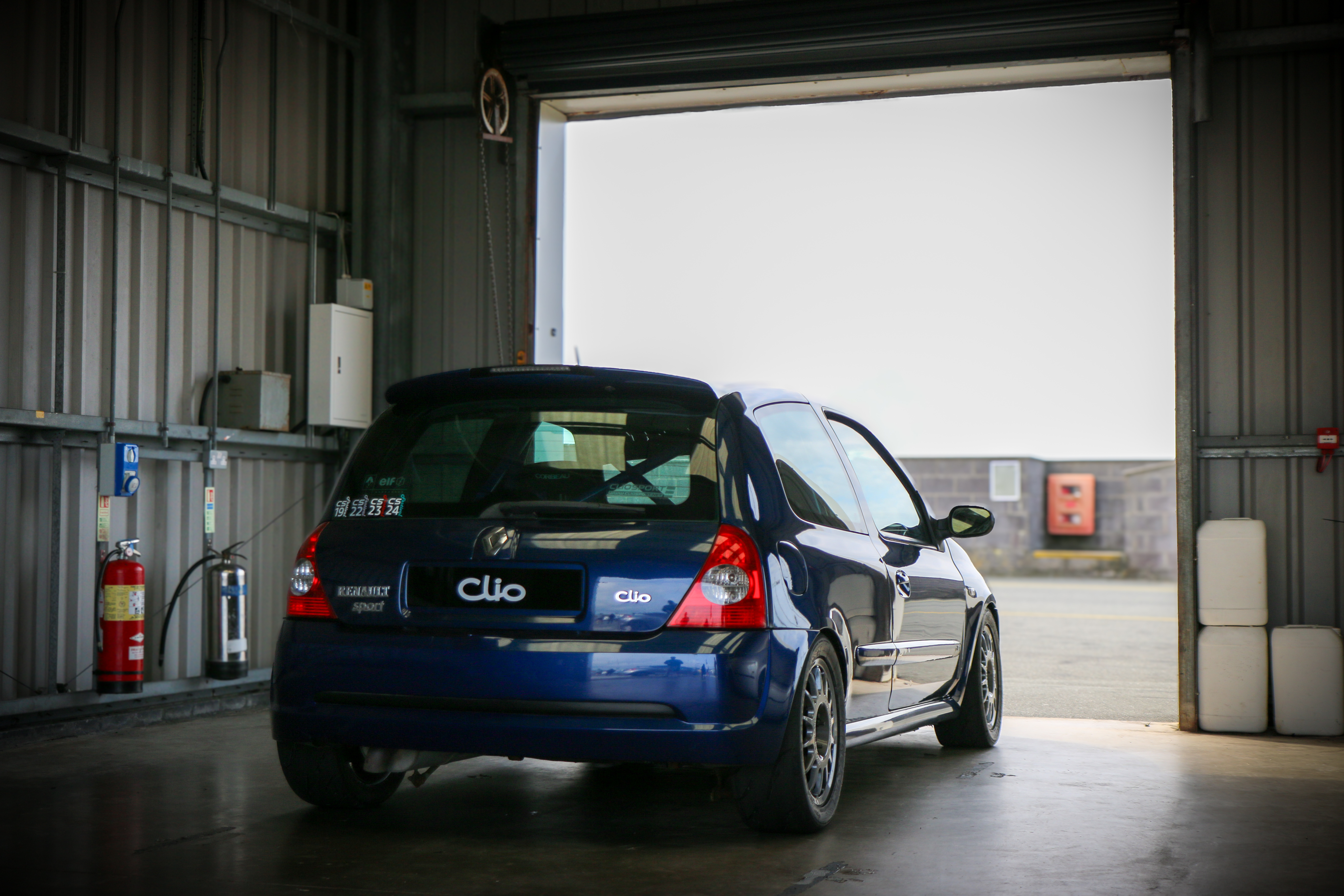

Drove down Friday, 7 hours driving time coupled with retards that can't drive. This Aygo being one of them, if you know this person, tell them to promptly die
The 5 series pulled the trailer without fault, I had @leeds2592 as a copilot. It made me realise how boring the drive usually is, it was nice to have some company

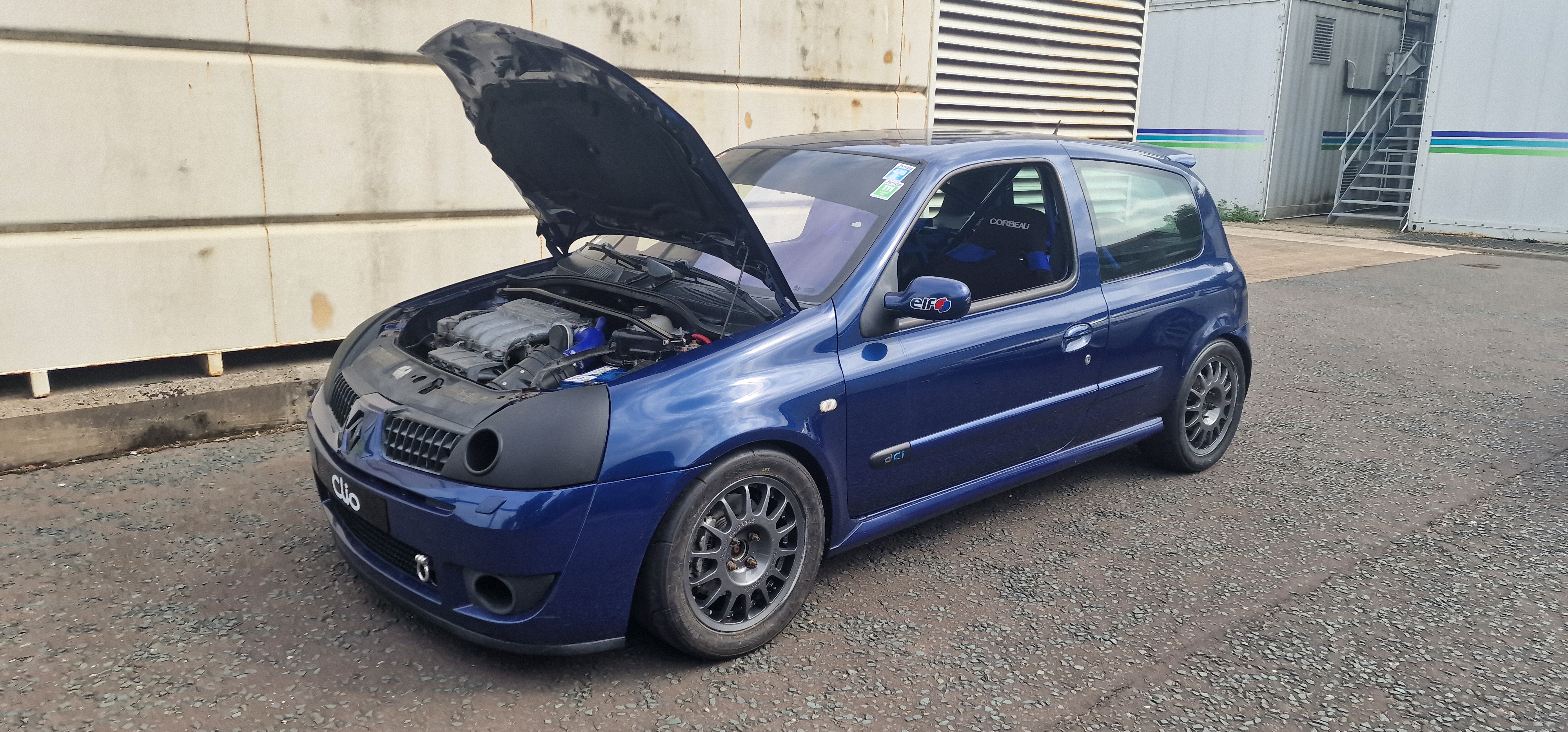

I was mega nervous about the Clio, I'd done less than half a mile in it since it's yearly gearbox removal🙃
7am arrival after a lovely stay inside of a chicken nugget caravan
Went out for the sighting laps, car felt good, I needed to bed my brakes in but couldn't really hammer them with it being sighting laps. So with that I let the mad rush happen and opted to go out 15 mins later. I got 1 lap in and started to bed everything in, as soon as I came out of turn 1 the car started spluttering with a flashing eml. I limped back to the pits and read for codes, the only ones I had were for both lambdas

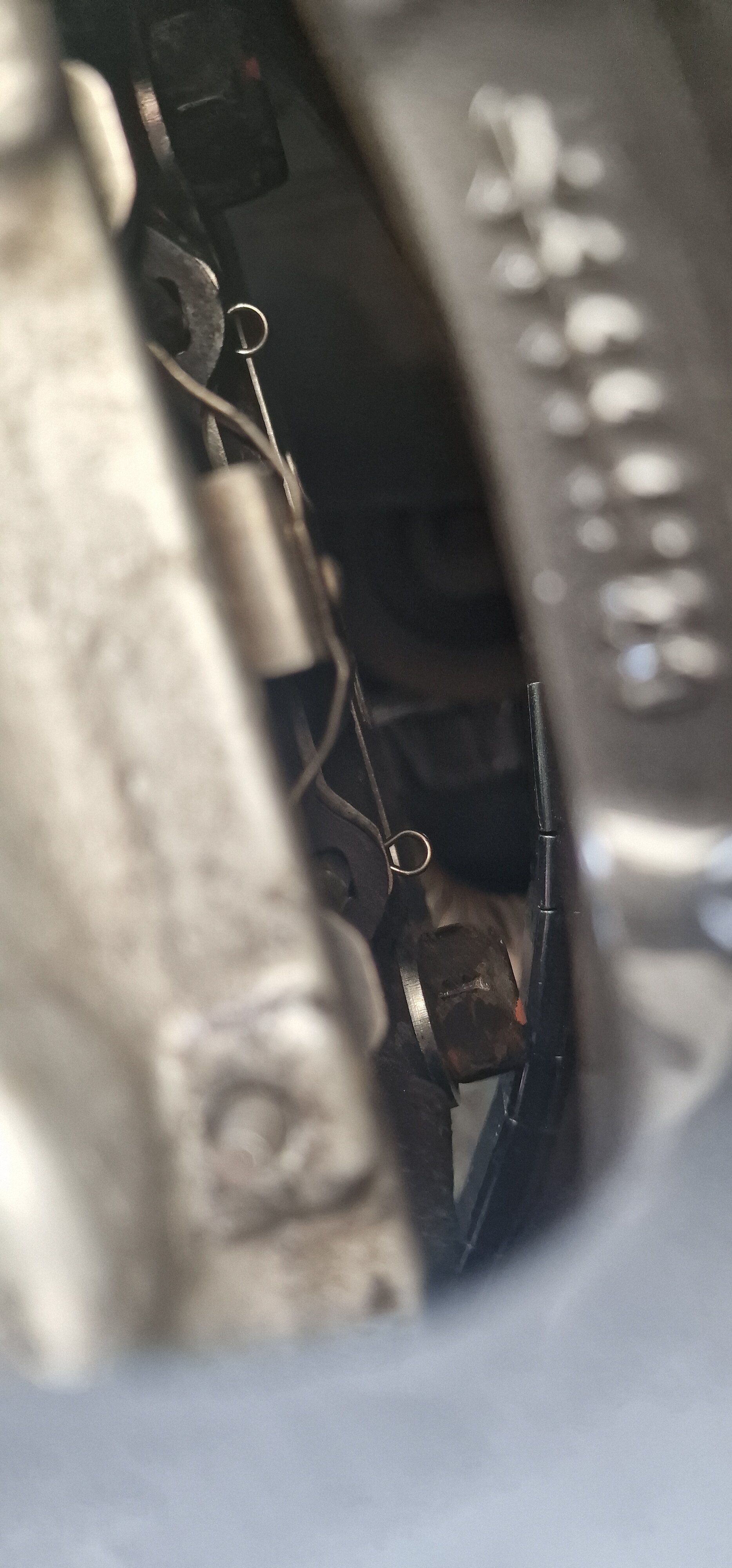

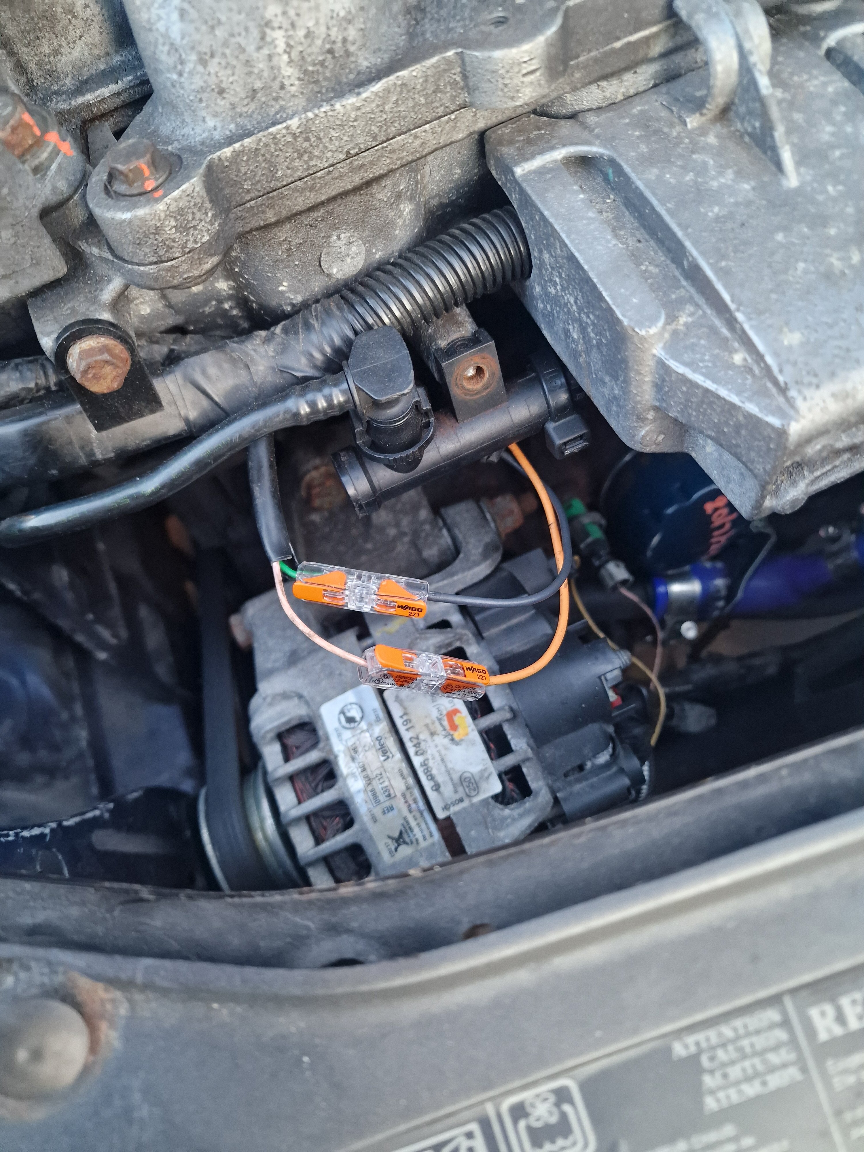

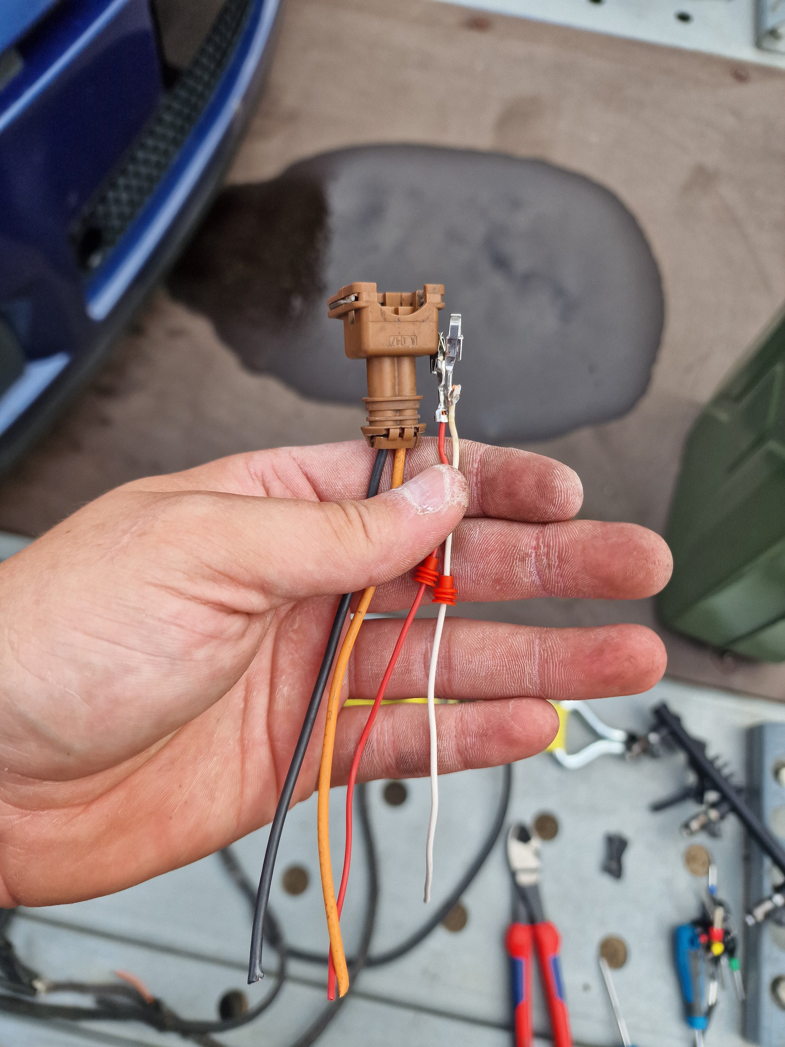

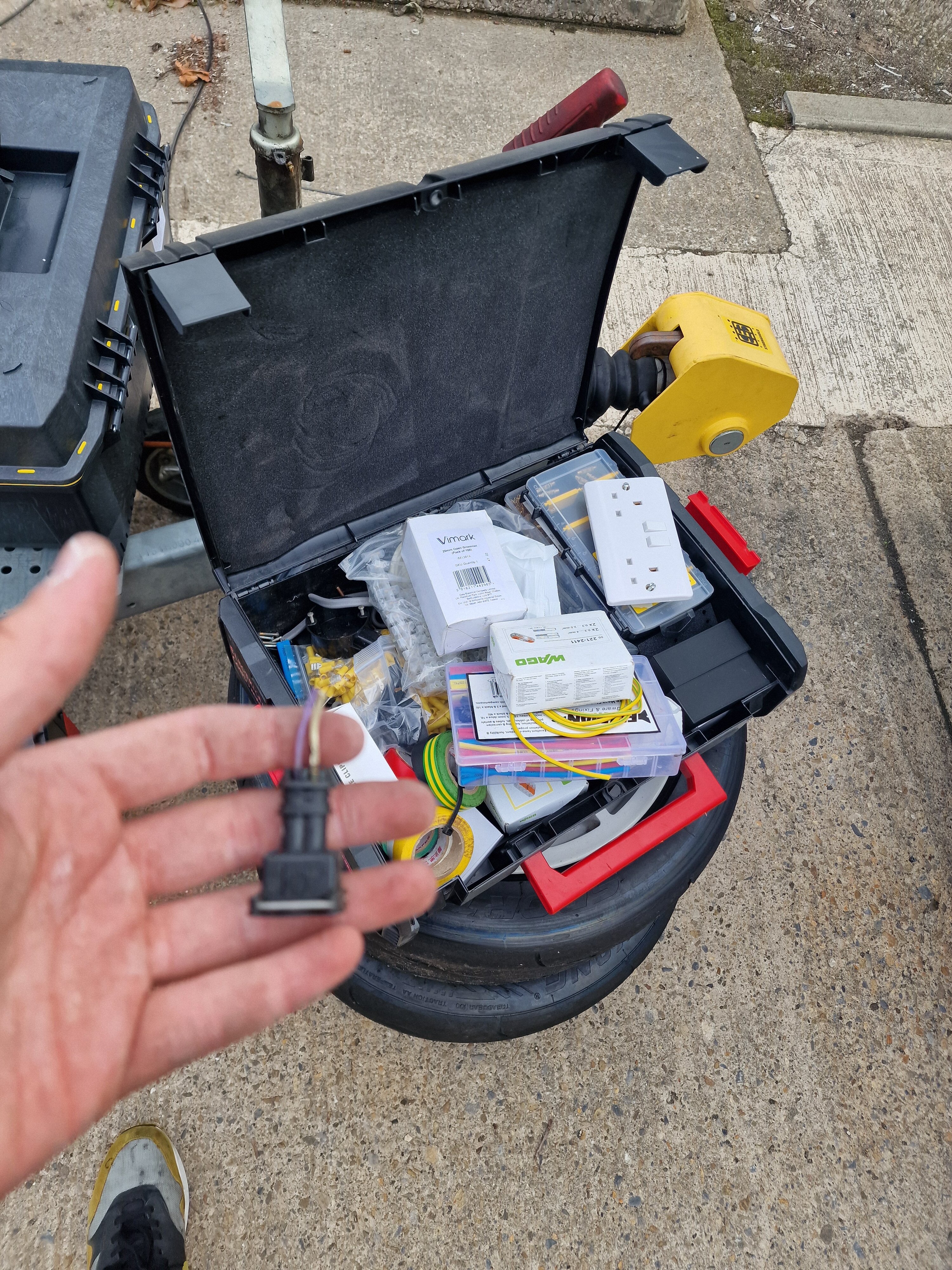

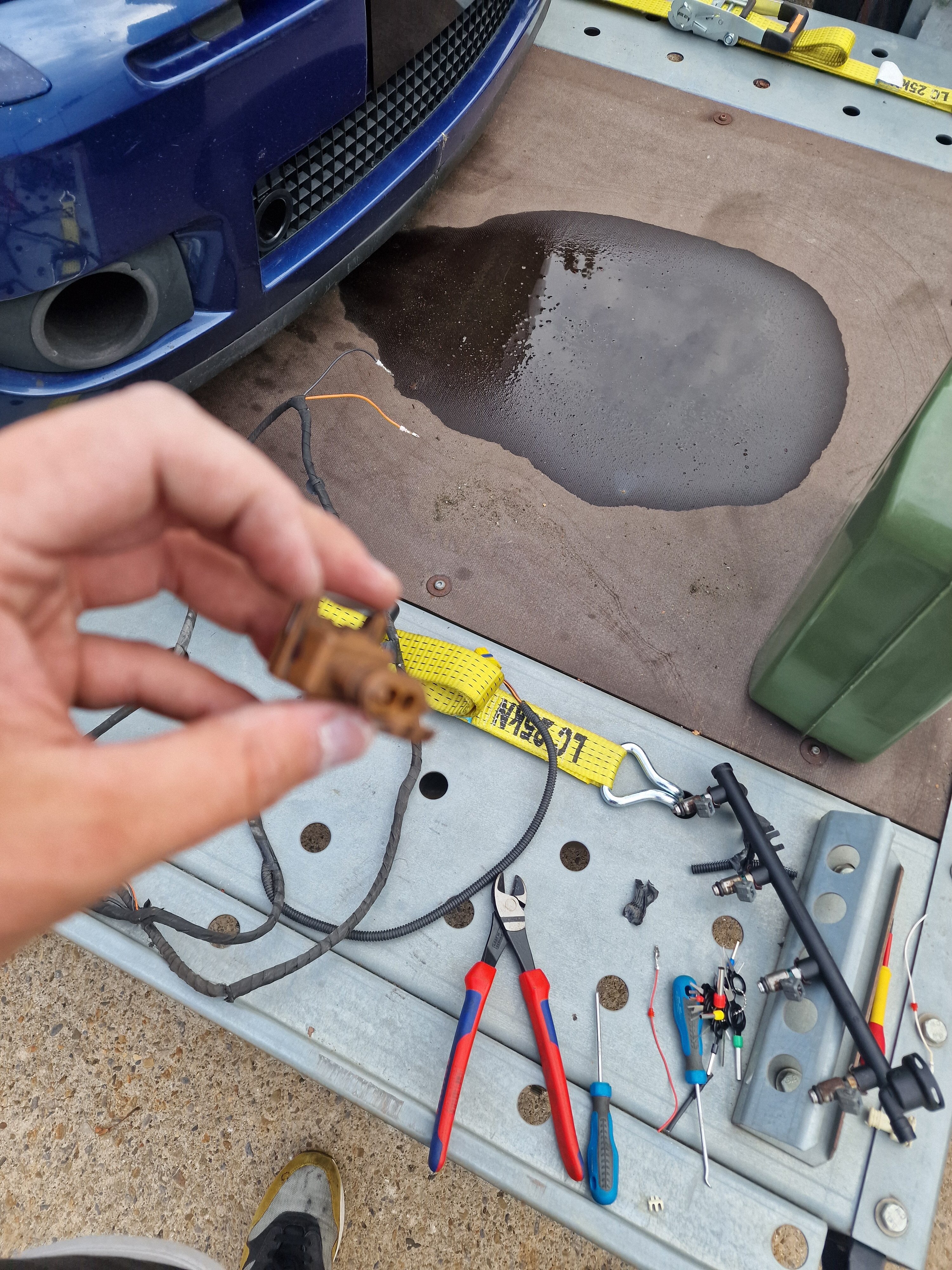

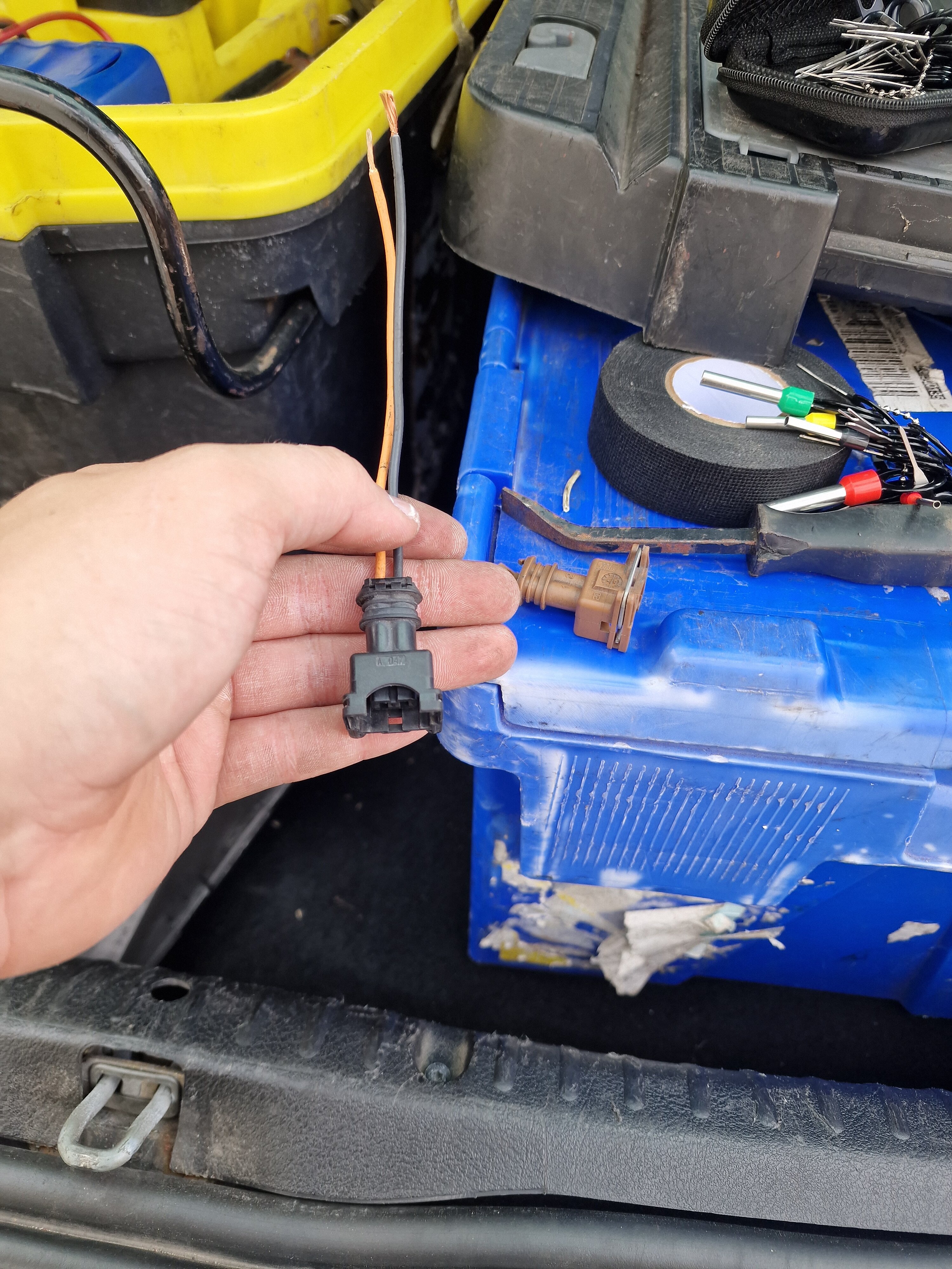

I got my spare injectors and rail and set about swapping the 'duff' injector. That then lead me to snapping the bolt that holds the fuel rail down. Thanks to @Scrooge for the positive words of encouragement at the time "I'm not leaving until it comes out or snaps, if it was me it'd be snapped already", no less than 4 seconds later I snapped the bolt so he could depart🤣🤣
With that snapped I swapped the injector, just as I was putting the connector back on I noticed copper from the plug end. Then I barely touched the wiring and I snapped🙃 So now I was left head scratching again on how to fix a wiring issue when the plug had 3mm of wire hanging out
Again, big thanks to Ryan and Ryan (or DannyDC2), his car was fully stripped so he cut out his speaker wiring which had 2 spade connectors on. So now I had a pigtail I could use and bodge fix my car with
Which resulted in this🤣
I fired it up and everything was spot on. I took it around the paddock and it seemed fine, so the helmet went on and I went out to really f**king give it some. And it was, everything was working well

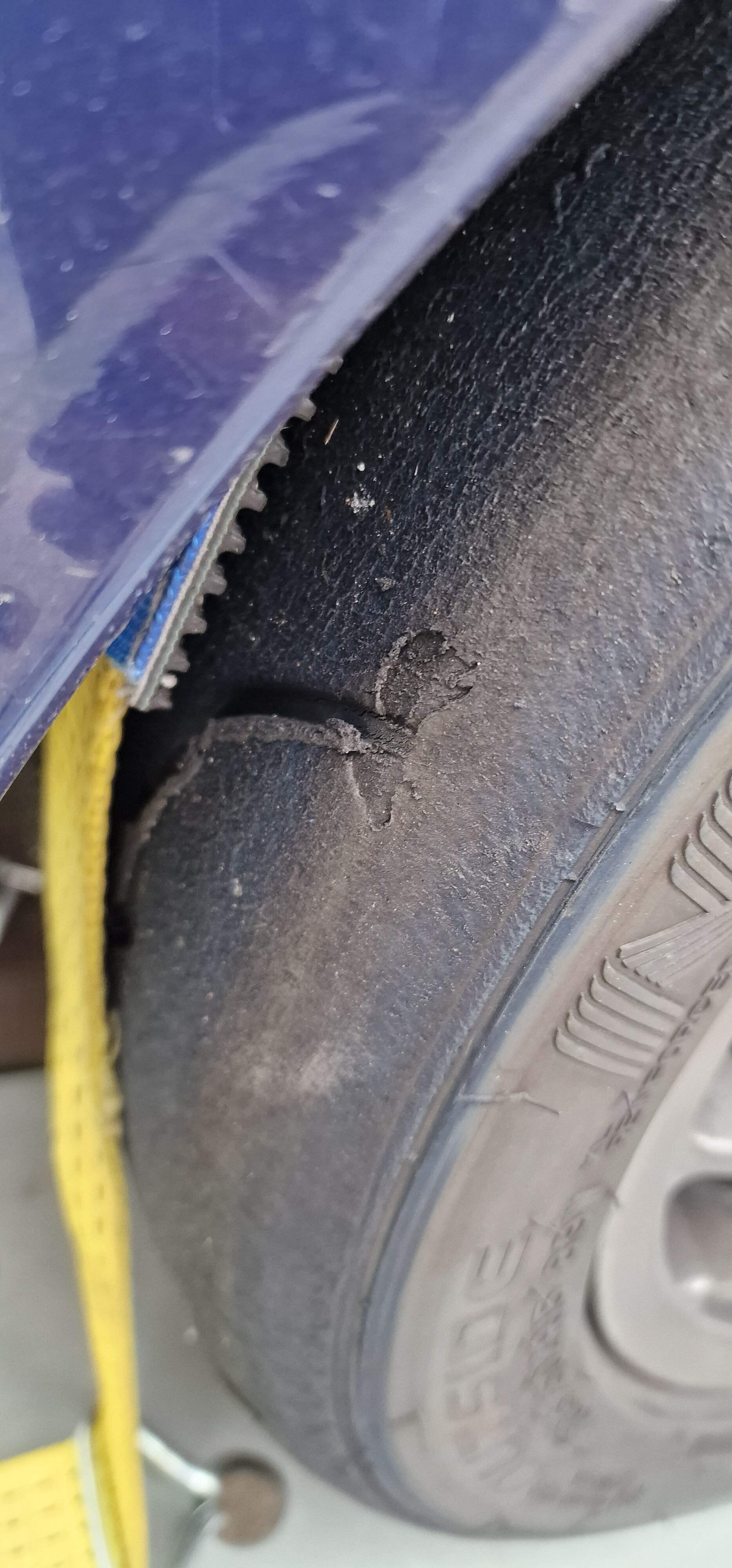

After a proper good session I had finally worked the front AR1s too hard and they started to go off. I can't thank Andy enough for the pointers, because after that I had the pleasure of @Sunglasses_Ron in the passenger seat. His son witnessed some horrific driving but at least his dad could call him a bullshitter because I never missed 2nd once with him in the car👀🤣
View attachment 1753682View attachment 1753683

@Brigsy had a plug with him too🤣
I think I'm gonna keep crimps and connectors with me from now on ffs
Ive had a pre wired ev1 injector plug in the trackday box for years, you would have been welcome to it mate.

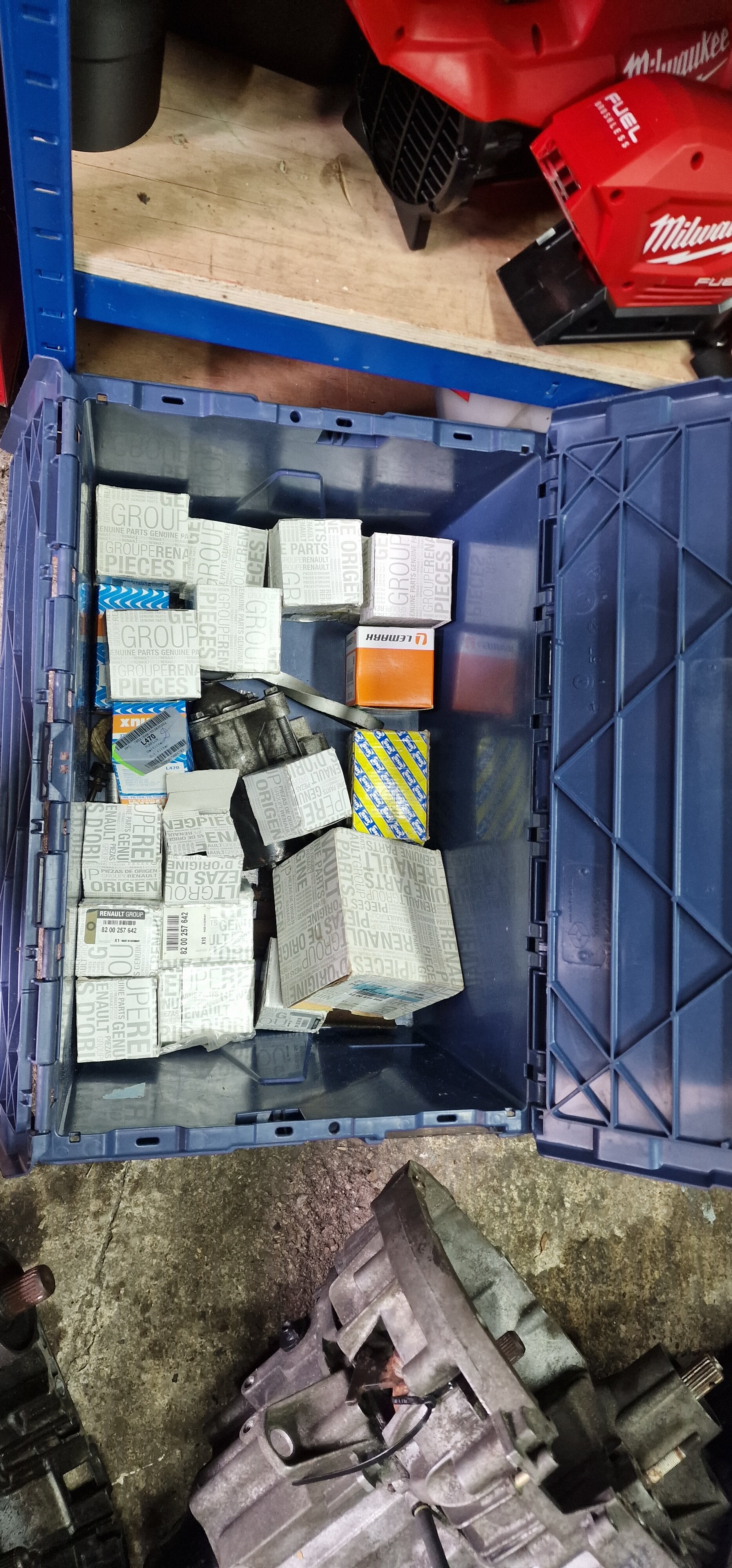

These are the ones I bought
I'm glad I got one with my mates car, he repainted it in Porsche Malachite green a couple of months ago. It's f**king rapid compared to mine, made 230bhp on 197 pistons, 421 cams and some Jenvey bodies, it's been that power for about 2 years now 😂 It's pushed me and I really want to put an engine together for mine now

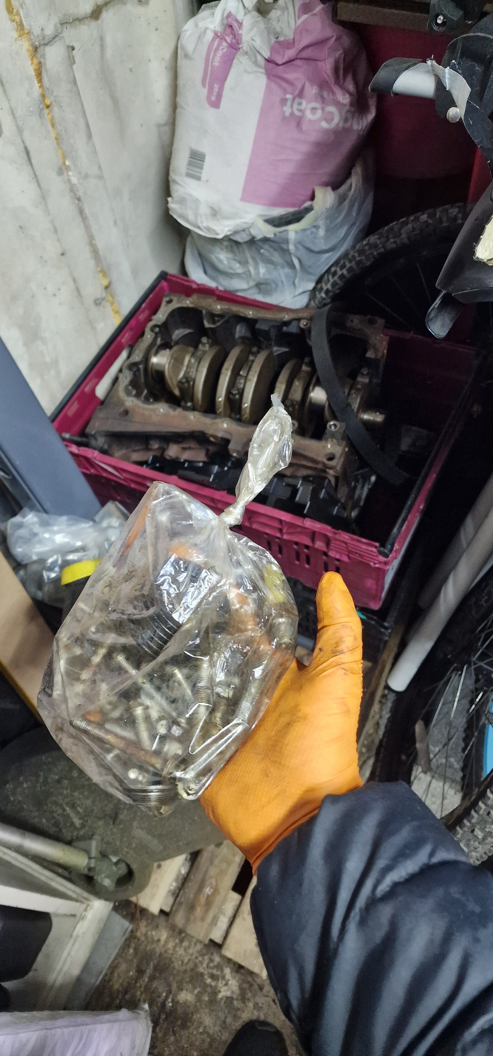

I have the vast majority of the parts;
  • Tessa inlet
  • 200 pistons
  • 200 rods
  • 200 cams
  • 200 crank
  • 200 valves
  • 200 valvesprings
  • Main bearings & thrust washers - Need to buy
  • Rod bearings - Need to buy
  • ARP rod bolts
  • Main cap bolts - Need to buy
  • Headgasket set - Need to buy
  • Bottom end gasket set - Need to buy
  • Top end gasket set - Need to buy
  • Piston rings
  • Head bolts - Need to buy
  • Megane keyed pulley 8200251569 - Need to buy
  • PMS lower cambelt protection cover
  • Genuine cambelt and dephaser kit
  • New crank pulley/dampener
  • New Genuine oil pump
  • Genuine camshaft stud
There will likely be loads I've forgotten that I have. I've spoken about it loads of times before but every time I get the time and money together to do it, something happens. First the Megane needed a new gearbox, then it needed a turbo and an engine refresh, then the Clio was my daily, then the gearbox shat itself (repeat 3 times), then the 5 series needed an engine rebuild, and new turbos, and mapping.
