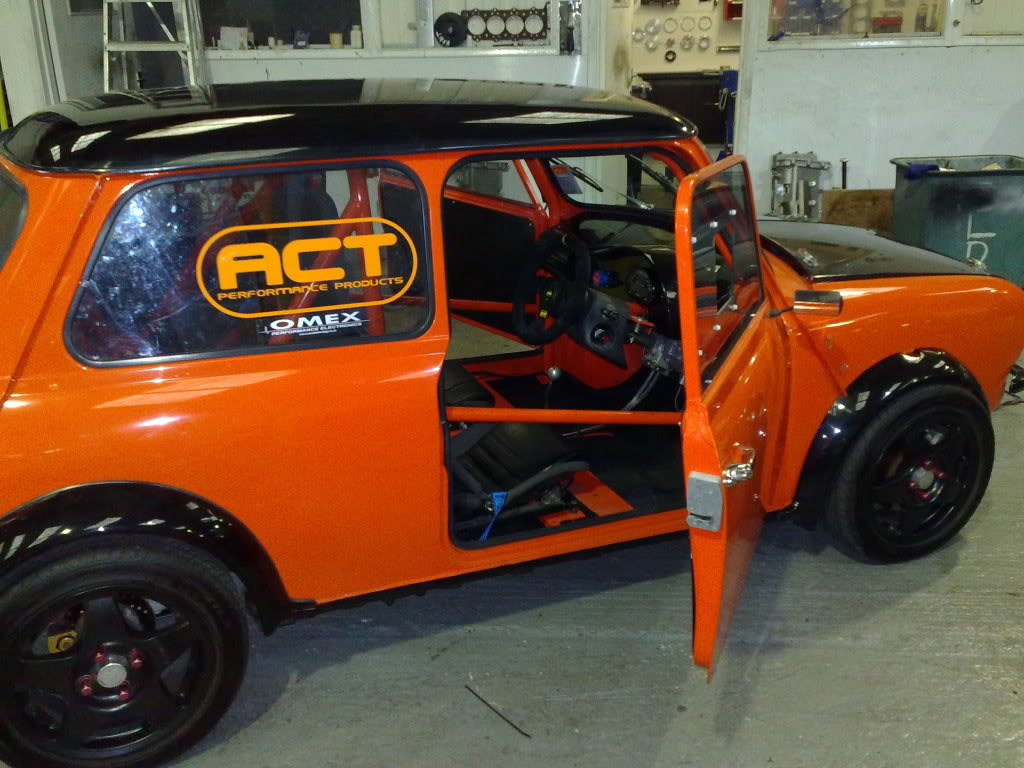

MINI V-Tec DONE!!!
Integra type R engine on Jenvy bodies with 8 injectors.
For sale soon!!
Sorry lads to clear any confusion it's not mine. Its a good mates. So anything to technical I may not be able to answer!

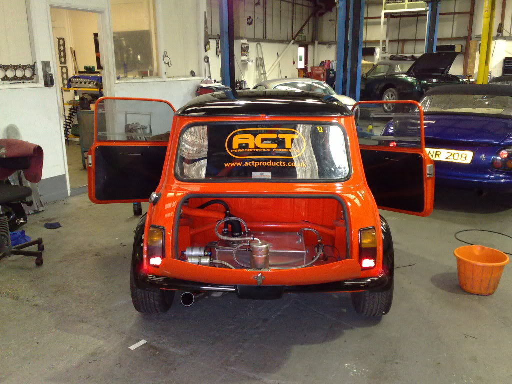

Might just be me then, due to me still waking up.

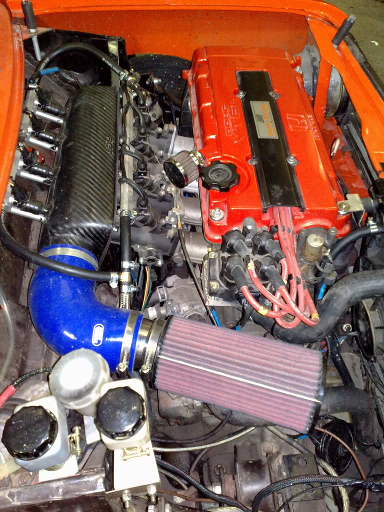

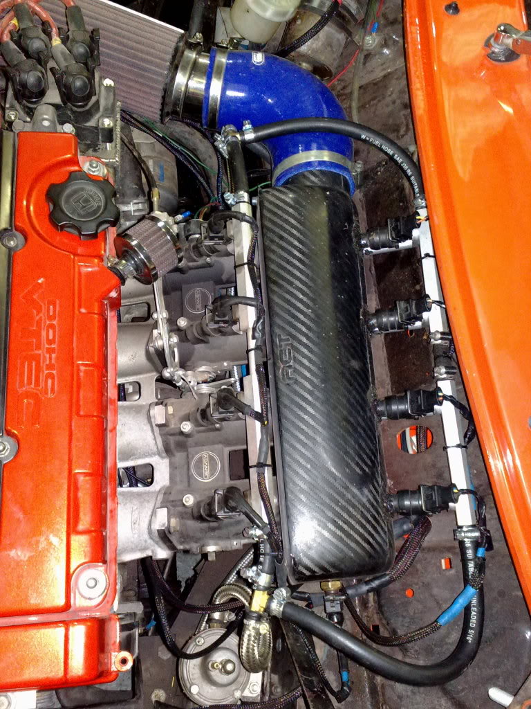

But it has ITB's, and then its still connected to 1 filter, rather than having 4 individual socks on for instance??
It's just running an airbox. You don't need individual filters, the box will help to keep noise and inlet air temps down.
S52/54 M3 engine uses an ITB/airbox setup. Works ok for that. ;)
