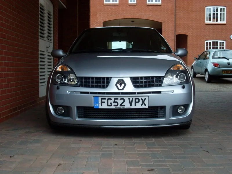

Hi everyone, have done enough to the car and got a bit of direction going with it now to warrant putting up a project thread!

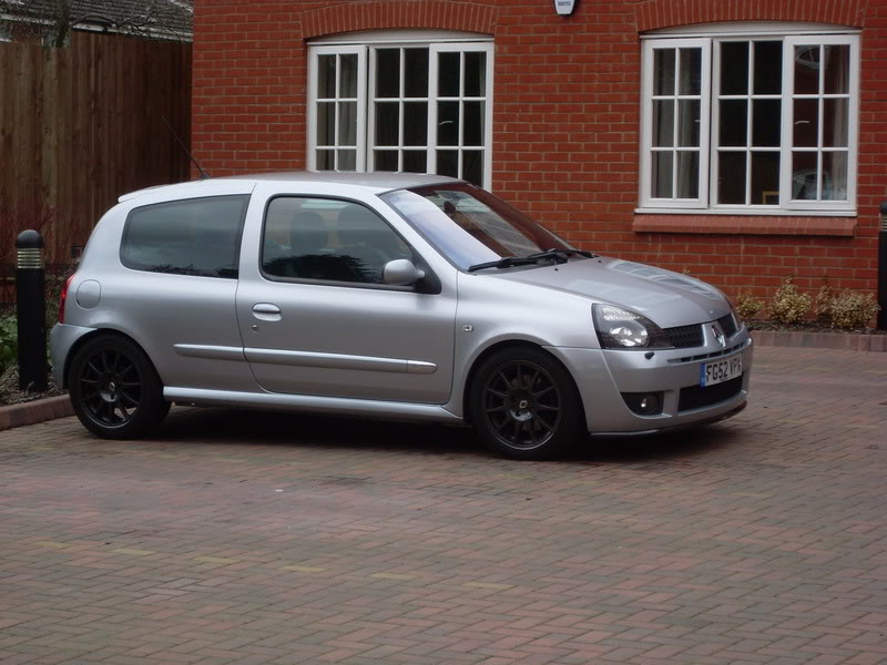

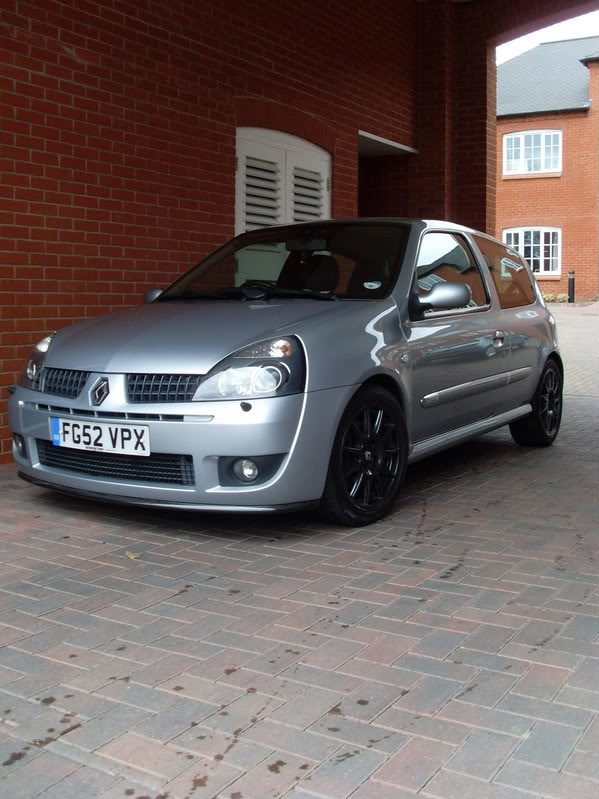

I bought my Ph2 172 52 plate last May. It was on 39k miles - now sits at 44k - and was completly standard bar an ITG panel filter. As soon as I had it I changed the front wipers to some Bosch Aero style ones.

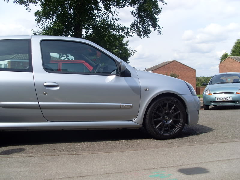

In the August, change was needed. Bought some turinis off Andrew 172 Cup off here. Had them refurbed and resprayed at Laptab, Birmingham. Same month bought and got fitted some Eibach Sportlines -30 mm and some clear side repeaters from Ktec.
In the November, ordered and fitted with a mate a Ktec CF splitter. This is the only real pic I've got of it. Also, my exhaust developed a real throaty sound and on closer inspection we noticed the centre section had an a huge split in it. So ordered a Ktec Stealth system as it worked out cheaper then a standard Renault system. Also had some Brembo Max discs fitted as Mot was due and wouldn't have passed otherwise. All in all an expensive month!

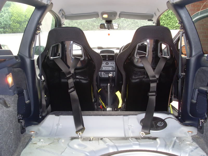

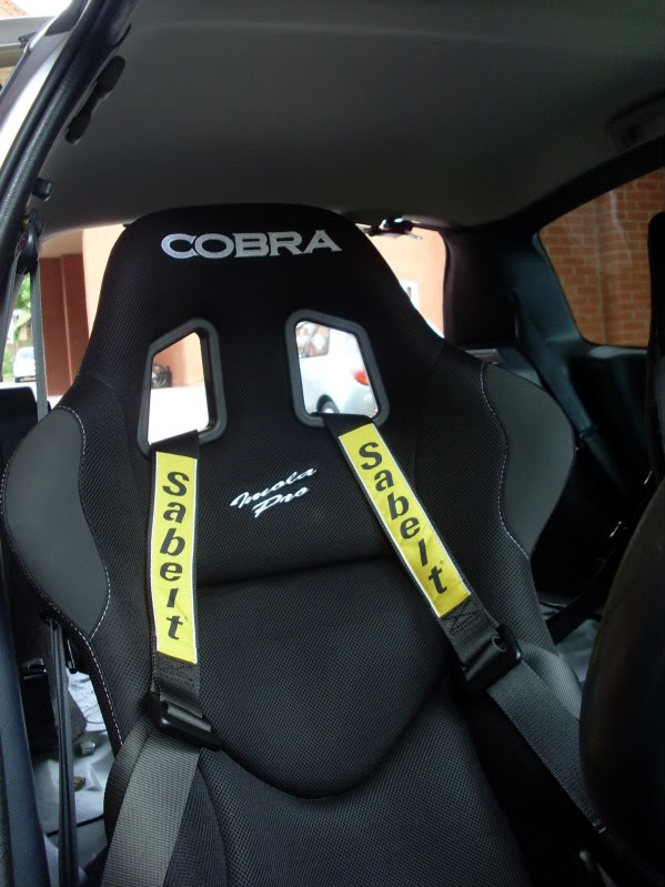

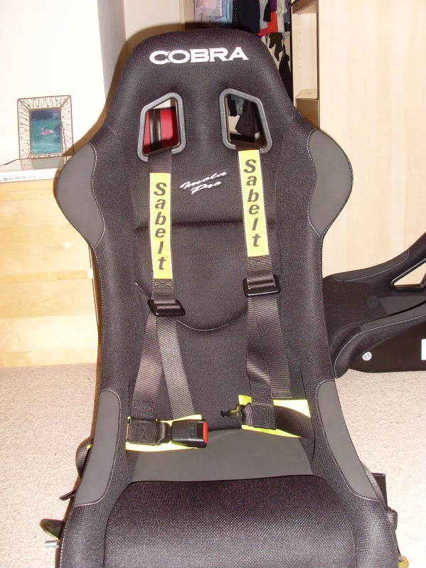

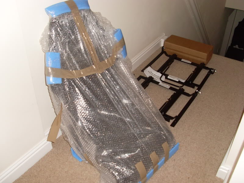

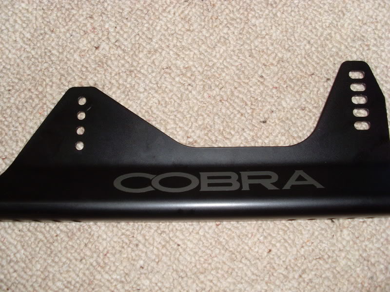

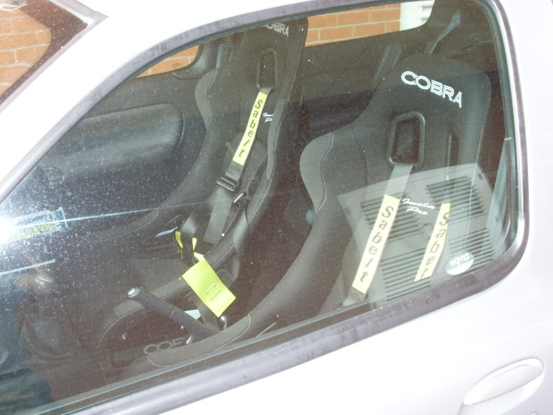

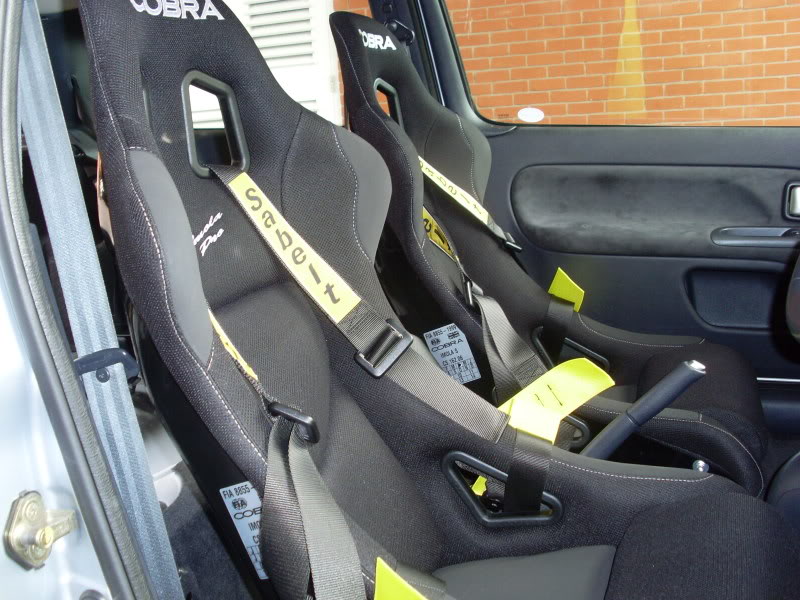

Then over the last couple of months had been doing a lot of research on some buckets seats as i want to do a few track days. Decided to order them from Demon Tweeks as they offered the best discount! Only took one week from time of order to delivery for them to come - speak to John Harris @ Tweeks, top guy!
Thanks to f0xy and ben_p off here for the help advice on the seats :D

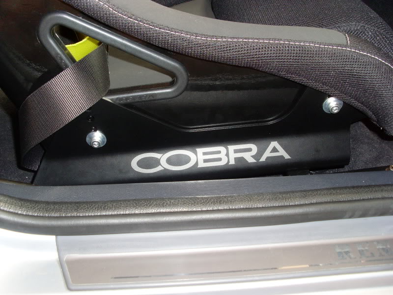

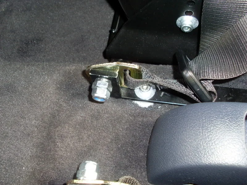

Specs on the seats are:

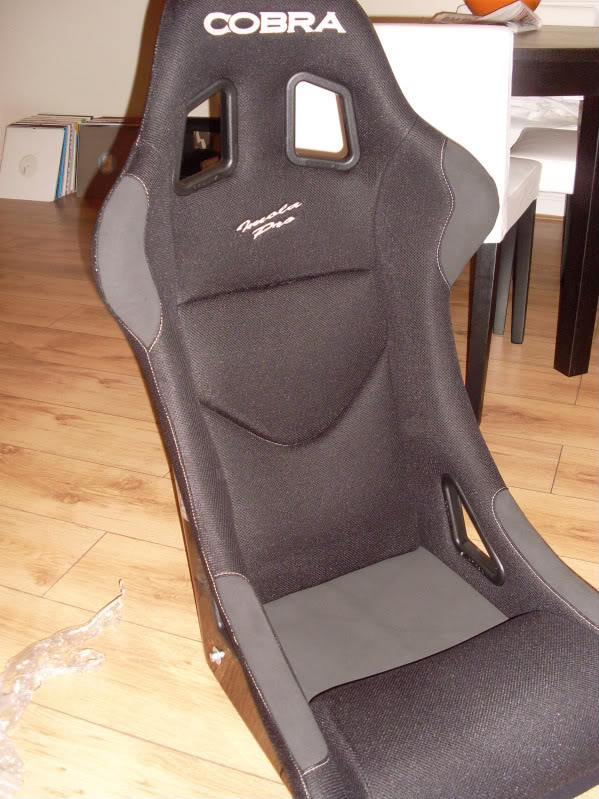

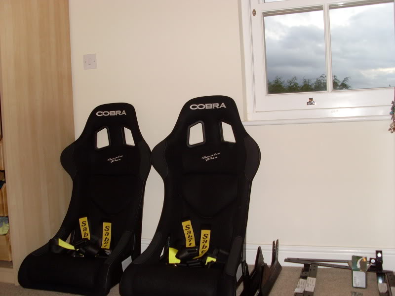

Cobra Imola Pro Std width in black
Cobra Steel Sidemounts

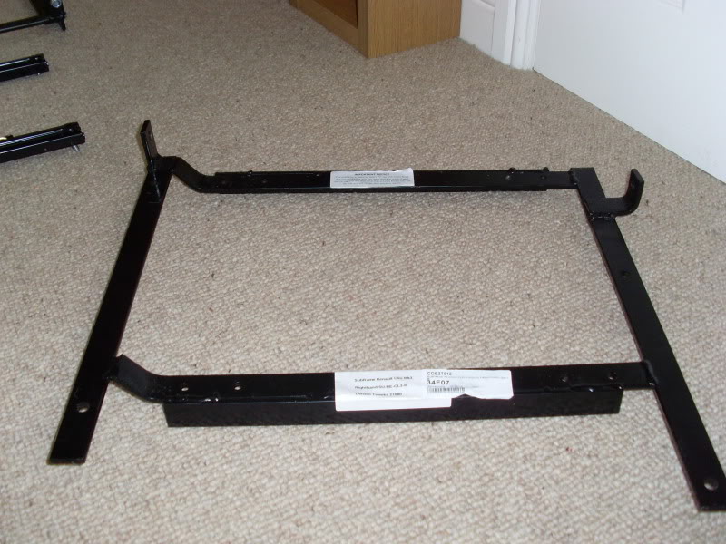

Cobra X-Low subframes
Sabelt 3 Point Clip In harnesses in black

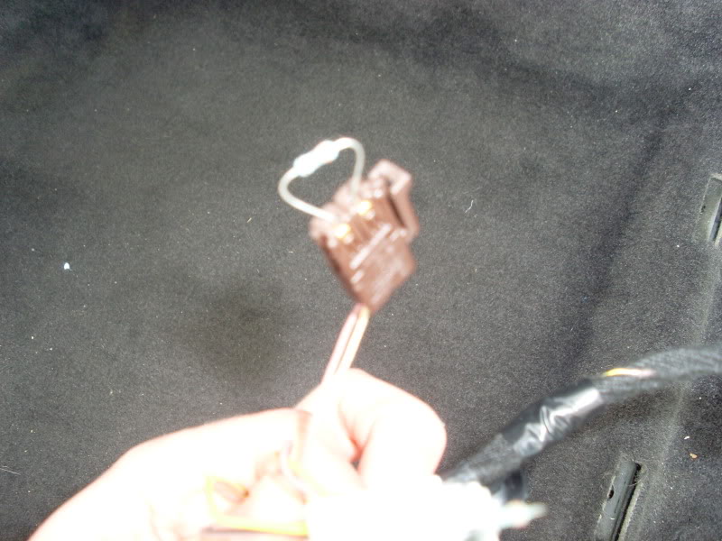

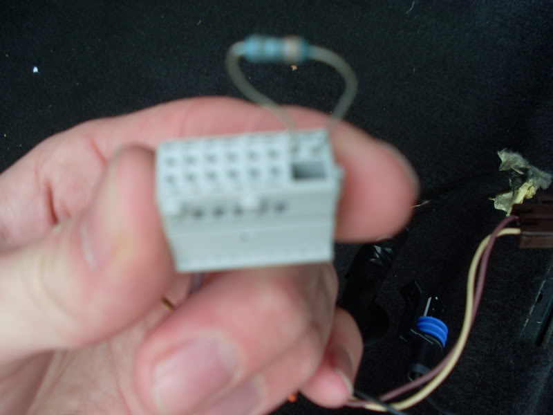

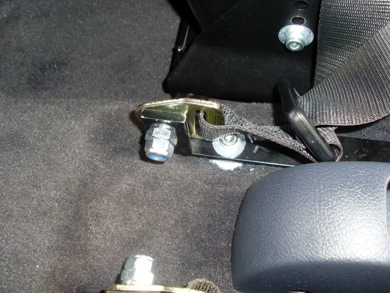

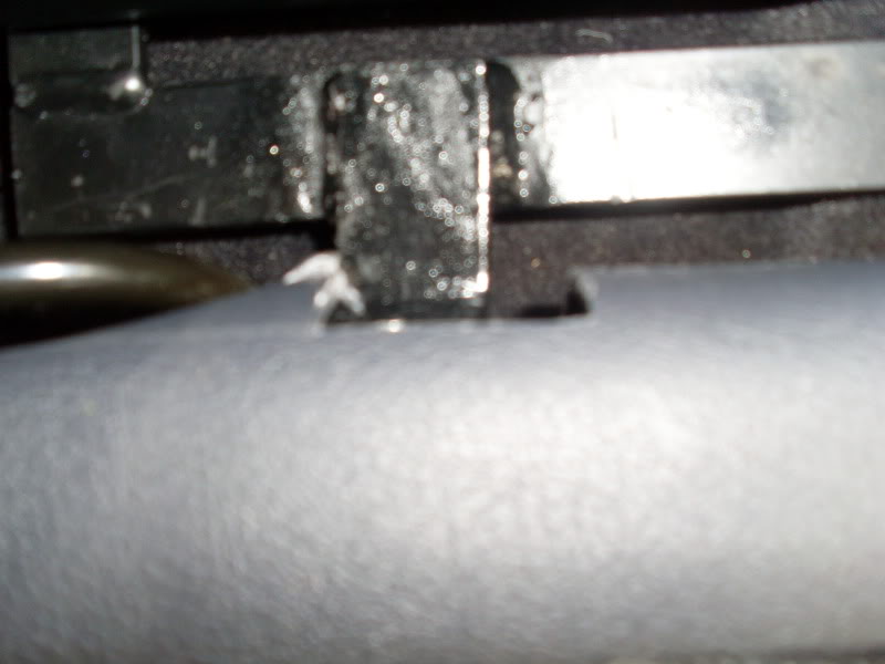

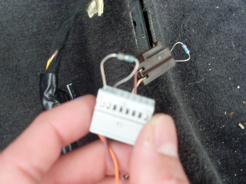

Here's some pics of the resistors and where I put them. I used 3.3 ohm ones bought from Maplin's at a huge 12p each! Not the clearest pics but if you follow edde's guide you can't go to far wrong.
http://www.cliosport.net/forum/showthread.php?t=109205&highlight=airbag

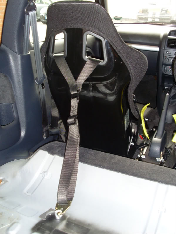

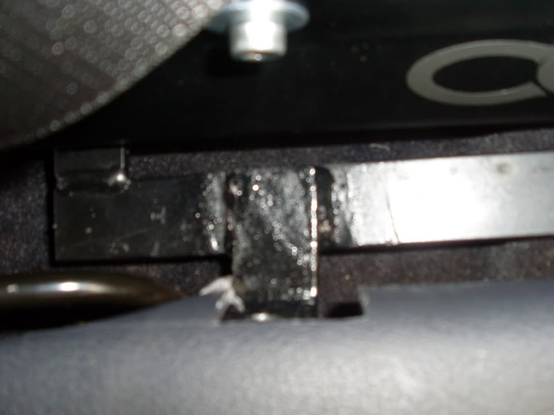

Only thing about the x-low frames is that you have to cut the inner sill to accomodate the outer lug which Cobra assured me they had changed - but they hadn't :(

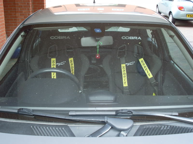

Just need to change my driving style as I can't believe how low and further away from the steering wheel the seat postion is, feels brilliant though! Now looking forward to doing my first track day hopefully at Bedford next month. C&C welcome :)
  rps13
you have faaarrrrr too much interior left in.
get that ridiculous carpet out, those silly door cards and that sound deadening.
seats and sabelts look awesome though, perfect set up.

not my set up no. mine are fixed for one position. cobra do provide you with the runners with the x-low frame but i think you have to buy the adaption plates to allow it to work all together and move back and forth.

cheap 172 15'' track wheels or 2118's if i can stretch to them.

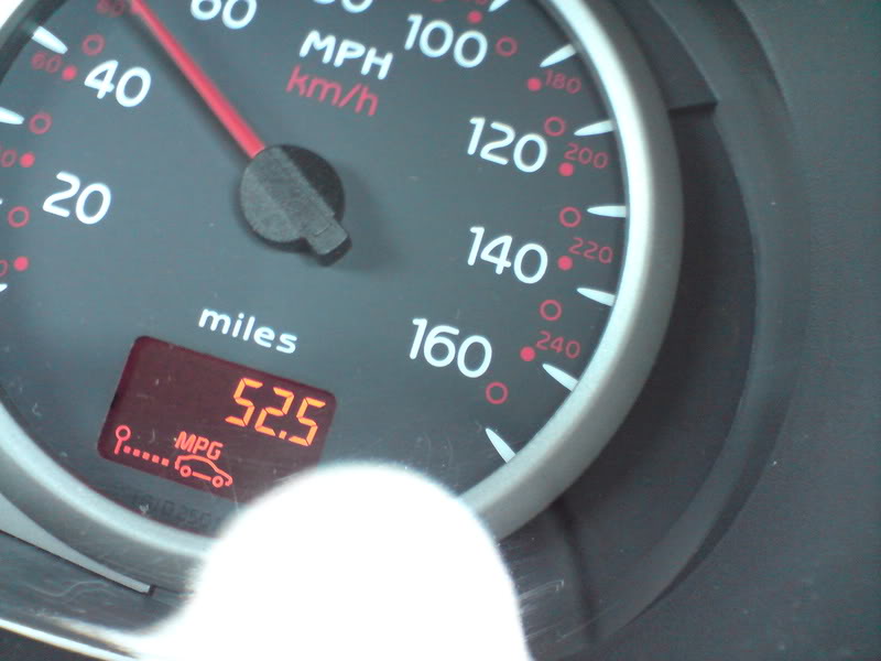

Looking well, What dials have you put in? Look like non sports from the max reading of 140mph & white needles?

  ph2 172 track car
Talking of bolts. did Cobra send you any to attach the frame to the floor?
errr.. no didnt expect them to either. ben_p sent me some bolts to fix the frames to the car and i bought the same ones to attach the side mounts the subframes.
they ones i used are m8 12.9 grade high tensile strength bolts. 50mm in length with a collar on them. did you get your mot issue sorted?

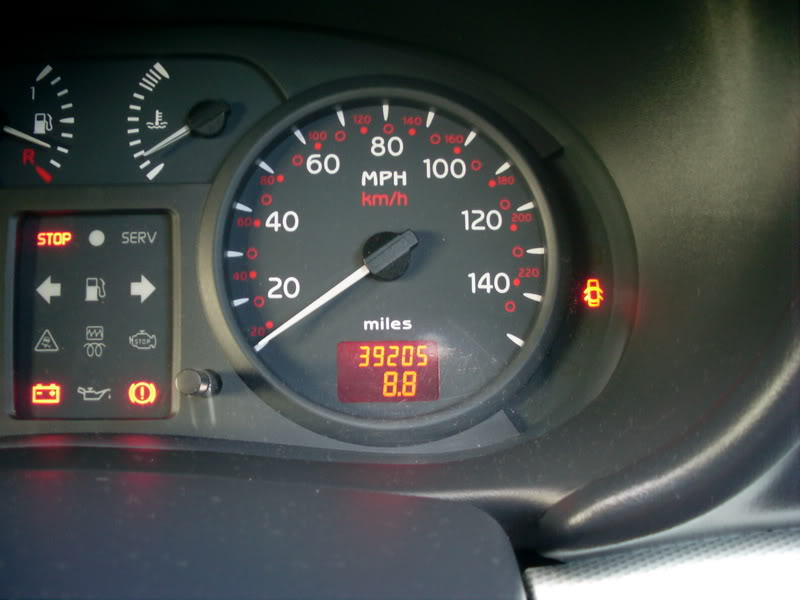

i bought the car like with the dials like that, i thought they were all like that on my model?!
  e92 + E46 M3 + Cup
Check your previous MOT's mate, you may well not have a car thats got 44k, heres a pic of standard MK2 PH2 172
maynard
  ph2 172 track car
yeah ive checked them, all mot's seem to match up. you've put the frighteners on me now.
Not yet, Im trying to get hold of some bolts for the subframe to be attached to the car. It's proving difficuilt! I need the m8 high tensile ones like you have. Orderd some off ebay but they are only threaded half way. so no good.

Sorry dude, Is important though for keeping track of cambelt/aux changing, last thing you want is that going because you "thought" it was good for another 20k, could be just that the standards failed though :)
you need a good bolt place, or try a local engineering shop. they should be able to help as long as you ask for what i described above.
well i've just checked all past mot's matching them from my receipts from before i bought the car to the mot vosa database online. all seems ok.
also have invoices for past work including the cambelt/aux change too. so everything seems ok there too.
apparently my car maybe an import so that maybe why the clocks are different, possibly but im happy all my details seem ok.

I spotted that from the first picture. Renault parts bin comes to the rescue.

only thing i can put it down too, never mind eh!

Dont worry about the dails matey the car is an import and came like that adds weight anyway ;) lol, certain looking very different now from when i had it, lol, from a car that never really got thrash to a stripped out racer, lol
