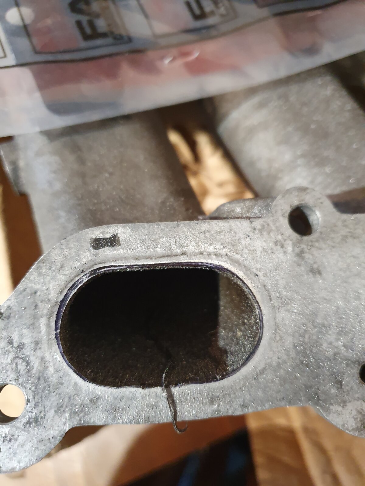

I know there are several threads on this and I have looked though them.
However I am in the process of matching my inlets and have done the ports that meet the head.... took a while!
Now I've matched up the ports between the top and lower inlet and they seem pretty well matched already. Also i noticed they are almost the size of the gasket from factory.
Therefore is it worth touching these as you'd only make them 1mm big max. Only other thought was to open them up and make a gasket to suit.
Pen mark below is the size of the metal gasket

Still looking at other matched inlets from specialist and it looks like they have taken lots of material off the ports, but then surely the metal gasket then becomes the restriction...

you don't need to open them up as match them. ideally you'd sort both faces out and run without a gasket.
