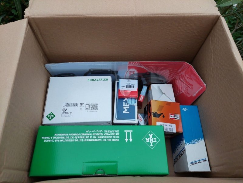

Parts bought

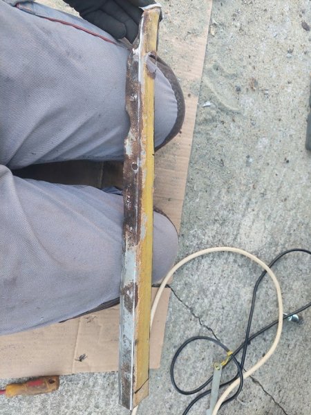

Rear subframe bar

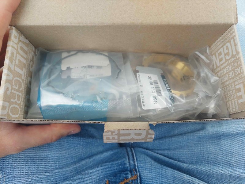

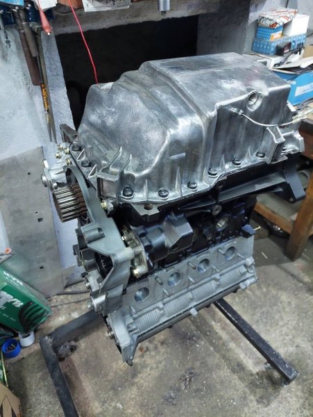

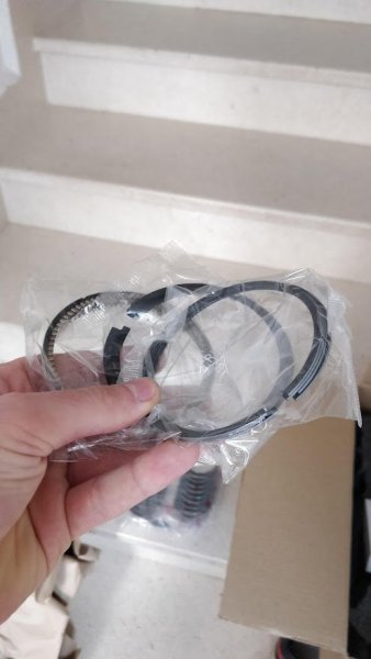

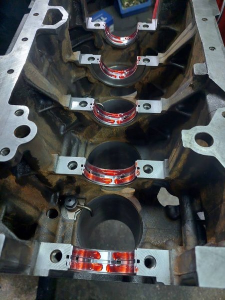

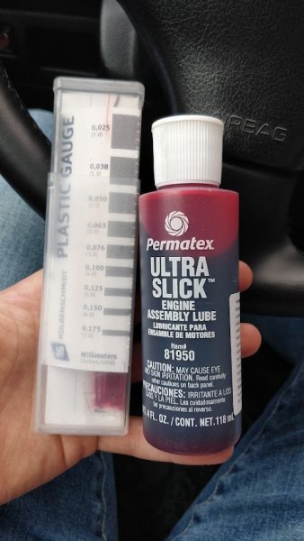

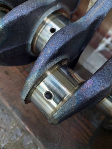

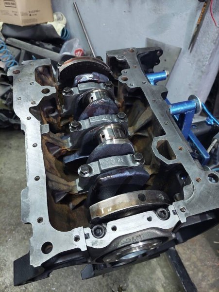

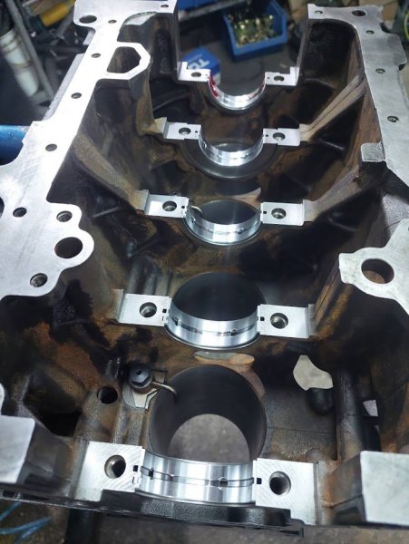

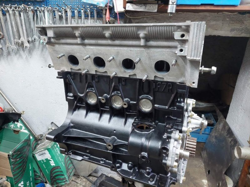

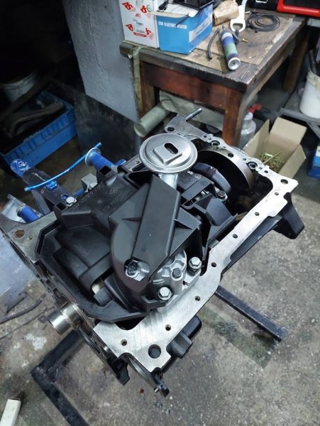

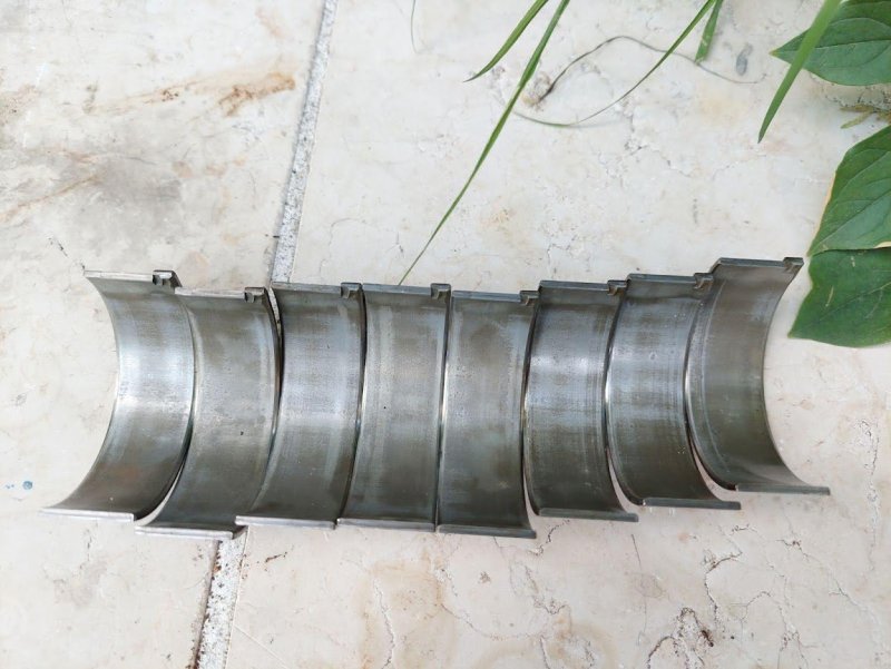

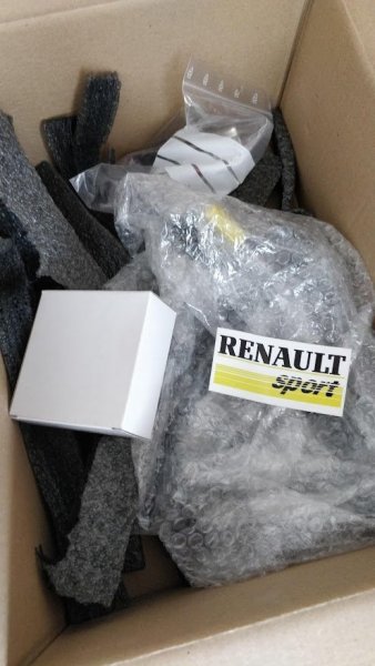

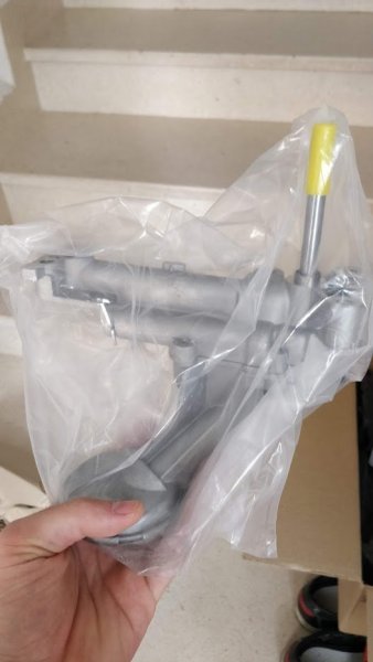

oil pump & bearings & rings bought from France

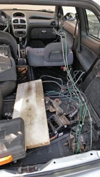

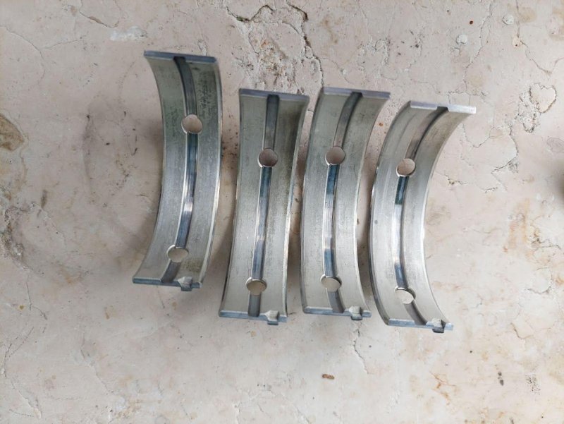

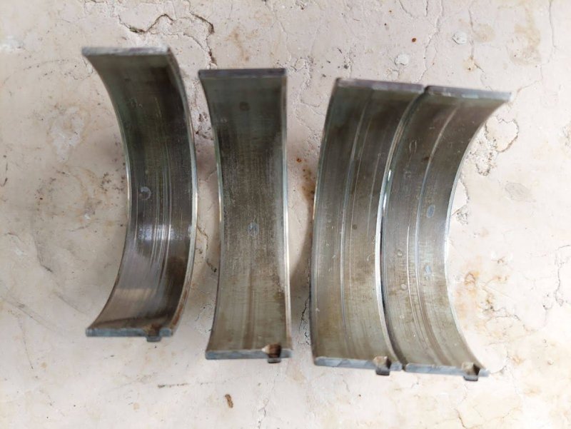

Beaaring that were taken out

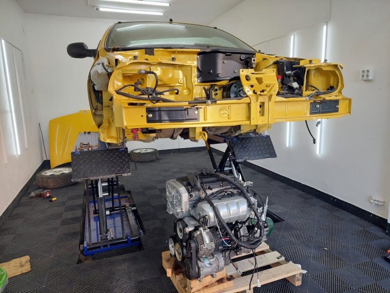

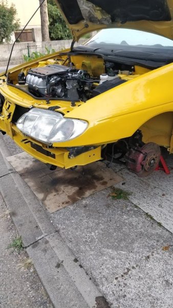

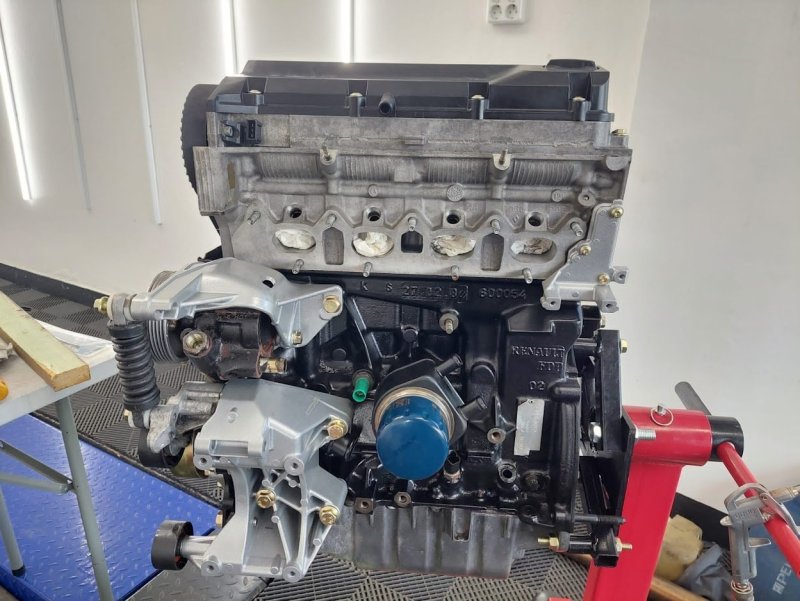

Gearbox overhauled, bought 2 jc5 gearbox for spare parts

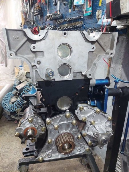

diff plate installed

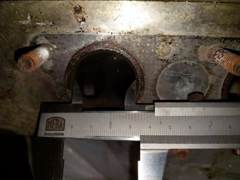

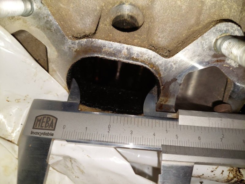

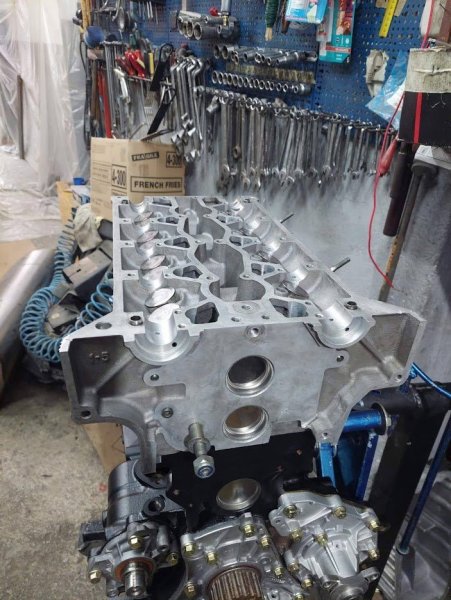

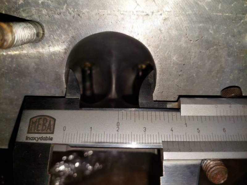

And head comparation, oem vs ported
In the mean time, went for some parts shopping, full inox exhaust, 2-1 exhaust section that was custom made, that OEM section is fully restrictive

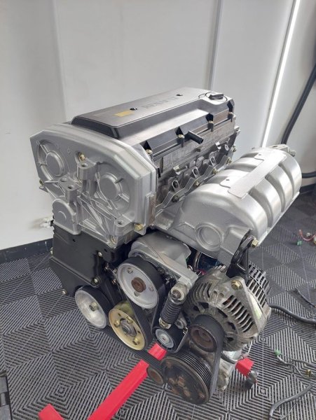

F7R from that guy sitting in a barn.. he also has megane maxi that he's build long time ago, but he's not using it..

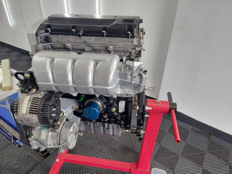

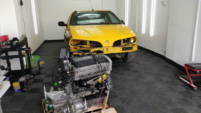

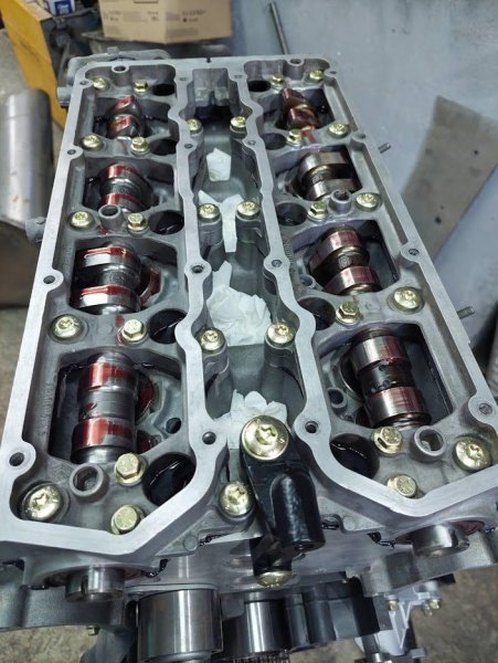

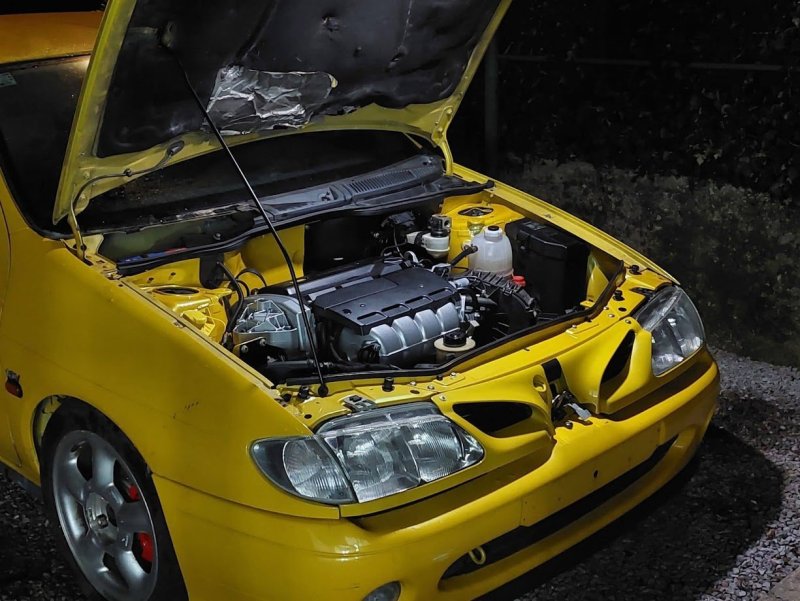

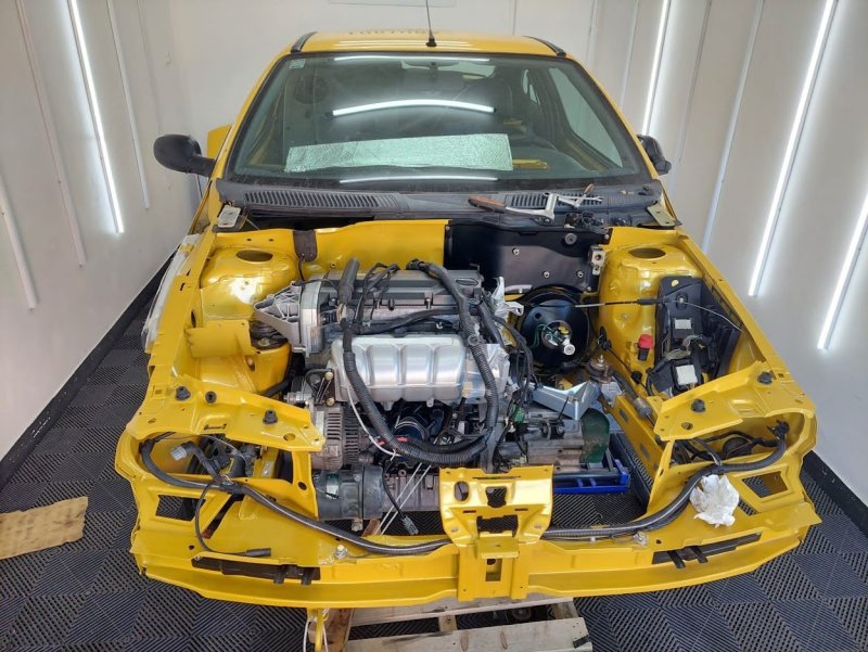

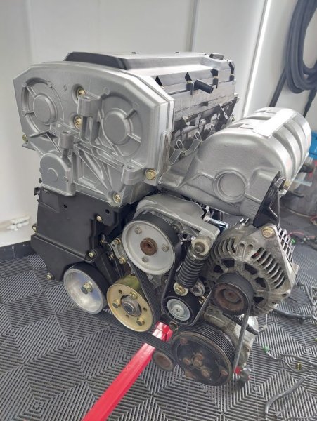

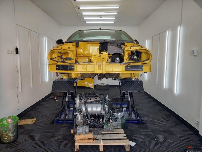

And assembly time for engine bay!!
In the meantime, moved my car to my buddys garage, big thanks to him, this couldnt be done without my friends.

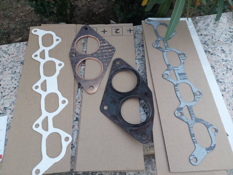

Made new custom gasket for exhaust manifold, and ptfe intake gasket

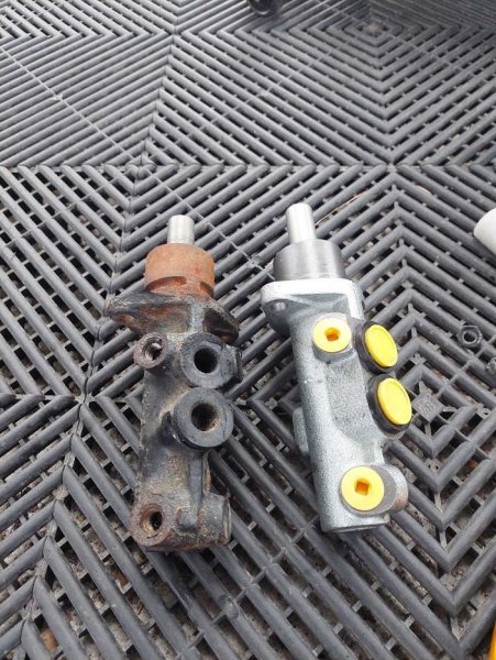

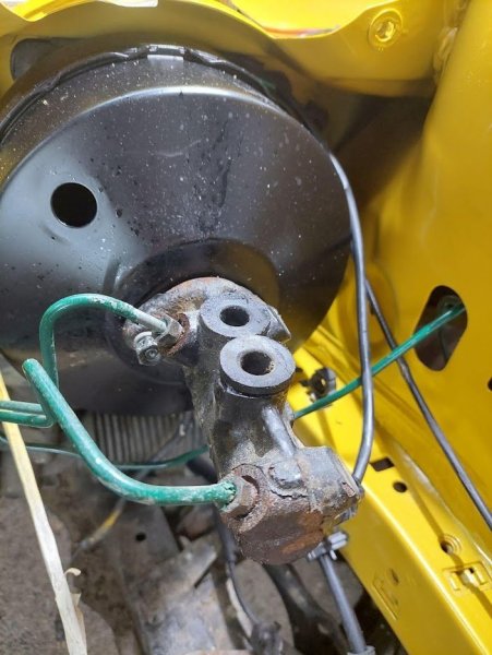

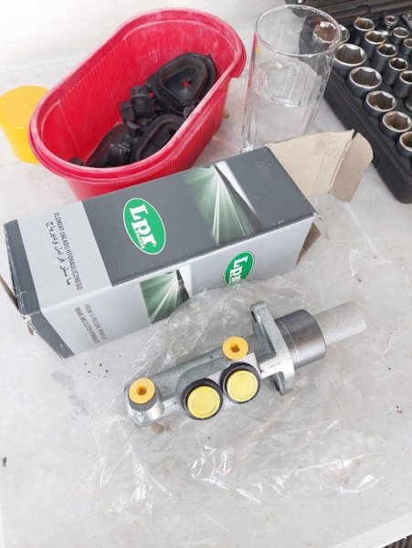

New master cylidner

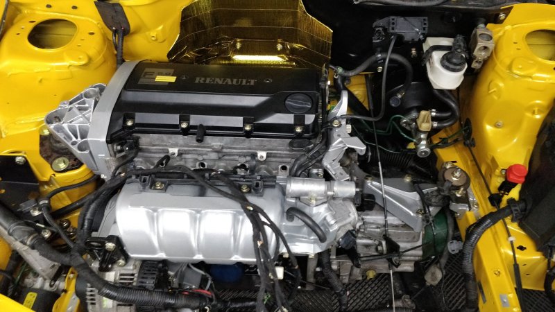

Time to put it all back togeather

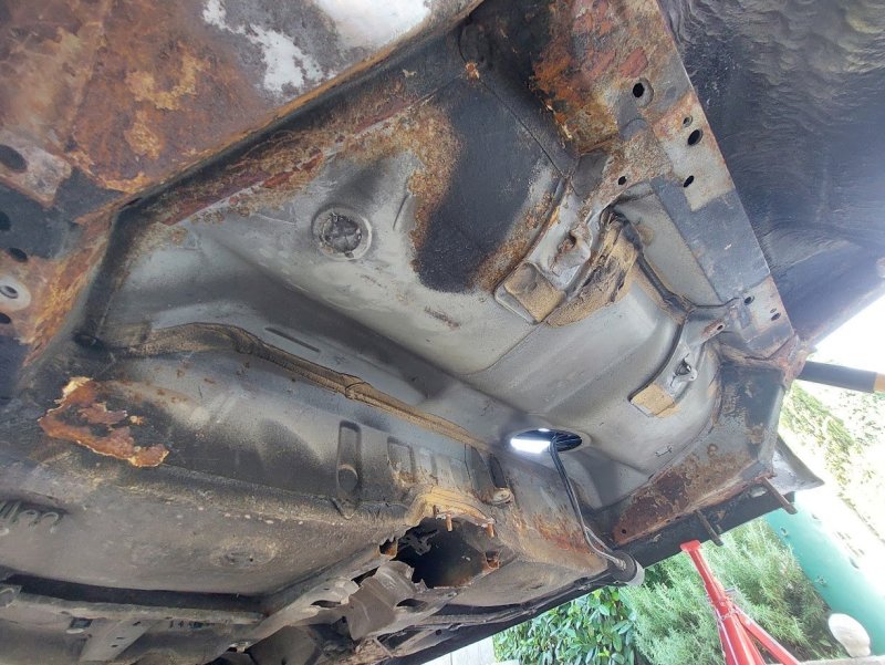

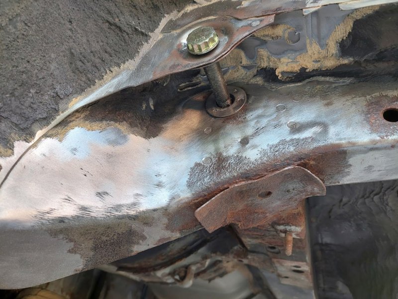

Well, my smart ass didnt look at the sills, at the rear end etc, but you will see everything as you go throught the topic..

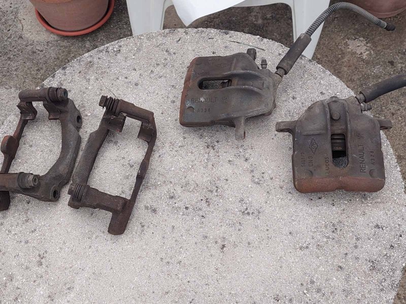

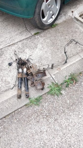

So, everything on this, regarding the underside was rusted and non functional, ripped everything apart
And took everything from my 5door

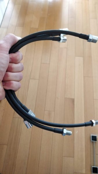

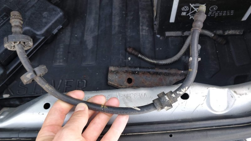

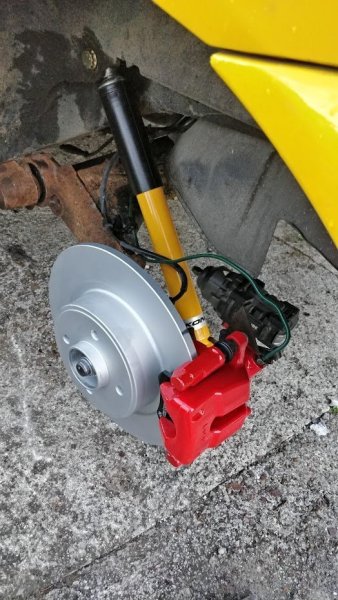

Custom steel brake hoses

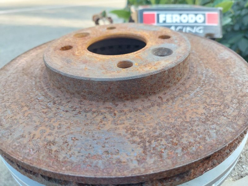

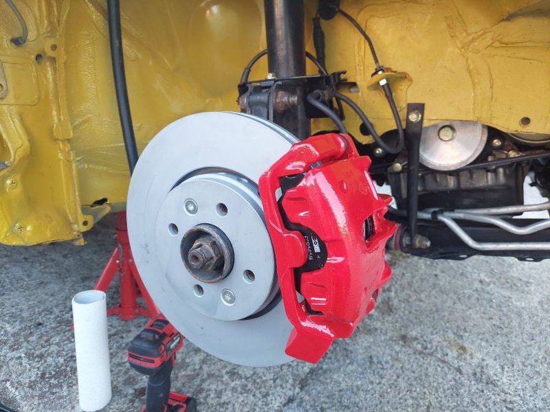

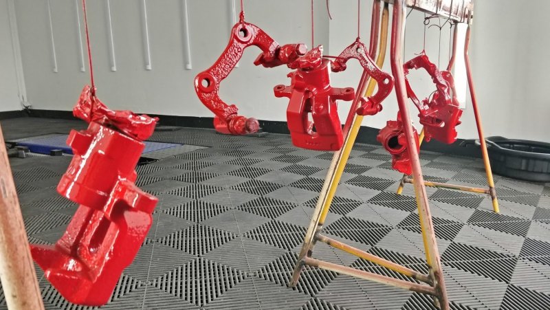

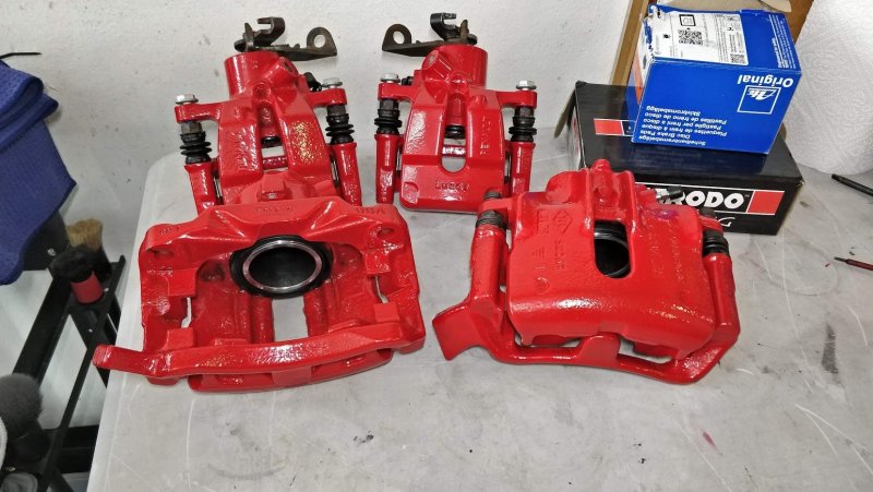

Brake's rebuild and painted
For the pads, went with ds 1.11 at front and regular ate at back

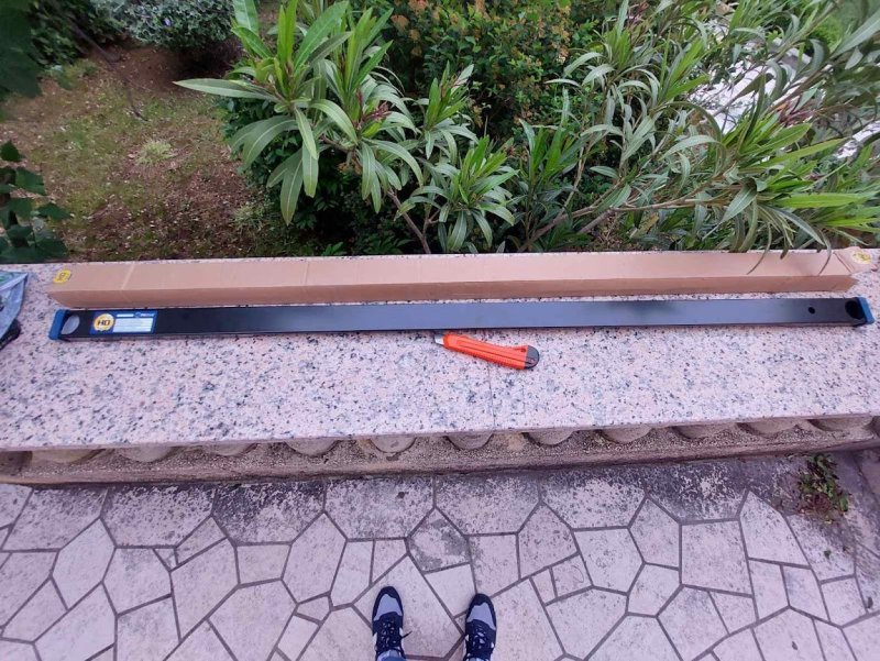

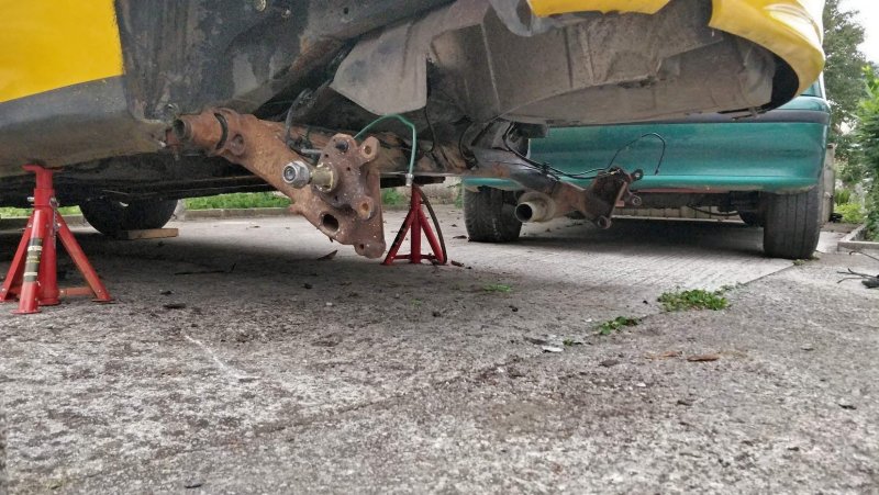

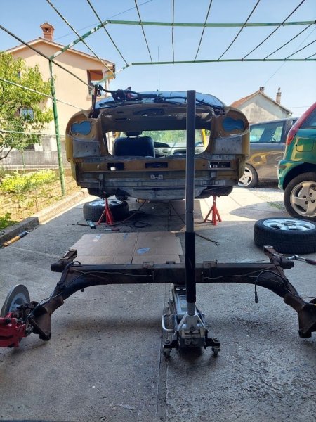

Regarding the rear subframe, oem is quite narrow, popular mod is to put scenic axle to get +6 cm ( 3cm on each side), and I bought used scenic rear axle.
With that axle, you have completely different brake system, the more modern one, like on cs197 and all modern renaults ( where the handbrake actually does something)
New discs

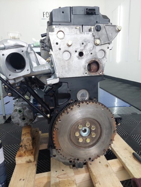

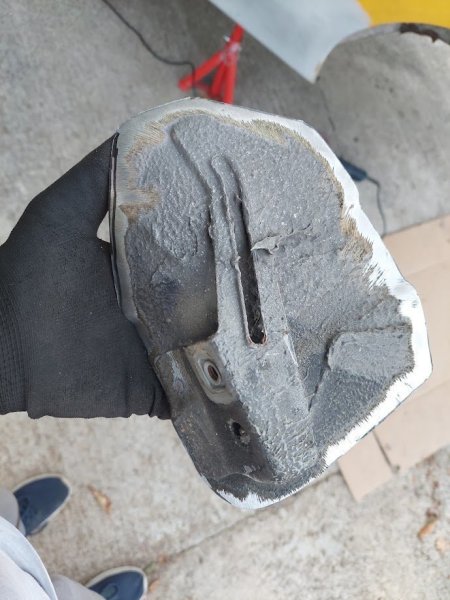

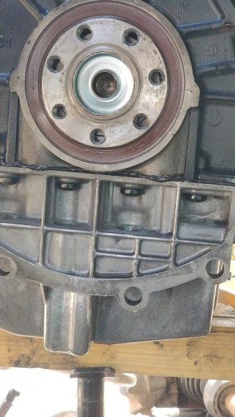

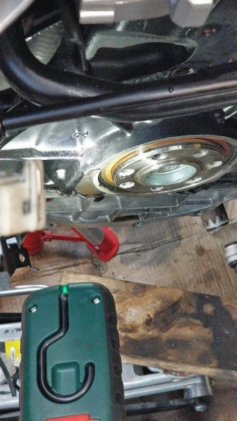

What I didnt mention, when we started the car, it had a leak, from crank seal ( flywheel side ) and it was quite bad.
To change it you need to remove the exhaust manifold, subframe, gearbox, flywheel etc.. so not quite a fun job..
Left it with new seal till next morning, and once upon arrival it was a bit oily, but I said to my self, meh, it's just from before
Assembled everything back togeather
1st start
aaaaannnndd it's leaking again.. ever more than last time... sigh..
1st it was mounted like this, I think too much on the inside
2nd seal was mounted so that is sits flush with the block.. but on the crank you can feel the lip.. still didnt touch that to this day.

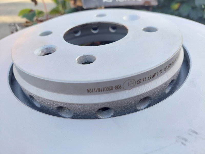

My stupid ass found out that I've painted the wrong front calipers..
Brakes on Megane came in 2 versions ( on 16v), in 262mm and 280mm. I knew that on my (5door) there were 262mm discs and calipers, but somehow i measured that original brakes from the yellow one are 280mm.. yep.. they weren't.. also 262..
So once again,dissasemble the fresh painted and rebuild ones, paint other calipers for 280mm, and rebuild them

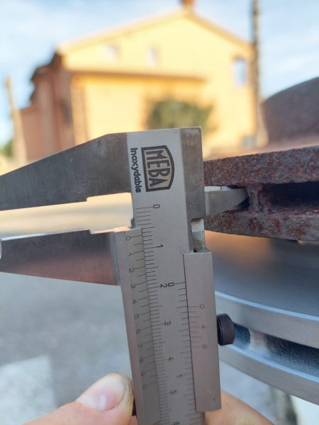

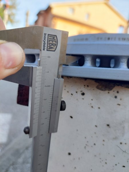

Sorted that, and little upgrade for brake dics, from captur, they have bigger spacing between the discs, and also more wholes for cooling in the middle.
This was tested by a friend, almost 100C difference in disc temp after hard braking if I remember correctly

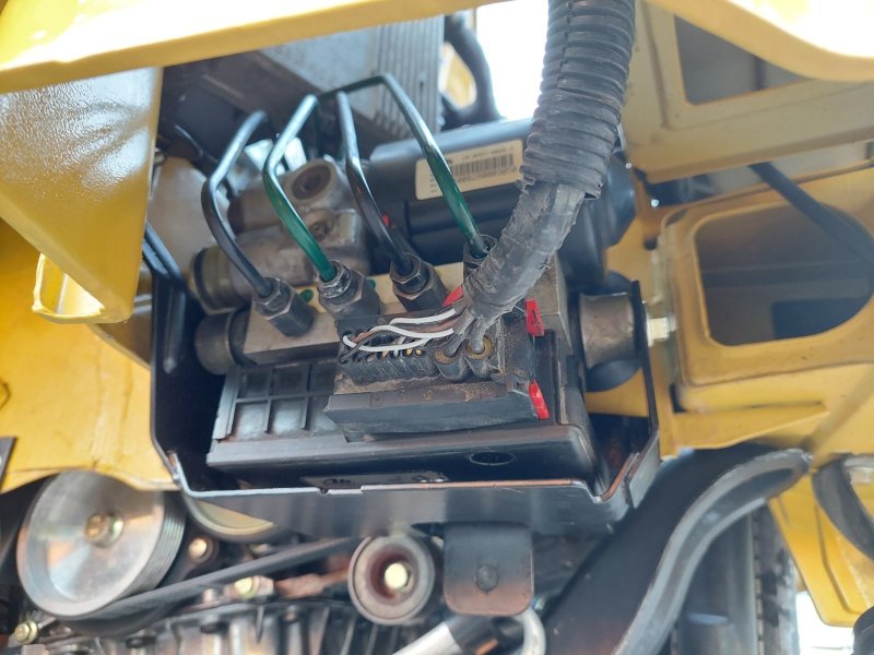

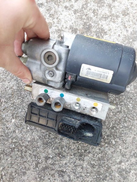

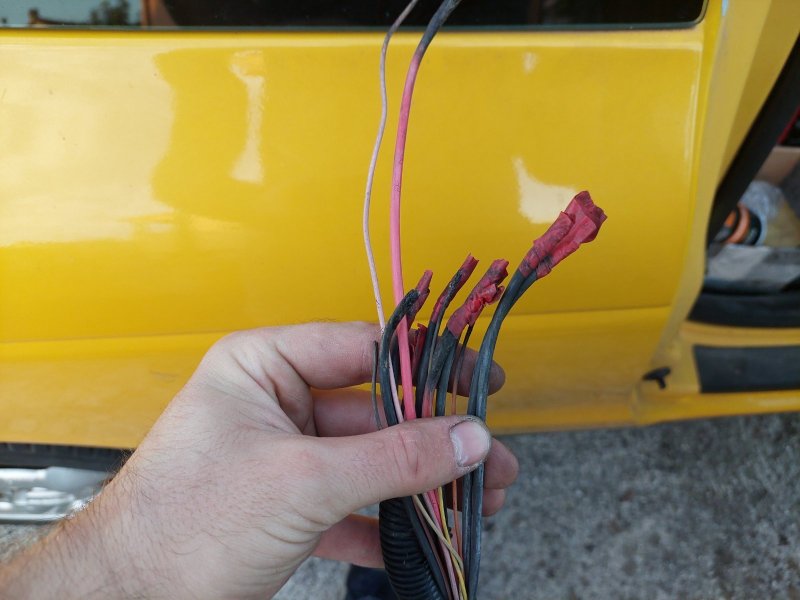

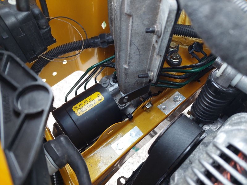

Next on the list was ABS. I presume at some point in the life of this megane, this catched on fire
So once again, parts were taken from 5door donor

I didnt really care that the engine was only run at the spot ( for many hours ) but not driven. a freshly built engine.

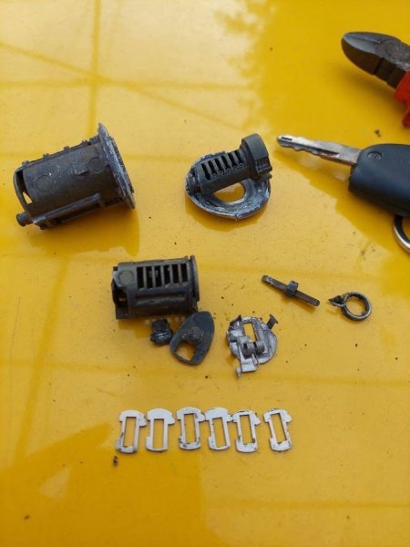

The drivers door lock wasnt working, it was turning in circles, so dissasembled that and took a look, I couldnt figure it out, thought it was more complex then it was and could get it to work, but friend helped me, actually it's really simple, but sometimes you just dont see it

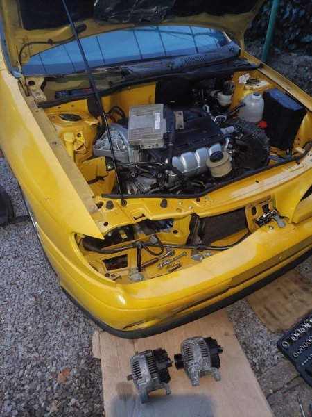

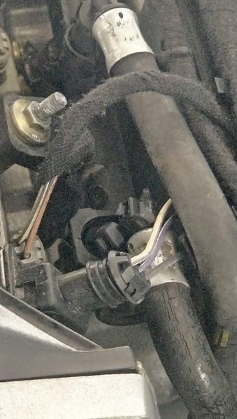

Had a big problem for radiator fan not kicking in, replaced the switch, resistor, everything, in the end it was bad plug and just not bled good.

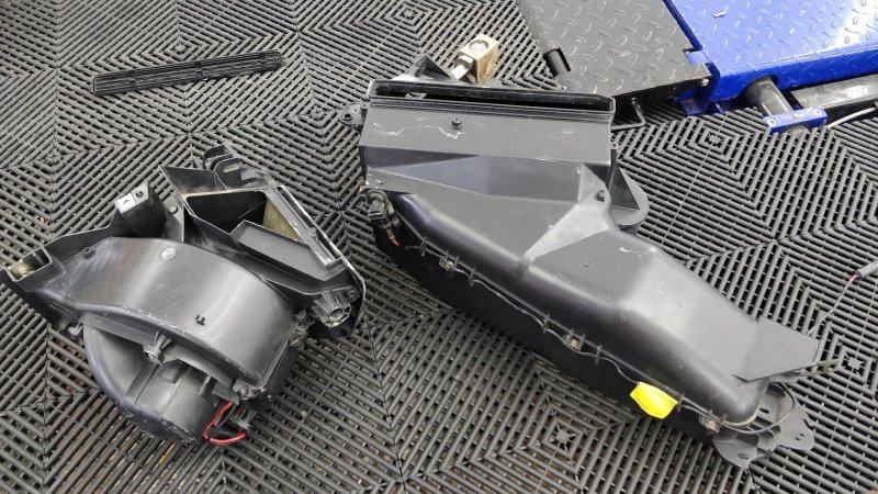

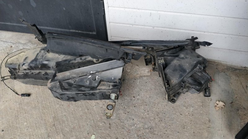

Water from rain was getting into the cabin, sealing the ventilation box is quite tricky, I did it on my 5 door, but couldnt succed here, althought I tried 2 times, still didnt solve it. Just need to give it one more proper go with a sealer.

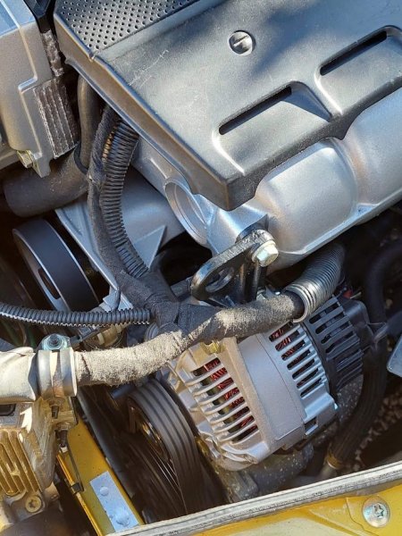

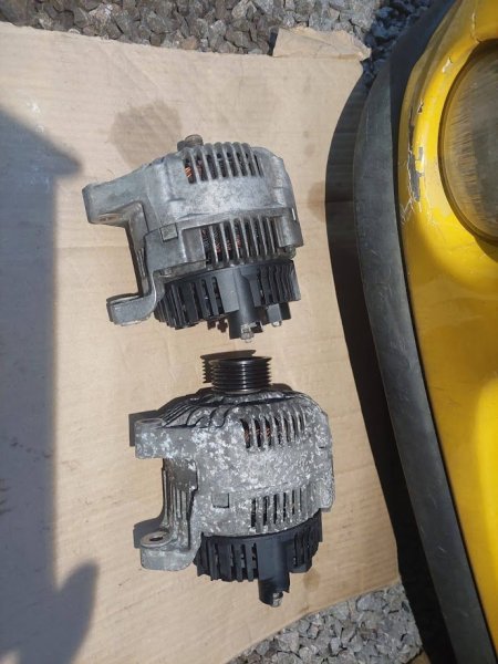

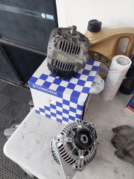

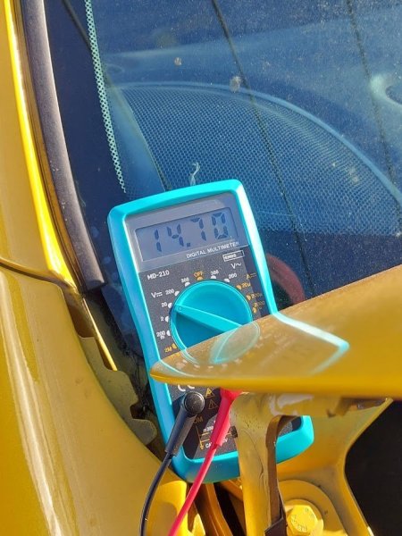

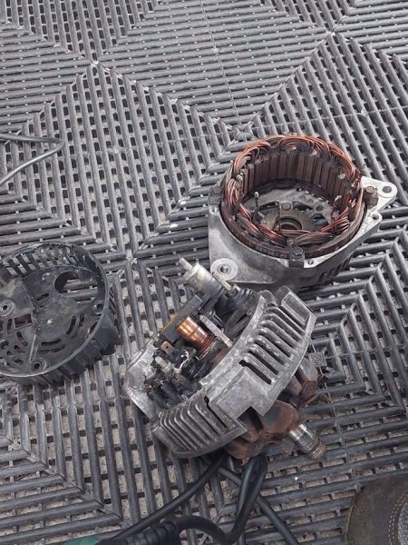

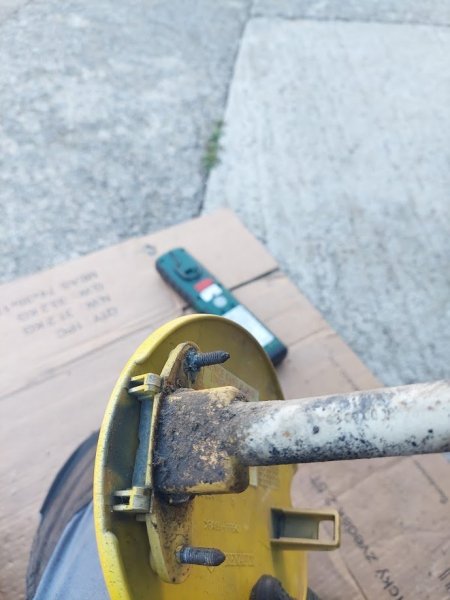

Then out of nowhere, the alternator stopped charging, but it was charging before.. the car died while working, because it consumed the battery.
And then the testing, I had another alternator but also it's not working, we almost took them both apart, wondering what's wrong, it cant go bad in such a short time.
Ok, went and bought a new one
Installed it, and also it wasn't working.. I was breaking my head for few days, googling, and thanks to forums, to be precise, thanks to cliosport.net there was a guy that had the same issue but with a clio!

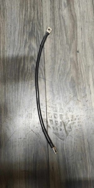

So, what happened, i powder coated the mount for auxilary. And the alternator get's it's ground through that, so basically somehow it worked for a good time, until it decided not to work anymore.
I didnt feel like dissasemblyng everything, so my friend made me a ground cable, and once i put that in place, voila!
That was a relief..

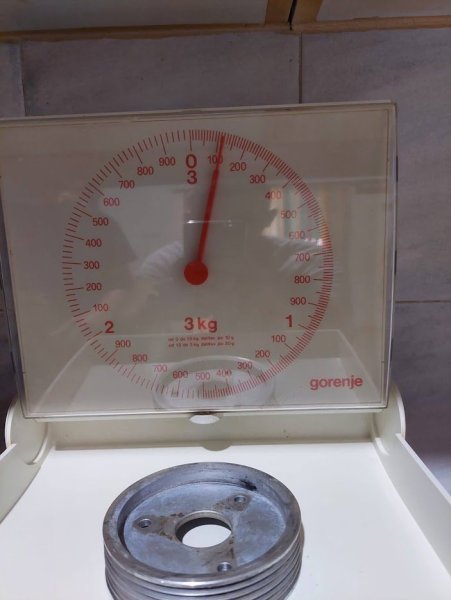

Pulley replaced

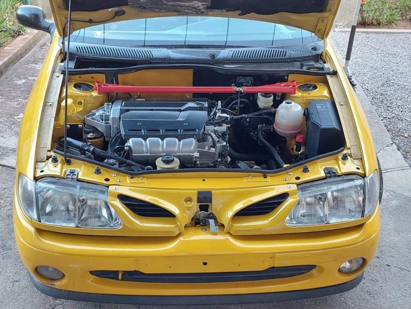

Although it hasnt been washed for few years, it looks clean(ish) and really mean. I do love the front end on this thing.

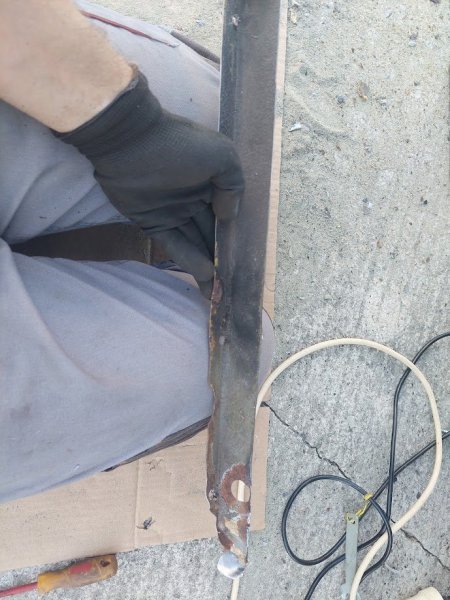

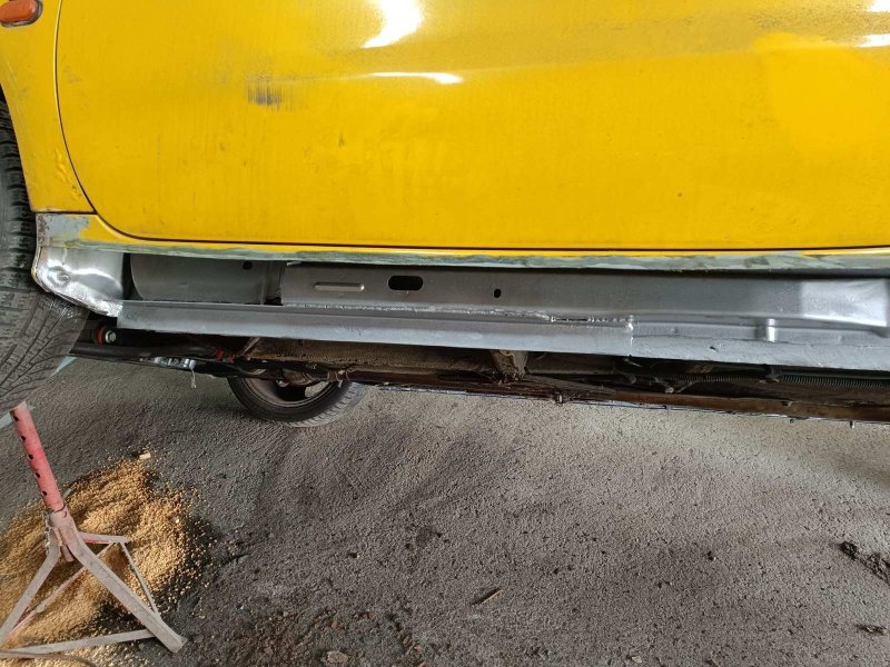

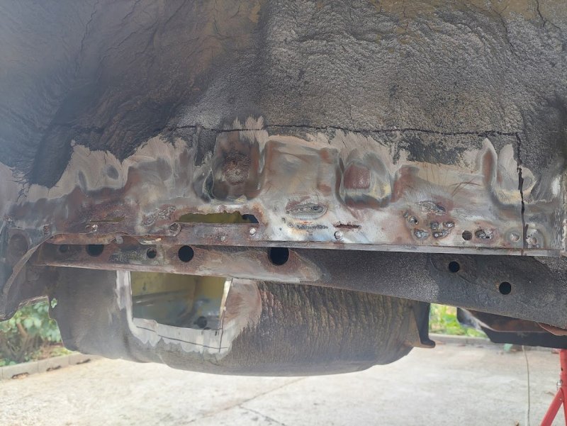

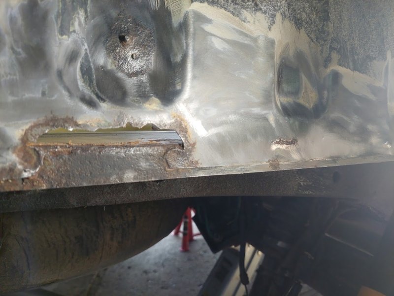

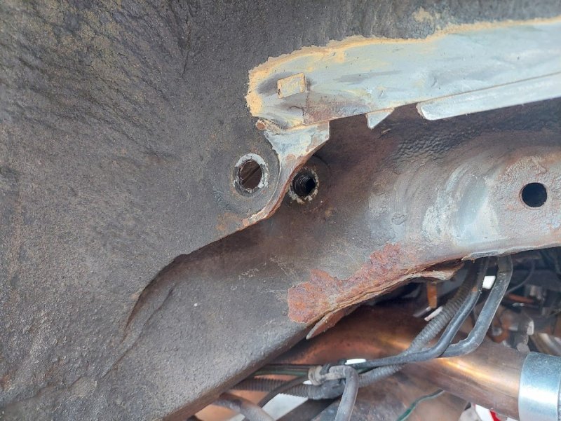

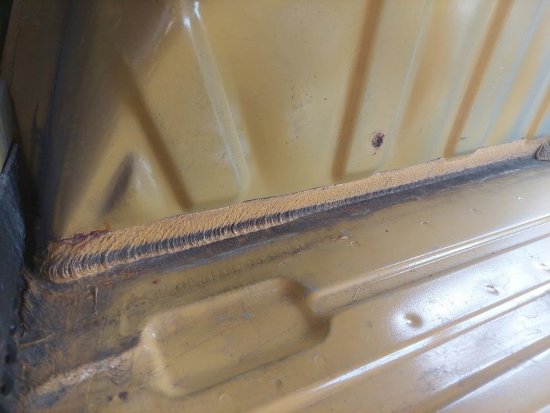

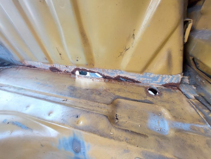

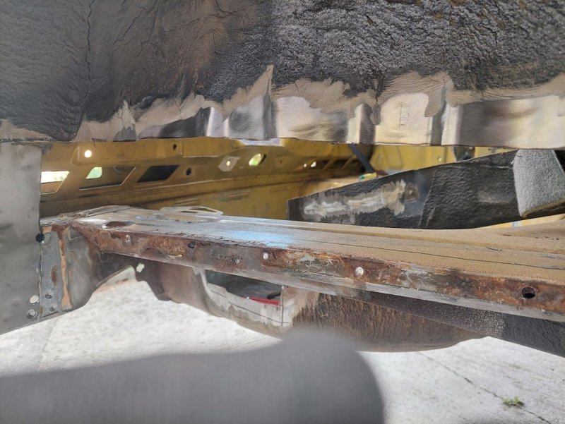

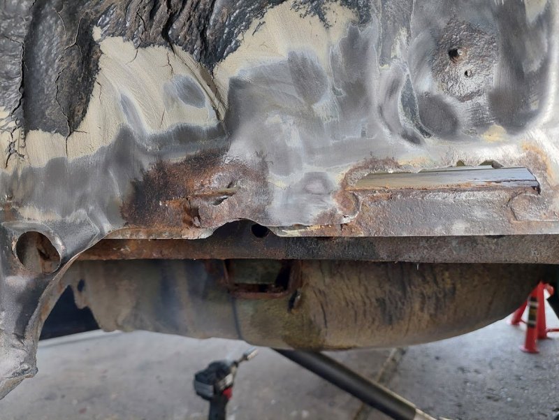

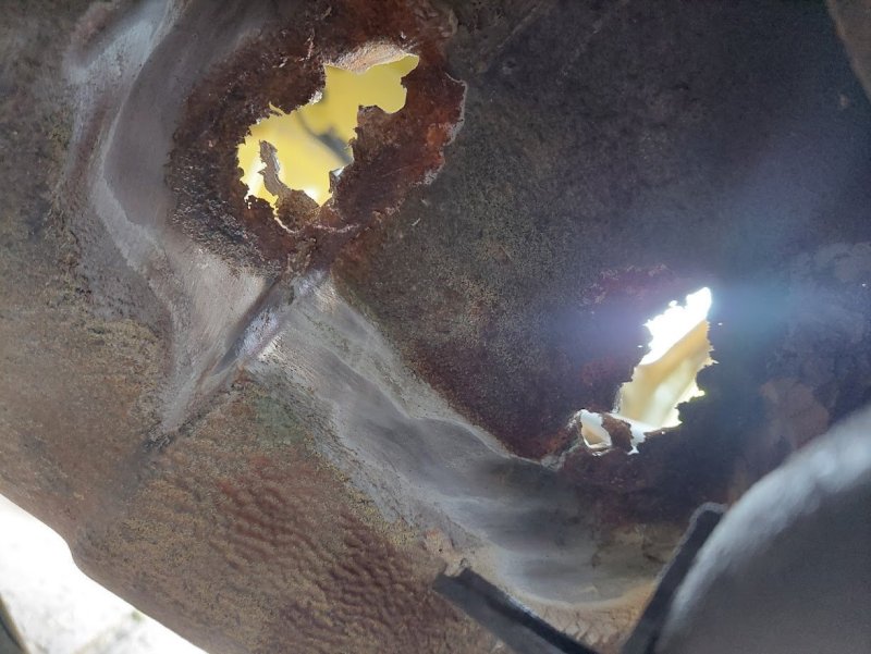

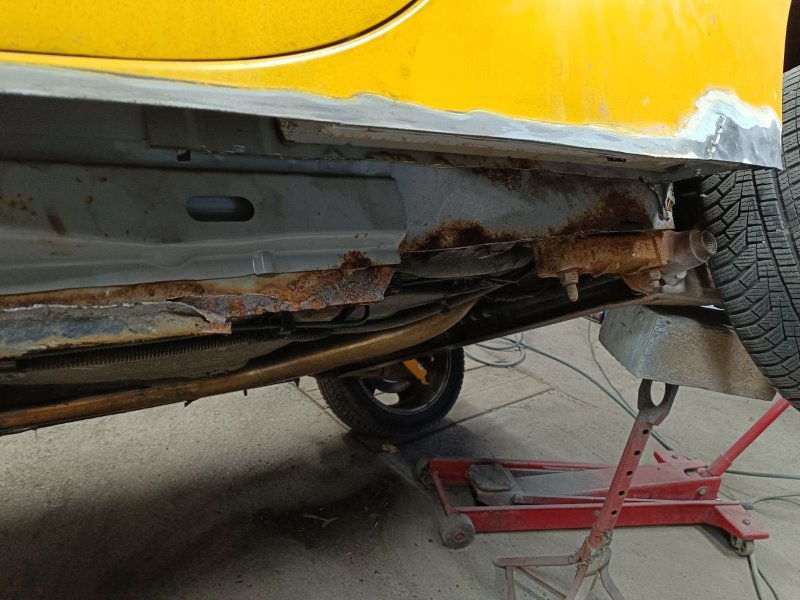

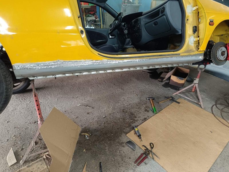

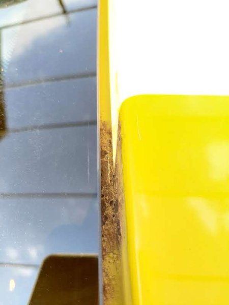

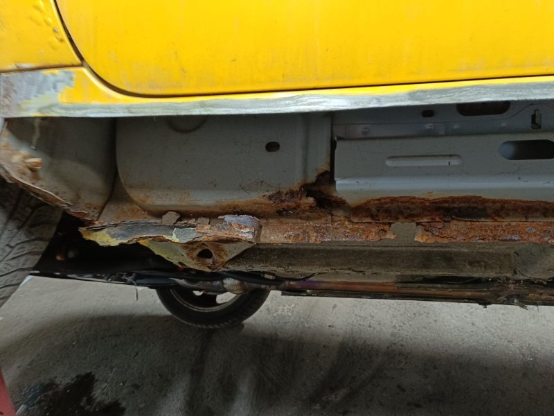

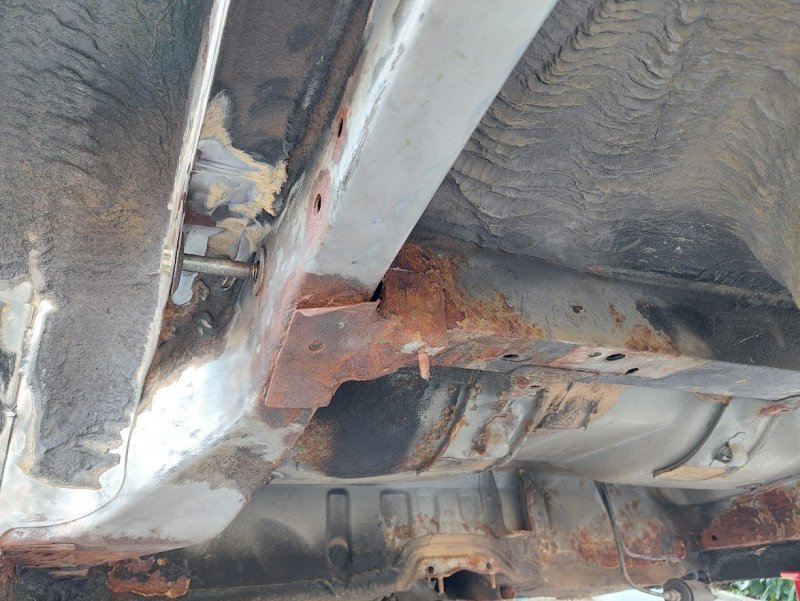

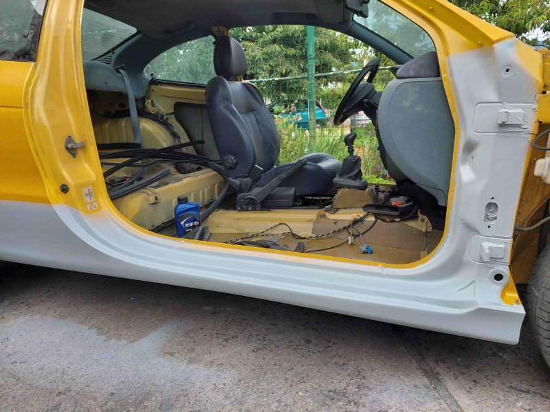

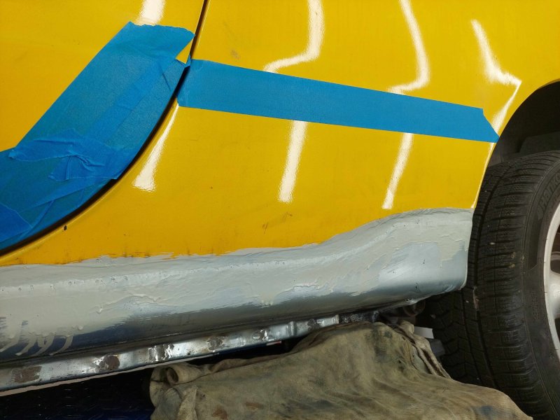

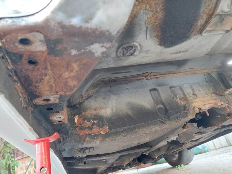

The next step was getting the sills done, they were really, really bad.. Couldnt jack up the car..
This time I took it to different guy, he really is an oldschool guy, knows his job, but like all of them, he takes his time..
5/2024

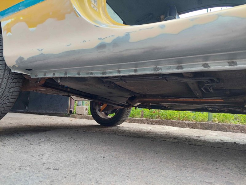

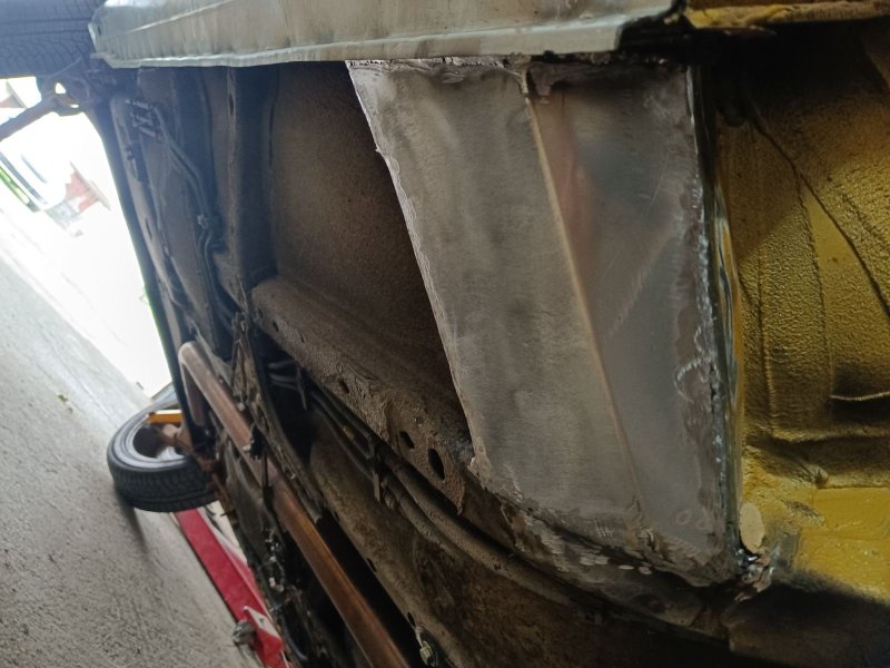

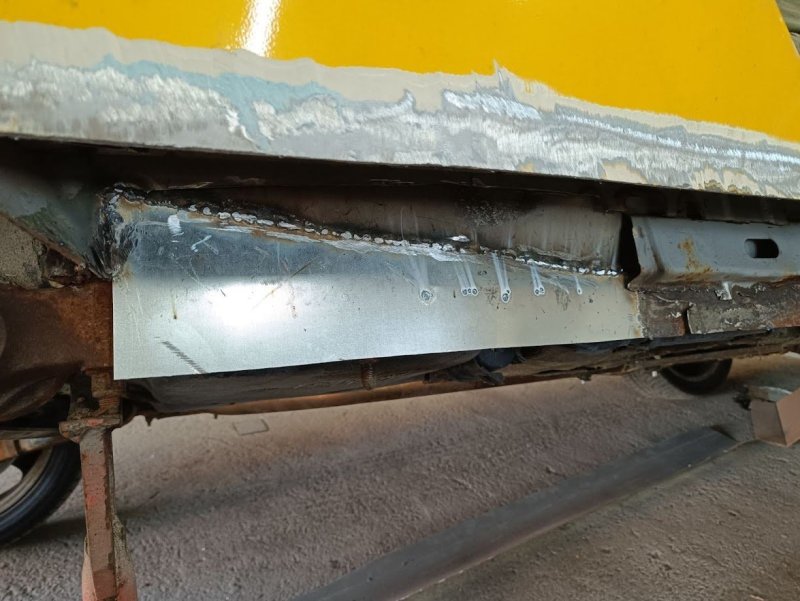

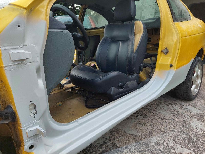

It took only 4 month to replace the sills and few more bits, here are the photos
Pickup time, luckly the car was on dry the whole time, it was outside only for me to pick it up

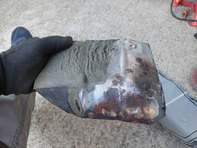

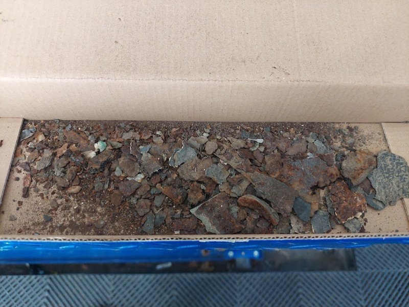

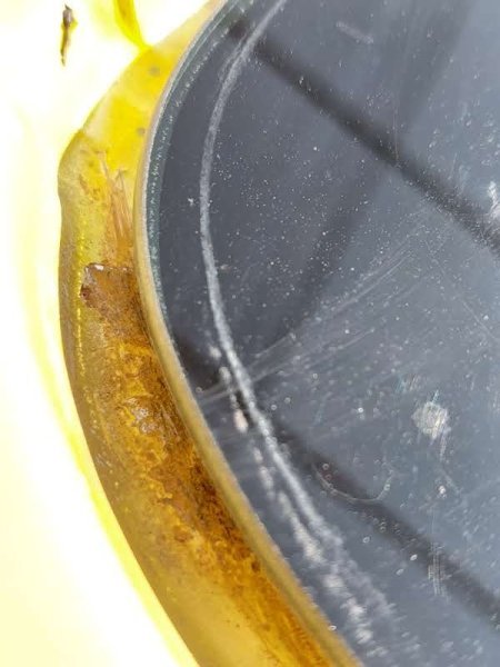

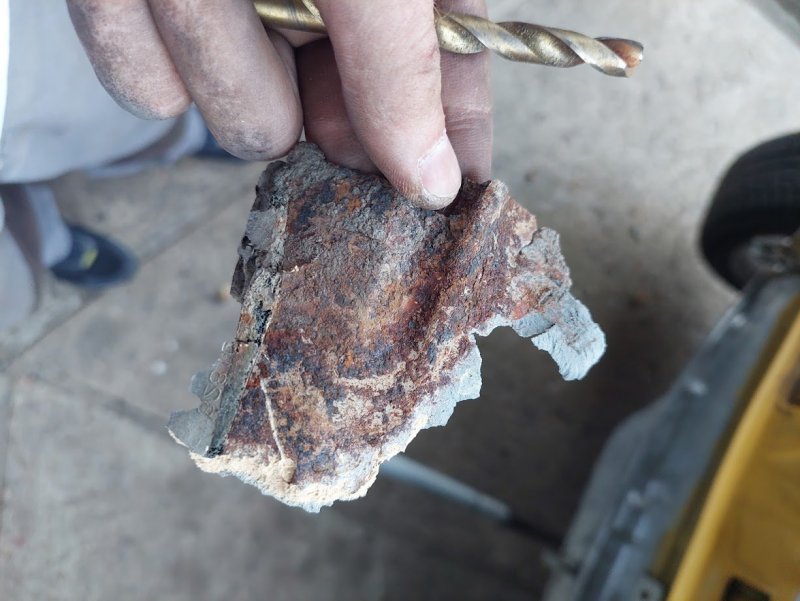

Did I say the sills were bad?

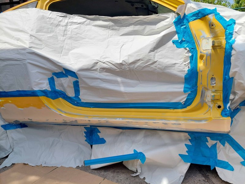

Went with epoxy primer over it, just so it doesent rust, as I couldnt get my hands to work on the car.

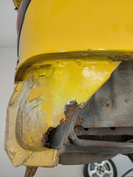

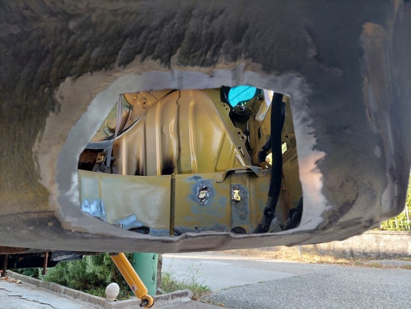

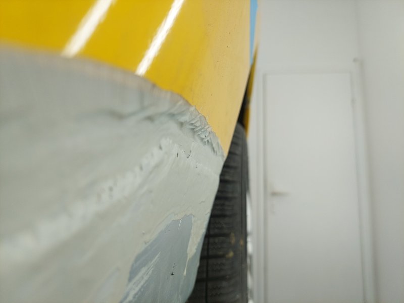

Oh, I didnt say this. The previous owner ( the young one, that had the car painted ) sad the body was done and everything was ok. Mhm, i'll let you take a look for yourself
Thats like 0.5-1 cm of filler. Somebody did the arches as they were also rotten, but got carried away with the filler..
Just to clarify, this was never a project to make a perfect car, but to make a fun, fast F7R that i can drive on the street but also go on track and competition with, so I always told to myself, oh cmnon, it's a track focused car, it doesent needs to be perfect, so I didnt try to fix the bad arches..

Ready for primer sealer

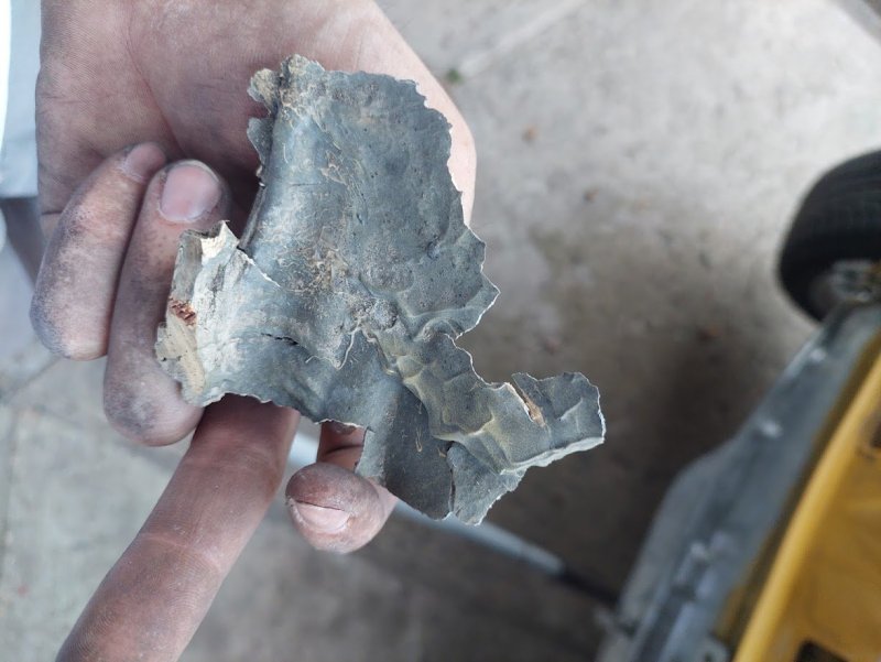

Syncro kit for jc5 ( its for jc5, but 1st and 2nd gear are not "double" like at later jc5, for example 089, this fits for jc5 053 ( megane one ))

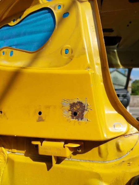

So I went with sanding all the car, to have it fully painted, and so I sanded and sanded and sanded....

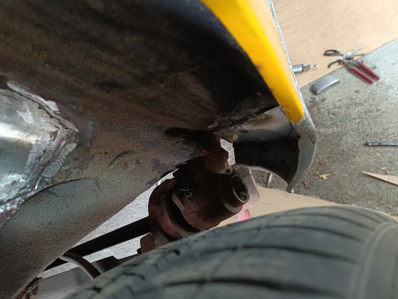

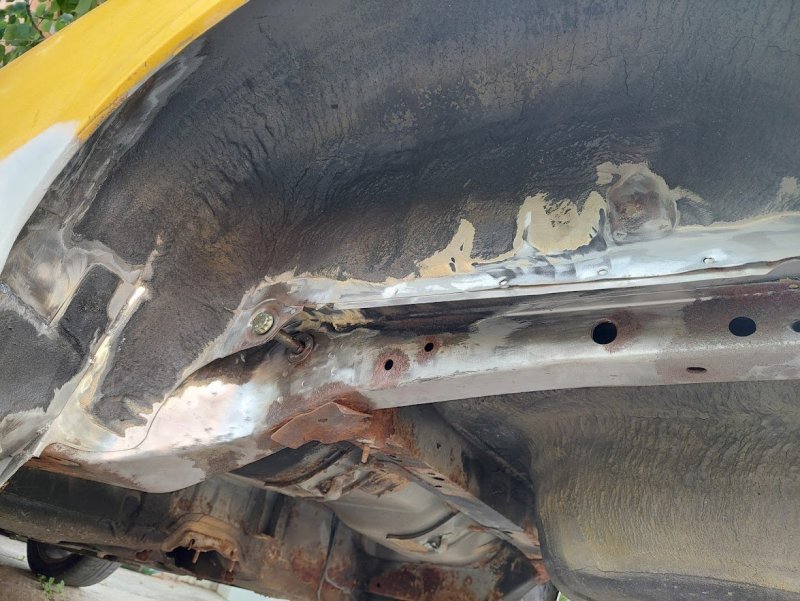

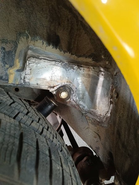

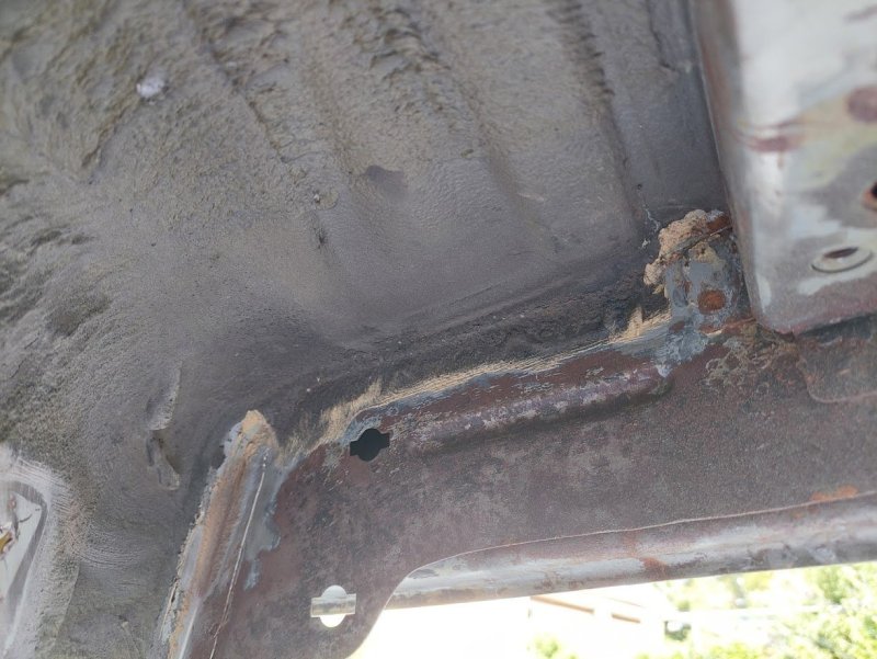

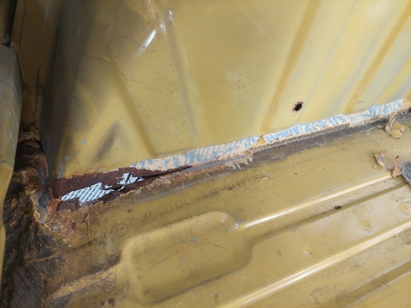

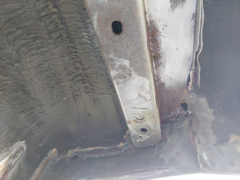

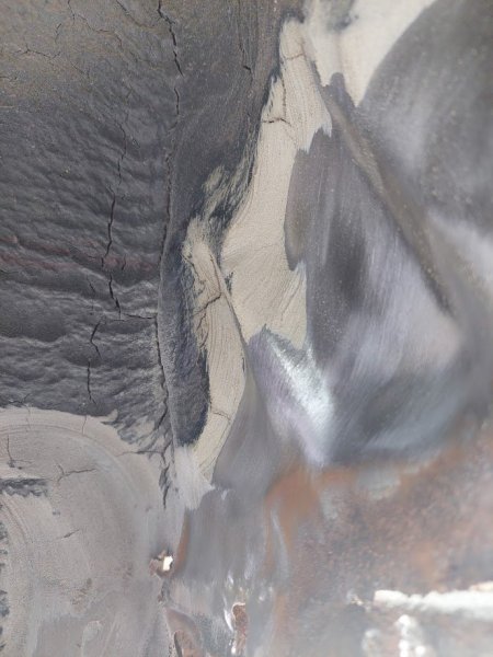

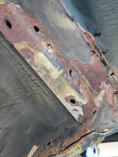

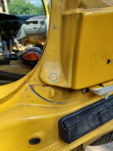

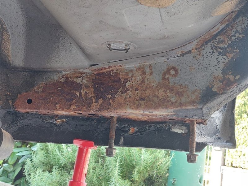

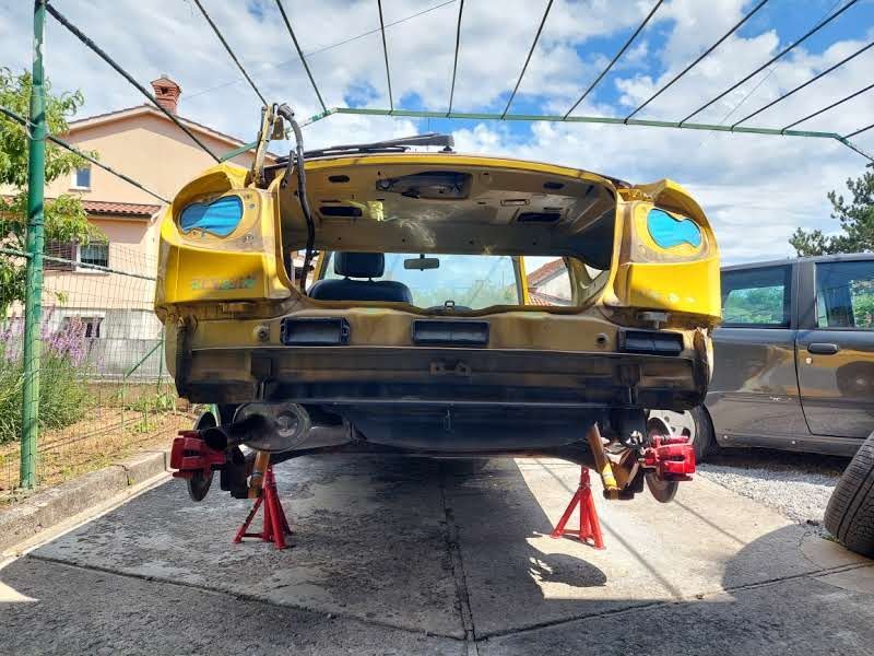

Remember what I've said that I didnt look the rest of the car when sitting on that garage floor?

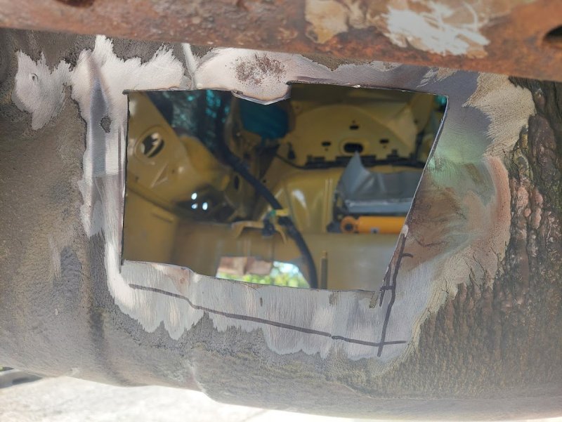

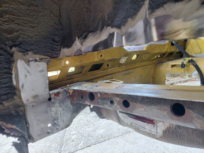

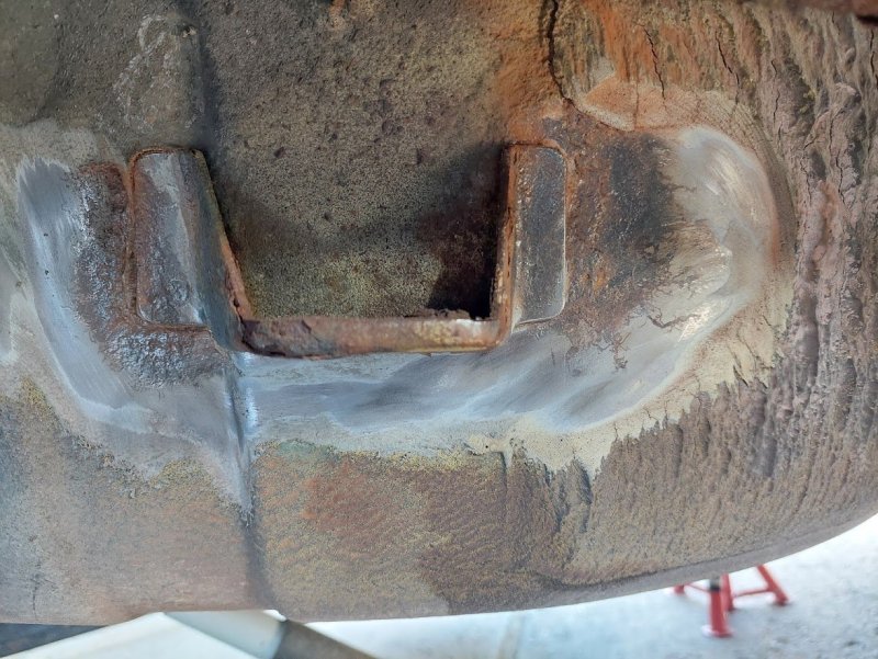

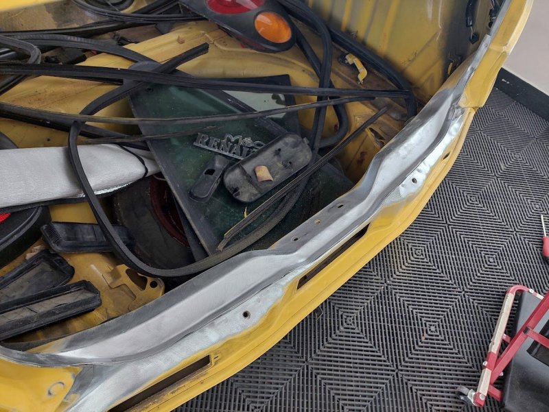

Well, I also didnt look at the rear of the car when I realised the sills need to be changed... I guess I want this car to be a suprise that just keeps on giving!!
Remover rear bumper
Driver side, above muffler hanger
Welp, here goes another year of my life on this car
7/2024
I decided ( again ) to go full r****d and dissasemble everything, wire wheel brush it and clean it, replace what needs to be replaced, and paint the car from underneath.

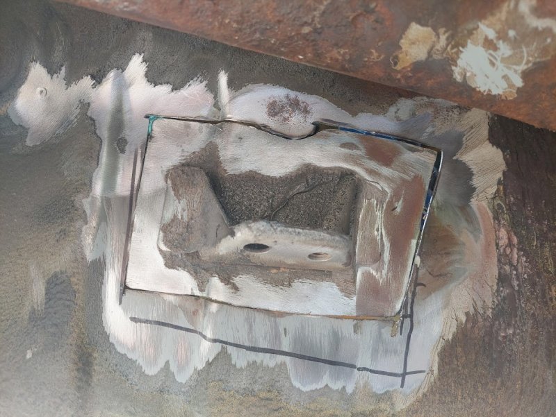

I've decided that I'm gonna try to weld all that pieces that I've matched to fit ( cut it from 5 door megane ) myself, I want to lean how to weld, and this is great oportunity for it.

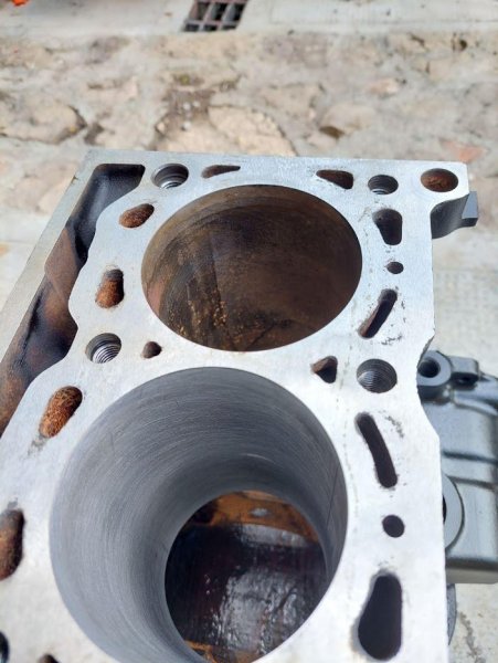

Oh, almost forgot, engine has blowby out of dipstick hole and oil cap, so something is bad with the rings..

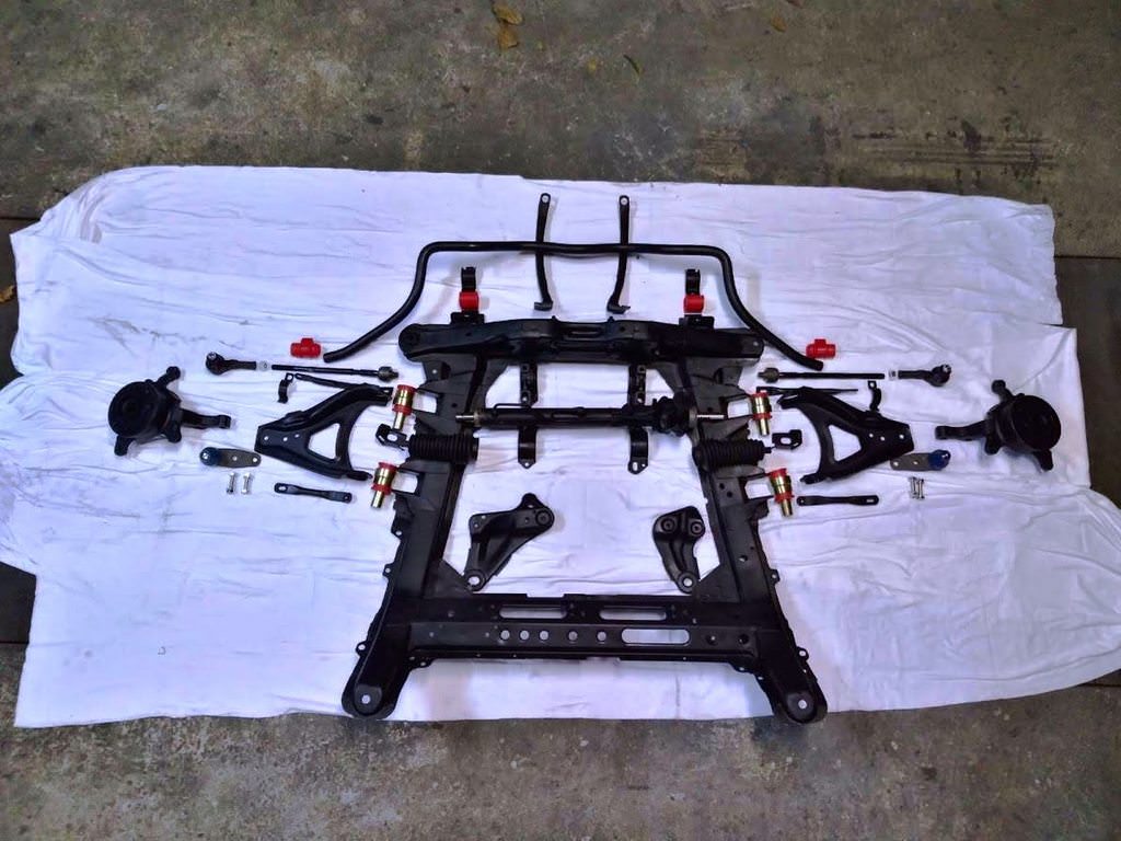

So, i ditched the scenic rear beam as it was too wide, and went for megane 1 estate rear beam. Wheels sit cca 4 cm wider compared to oem, its has new style calipers, and more important 25mm rear torsion bar, but 23mm ARB. Megane coach has 25mm ARB, the plan is to put that ARB but that's something that's not important now.
I've never lowered a torsion style beam but watched a lot of guides, so this was my 1st try with it, and I can say, preparation is key! It went smooth like butter, even managed to get the height from the 1st try.
Cleaned and greased everything, and put back, would also like to paint the beam properly because it's not painted properly now.. There was some modifications for the rear shocks to fit from coach to estate beam but dont have any pics of that, will take it in the future..
Although the beam is "refurbished", there was barely any thread in the torsion bar, lucky it went good with the thread tap.
