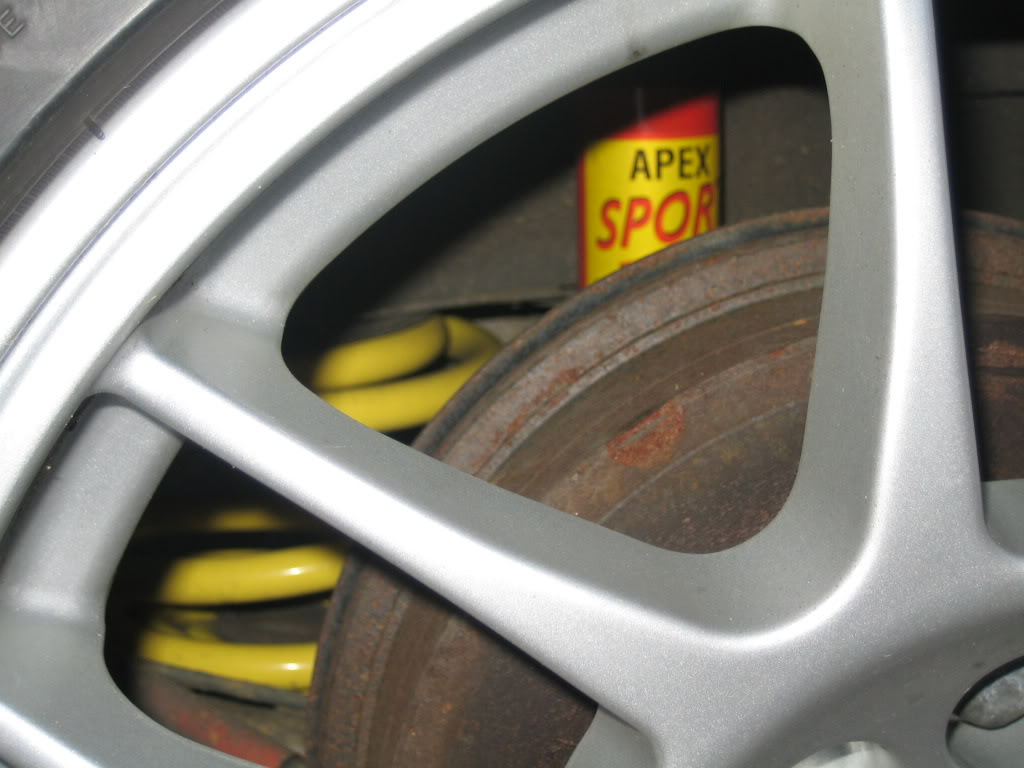

I would defo get 40mm apex mate for the mk2 is thats all the drop you want.

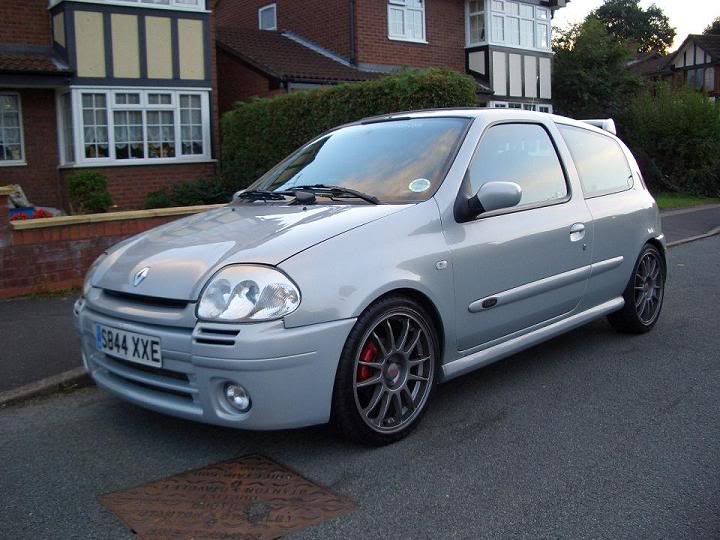

Proof that they go on a Mk2 ph1
and stay on ;)

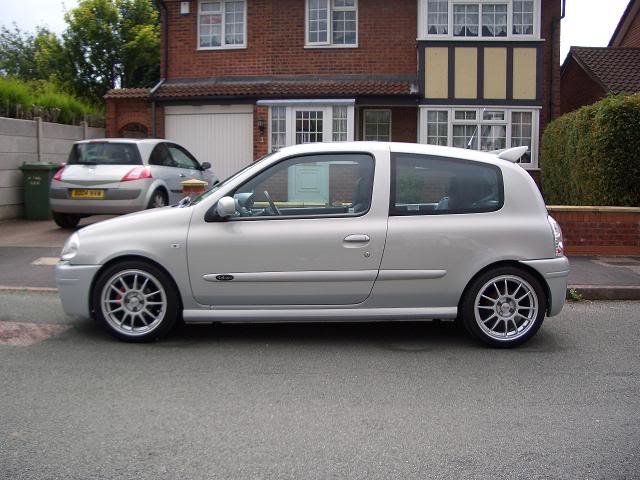

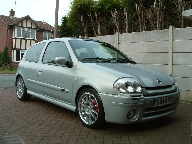

Vinnys is the same height as mine, just bigger wheels.
  Mégane RS

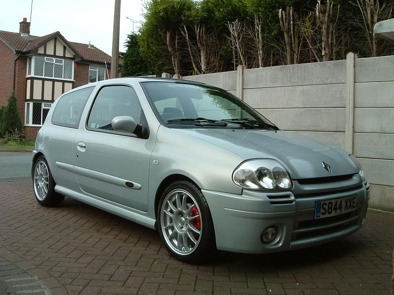

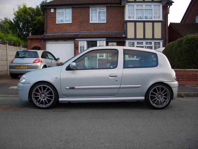

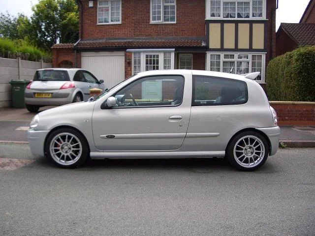

cheers mate, mine 40mm on springs but will be going to coilovers soon, heres another pic
16"
17"
Have you decided what size wheels you going for?

anywhooo, mine :)
