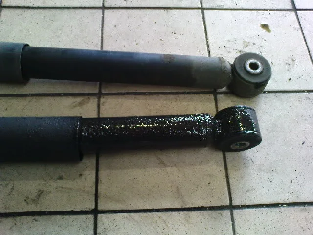

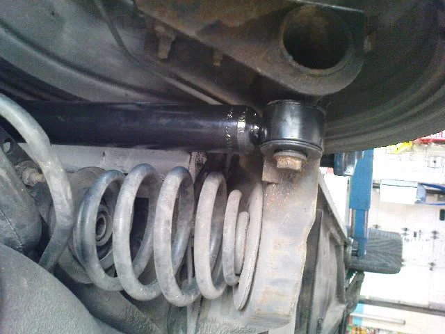

I knew my rear shocks were getting old, but when i found a puddle under the car it was time for a change lol, so i bought from renault a pair of Sport rear shocks and fitted them, bloody good job too as look at the state of them:

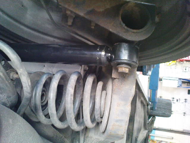

and all fitted nice nice :

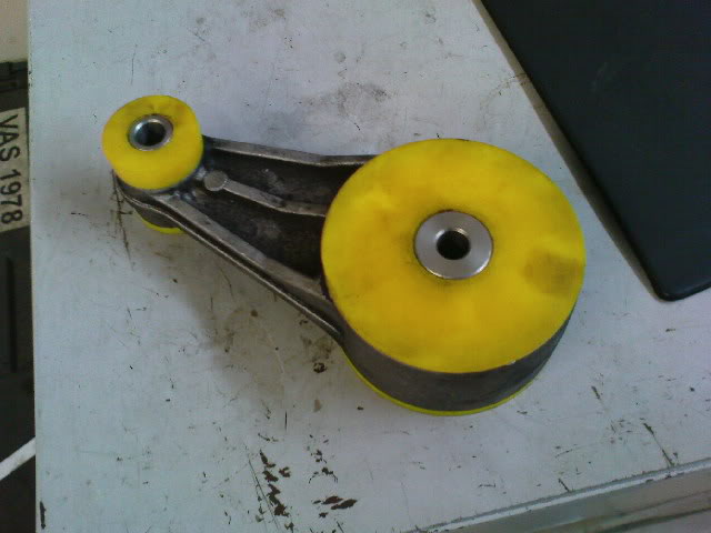

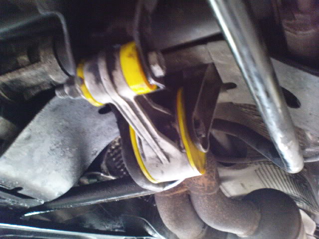

then i moved onto my dogbone mount, and pushed out the old bushes and put in some nice poly bushes

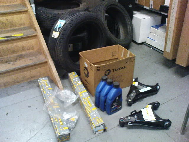

feeling in good spirits the next job was duely started: replacing the wishbones.
I have felt the front feeling very vauge (sp) and not very controlled, and on inspection the rear bushes were knackered.
so onto Renault and new wishbones ordered.

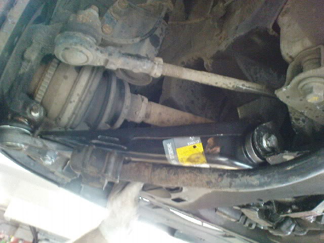

The ball joints were fine, as were the front bush bolts. But the rear bolts were shafted. it looks as if the bolt had rusted to the metal inner sleeve of the bush and took two hours to get it off with alot of heat!
so after alot of blood and sweat both arms came off, the drivers side came off without the bush as we burt it away!
but new arms on and looking all nice:
