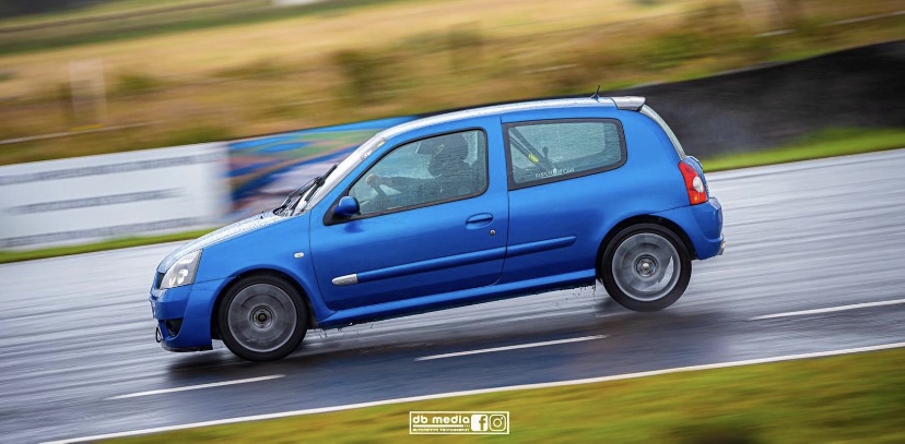

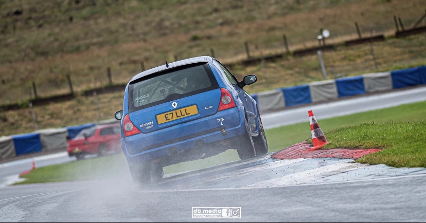

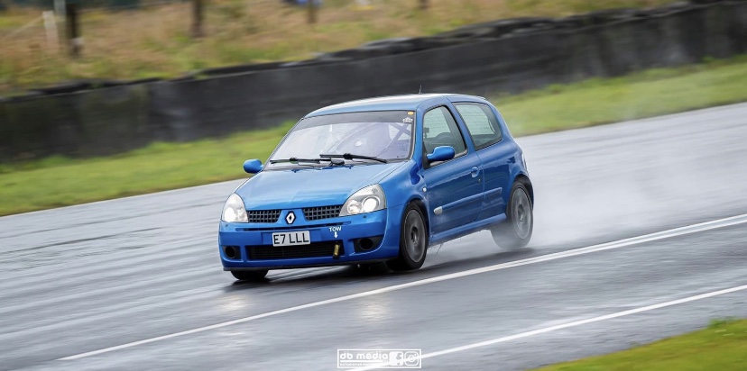

The pictures give an idea of how high the car is sitting currently

The back of mine looks higher than yours and I have lowering springs! No doubt my weight transfer situation is messed up too because it's also fairly lively at the rear, but it's also fun, and I have an ARB. Coilovers are next on the list!
