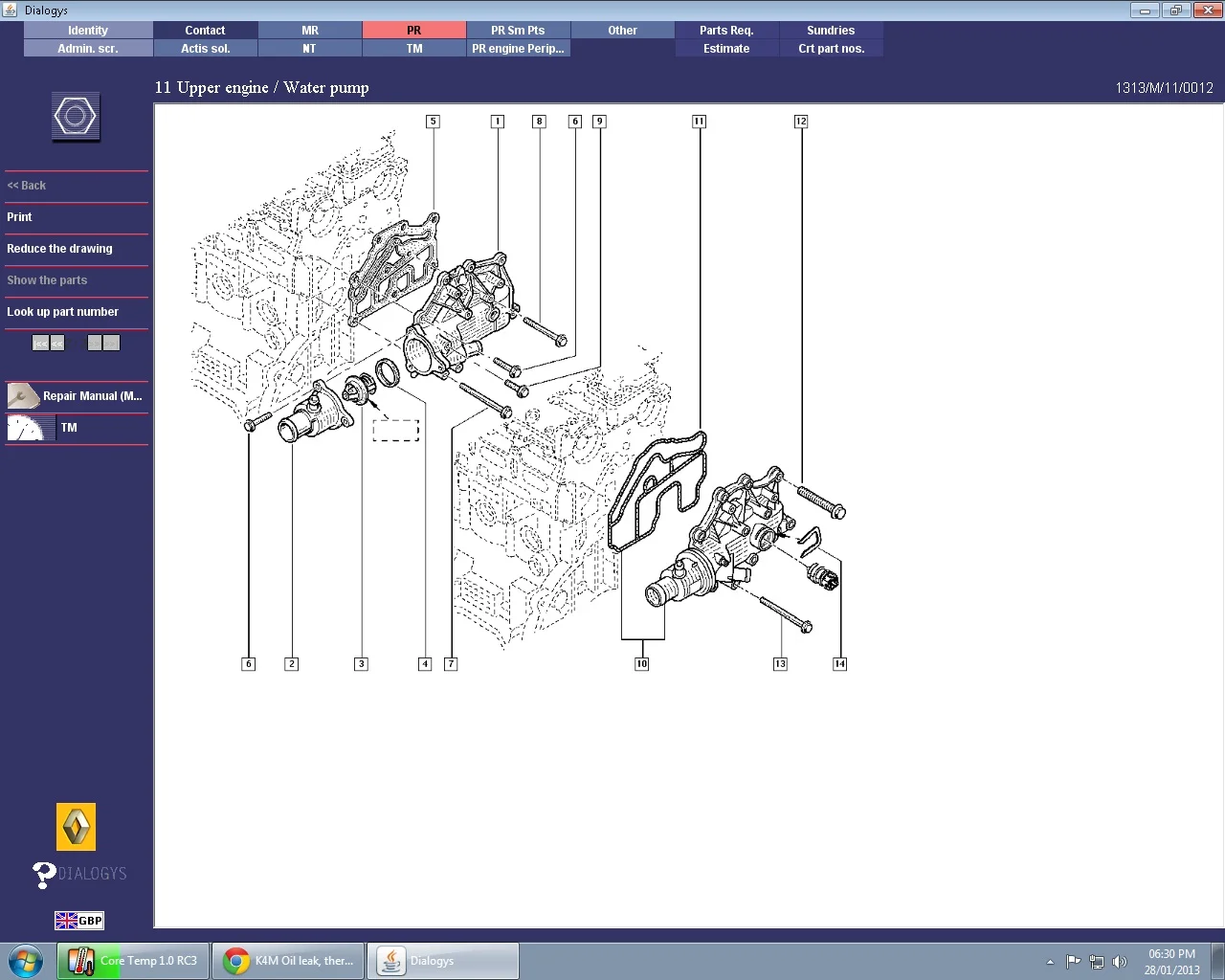

Best bet is to replace the plastic housing with the aluminium one. Last longer. You will have to change the thermostat as the one in the plastic housing is molded on whilst the one for the aluminium housing can be changed separately.
I think the position of the temperature sensor is changed as well.
  1.4 16V '52
You can talk to West Renault on here or check a scrap yard over there to get one.
I hope this helps.
I have the one on the right, im leaking oil and it's mixing with the water. Should I just replace the seal or are they known to crack ?

Go with the gasket first mate, its cheaper than the full housing and normally this... Drain the coolant off first though.
