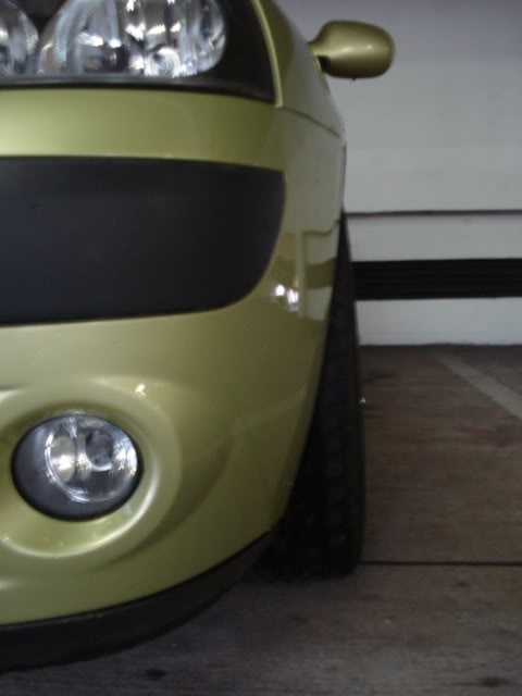

To add to this, how come I dont need to buy Camber Bolts like everyone goes on about? So basicly K-Tec coilys have built in adjustment?? Or will I need to buy Camber Bolts anyway?

the units have camber slot on them(the elongated bolt holes) and ktec supply you with camber bults, the bolts with what can be described as a cab on them.

they come with the bolts already.. but i was thinking of getting the eibach ones as the ones supplied are very hit and miss, one side maxed out at -1.5 and the other would go to -2.5 .... even making sure the bolts are the right way... but as for the shocks they are good

are these the k-tec ones they have simply moddifed by redrilling one of the holes?
The hole is drilled out and the bolt has a 'lobe' washer on the end that is adjusted by turning the bolt between two welded on strips of metal in which a nut is tighted over to hold it in place.

So basicly if I go into a tyre and suspention garage and ask if I can have 2Deg Neg Camber on the front, will this help the handeling/understeer issuse?

I had mine fitted by ktec and I'm sure if you take them to a garage and ask them to adjust the camber then they'll sort it for you.

Camber was out after fitting but when I had tyres fitted tyre place put the front camber back to 0.
