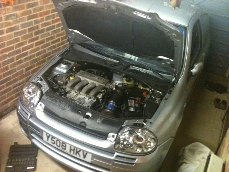

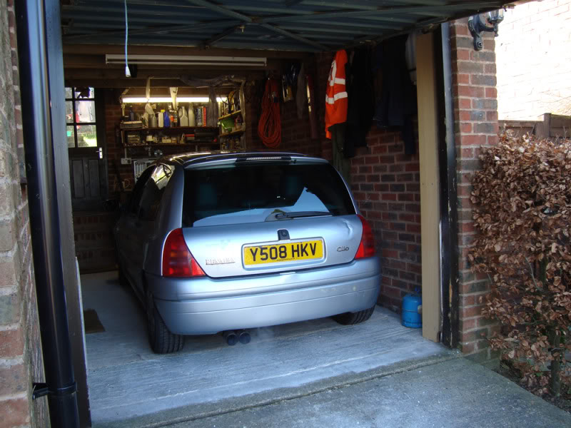

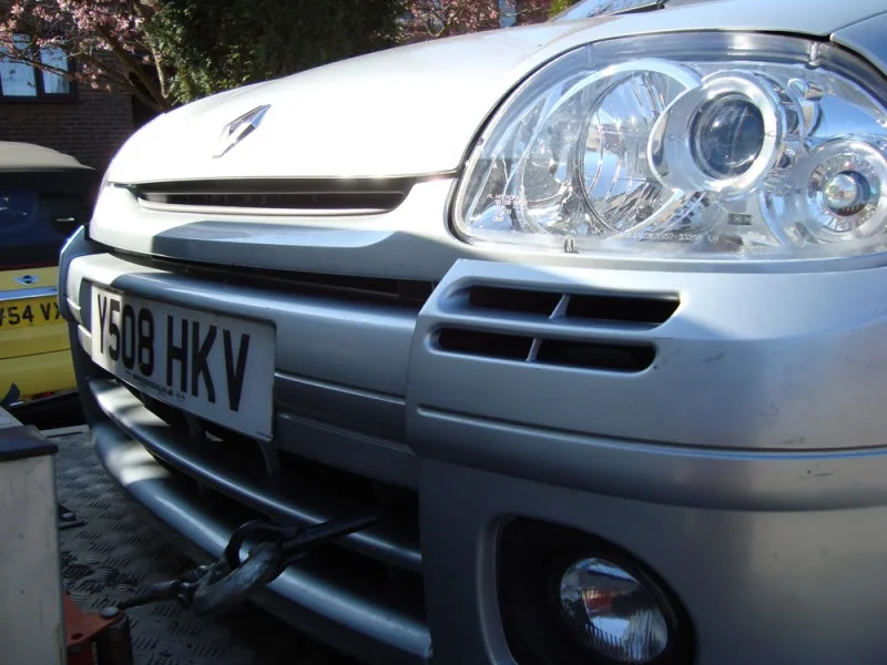

Dad took these pics when he got it home:
Odd lights, but it does have an HID setup.
The car drove itself under it's own steam up the drive and into the garage.
The car has done 86k and appears to have a full - if interesting history file with it.

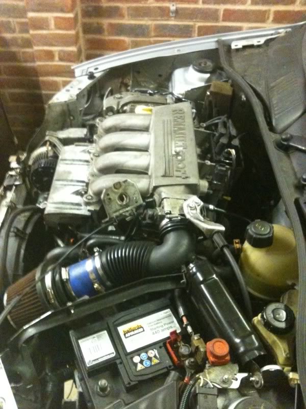

So first job was obviously to source the parts to replace the faulty bottom end. Good old eBay came up trumps with a 43k 172 Cup bottom end taken from a rear ended 03 plate car. I made the guy an offer and last night travelled into deepest darkest Essex to collect from what can only be described as a backstreet scrap yard. Very odd. Still, the bottom end was squeezed into the back of the BM and brought home.
I didn't get in till fairly late so my brother and I lifted it out onto the bench and left it.
It's a bit grubby, but the plan is to strip down and rebuild anyway, refreshing what's needed. The bores all look fine at quick glance.

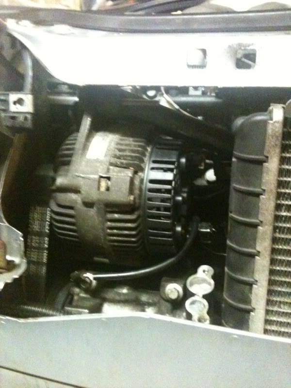

As a bonus it's still got the Cup alternator bracket still fitted which allows for the removal of the aircon and tensioner pulley. This alone is usually £100 odd.

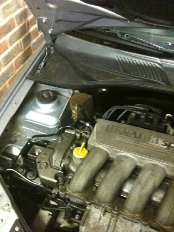

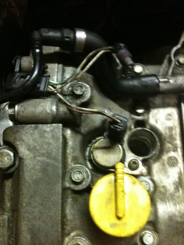

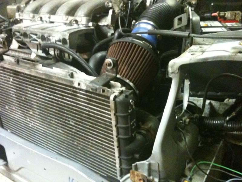

On that front I opened the bonnet for the first time and had a look. It seems someone has already started removing the aircon system.

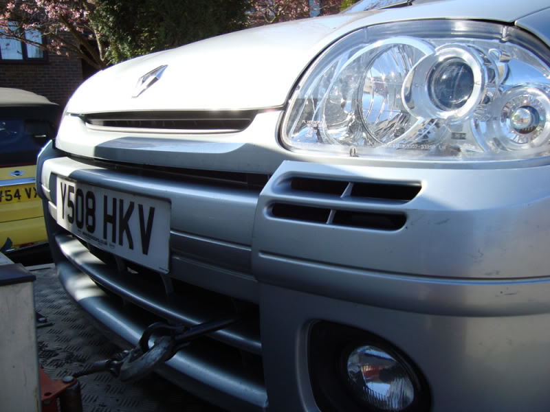

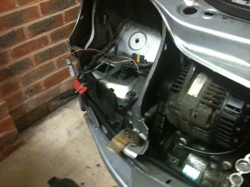

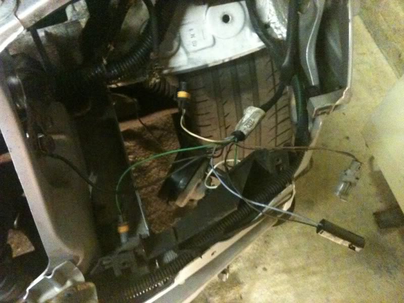

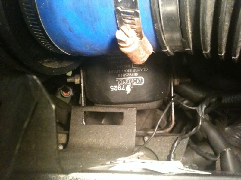

First off discovered the car has some crappy Clifford type alarm and immobiliser on it. Oh the joy! :angry:
Anyway, put the front of the car on axle stands:
First job is to remove front trim.
Some bolts were already missing....
Top grille off:
Foglights out:
Bumper and inner arch liners out:
Aircon rad already missing!

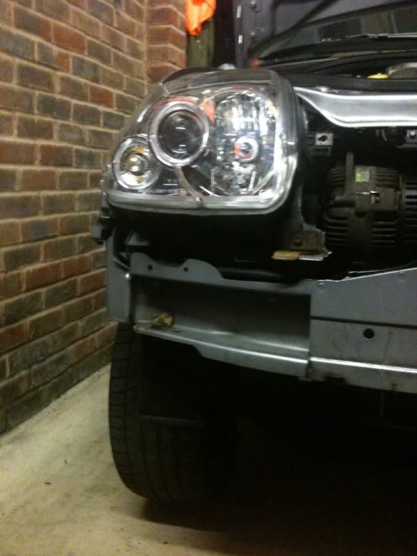

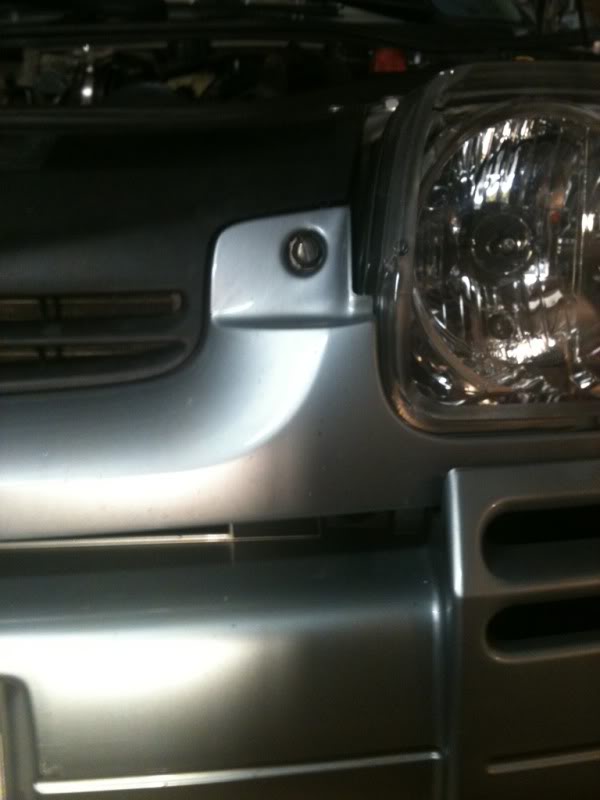

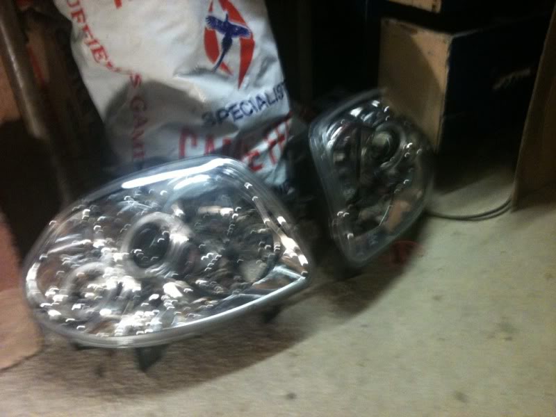

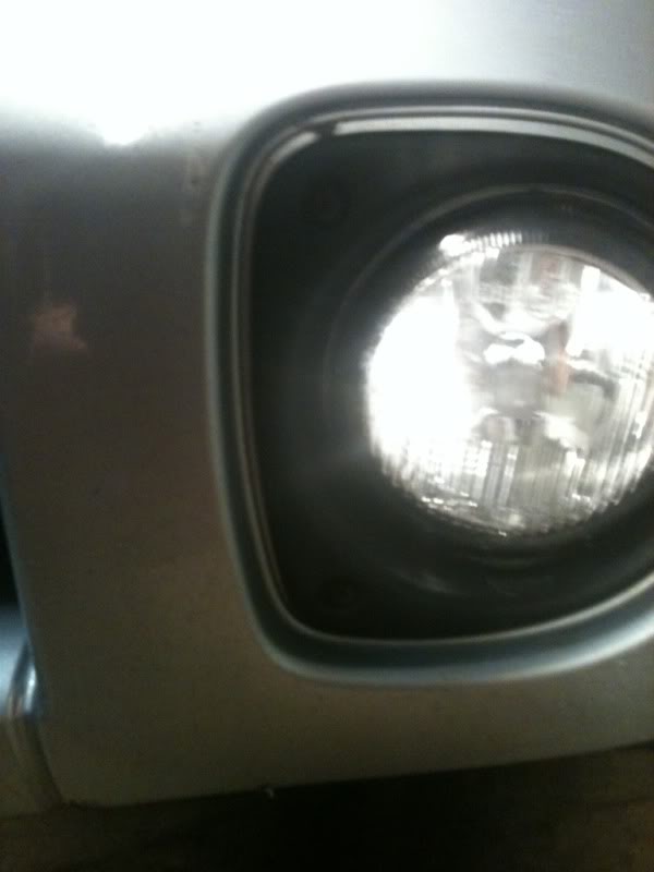

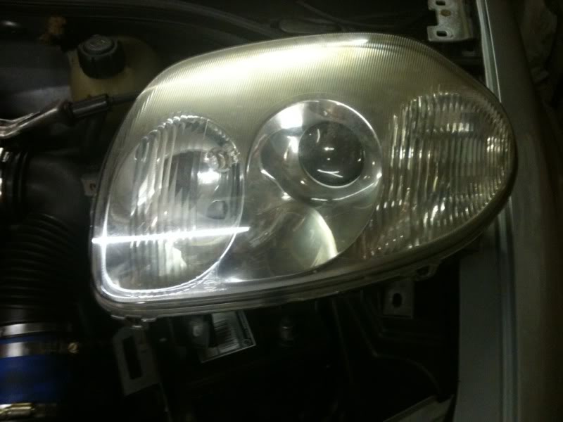

Weird front lights removed - they even have built in daylight running LED's.
:D :whistle: :rolf:

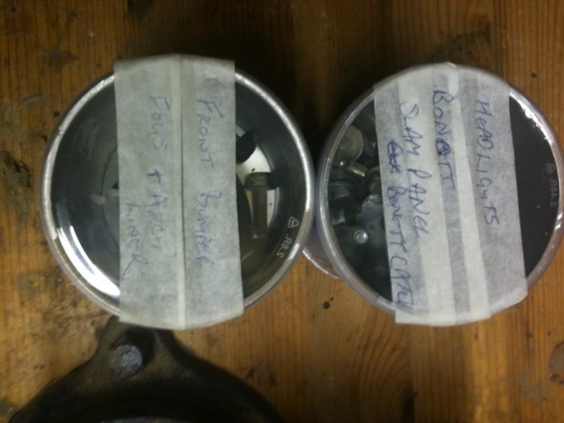

Taking as many photos as I can so I can remember what goes where!

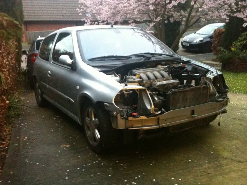

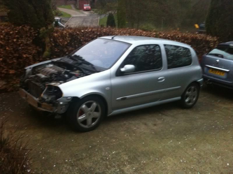

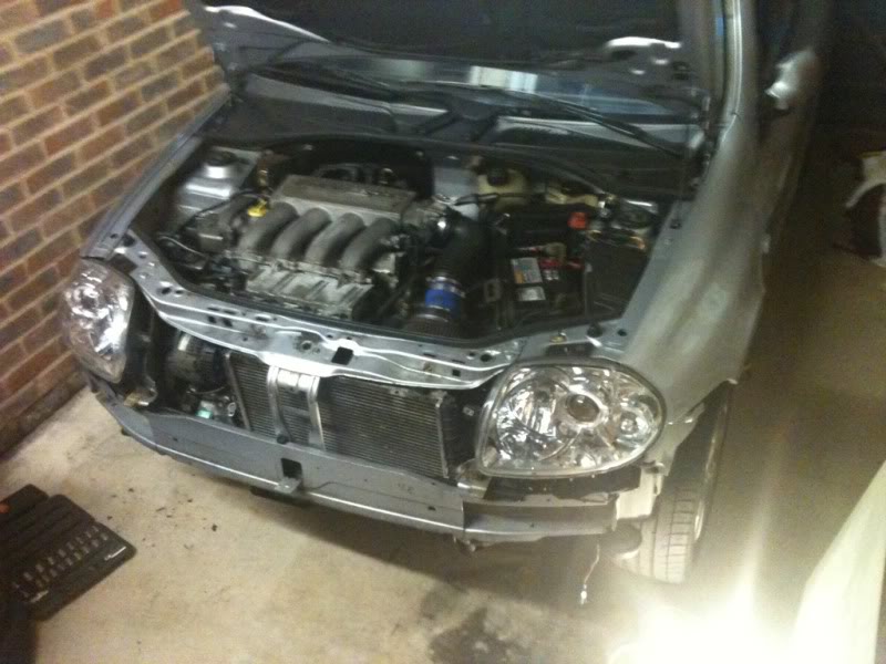

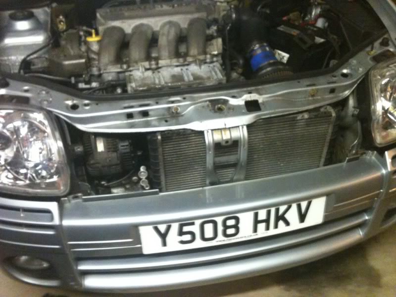

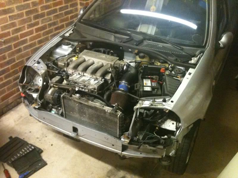

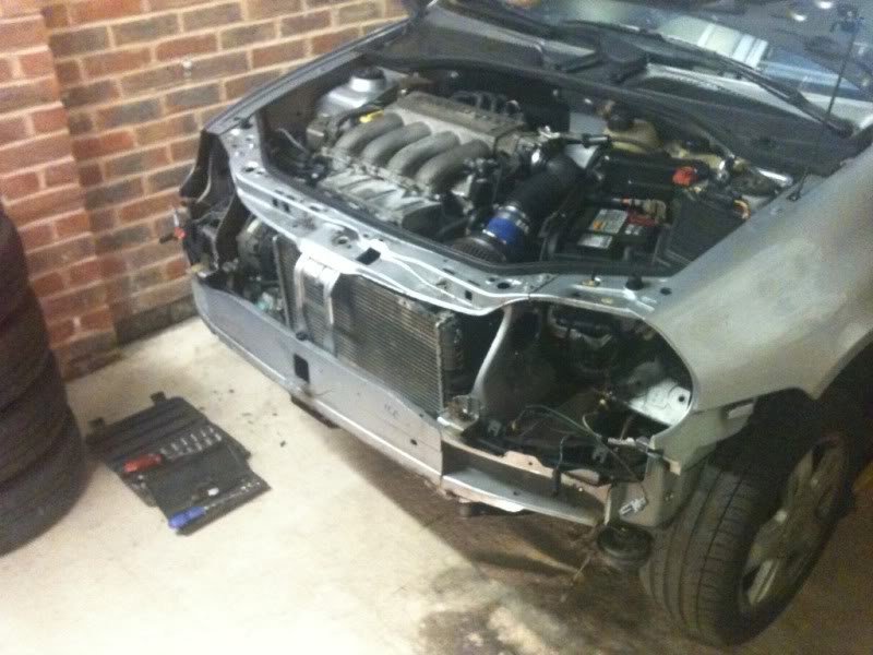

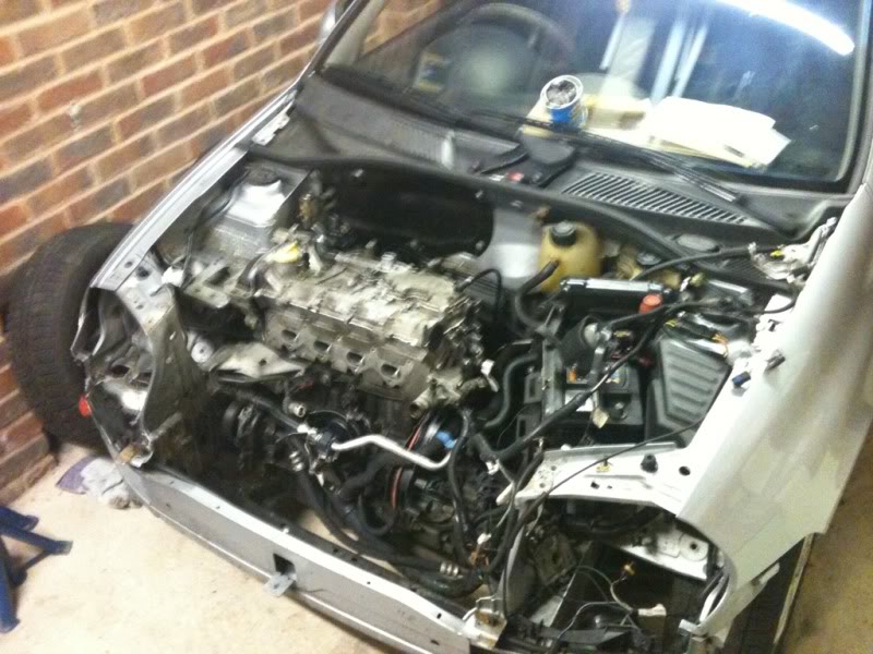

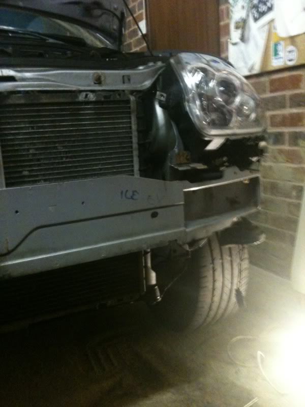

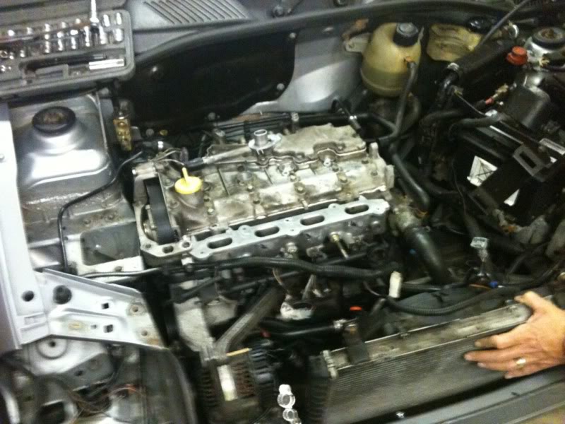

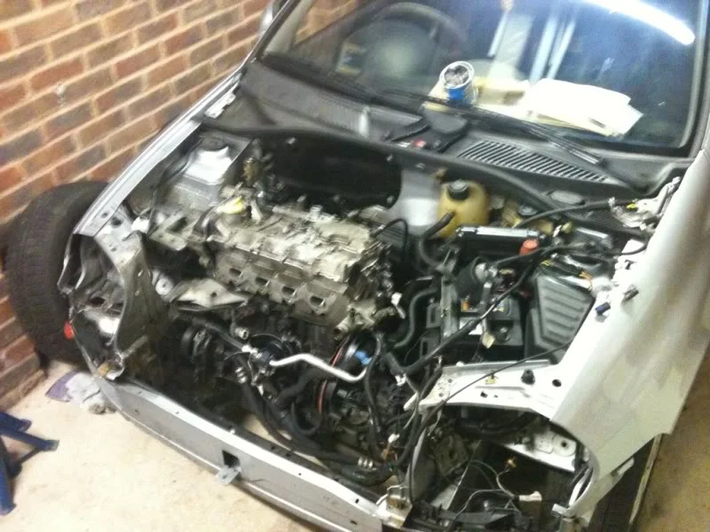

So, again, hardly any time to fiddle with the car tonight, but finished removing the front end and then took a few general pics:
Bonnet and slam panel removed.
Nearside
Offside
Marking up where bits came from.
Engine bay.

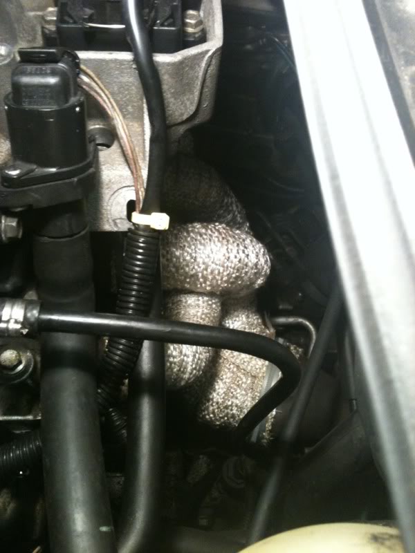

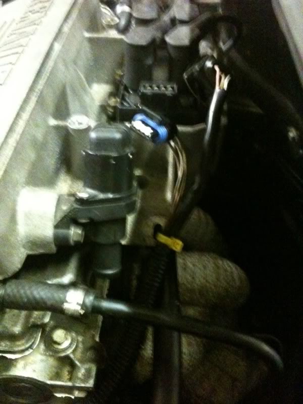

Manifold has been wrapped at some point.
OE lights turned up.

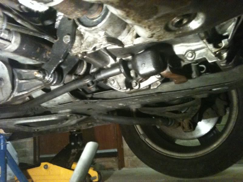

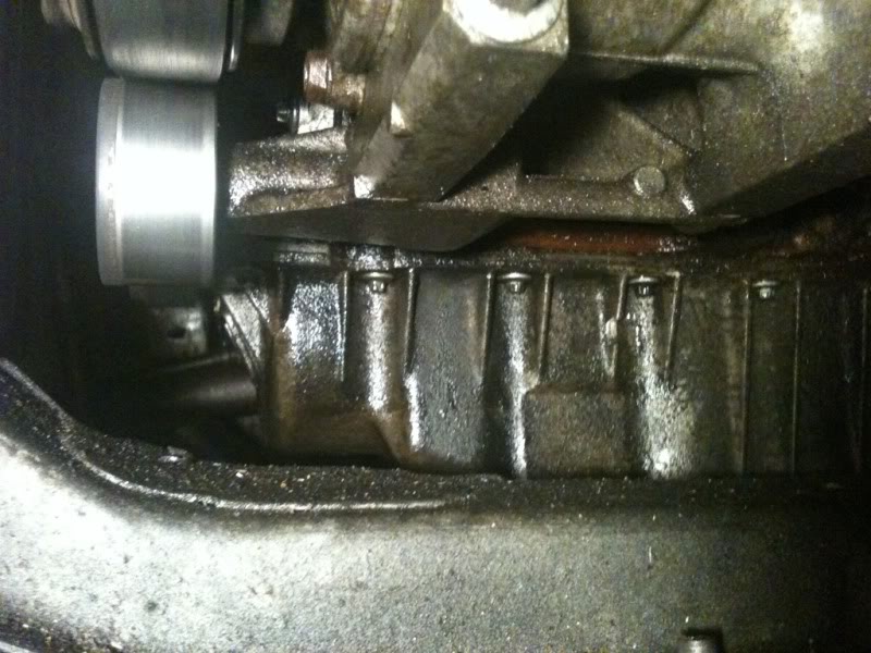

Sump is weeping a bit, it'll be out soon.
It's a Cobra not a Clifford.
Only fit for the bin!
Tomorrow evening the coolant gets drained and the rad removed. Might start removing interior as well if I get any time.

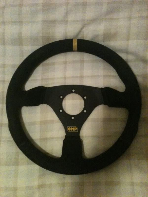

It's a seriously crap wheel in a bad state. Luckily I have an OMP on it's way to me already. :)

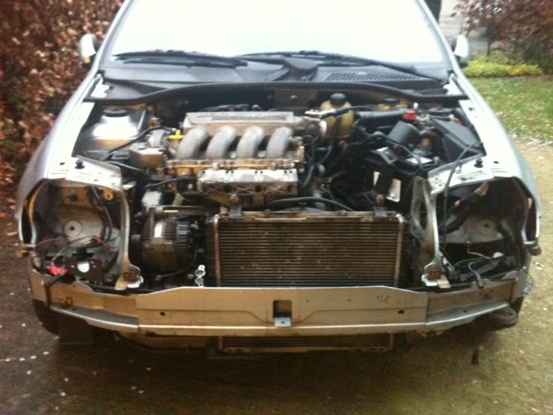

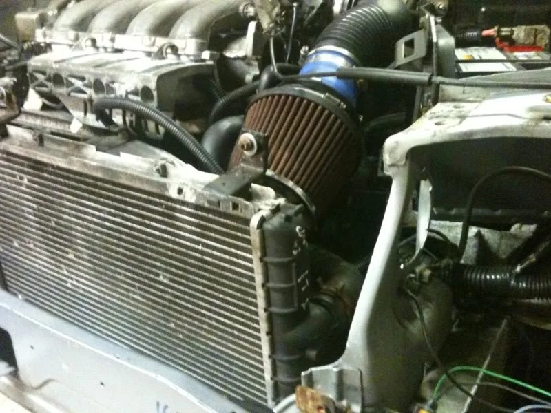

Last night I finished taking everything off needed to get the engine out, save the rad, with is just sitting in place and can be lifted out.
Removed the airbags ready for the new wheel.
Rolled the car back out of the garage, washed all the birdcrap off of it and then drove it back in ready for the engine to come out.

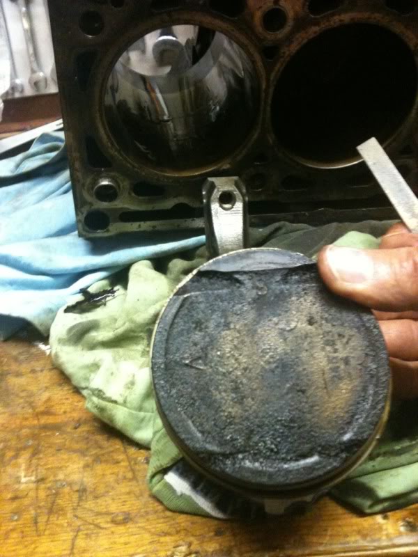

Time for an update.

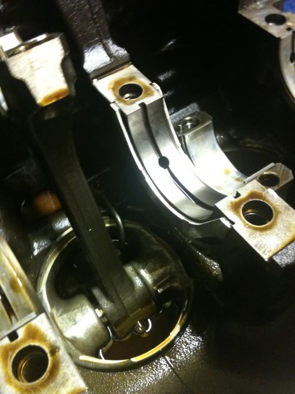

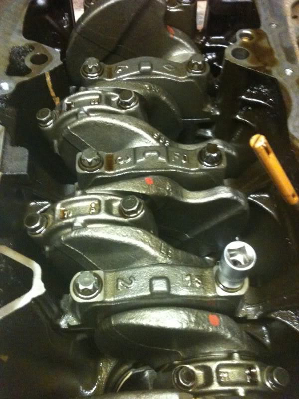

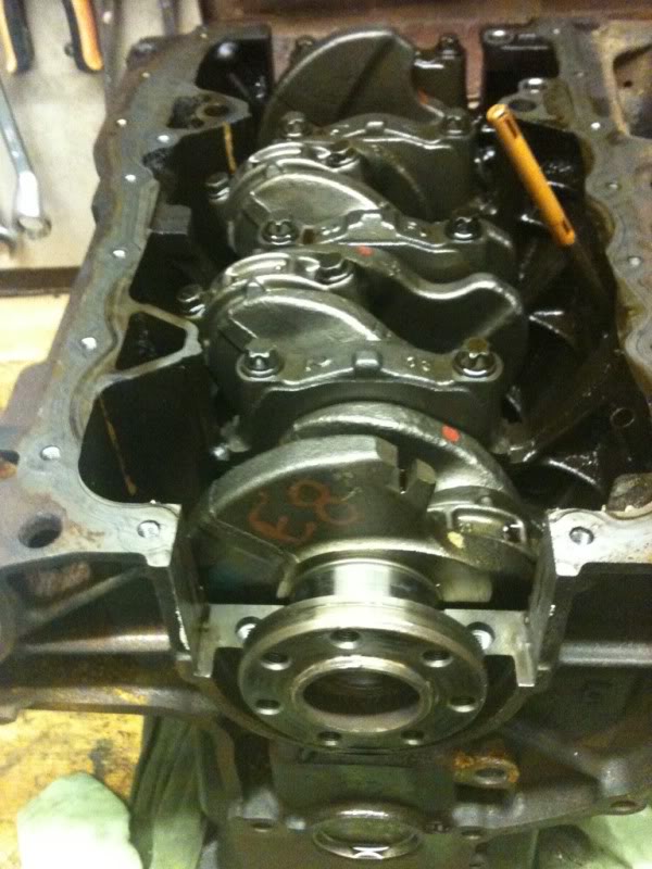

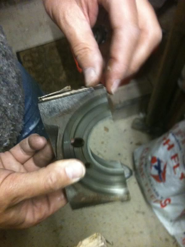

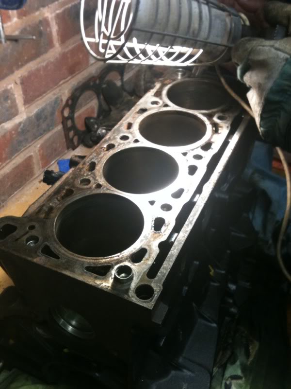

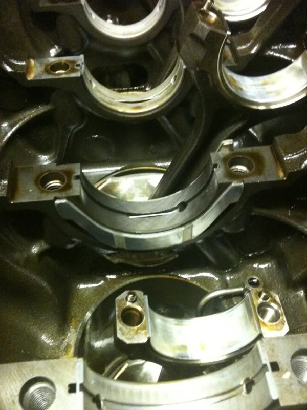

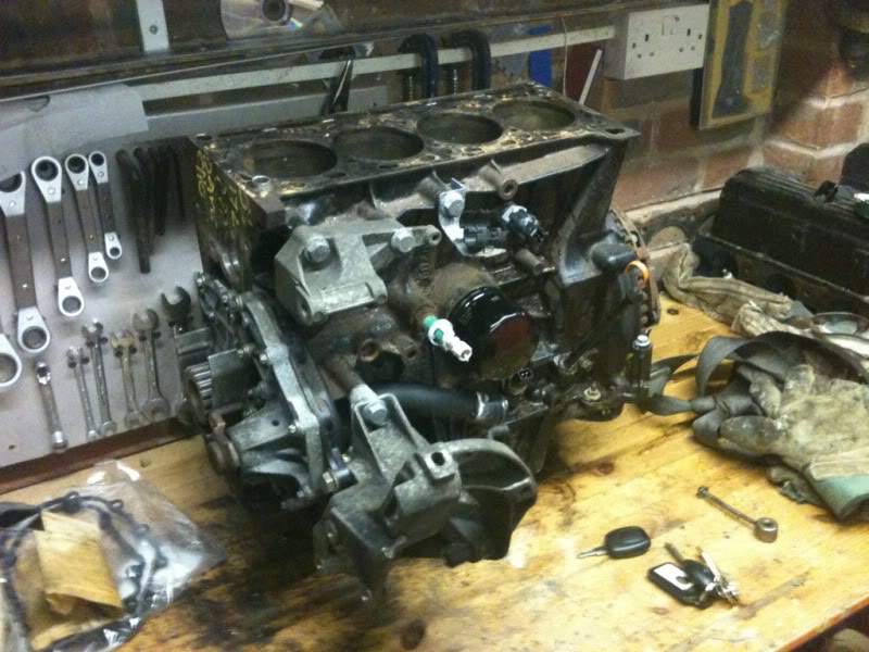

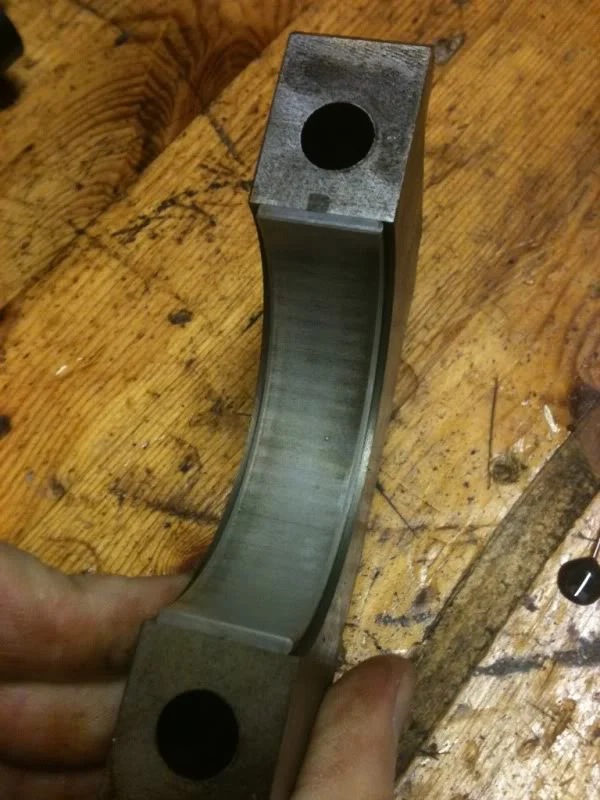

Dad had removed the sump from the bottom end I bought and had removed the oil pump and chain drive + the crankshaft pulley. The bottom end had a fair amount of sludge in it indicating that water has mixed with the oil, we both think it'd been standing a while.

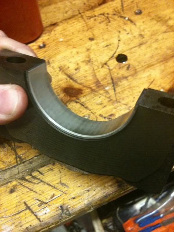

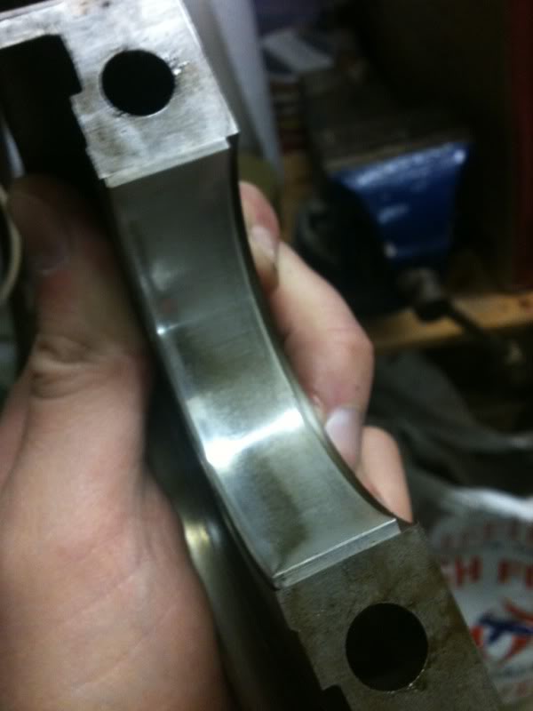

We spent this eevning stripping the bottom end down, marking everything up and cleaning as we were going along.

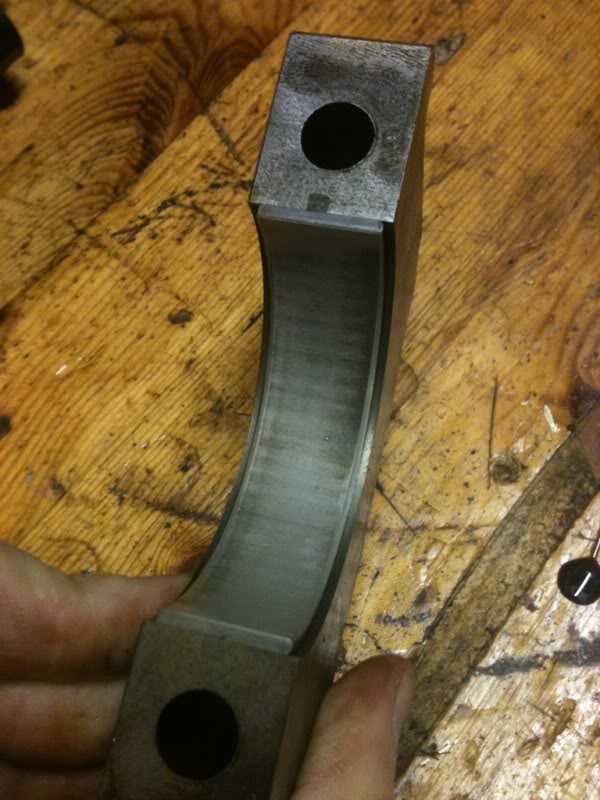

Everything seems to be in good nik, with only slight marks on the main bearings (which I might replace pending some advice). Big end bearings, piston rings, bores etc look fine. Tomorrow we're going to clean the block up and get rid of all the muck.
A few pics:
Main bearing 1
No.1 is nearest us.
Shims on no.2 only.
Main bearing
Will need a good clean!

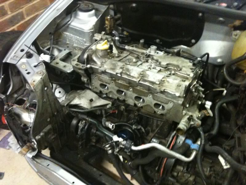

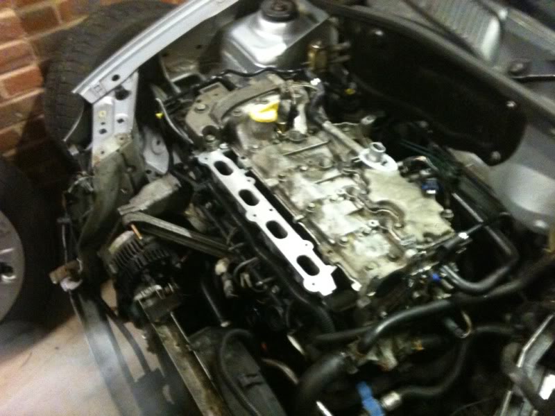

So had the evening to myself last night and it's the last time i'll see the car until early May, so thought I ought to crack on a bit. Dad's set some time aside next week to rebuild the bottom end of the spare engine, so the head has to come off the engine in the car to go onto that one. I spent the evening removing everything I could and marking up all the wiring, sensors, loom etc.

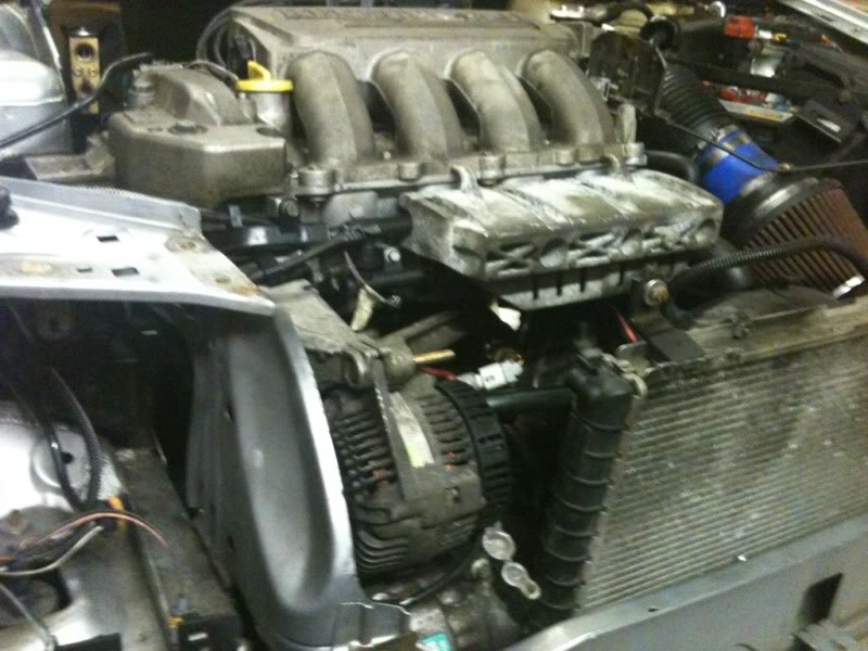

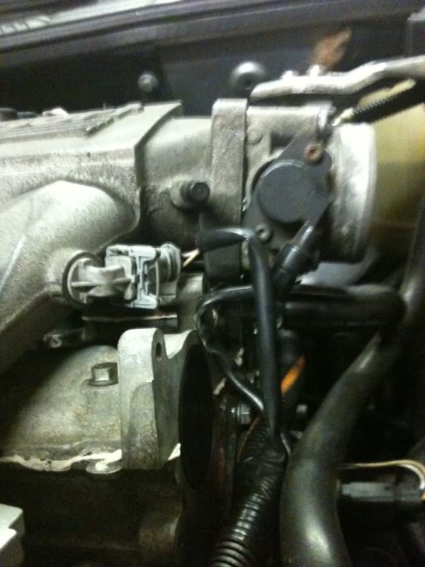

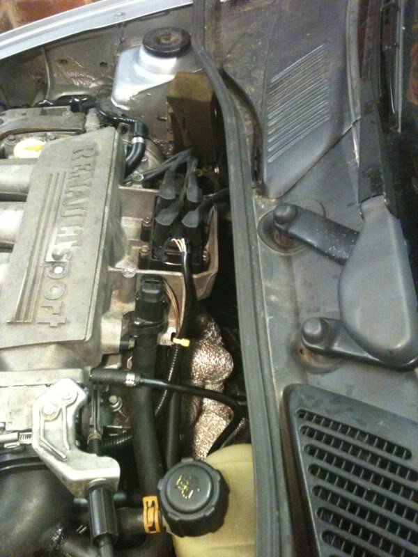

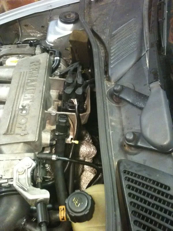

First up, remove throttle body and throttle cable:

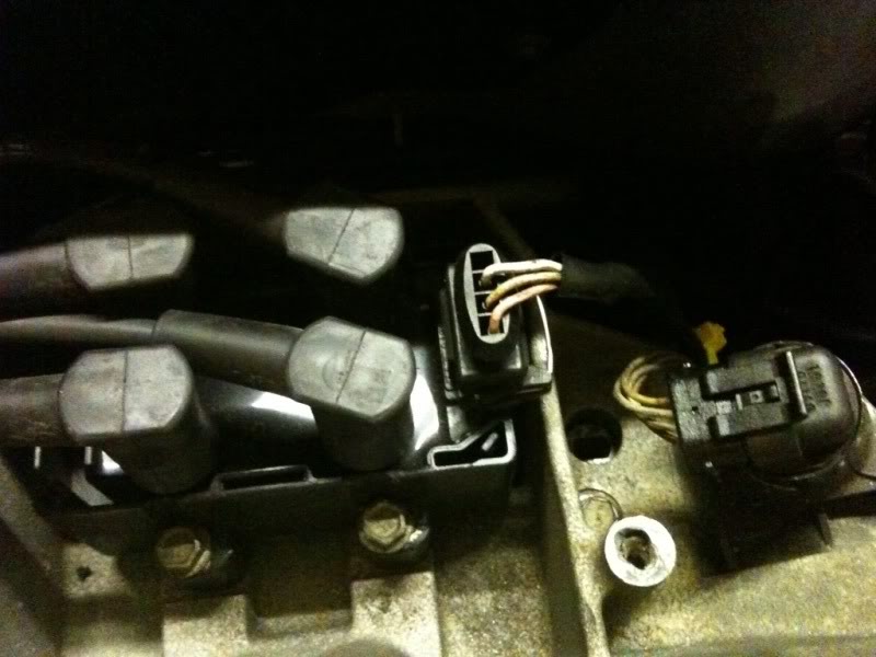

Coil pack:
Plugs:

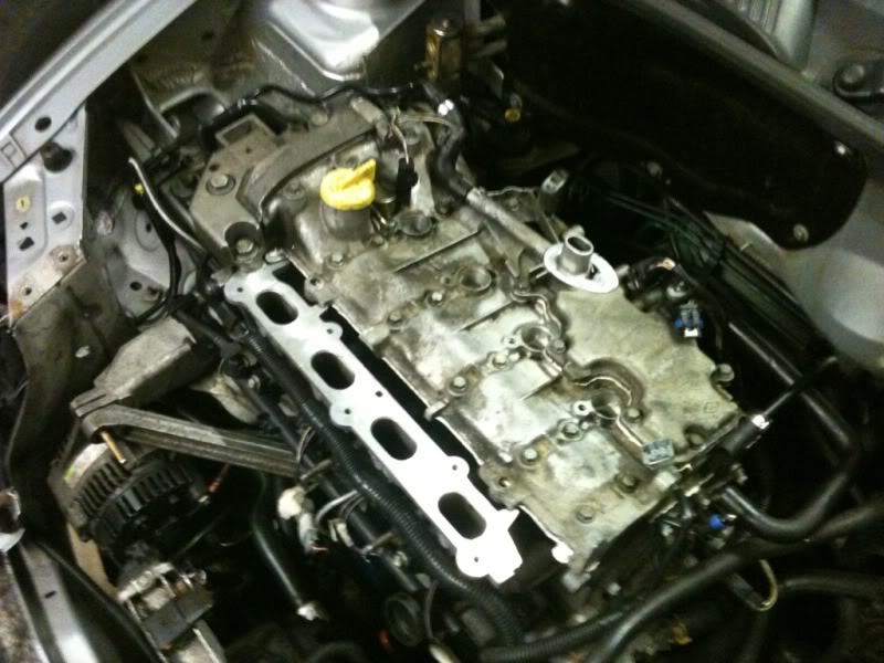

Next the top engine mount was removed along with the upper inlet manifold.
Then at some point the coolant was drained out and rad removed along with coolant pipes:

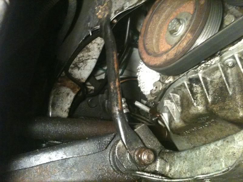

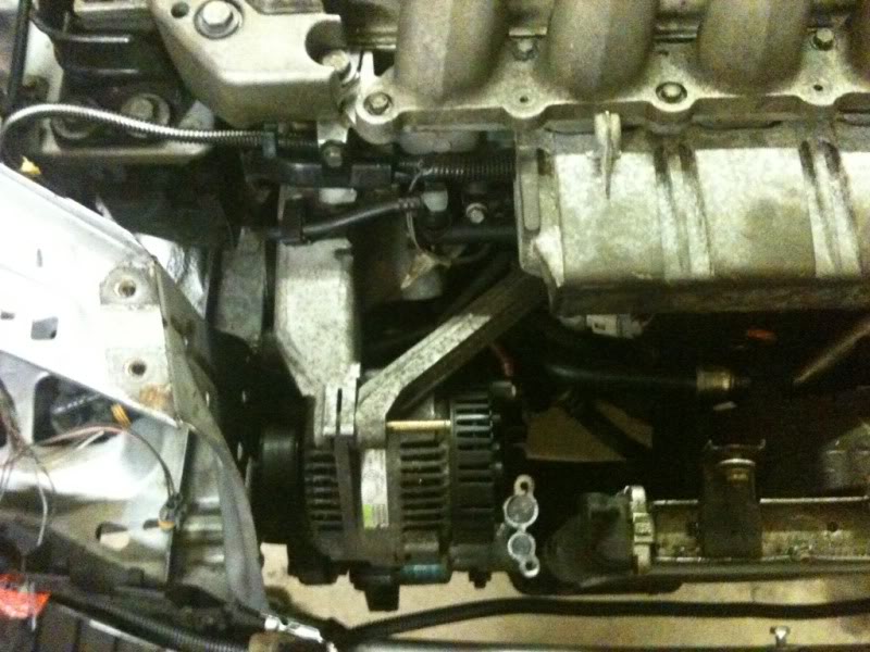

Alternator, air-con pump and associated bodged bracketry was removed. I was amazed by all the weight involved here and what a bodge it appeared to be. None of this is going back on and it's saved so much weight (all right out front). Good stuff.

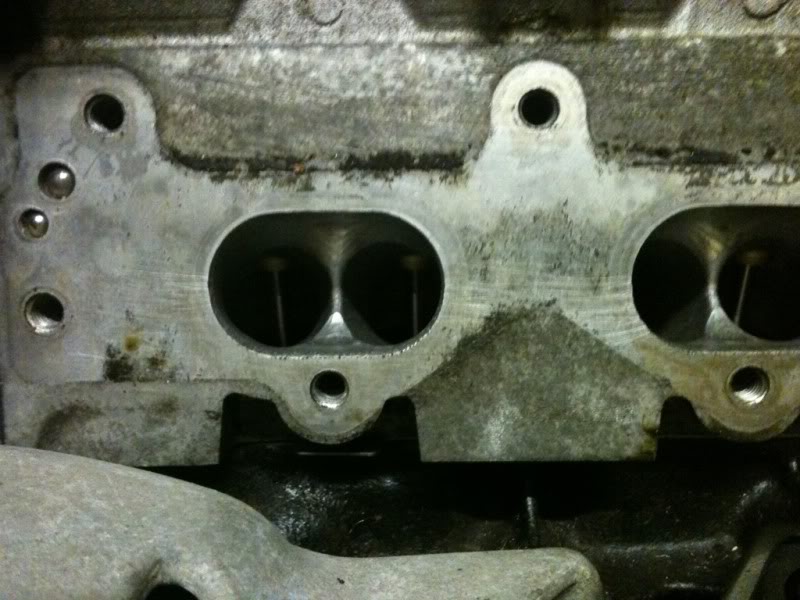

Lower inlet removed:

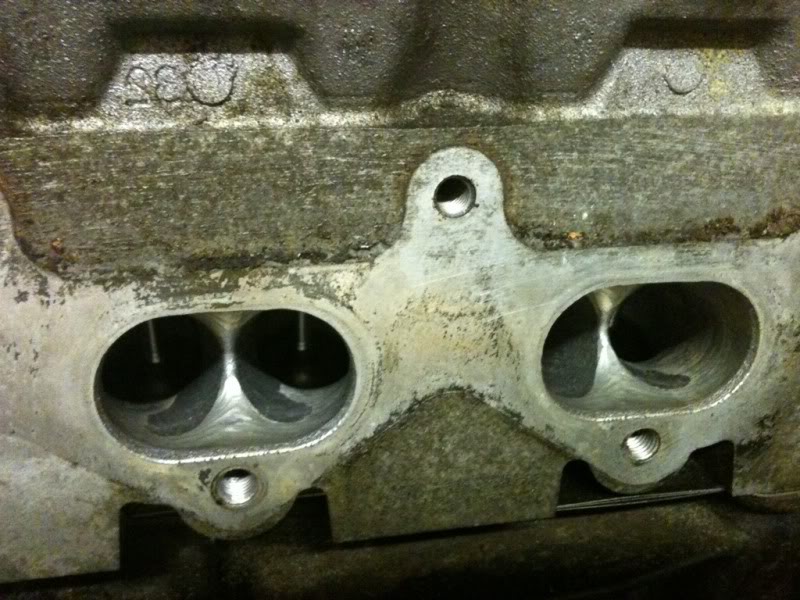

Can't decide if someone has had a go at these already, it wouldn't surprise me:
Finished there and was left with:
Steering wheel has also arrived (as has so much other stuff, none of which i've taken a picture of!
