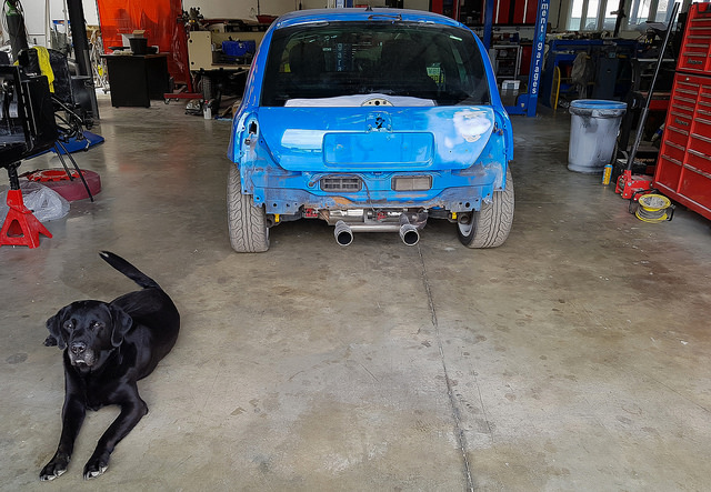

Rear bumper removed

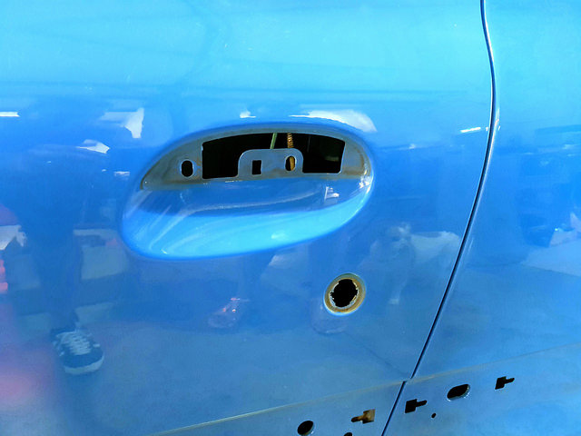

Passenger door lock removed

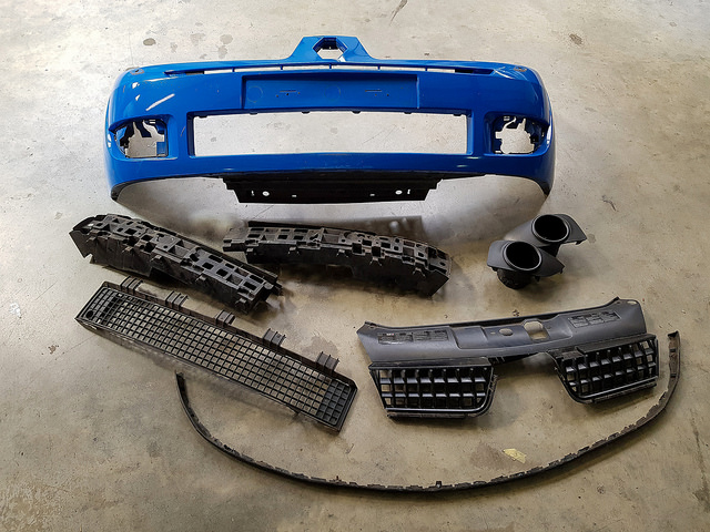

And the front bumper all split

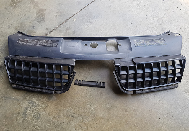

The front grill clip has snapped on the top. Never noticed it before. Am contemplating getting a new grill as this one has been sprayed. TBF its held up well and looks decent still but the crack has made me ponder on getting it replaced with a new one. Will contact Paul off RPD about a small list i have.

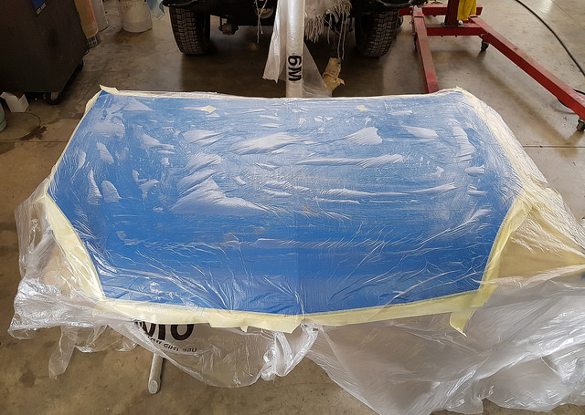

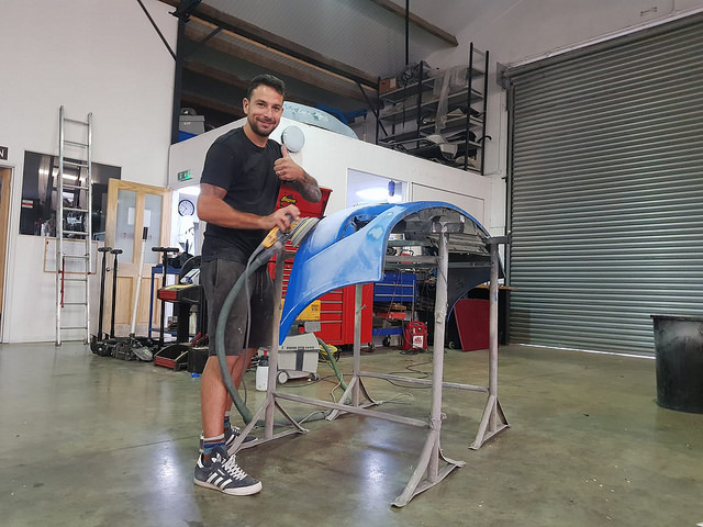

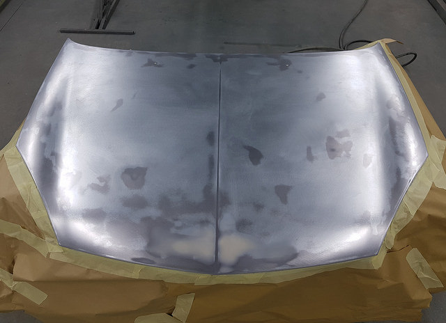

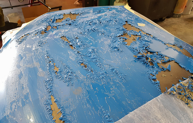

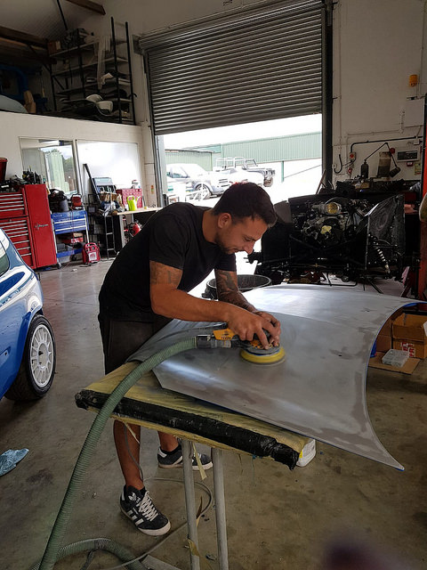

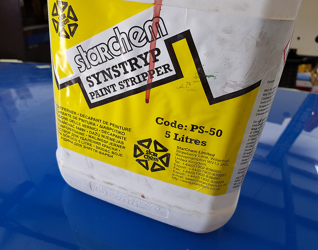

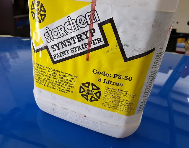

This weekend i decided to remove the bonnet and make a start on the prep work. Steve @MrBlonde wanted to come down to fit he's new front splitter and Will at work was tinkering with he's R26.
Bonnet off, masked up, paint stripped and DA'd in 80, 180 and 320 grade.
My missus getting the action shots!

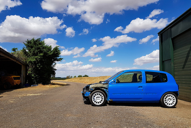

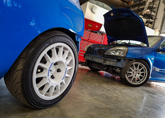

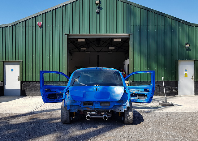

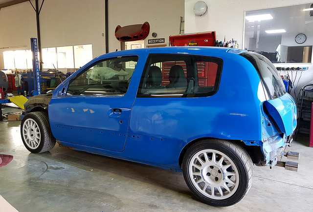

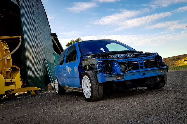

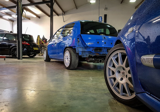

Then called it a day and parked it up, but wanted to get a quick snap next to the farmers Combine Harvester.
You can see in this shot the difference in shade between the door and the rear quarter.

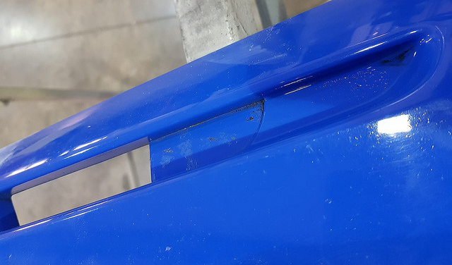

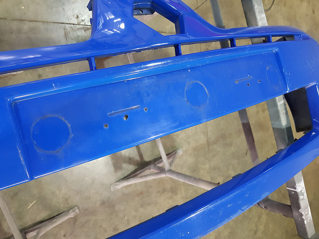

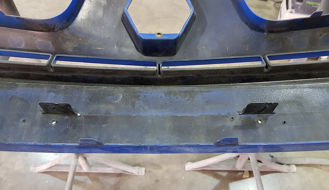

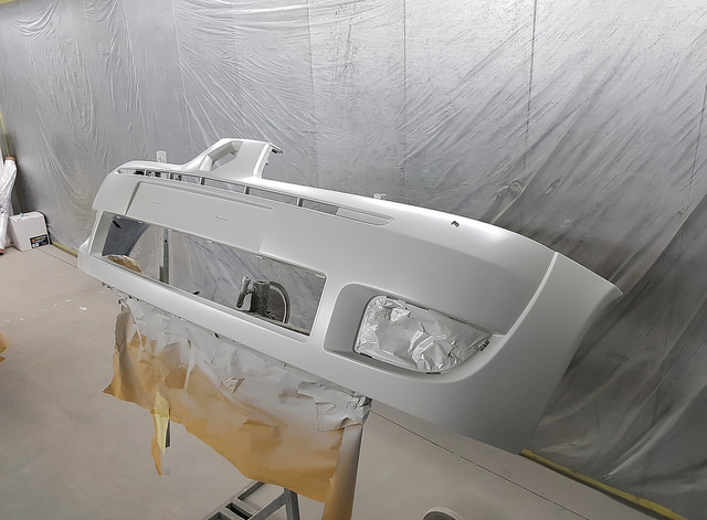

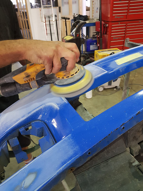

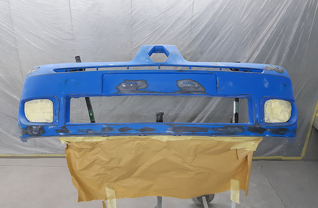

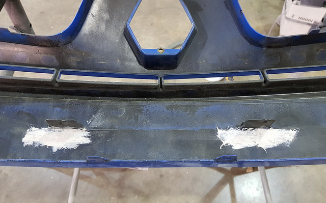

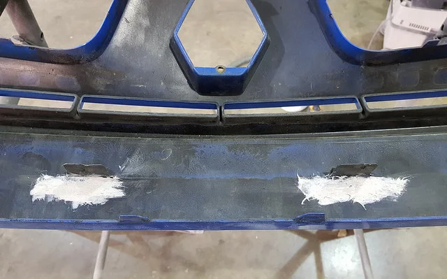

Back at work on sunday morning to prep the bumper. It had a few number plate holes in prior to my ownership, so i taped up the front and fibreglass fillered the rear (will need sanding down at a later date) then flipped it over, removed the bumper stickers and DA'd the front in 180, 320 grade before adding some filler for the scrapes/scuffs and chips and blocking it down with 320 again.
Few more action shots
Fillered the washer blanks too.
Bonnet and bumper all ready for primer now

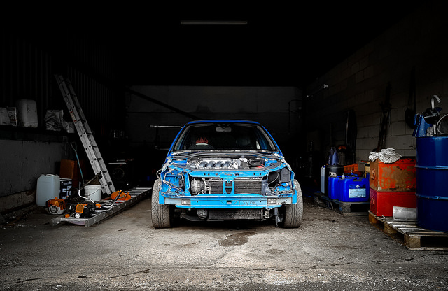

Love that last shot, so moody.
I know. I've been wanting to get "that shot" since I've spoken to the farmer about using the unit and happy with how it's come out after a little edit.
Get a new grill mate. You're doing all this on it, so it makes sense ?
Yeah your right Craig. I'll drop him a message soon I think.

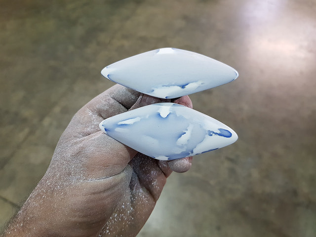

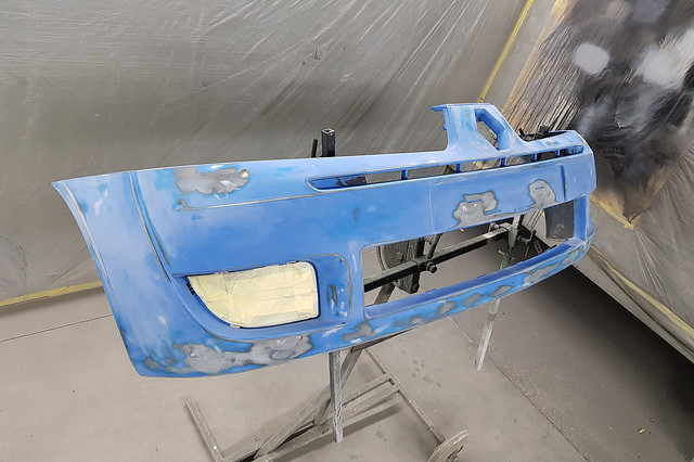

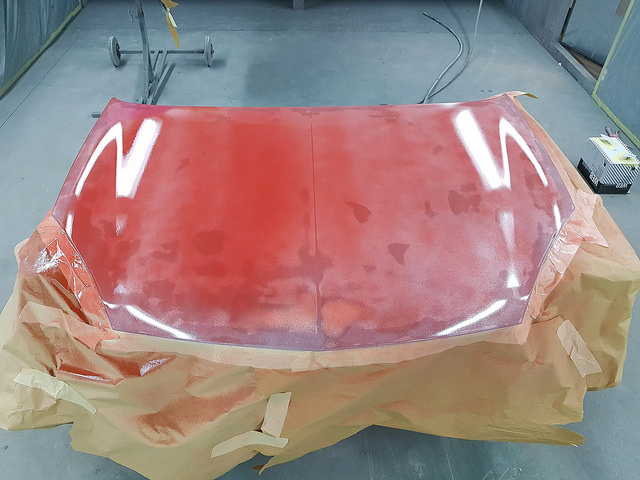

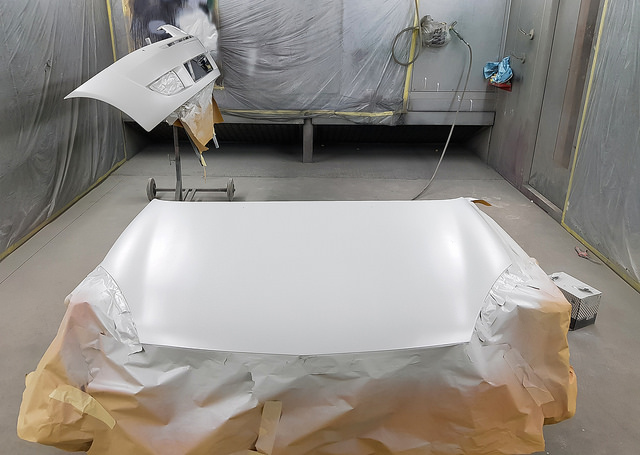

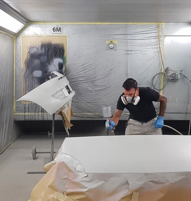

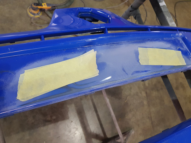

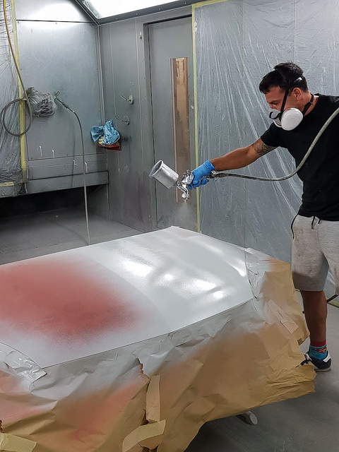

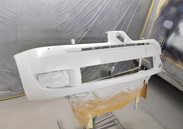

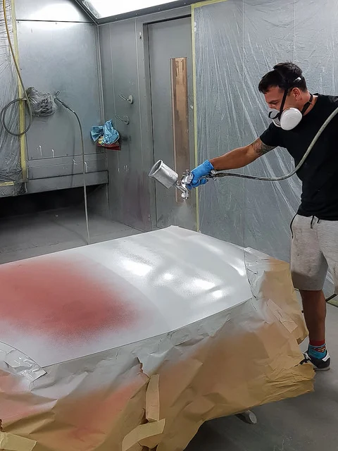

Bonnet, front bumper and washer blanks all primered. All degreased, and then i put some etch primer on the bonnet and some plastic primer on the bumper and blanks. Pretty happy with the outcome, considering ive only picked up the gun a few times. (Maybe a bit more but not a lot.) In fact, it was probably april/May time that I fish had a go at spraying. I'd never done it via a gun before, only cans.
Luckily at my firm, they are happy to teach me which in turn has its perks. Dont get me wrong, im certainly not skilled to do base and lacquer, but good to get involved with the basics and having a go. It feels so much more involved than just using a rattle can, from prep to gun clean, mixing paint to the actual spraying process.
Will block them later in the week.
And again, some action shots! (Wearing a mask this time @James along with gloves and superman socks!)
All done.

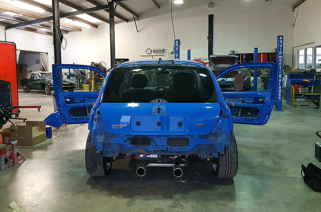

Did a bit more on the RB.

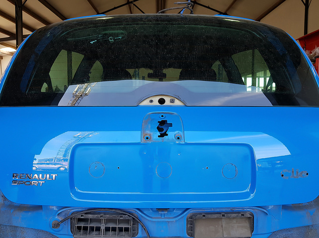

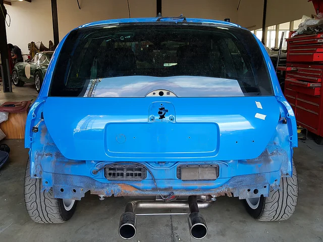

Removed the rear badges:

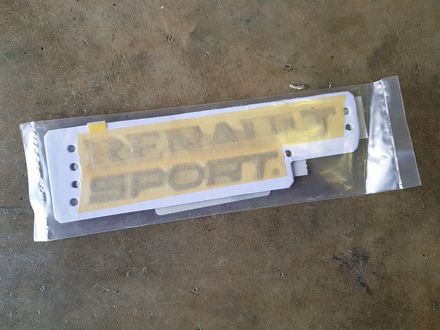

I have ordered a new genuine "Clio" badge and a new genuine 197 "Renault Sport" to replace the one i've removed. I didn't want the original one on and prefer the 197 look to the newer ones. Plus it matches my steering wheel and clock bezel stickers and now my new show plates.

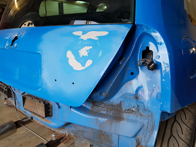

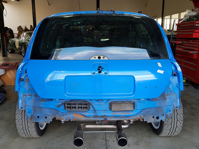

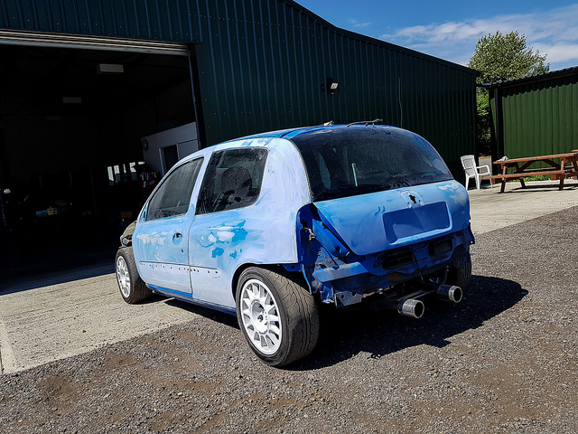

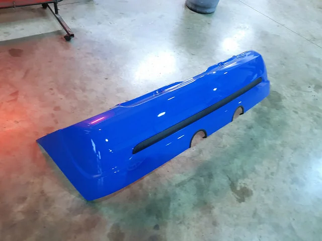

Made a start on the bodywork. Sanded it down and gave it the 1st skim of filler. Needs more fettling and to be honest i haven't got "the feel" for it yet so will need it looked over and added by better hands.
The rear was done due to having a bad repair prior to my ownership. Its never bothered me but seen as im doing the sides, i may as well do the rear.

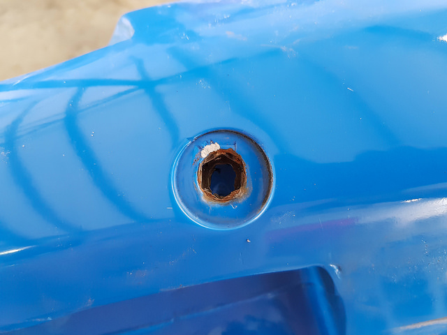

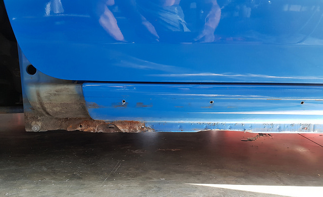

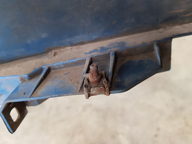

You'll notice that i have some surface rust on the rear and the sills. This is nothing major so i will give it some rust treatment and paint them. I also have some 1" x 1" box tube that ive drilled and will bolt them onto the back of the jacking points to add strength. These will bolt through the existing holes in the skirts so hopefully be hidden.

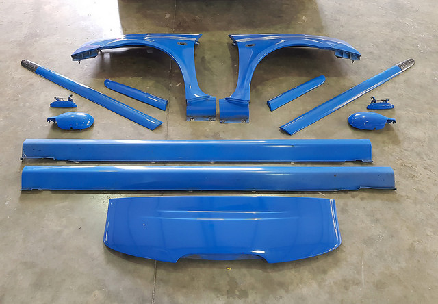

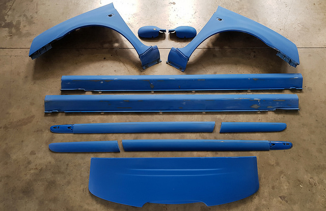

Here are the bits im prepping.
The badges will need redoing as they have chipped as you can see. Im contemplating doing them a slightly lighter grey such as Ford Polaris Grey, just like my inlets.

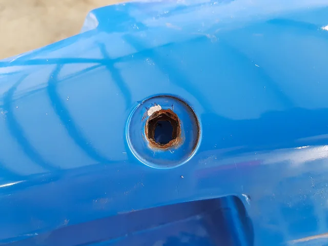

The one stubborn nut that didnt remove. A grinder fixed that!

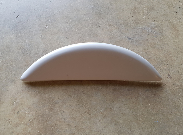

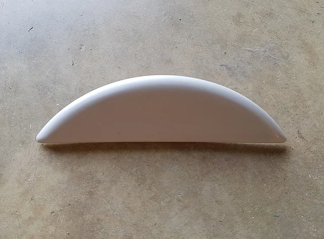

Due to me deciding to go wiperless, ive bought a wiper blank off one of the facebook pages. Once i receive it, i'll smooth it and paint it satin black. I have also bought a spare loom/plug for my broken wing mirror one. My original plan was to cut the wires and solder the new one on, but im told i can just use the black plug casing, which is what i think i've only broke. Will check later on. Also, as i'm going wiperless, i removed my rear washer jet. I did think about filing the hole but i think i will add a bung in there as its less work and i have some bungs here at work.

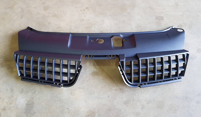

I've also ordered a new genuine front grill as mine was snapped. The top bit had only broken on one side but fell apart today. I remember grills being £40ish, but now they are £75! But i needed one so one was bought.

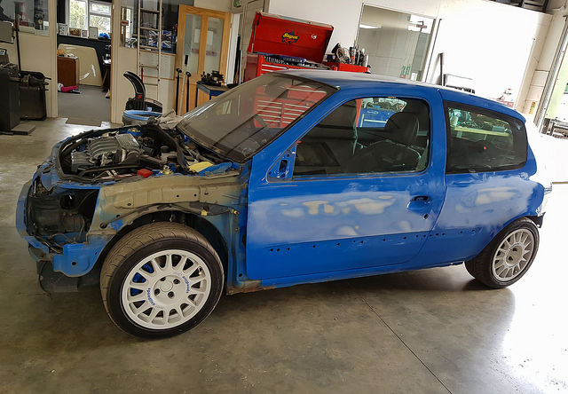

Got a bit more done.

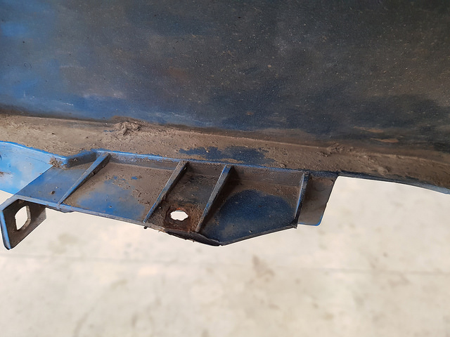

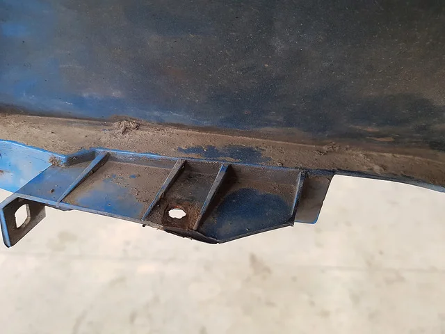

Jacking sills needed a bit of attention as mentoned earlier. I think jelly is stronger!
Gave the car a good scuff up all round.

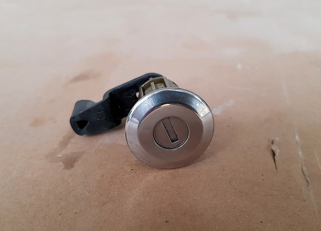

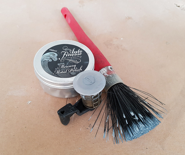

Gave the lock a clean up to as it was looking dull.

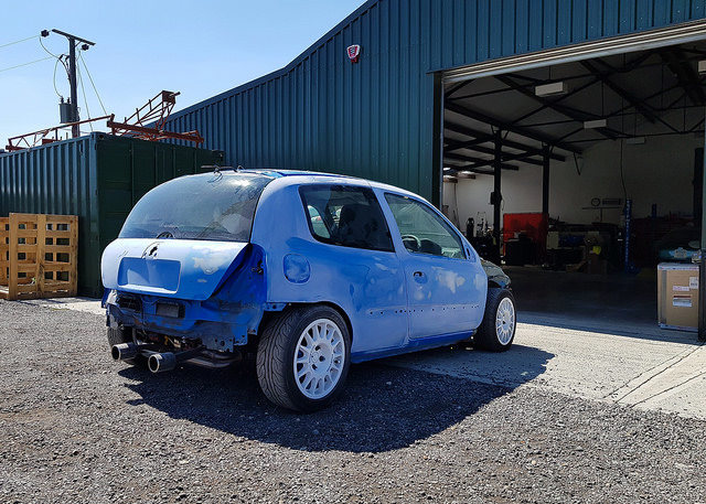

Then i had some lunch and enjoyed the rays. Had some house music going on in the background. I was on the farm on my own and life was good!
After this i did lose a bit of motivation but i did pick it up again.

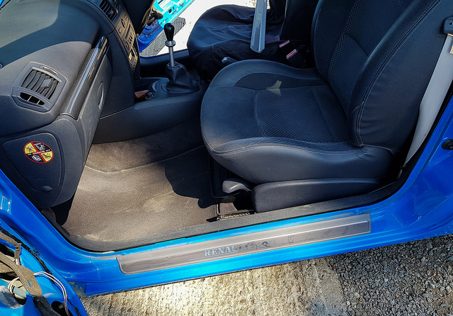

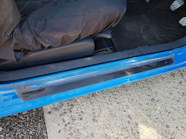

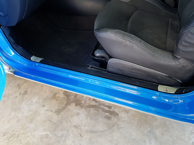

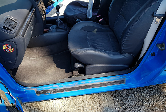

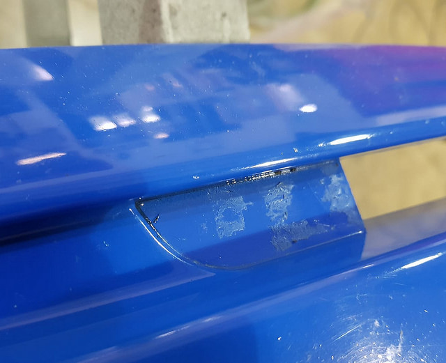

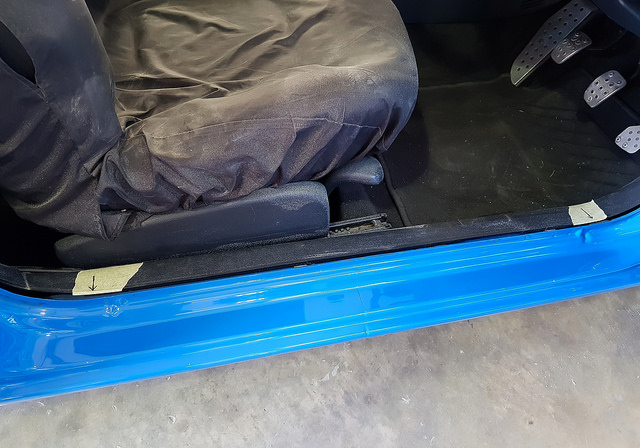

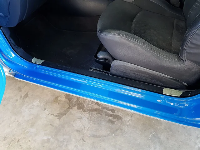

Kick plates removed

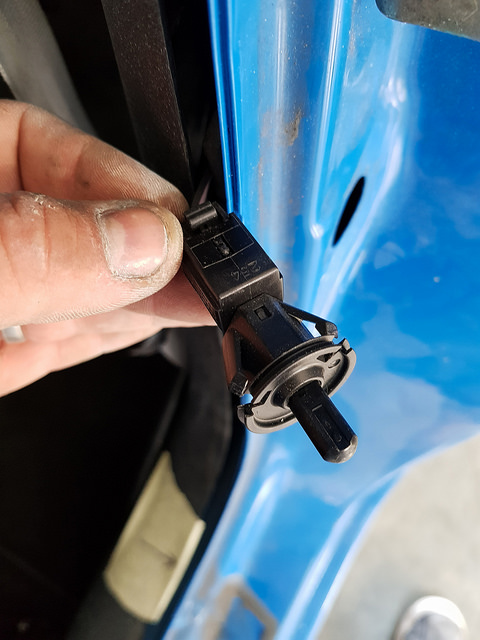

I removed the door sensors but broke a clip on each. Luckily a quick PM to @Mbeau sorted that out along with a replacement passenger window seal as i buggered mine up removing it. Top guy!

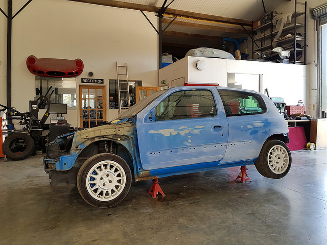

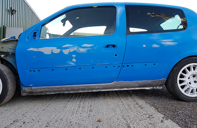

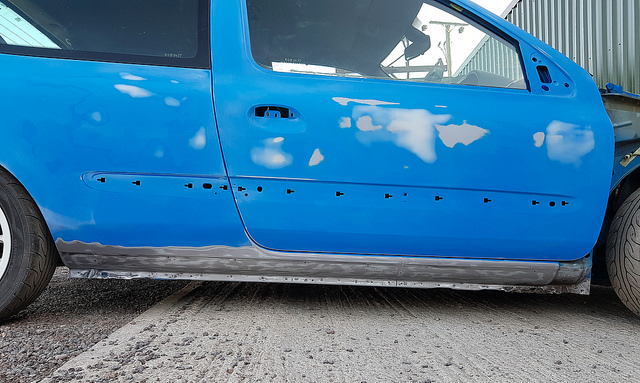

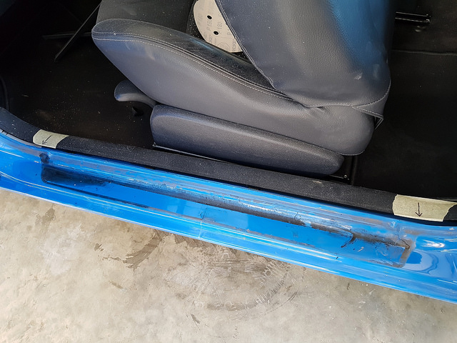

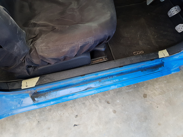

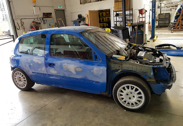

Then i pulled it into the workshop as i wanted to get the sills to bare metal. I was told to do this as most people sand the sills down then paint, but you have to get rid of the chips as it will eventually rust, so bare metal is the only way. Did this by using 80, 180 and 320 DA discs, then 400 onto the bodywork for a smooth blend and a zip wheel on a grinder for the hard to reach areas. Both these took so long and was time consuming. I adjusted the jacking points better too.
While the car was in, i finished removing the kick plate stickiness and gave the shuts a clean up.

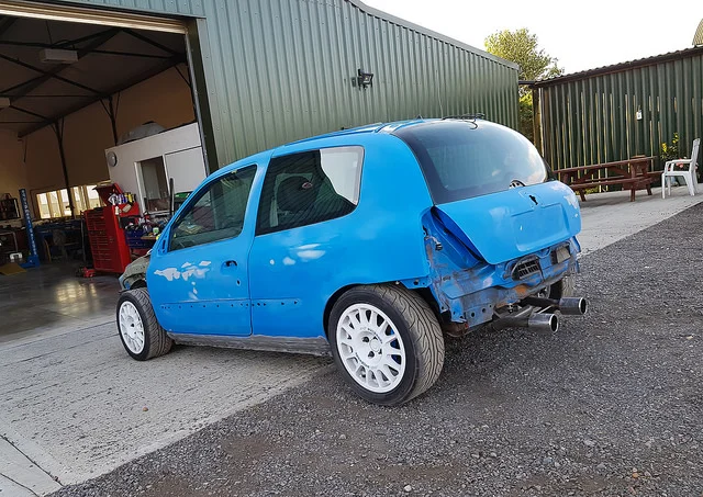

Sills done

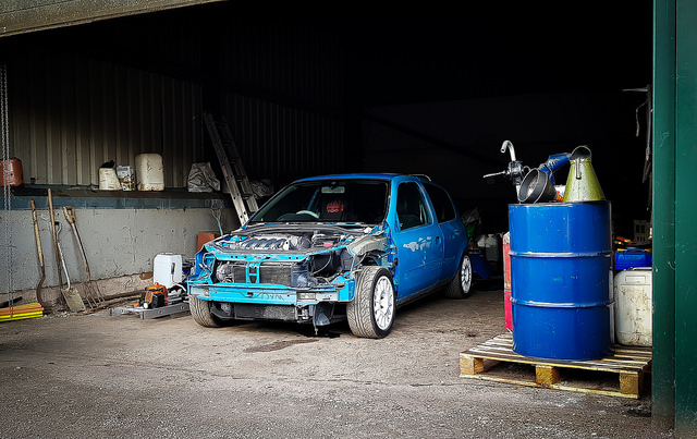

Then i got some pics before i parked it away.
And back in the barn (Slightly edited)

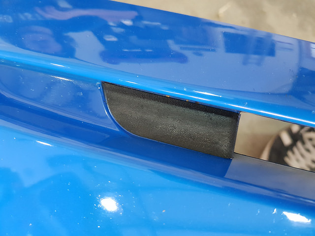

Today my new rear wiper blank arrived. Looks to be decent actually as its 3d printed.

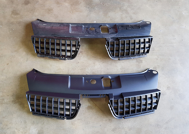

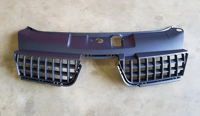

And my new front grill arrived too.
Old vs New

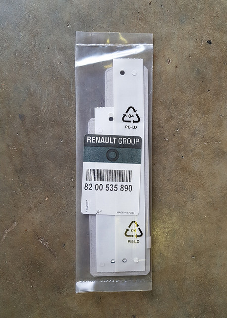

I would have thought this would of came with the stickered but it seemed not. Will do a message and get these ordered.
Lasty my 197 Badge turned up too.

Yeah it is Steve. Saying that, my old grill had been sprayed (prior to my ownership) so it was a satin black anyway. I'll get some cleaning stuff on it to keep it looking darker than it is now.
