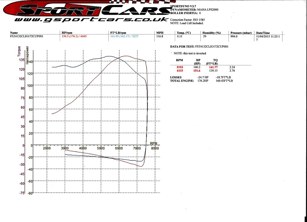

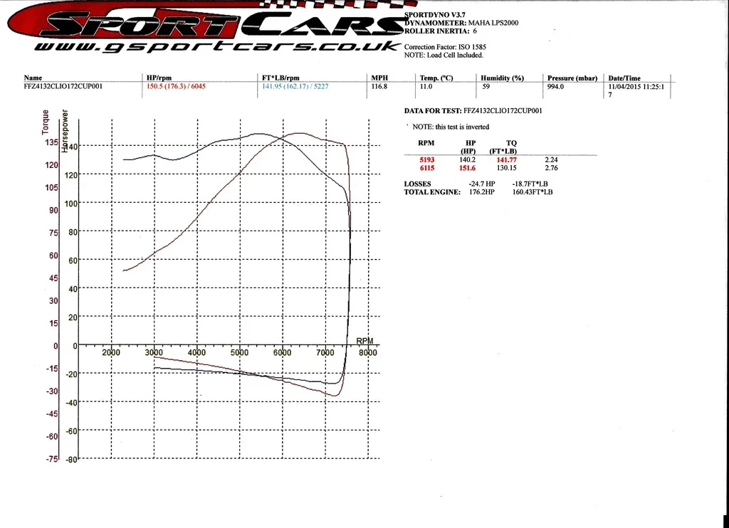

Didn't get a base/standard dyno run, but mine with RS tuner.......pretty healthy for an abused 13 year old cup!
