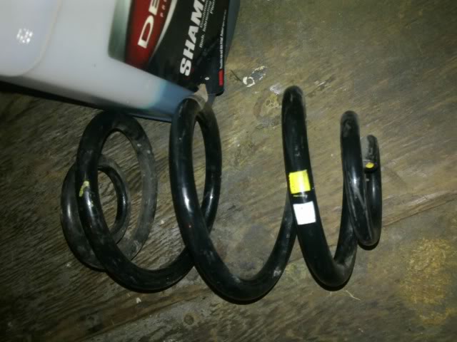

Cup spring have white and yellow markings on each spring
Really ... whereabouts? ... e.g. at the top and bottom, or on one of the coils? Pictures/weblinks would be ace if you have any
I couldn't see any markings at all on my springs, they just looked black

Here you go mate, should all have these markings on them. Mine all have (took off a Cup last weekend)

Also the new springs have the same colour markings as the old ones - thanks to 197gaz for the help on that :approve:
