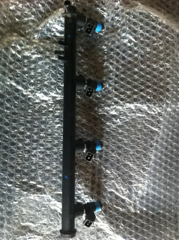

197/200 injectors are a strange type with a long tip. If you're buying new, get megane injectors
  Clio 172 ph2
buy a set of megane RS injectors, they will suit your requirements.
Are they 430cc? Isn't it too much?
Anyway - thank you for idea. I have Megane 225 too and it is stage 1 now. So I can buy new injectors for my Megane to make stage 2-3, and use the old original Megane's injectors for my Clio!!!!
  DON'T SEND ME PM'S!!
they're 440cc, but have a fantastic spray pattern and are very controllable at low duty. I used them on a ~200hp ITB'd F7R recently and they performed faultlessly and gave great accuracy
