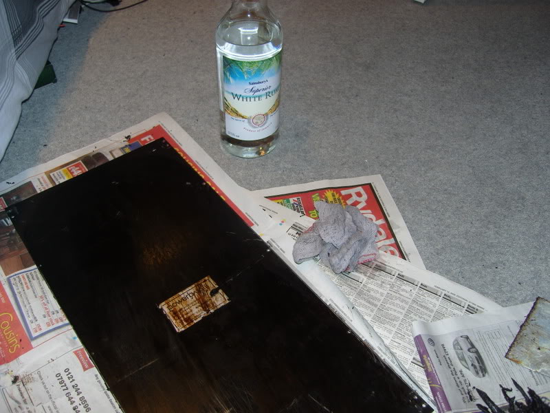

You're going to think i'm mad, but i used sainsbury's own gin. Basically cheap high strength alcohol, and a scraper. I had an amp which someone had plastered in a similar product, really tacky, but sludged not sheeted!
After about 2 minuted with the scraper it looked like this....

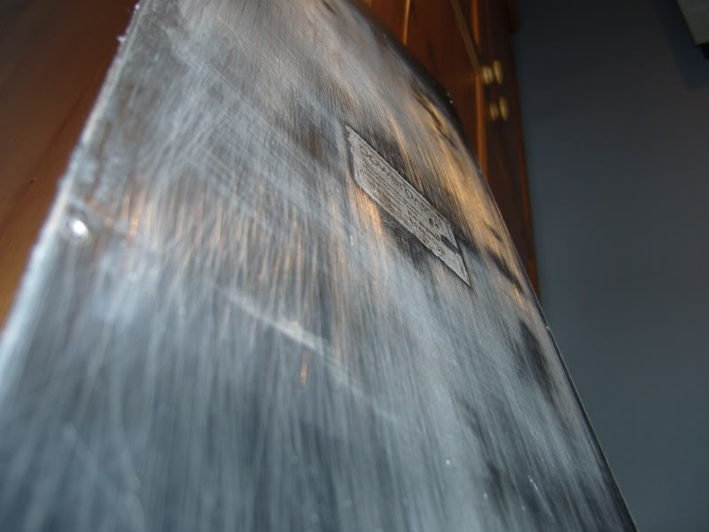

More work, to this:
