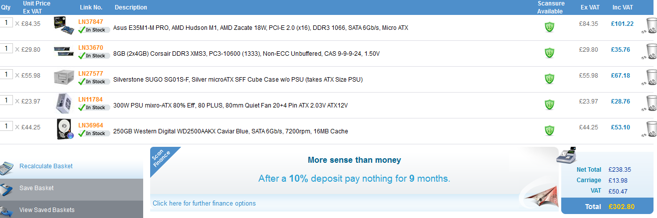

ahhhhhh dabs had put my order back another day so i cancelled it before work this morning.
decided to go on scan and pick in stock parts and it's already been picked about to be despatched!!
got a mobo/processor combo with no fan so i think it's basically a netbook in a small case lol.
still going to go with a SSD so silence will be golden for me.

Scan are by far the best at their game, they also use DPD for courier services which again are the best of them out there.
