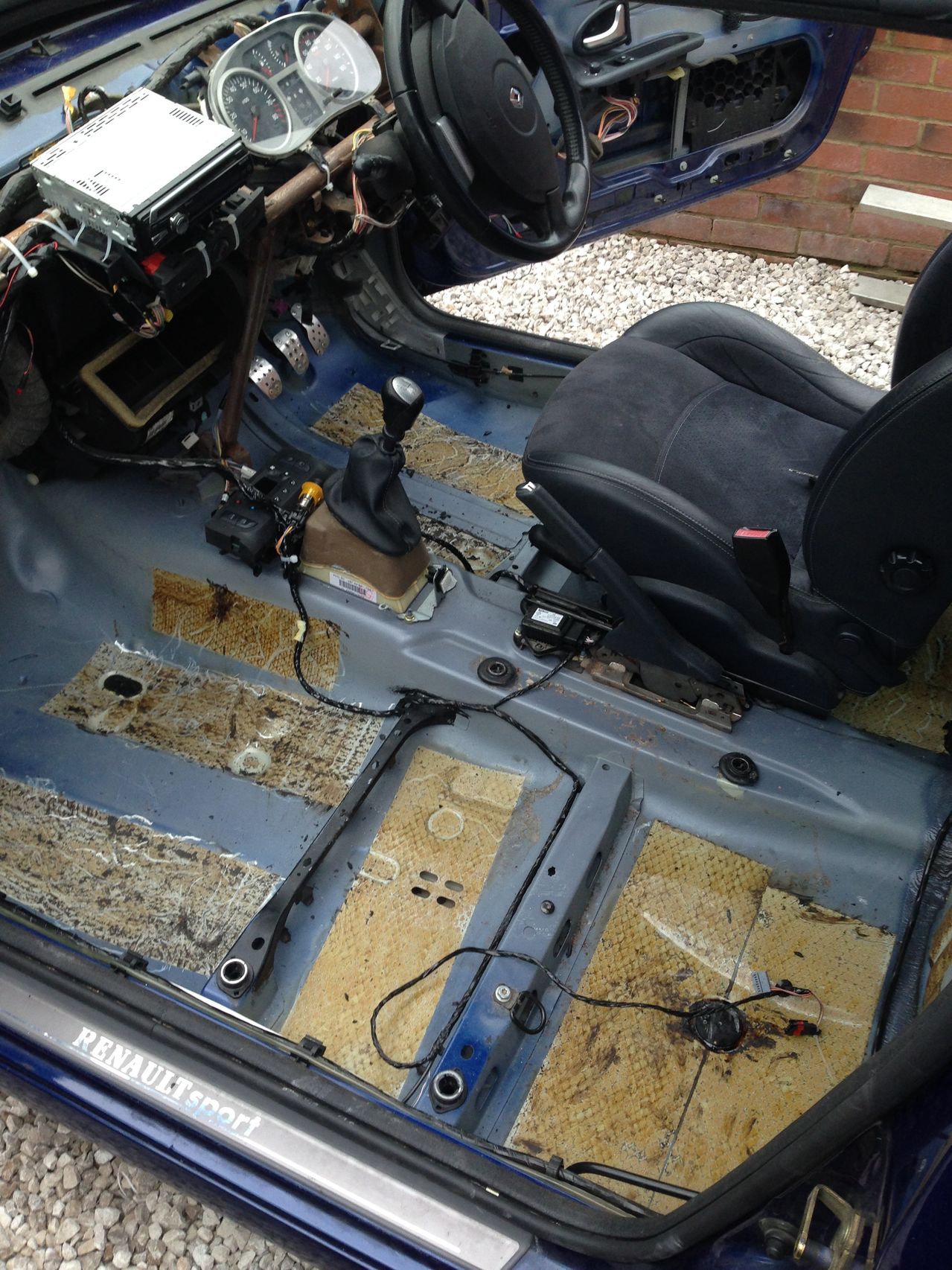

As per the title, has anyone found an easy way to remove these strips pictured without scratching the metalwork?

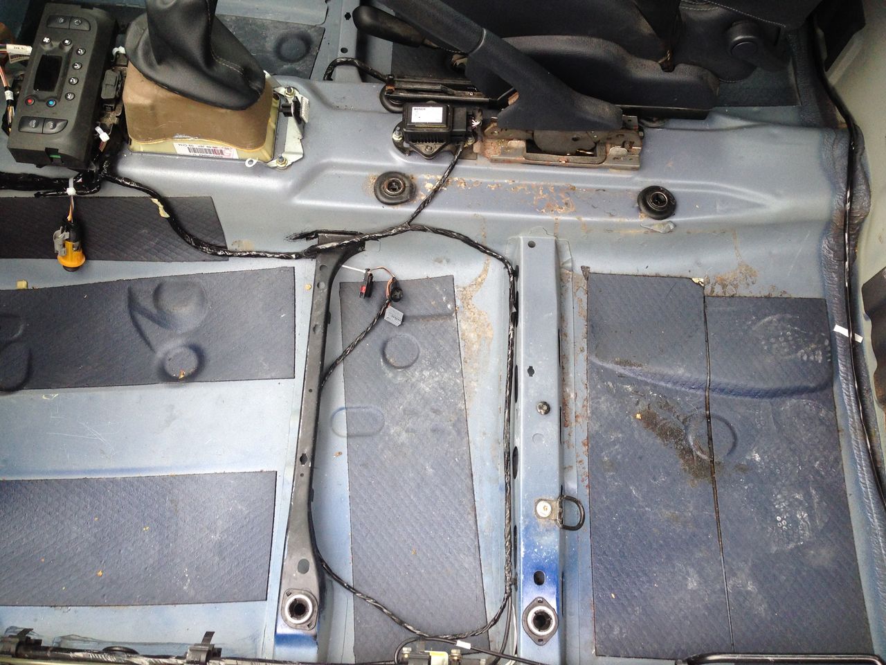

Well that wasn't too bad. Blow torch it until it turns greenish then it just peels off. beware of the fumes though, I think I might be slightly high on them.
Going to clean off the residue and then prep for its paint job.
