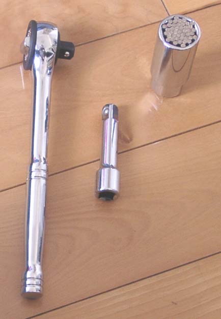

hey mate. This might work depending on your locking nuts, but it worked for me.
You can buy these sockets which come in alot of sizes and they have pine in the end. And when you put them round a bolt, it sorta moulds the shape.
Heres what they look like.
Hopes this helps. Sam!

that socket is a gator-grip. I've tried them for this and the pins came out like a nail bomb going off.
