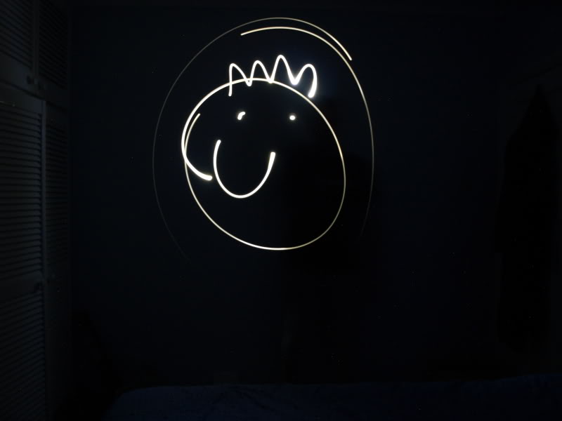

olympus e400, i'll try that later...here's the pic..photobucket has reuced it a fair bit but you can still see them...

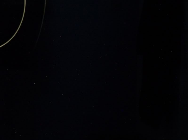

crop of same image..

My laptop screen is a mess, but it looks to me like dust particles in the air that are being lit up by the light?
Edit: maybe not, seems to be too many away from the light as well.

good point about the dust...i'll try some more later, with the lens cap on and outside, see what happens...

Some pixels have a different level of sensitivity to light than others. This only ever shows up during long exposures. Usually showing white (As shown in the image above). Most camera manufacturers allow single pixels as not being defective. If theres a cluster though they may under some circumstances repair/replace the sensor.
It's a tough one to argue with the manufacturer though, most don't want to know.
A simple test is to take a long exposure at wide aperture with the camera body cap on. Then view the image at 1:1.

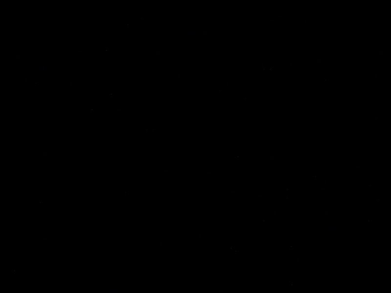

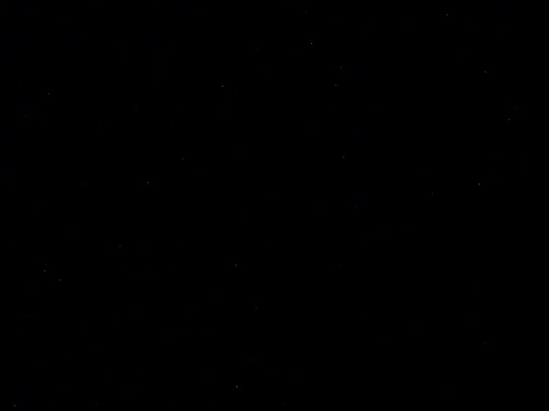

crop of bottom right corner
10s, f22, ISO100
just gave the lense and sensor a quick "blow" with my rocket blower thing and took another pic on exact same settings and the picture is exactly the same :(
hot pixels.
try the cure which works on canons it may or not work on yours.
take the lens off and switch the manual sensor cleaning system on so that the mirror lifts up. leave it like that for 2mins then switch off then on again. see if they are there.

ok so my camera seems to have a pixel mapping option, just done it and took another pic...
both the below are crops of the bottom right corner, one before the pixel mapping and one after...
before
after
much better :) might run it again a couple more times then try some more light graffiti now
