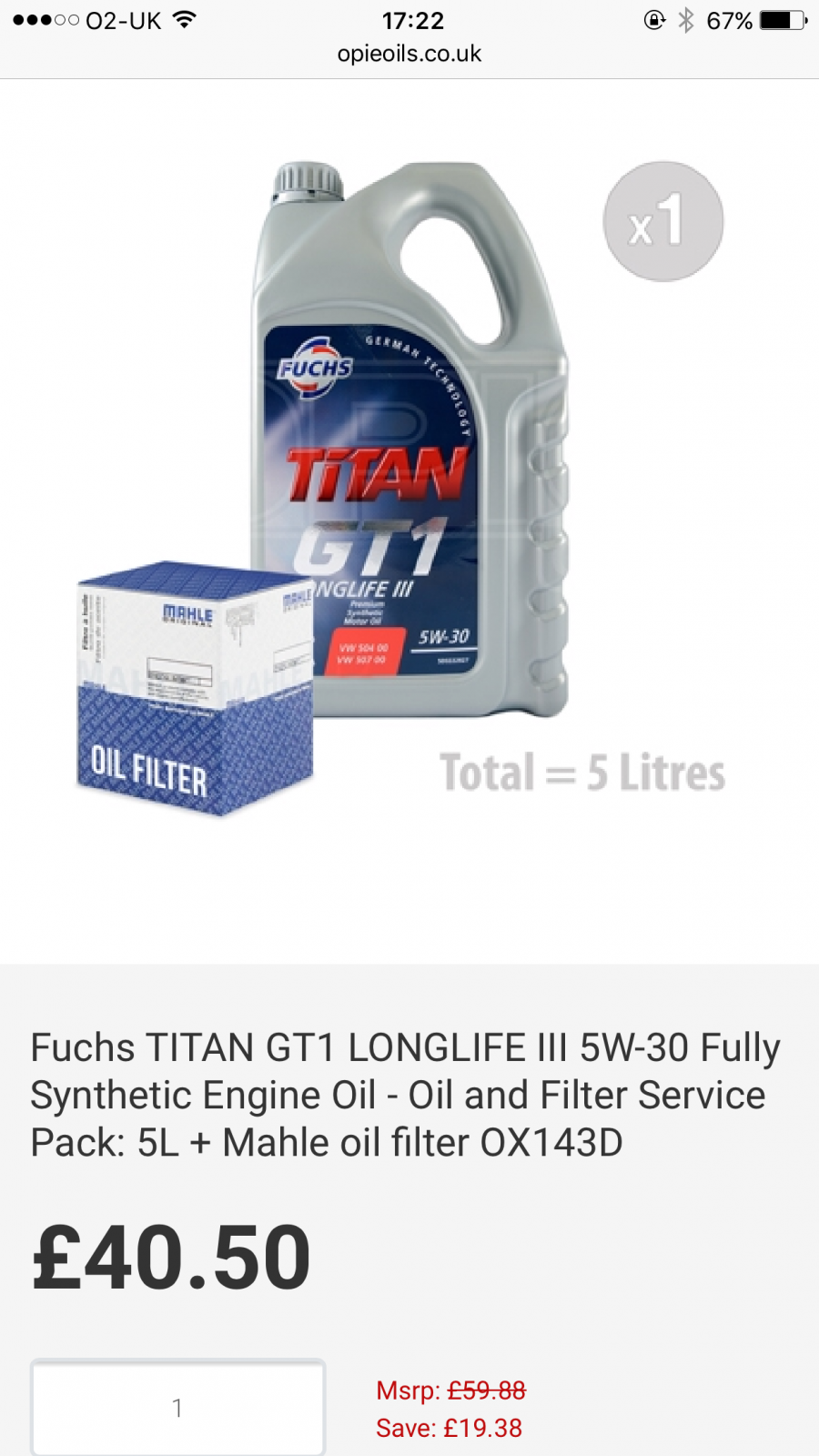

Cheers mate. Went for this, using their search to be sure:
Hopefully this stuff should be adequate?!
  mk1 Octavia VRS
It'll be fine but the Quantum oil is a fair bit cheaper, the same spec and is used by some VAG dealers.
