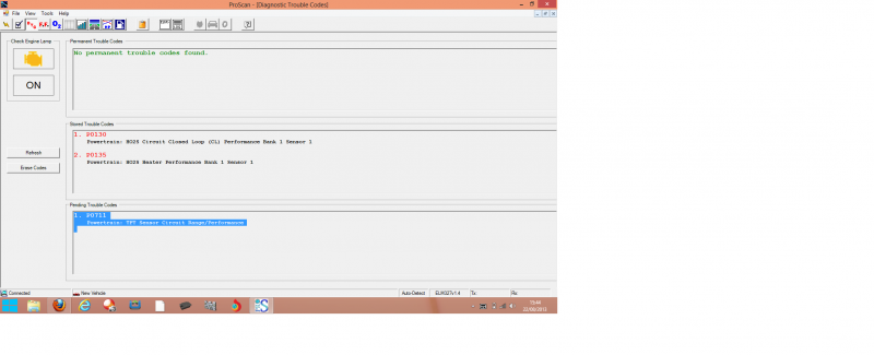

One of my mates came round with diagnostic software that he used on his 172 to diagnose faults and it has brought up the following code.
Does this code mean anything to anyone ?
H2OS codes i'm guessing are due to de-cat and lambda sensor :boring:
Could my TB, plugs, coil pack or leads be on there way out ?
As they are less than 10k miles old.
Could the transmission code be a bad earth somewhere ?
I have since cleared the codes and ran the car, but yet the idle is all over the place and brought the Transmission code up again.

could be a dogey crank sensor try removing it and cleaning it .... but either that or map sensor had a saxo with similar probs was the map sensor in the end

Cleaning TDC as we speak, as its the one sensor i forgot to clean.

That's the same software i've got and that fault always comes up on mine. My car runs fine so don't think that's your problem

The TDC sensor is clean and it's still doing it.

i can't find anyone with CLIP neither bar the main dealer to confirm if the transmission code is a generic fault as Paul mentioned :-(
