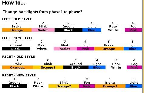

can anyone tell me what wires to change around,
ino sidelights and brakes are on bottom and fog on top and indicator and reverse need swapping round. but which wires

I have the wiring guide at home if you send me your email addy ill do it then
If you search for Day he usually is the first to post it up

ta lads, quick question how do u get the wee clips out, with the wiring. i just broke 1 which didnt do me any good. i lifted up the cover part and then had a wee look at wires etc and pushed them up. but they wern't coming out.

I'm going to start charging for my light changing services soon ;)
