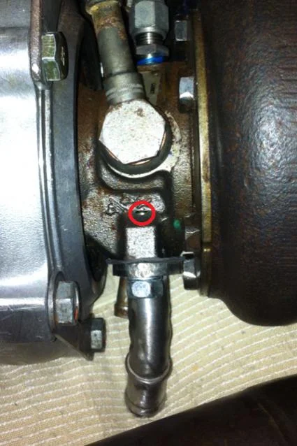

hi got this garrett gt28 turbo abit ago and finally have all the parts but i noticed on my turbo before there seems to be a small hole! is this normal? ther doesnt seem to be any dent and the metal seems fairly fin, hopefully you can see from the photo. any help will be greatly appreciated as im ment to be booking it in for full installation in april.

  clio 182
FALSE ALARM! its just the bloody taping hole for the bolt! i s**t myself, thought oil was gona be pissin out. on the other hand tho i the turbine has a small bit of play in it, ive heard some people say thats normal? doesnt seem too bad but i dont no much about them.

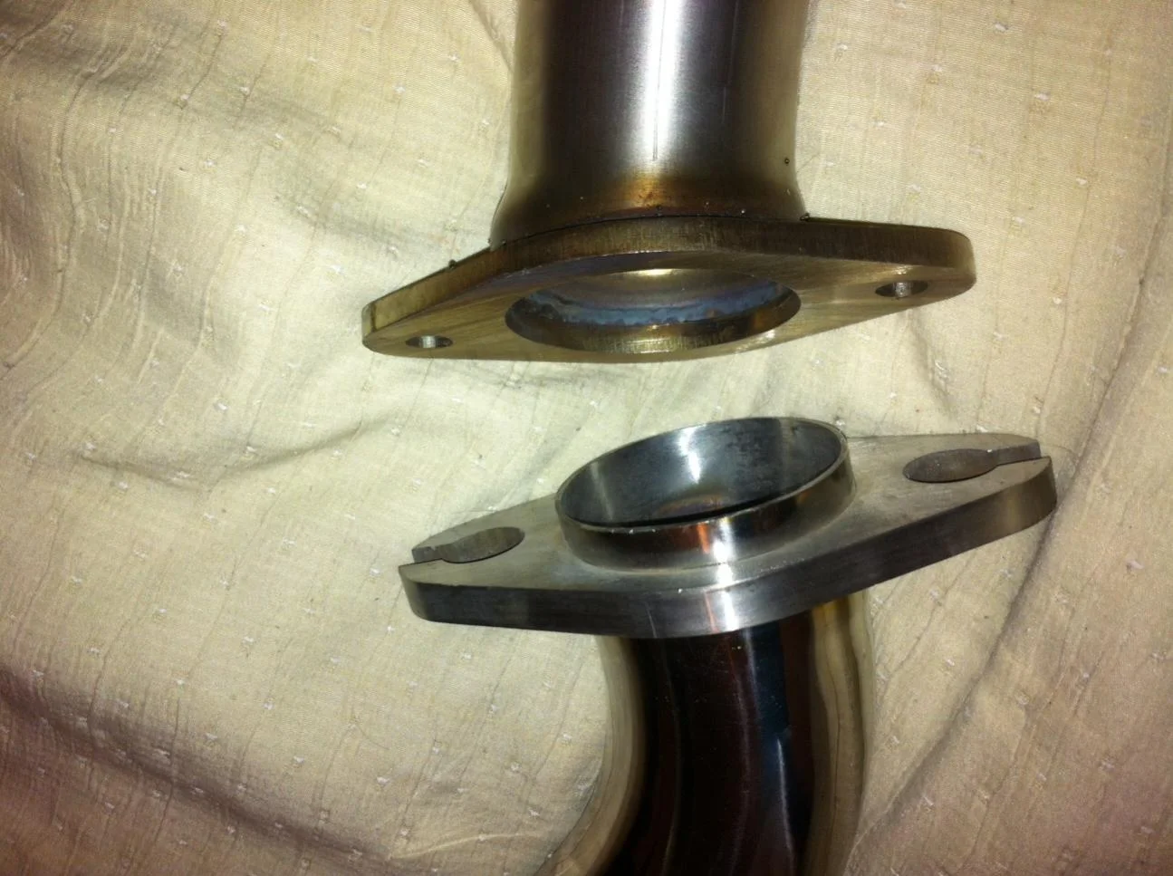

also any 1 ever used ktecs 182 link pipe and ED's v-bad down pipe? they dont seem to join well, i was told by Engine Dynamics there compatible but the pipes dont join in together, can it be fabricated easily? im getting it all fitted by chris at efi so im sure he could sort them out, they seem to be in the right place, just need the bit on the downpipe ground off or somethng so they can join. hope this picture descibes it beter for you.

  clio 182
il have to just instal it and get it refurbed at a later date, i was told it still had plenty of life in it. should be fine for a wile. il have to refurb it when ive got some funds again. this whole turbo thing aint a cheap route to go down!
