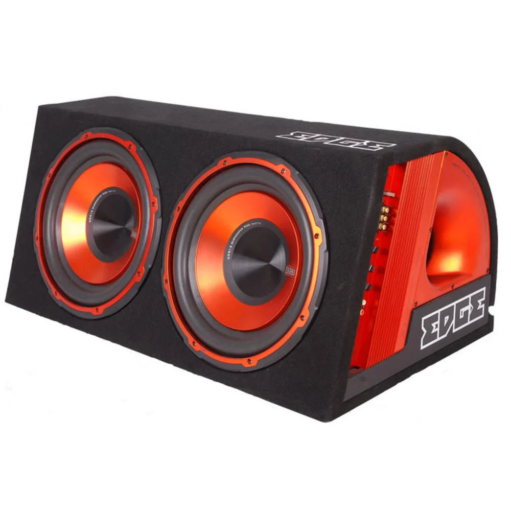

try having one of these in ya boot, fills the whole thing lmao. i wired a kettle lead into mine so a nice easy plug and play! 2 minutes later, ready for the shopping at b and q lmao:
Power Output: 1800 watts (600W RMS) OHHHH YERRR
one thing that does piss me off is the light in the boot is on the left and the dials are on the right. going to fix that soon tho :p
i wired the earth onto that boot bolt too mate, went direct from the battery, no faffing about then with lights an shizz
