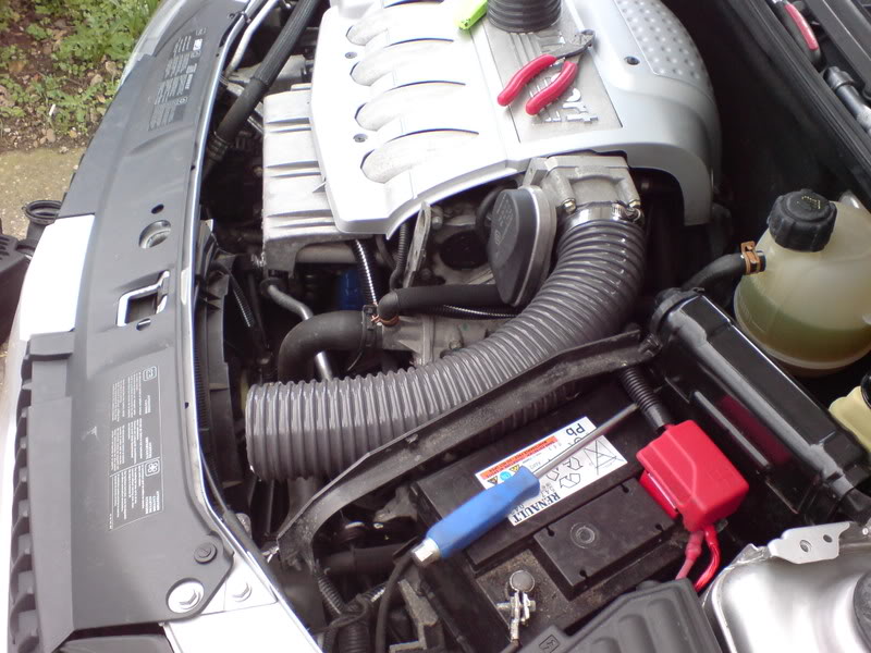

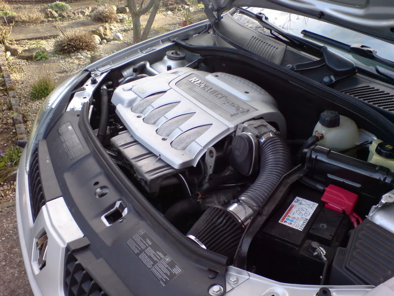

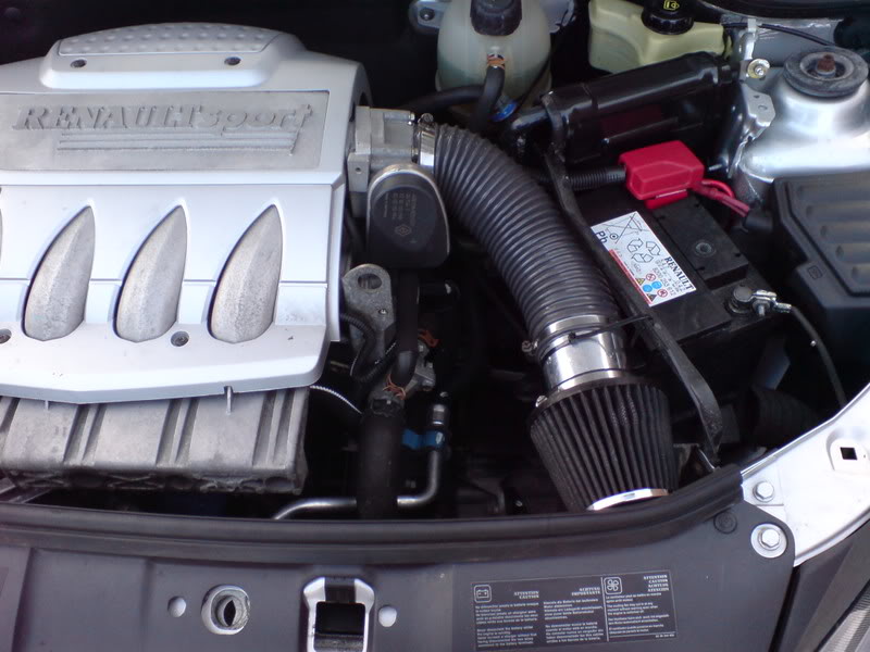

Well today i set about putting a cold air feed in from the foglight...but looking at how much space i didnt have i decided to make my own intake system. here it is

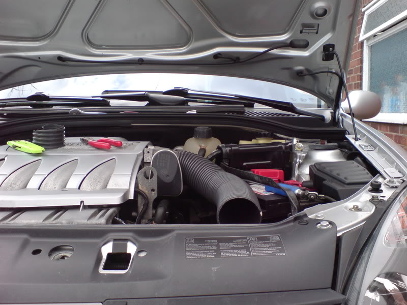

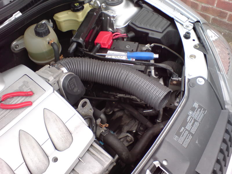

how it started:
halfway through:
and the finished article:
love it, happy with it, though i need a bigger filter as the one is a fiesta rs turbo one and is tiny but its all i could fit on it. guess ill have to get a mushroom filter when i get paid. the mod cost me nothing and i might aswell try bits out so i can make something from stainless to sell. cant wait to get it on throttle bodies :)

also that filter seems to sit right behind the radiator mate,so surely apart from sucking in the hot air in the engine bay its going to be having the hot air from the rad too?
  2002 172
yes, the first is just for refernce as i always forget to taking starting pics. the tubing will not close under full throttle as it has strong plasticaround it to stop it closing.
  2002 172
probably will but find me a better place to put the filter?
  phase 1 172
what material is that and where did you get it?
as for location it might be worth extending it behind the front light where the standard air feeds are, that way its away from the radiator and the coolant hose
  2002 172
a friend gave me it a while ago to use as a cold air feed on my old ibiza turbo. i think it may be pond hosing? i would extend it but there will still be heat anywhere under the bonnet to be honest. the plan will be when i get time to relocate the filter in a box, somewhere away from everything.
  53 Clio's & counting
i was gonna say matey for noise its great but if its power then prob the std filter would be better? under bonnet heat is such a killer :(
  phase 1 172
if you`ve got enough go jap style and lower it further into the engine bay and creat a shield from road spray
  2002 172
the plan was to either fit a slight shorter radiator as ill need this for my itb's anyway. or to put the filter behind the bumper shielded fr everything with one air feed going straight to its box, like a bmc. trying different things to develop something and market it.
