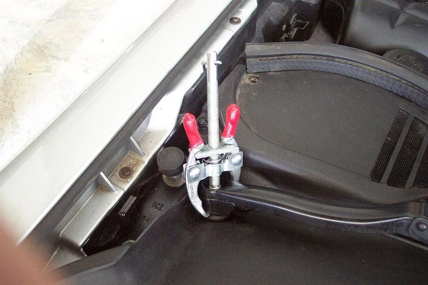

I tried with a windscreen wiper arm puller and they would not budge, until I applied some heat. 30 secs to remove then!

If you have a small puller available like below, it can help pop the arm off:
