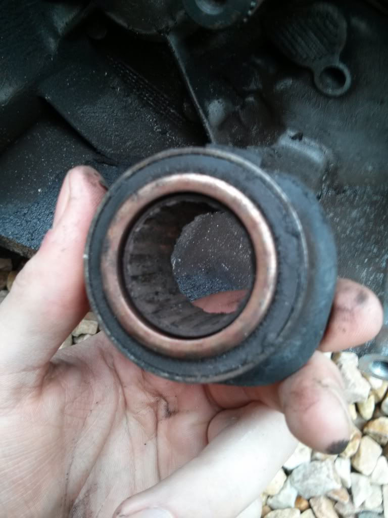

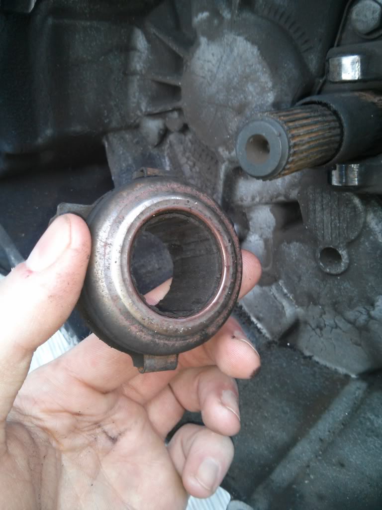

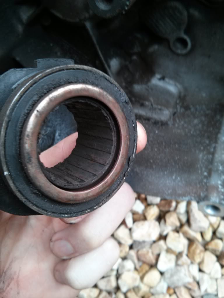

Do you think either of these relsese bearing are good enough to put back on the car?
1.
2
  182cup & 172 racecar
If you have gone to all that trouble to get the box out, change the clutch as well, it will come with a new bearing.
Can only by tell by feel really.
What should it feel like? First time doing a clutch/release bearing.
Was going to do the clutch but not really bothered about taking the box back out the car, so just going to leave it. And it was apparently done by the last owner.

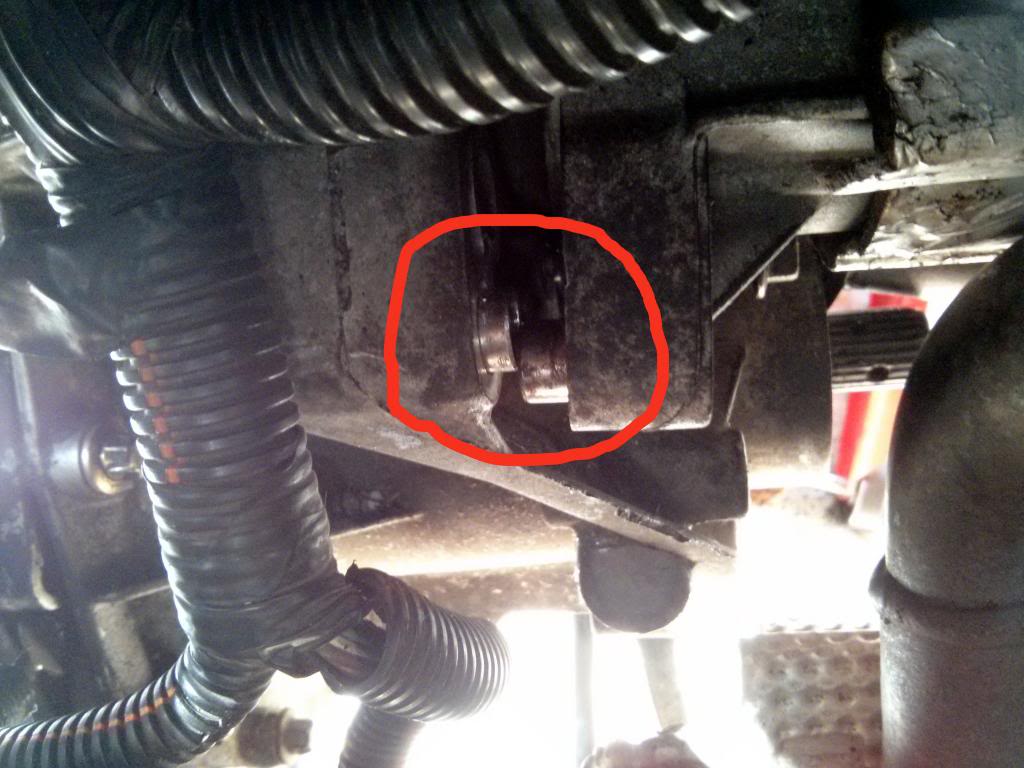

Here my problem :

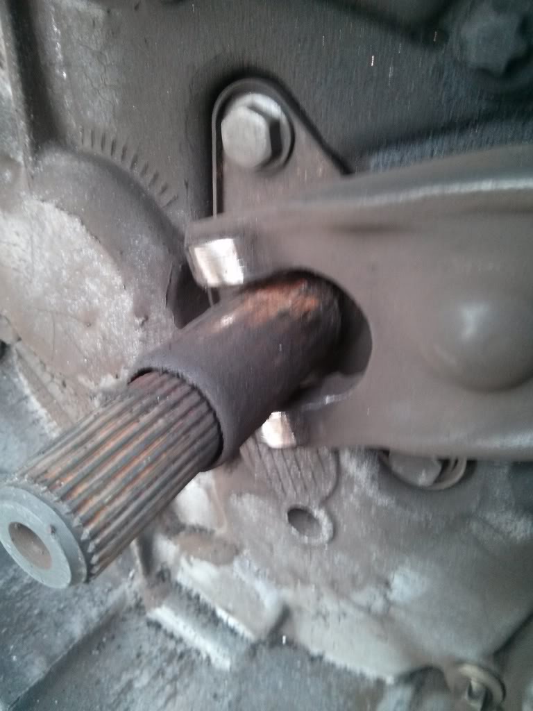

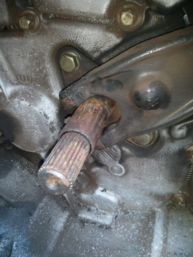

Looks like the to inserts are the same size, and when trying to bolt it up the starter is not going flush with the gearbox because of it. And just had a quick look at the old gearbox and it doesn't have the same insert sticking out, my own fault for rushing I suppose :dapprove:
Anyway to fix it apart from taking the gearbox or stater motor back off?

Fiddly but think it does come out without the manifold having to be taken off. Basically impossible to get the heatshield on afterwards though
Cheers will have a go tomorrow if the weather is ok!
Will see what I van do about the heat shield though, don't fancy leaving it off with the starter being that close to the manifold :rasp:
  clio sport ph 1
This how I placed a jb1 gearbox on my clio sport;) . Just pull out the inserts there are multiple holes for it!! Housing for gearbox is the same .
Starter has also multiple holes I thought not sure

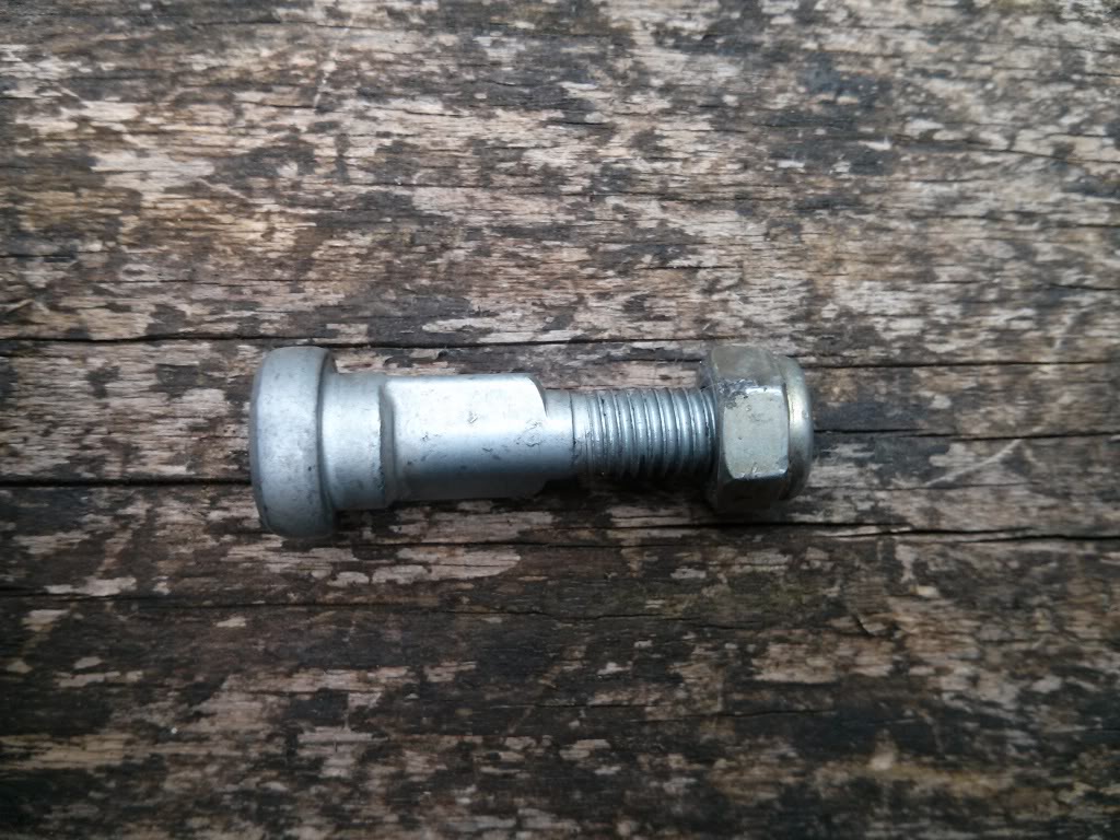

This is the bolt I mean:

There is no hole on the rack, the column connection passes over it and then the bolt goes through the connection and the flat part of the bolt you have pictured holds it :) If you cant get the bolt through the connection then you have got the connection 180 degree's out so spin it round and then it will be fine

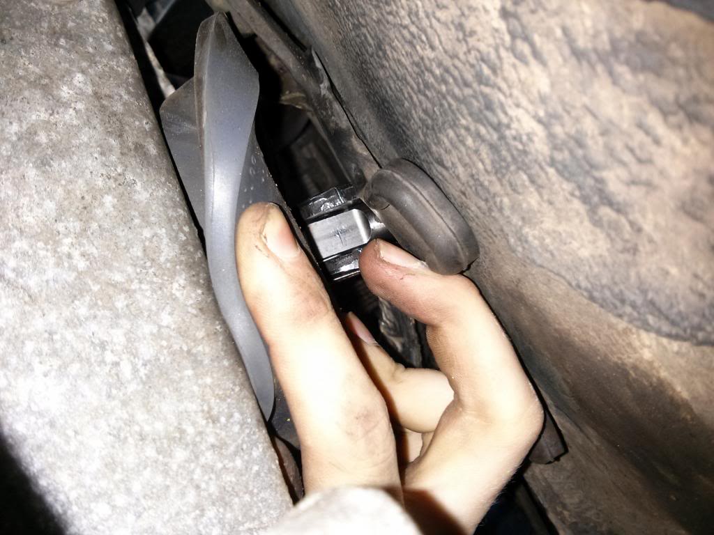

Here is a photo from underneath:
Everything is lining up, as in the 'nick' you can see on the rack lines up with the middle of the holes in column. But it still wont go far enough in to get the bolt through though :S
The sub frame is bolted up properly now as well.

Can't you now turn the wheel to show you the bolt hole and why it won't line up?
Out the top FTW. (;

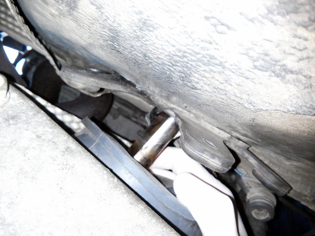

Was hard to get a photo of it. But it does look and feel like its lined up tbh and the nick lines up with the holes so surly it should fit together? :S

Can you not try and put a smaller punch/screwdriver through the hole first to see if that centralises it?
Could be slightly out, and that would be enough to stop a threaded bolt going through...

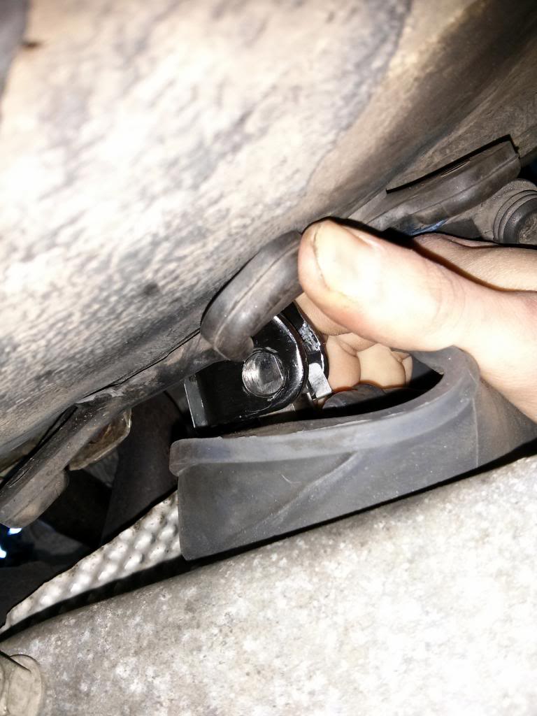

Here's a photo of the side of them:
Can't really see it from the angle but there is a hole, gets bigger if you wiggle the column about as well, so will try and find something to stick through it, to try and centre it....
