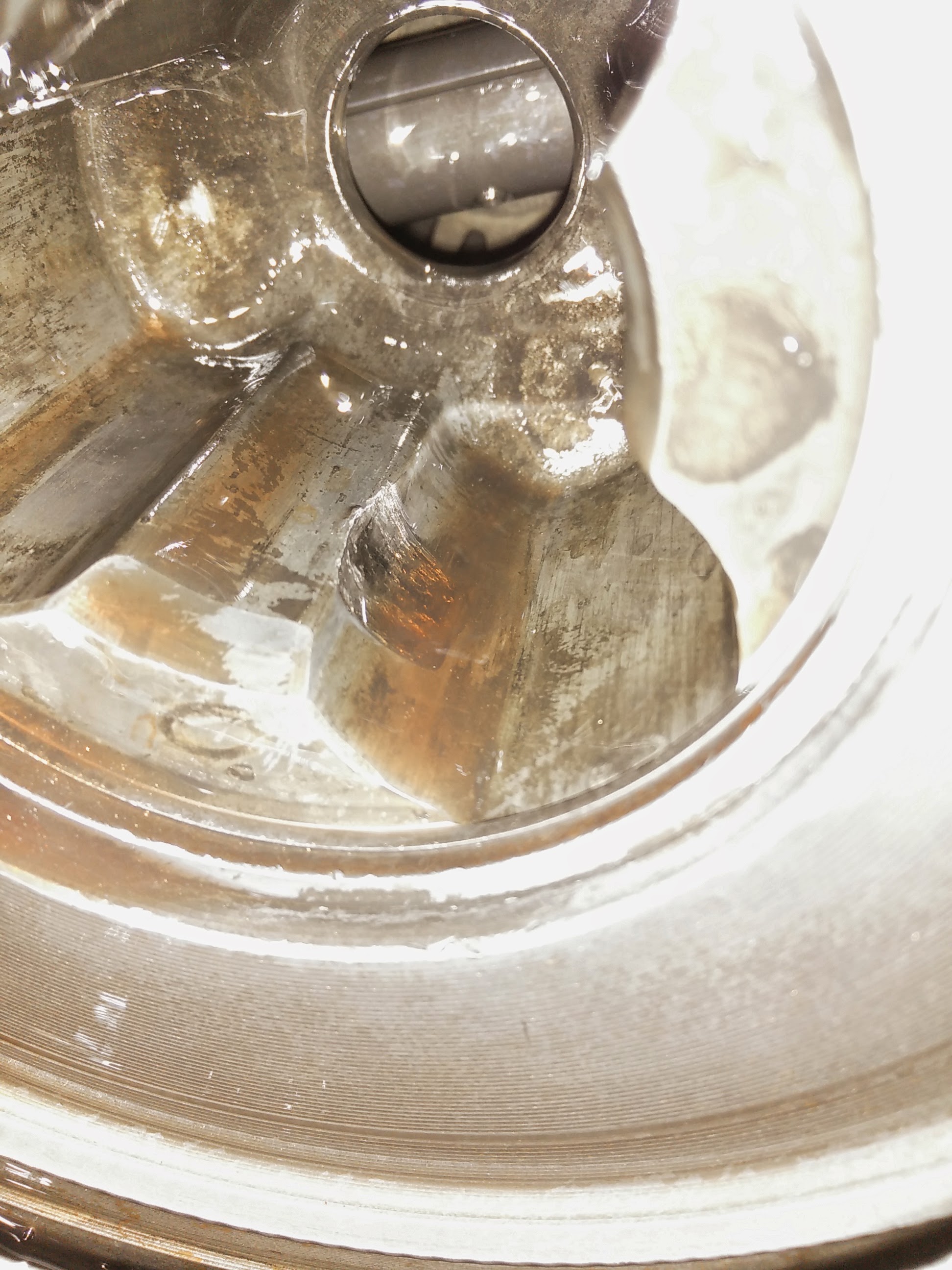

So my best option is most likely to refurb the spare box I have? I'll dig out a picture of the diff bit that's damaged. As said, apart from that bit, I'm 99% sure it's a much better box. Only thing I ever remember from it was a crunch into 3rd when hammering it on track.

I think I've seen it before tbh mate. Sure you sent it me in a pm? The spare box sounds the better option for definite then if it's only 3rd.
sburrell93
Scotland - South
Damaged bit of the diff as mentioned above
