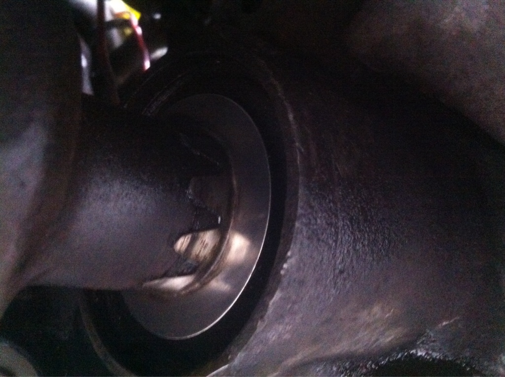

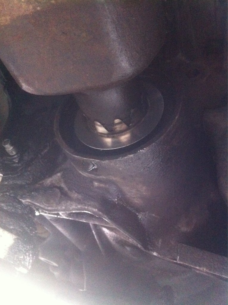

Have cleaned it all up, and it's leaking from the drivers driveshaft output seal.
Pics:

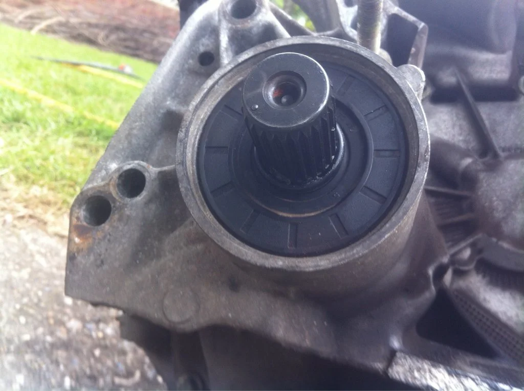

Seal in more detail on a spare box I have:
Anyone know if it's as simple as pull the old seal out and replace? Seal available seperately?
Will give Agency a call on Tuesday and find out if nobody knows.

I've never had to do one on a Clio but usually it's an item that available seperately and cheaply. Nice and easy to change usually just be careful and don't bend it

Luckily, it's pissing out at the minute, so will have to source one pretty sharpish.
Never seen one leak there on a Clio either. Freak of a car.

I done s**t loads on my old E box I had on the punto and a few pug ones, both times only the main dealer managed to supple decent ones.

Just looks like a standard lip seal mate.
Should have the size on the seal?
  330i. E30 Touring.
Had a look online, and seems the seal set can be had for a tenner,
Result.
Will order one, and hope it's right.

Pretty easy to replace just ensure its in square. :)
