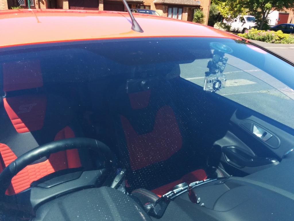

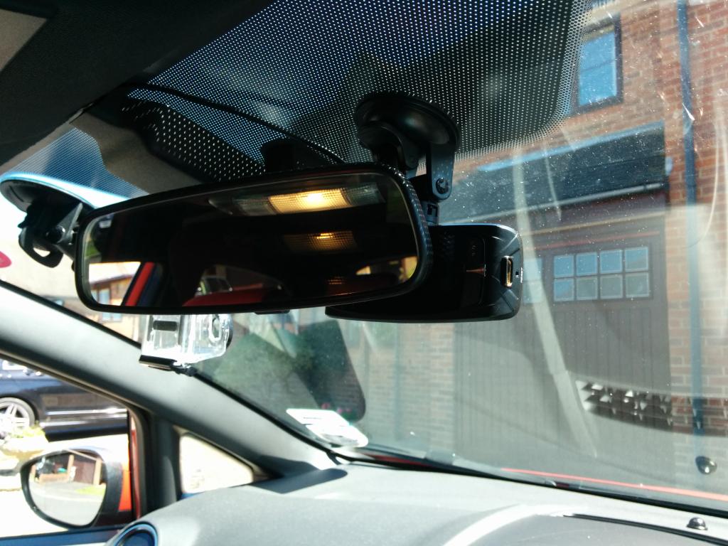

I'll get it mounted better than it is...I'm going to butcher the mirror clamp to make a small pad I can stick up high behind the mirror, I'll end up not being able to see it while driving along. That's small enough for me.
For what it cost it's incredible value in my opinion. I'm definitely getting a second one for the rear.

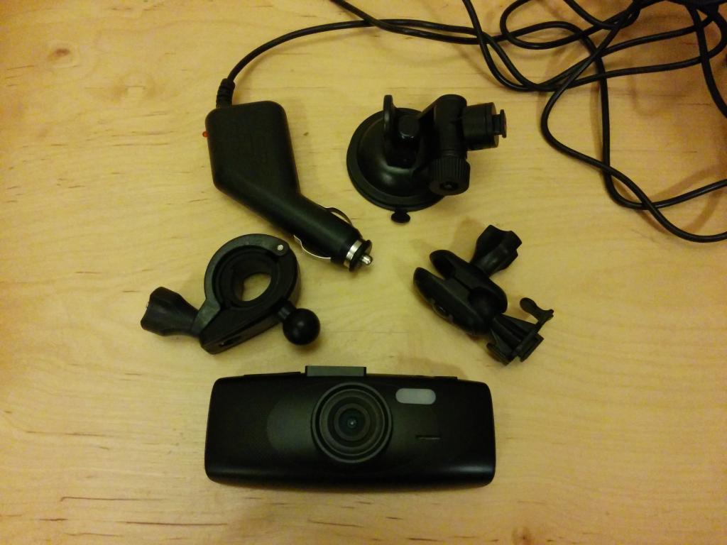

That's a link to the G1W which has a 120 degree angle and a bright shiny large silver bezel around the lens. The G1WH I have has the black bezel as per my picture, a 140 degree viewing angle and something else internal is improved as well I think.
Search the sellers's shop for his other bundles, I got the G1WH + the double-jointed-clamp-mount + 32gb micro-SD card. I thought as a bundle it was easily worth £47.50 considering a few have had issues with certain memory cards/classes not registering in the camera. The one this came with has worked fine straight out of the box.
