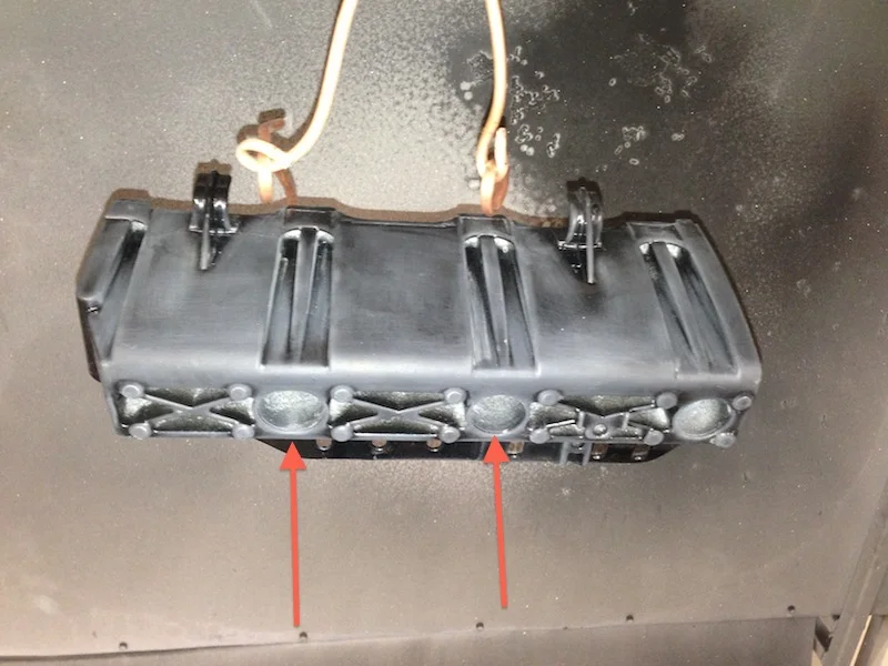

How do you remove it???
M Madmatt racing Jun 26, 2013 #2 2 13mm bolts I believe from the holes at the front , smaller the socket the better
sam_clio182 renault clio 182 Jun 26, 2013 #4 It's two 10mm bolts you will need a socket extension also too get into them or I did at least
Carbonraider ClioSport Club Member Raider, 172, the van Jun 26, 2013 #5 sam_clio182 said: It's two 10mm bolts you will need a socket extension also too get into them or I did at least Click to expand... I'm sure there nuts...

MarcB ClioSport Club Member Too Many Jun 26, 2013 #6 There is two 10mm nuts in the front of the guard. The 2 red arrows show where the nuts are.
sam_clio182 renault clio 182 Jun 26, 2013 #8 Carbonraider said: I'm sure there nuts... Click to expand... My bad yes you are correct no idea why I wrote bolts there's nuts lol

Jekyll ClioSport Club Member Racing Blue 182 Jun 26, 2013 #10 Yep, definately 2x 10mm nuts. You'll need a small extension on a 3/8th or 1/4 drive. Be careful not to drop the nuts!
