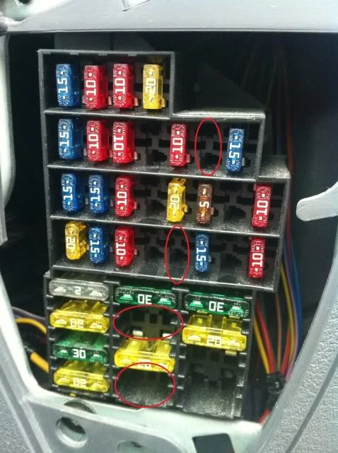

I haven't as I don't have the manual to know what's what in the fuse box thing! But I presumed the front and rear side lights would be running off the same fuse?
  CLIO PH1 172
on the passenger side of the front dash have a look in that fuse box there is a diagram on the back showing what fuses you need for the lights

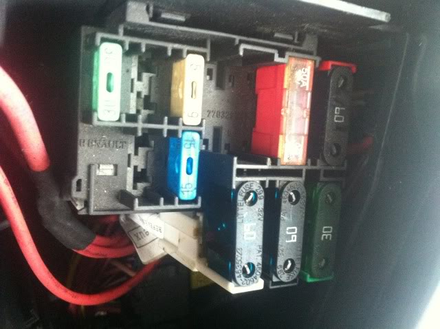

Near the battery you have another fuse box. The headlights fuse are normally Red and rating 10A, one for each side. See if that ones are burned.
had a quick look, there are no 10A fuses there? am I missing them?

I do have a few fuses missing where it says there should be some on the diagram, but I presumed that's because they're for features my car doesn't have?
Picture:
Sorry mate, now I see that your car is a Clio II. When I first read I was mistaken and saw wrongly. In the Clio III that applies, you have at total 3 fuse box: One inside the car on the right bellow side of the steering wheel, one in the motor bay below the battery box and one on the right side of the battery. That´s one have the lights fuse. One time I blew all the lights from the left side of the car (touched with a flat screwdriver on the contacts that hold the lamp on the registry plate and blew the fuse) and the one that blew were in that fuse box.

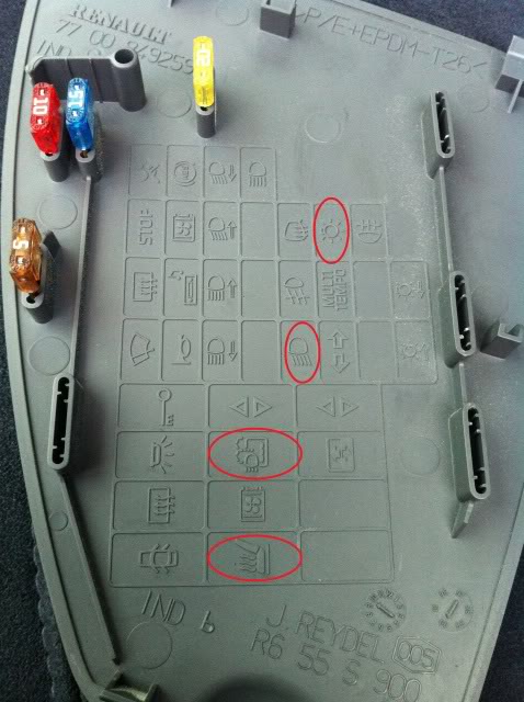

glad for this photo...my fogs weren't working, i know they had before...the bloody fog light fuse was missing (guess someone's been playing silly buggers with me). i knew which slot it was & i obviously have spare fuses, but not what strength fuse should go in...stupid service book didn't tell me that
