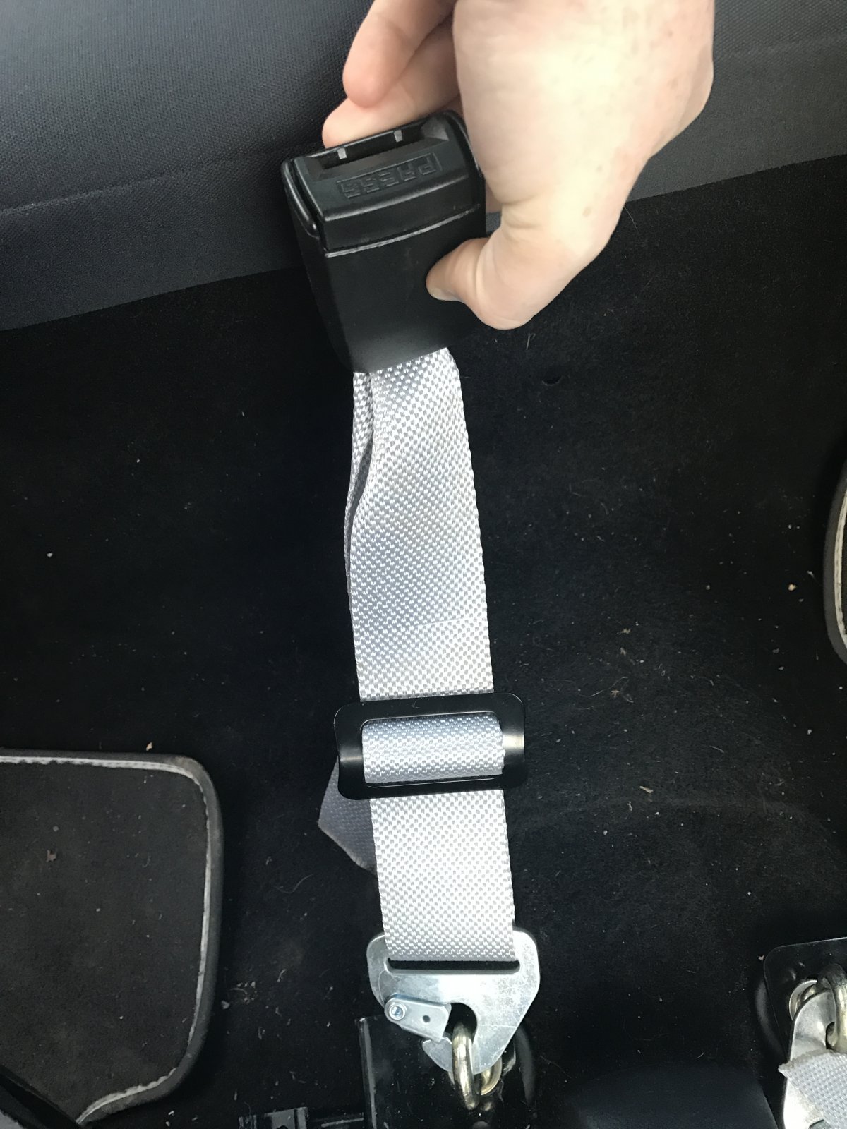

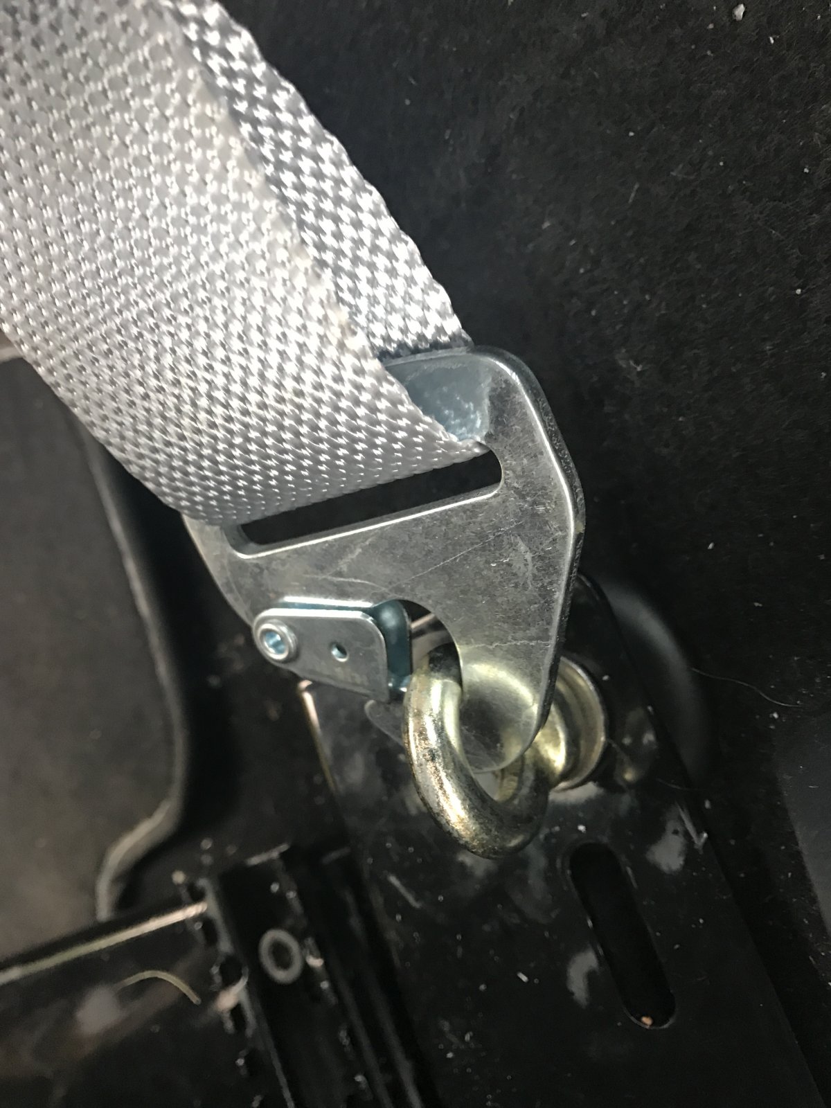

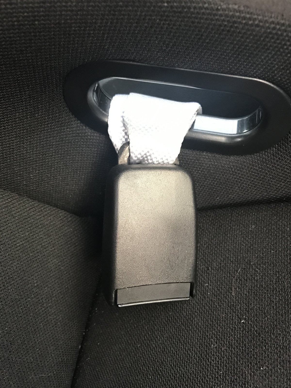

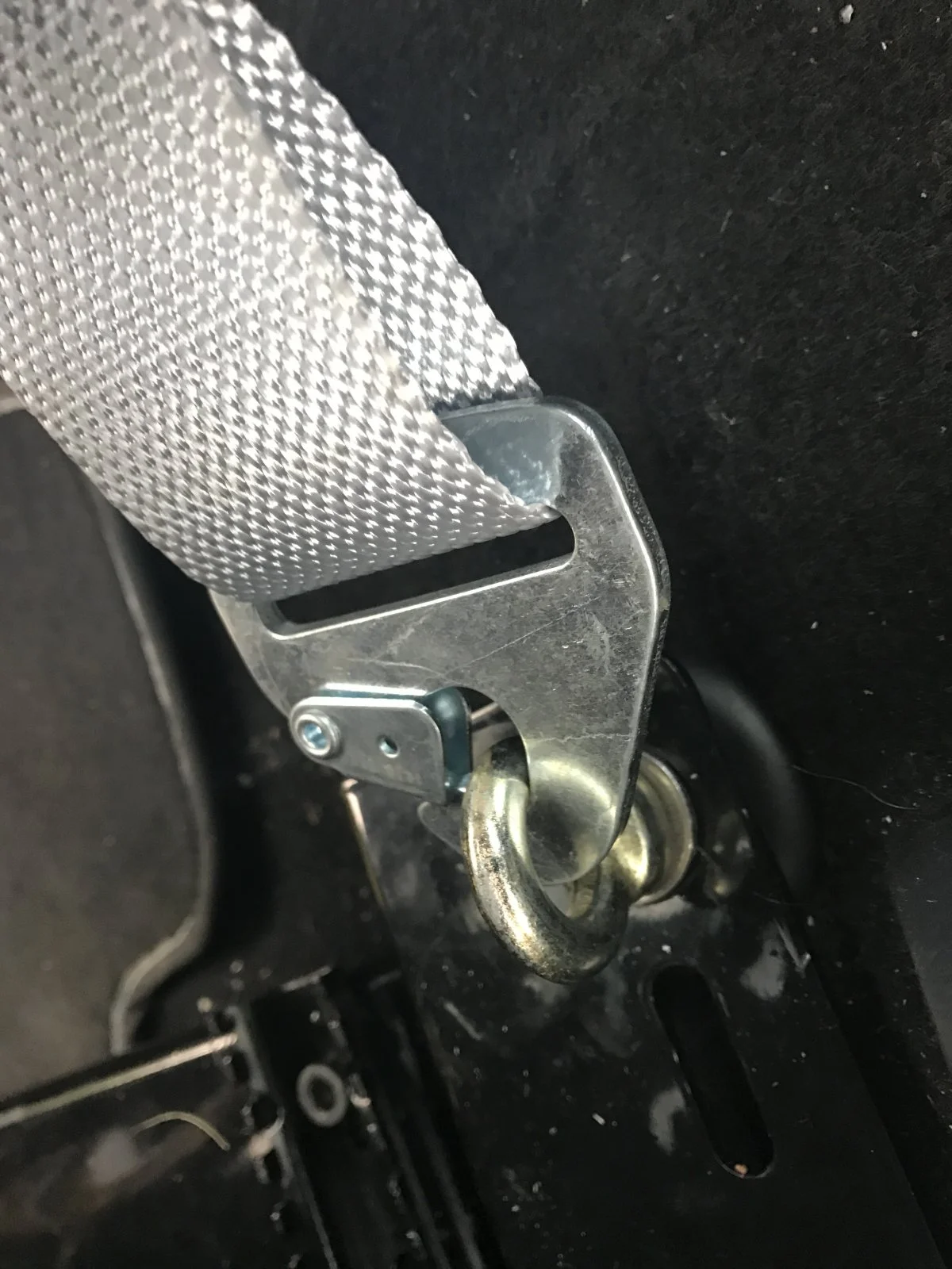

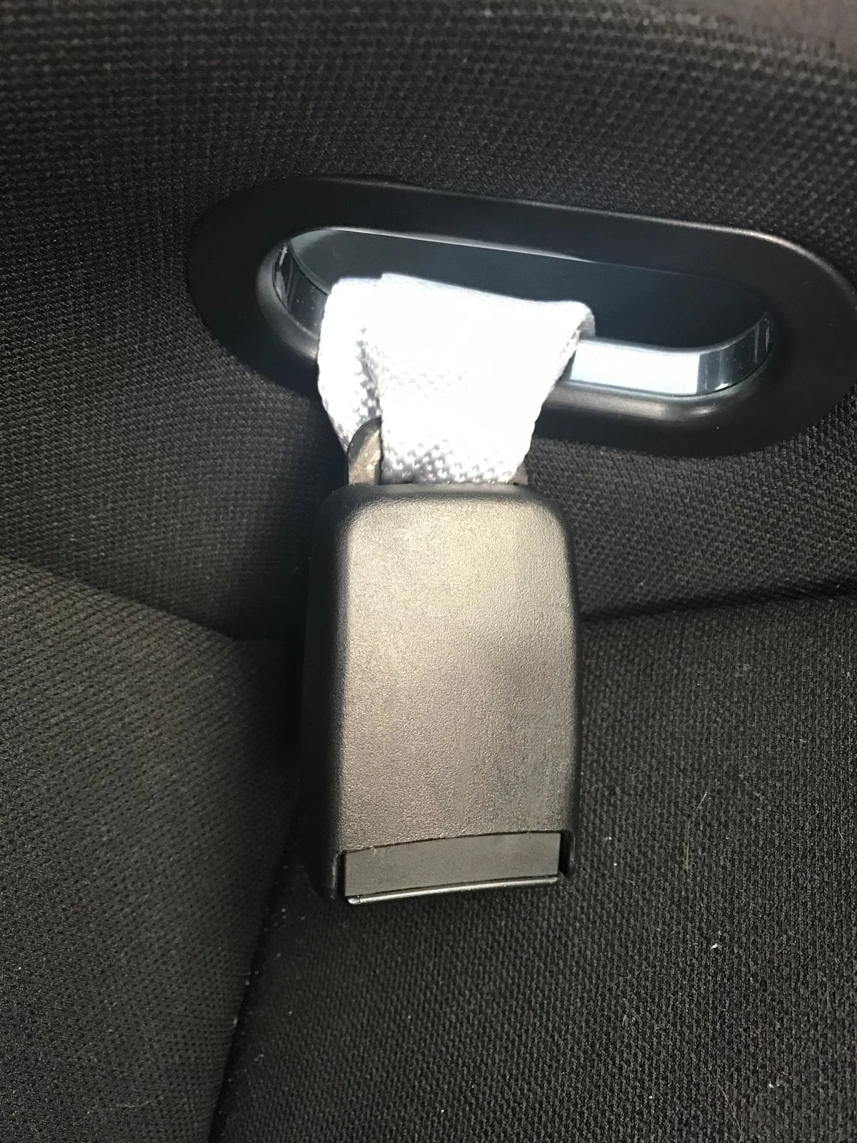

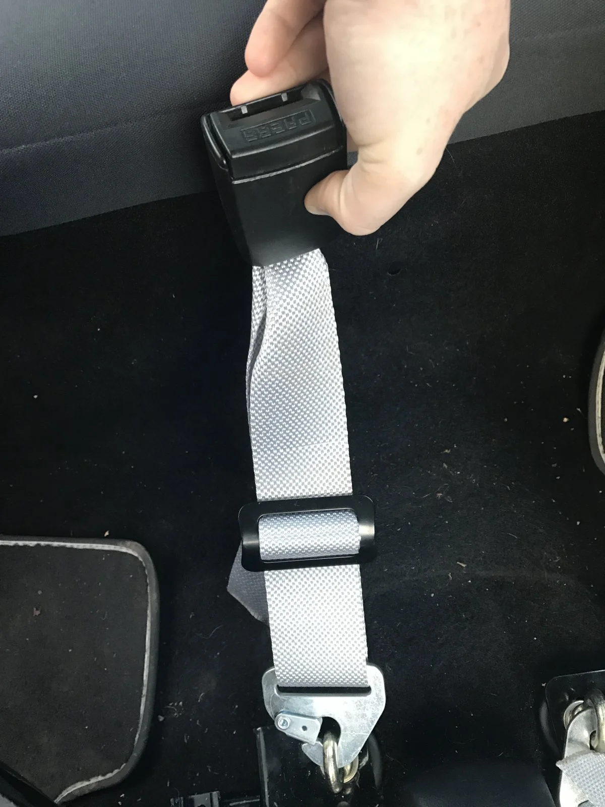

@LeeRS these are what I'm using from a guy on here. Works well with standard belts.
  172
Where di you buy these from as i would like to keep standard seat belts until i get harnesses
I got them from a guy on here, he made them up.
Think they are some form of peugeot rear belt and some harness material cut up. They do the job nicely
