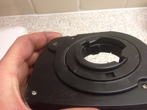

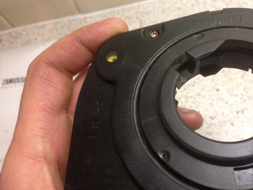

This is what it looks like.
Hmmmm thanks for your help mate.
I had to remove the front portion of that set up (it just unclips) because the boss was rubbing.
it fits perfectly without - dammit.
​ill take a picture when I get home

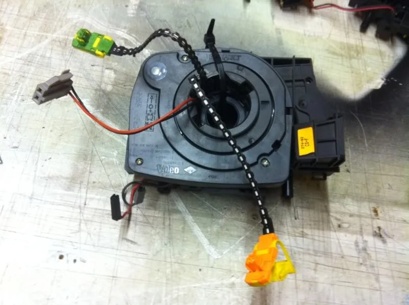

I uv taken the above part to pieces you will deffinatly need a new one!
