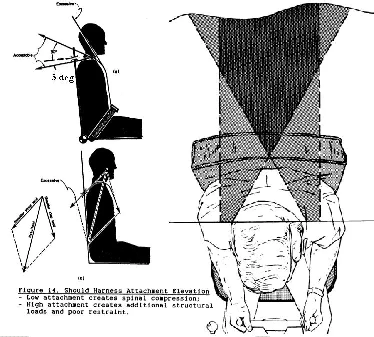

Thats not a safe sport when you have a front end crash though as it will cause you massive back problems as it will compress your spine.
This attached phoots shows why you need a proer cage and harness bar.

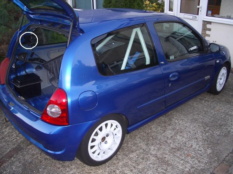

  My trusty lil 182 :)
Not fitted mine yet but assuming its the circled area where the rear sear belts are mounted behind the plastic trim:
ps borrowed image from another post - hope owner doesn't mind :)

your right the issue only exists when you use the lower holes when the belts ar upto -20 degreee as per the drawing your ok any more of a drop and unless you have the special seats then compression of the spine happens.
