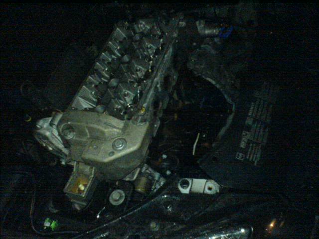

just lowered the engine and gearbox in, it fits (sort of!!)
the diff on the back of the ND0 is catching on the steering rack (but it clears the ABS!!) a job for the angle grinder!!
the sump is VERY close to the subframe, looks like i'll have to cut a section out and weld a plate back in so it clears
the top of the gearbox is very close to the chassis leg, but it already has a notch shaped into it from factory, a large hammer will sort this!
all i need to do is finish off my custom g/b mount and figure out the dogbone mount (plus i'm going to see what i can do with a 172 lower subframe mount)
driveshafts, gearlinkage, clutch mech conversion, loom, cooling system and few bits and bobs to go
who knows it might actually be finished this year!!!

Any idea on engine weight Fred?
What cooling setup are you using? Megan would be a bit big size wise and 172 is a bit to small isn't it?

172 rad works fine for the TT engine, although i might be using a beemer 5series rad (it has built in expansion tank)

Your going to have so get some seriouslt strong rubber in the engine mount.
PS I had an ide why not make a second dogbone mount and use this to hlep keep the engine movement down?

this should be a monster. iirc this is the non-vvt head from the vel satis?
what gearbox and you running fred?
  Lionel Richie
i'm using the Megane RS NDO 6speed gearbox (should be nice in the cliopatra)
non VVT head, but as we all know VVT does f**k all (well in my opinion anyway)
edde - this is an early test engine from Renault, it was run on the engine dyno in the factory in dieppe, the bearing shells are spanking new! you know me mate, i don't get into rolling road bullshit claims, all you need to know is it'll be quick, VERY quick!
yes.
Run 2 front lower supports, 1 upper gearbox and 1 solid rear along with a damper on the cylinder head, this leaves the O/S top mount optional.
