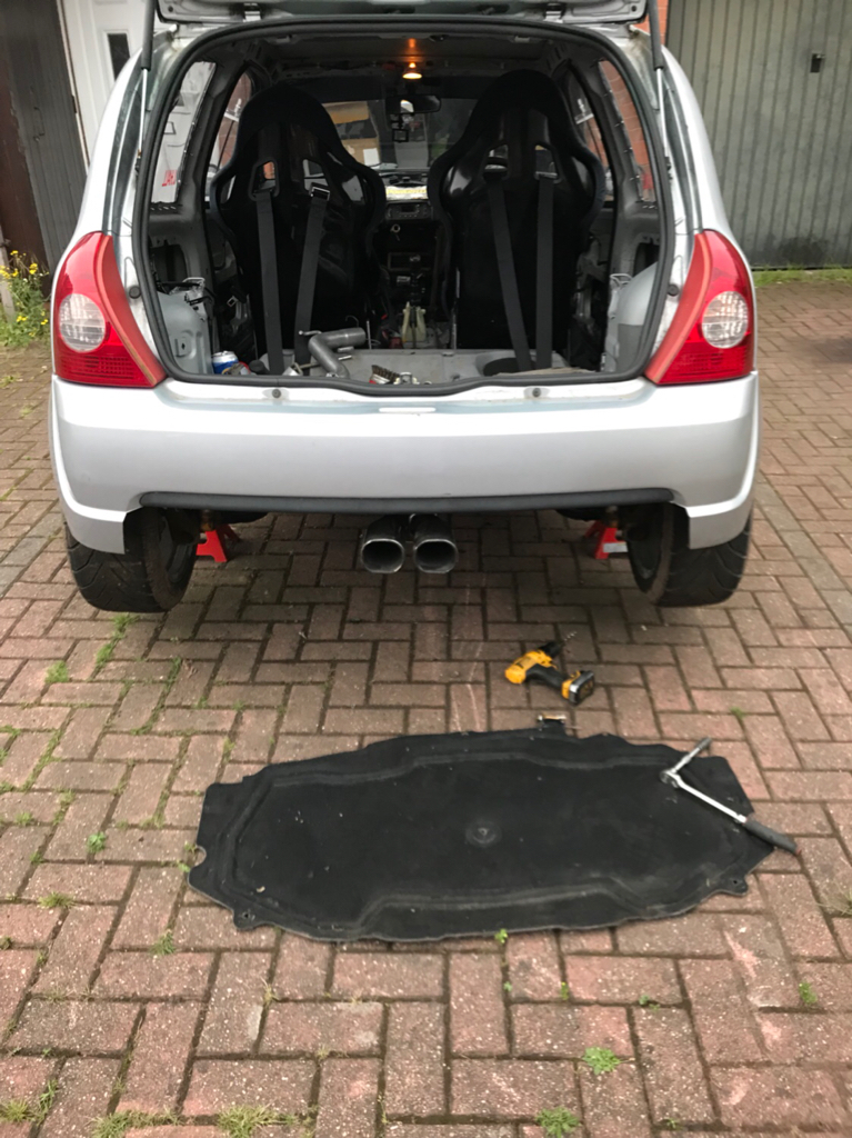

As title says my exhaust is to loud. I need to make it quieter for track days as I’m pretty sure I will get black flagged for it.
Car is a 172 ph2 running a decat 2.5” exhaust and power flow backbox. Reason I went with the power flow was because of its size and having it exiting through the centre I didn’t want something massive. I will also add the car does also have a mid silencer. What are my solutions as don’t really want to be changing my exhaust system as i have custom made it all.

No standard manifold, decat 2.5” exhaust with silencer and power flow backbox. I’m in 2 minds whether to cut the the rear silencer open and pack it out abit? I’m not sure to be honest just need it quieter!🤣
