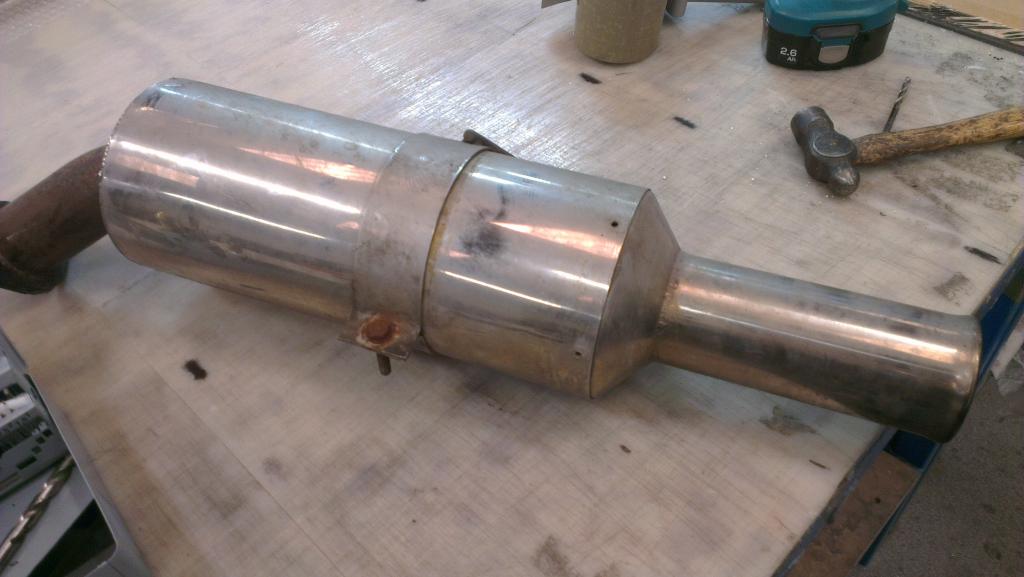

correct, the yozza race exhaust has the tip held in place by pop rivets. Simply drill them out, wrap this stuff around the centre baffle twice loosely and then rivet back up. When upto temp it expands and fills the area. This way it does not get over packed and reduce the efficiency. They have a calculator on the website to work out the cut length depending on bore and outside diameter :)

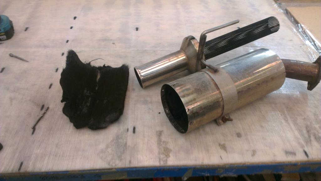

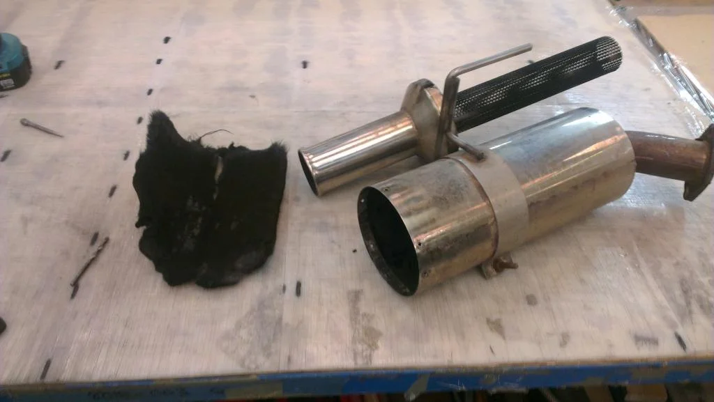

Once the pop rivets were drilled out I used a centre punch and hammer to knock the stream of the rivet out of the hole. The tail was then clamped in a vice which allowed me to knock the back box off. Took some doing as its a tight fit, and was full of dirt and grime caked on with the heat.

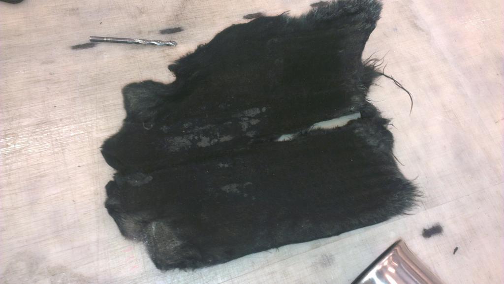

Once off... yeah... that's what was left of the packing lol.
I took some time to clean all of the parts down, this then meant I was in a rush before work closed for 11. Unfortunately I did not take any pics of the new packing in place. Left it idle for 10 min and then took it for a few spirited runs down the highway to get proper heat into the back box.
