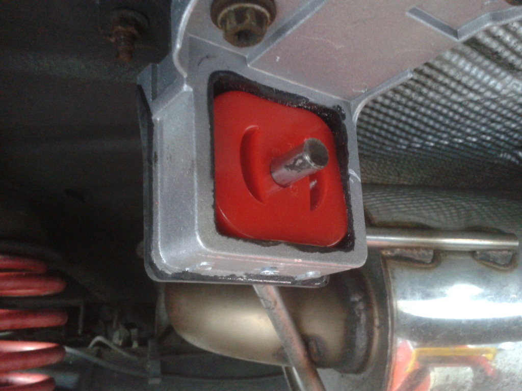

For anyone in the future wondering what I'm on about, these are not Powerflex but do the same job. Charlie at Prospeed fitted these for me and they're solid and certainly won't sag:

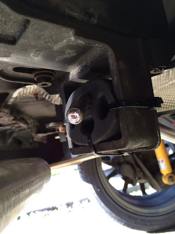

I bought 2 new mounts for £12 and two powerflex exh008 mounts for £12...
10 mins with a stanley knife and they are in, i drilled a hole top and bottom and put a 8x1 screw in to hold the mount in place.
No need for cable ties and looks spot on imo.
Whats that hanging out of the middle? Looks like that was your backbox hanger?

Yes, that is the idea. It is an exhaust mount after all.
Well given that the thread title is "exhaust mounts" and that Iam a mechanic I sort of gathered that but from the photo it looks like its broken away from the exhaust.
If you look to the extreme right of the picture (above the yellow shock on the photo) you can see the other side of the mount.
