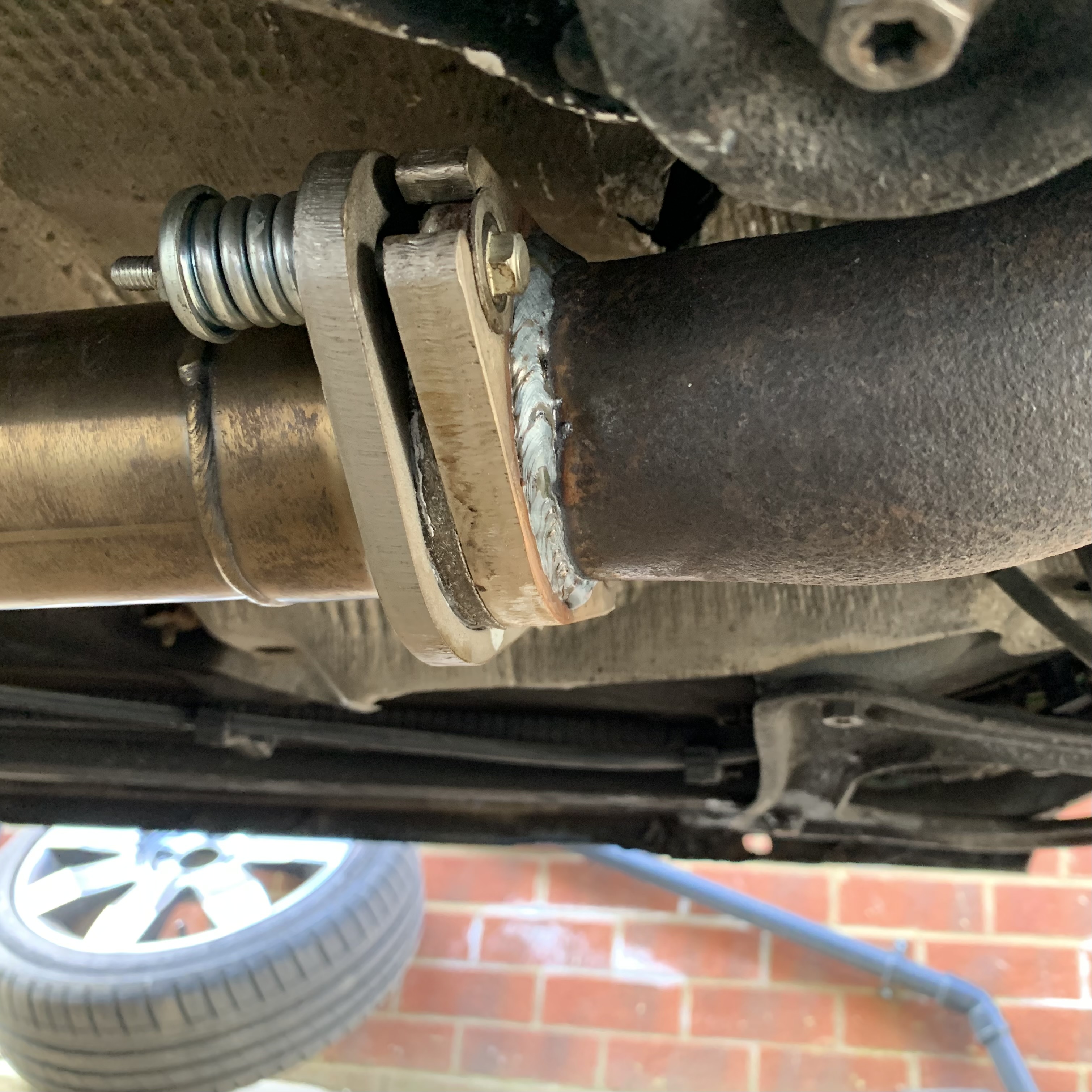

Would we say that 5 hours to fit this is normal?
1 of us a mechanic.
Nightmare!
Almost gave up

I don't think my mechanic even charged me extra labour when he replaced that on my 182 at the same time as another job. Can't be rocket science surely?

Aye it's a piece of piss on a 182
On a 172 it's a fuckin nightmare unless you're from Norwich and you have 3 hands and 18 fingers
Absolutely second this. I’ve got a 172 decat on mine to link to the downpipe and it’s an absolute c**t of a job. There are no human hands that are capable of holding everything in place and getting those little shitty nuts on.
The only way I had any success was sticking a f**k off threaded bar through one side and tightening it so I could get the other side done then swapping over. I’d love to say never again but no doubt the car will s**t itself again soon and it’ll need done again.

I ended up blutacing the spring to the anti squeal cup, blutacing the nut into the socket and having my mate contort himself in the engine bay and push on the bolt with all his strength so I could JUST compress the spring enough to get the nut started.

Until you've done it on a 172 you don't know what real pain is. I think in the end I started punching the underside of my car because every time I got it started I'd forgotten the washer or then the nut fucked off. I'm getting Vietnam flashbacks just thinking about it

Good to see it wasn't just me that found doing it on a 172, by myself, in the rain was a total PITA. And I'm sure it still catches the rear beam, despite lots of adjustment and pulling the engine forward.

If you'd seen the tears, swearing, tool abuse, grinding teeth and mashed knuckles you'd be more likely to take me toolbox away and stop me from ever working on cars ever again.

Looks like a cow of a job to do the front exhaust flange on 172. Ill dodge that one in the future :LOL:

Absolute doddle with the subframe off. Which is also a b*****d of a job in its own right 😂

I would say anyone saying it’s a 30 min or less job is referring to a 182. On a 172 it’s a s**tter.
