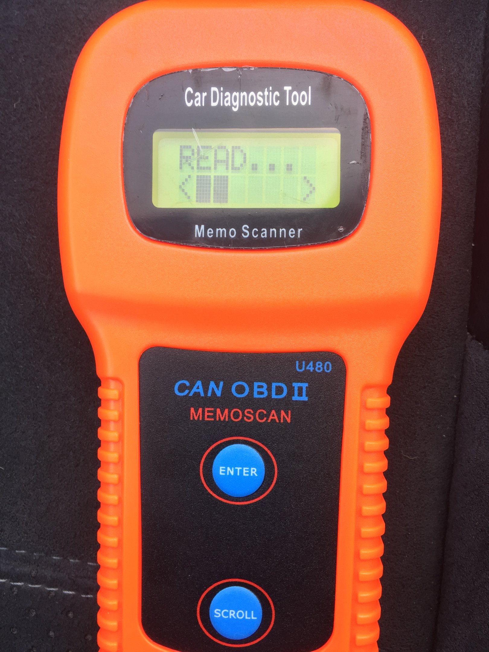

So U480 code reader arrived and straight on it. However following the instructions word for word.......
It connects fine, seems to initialise through the protocols and run a scan which comes up as No Codes Found even though EML light still orange and still on!
I have tried a rescan and it then comes up with ( see image ) and then just stays like this.
Looks like I need to get the codes read and cleared elsewhere using another reader, any ideas why it might be being such a pain?
