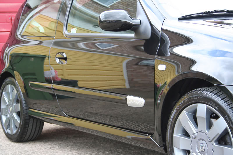

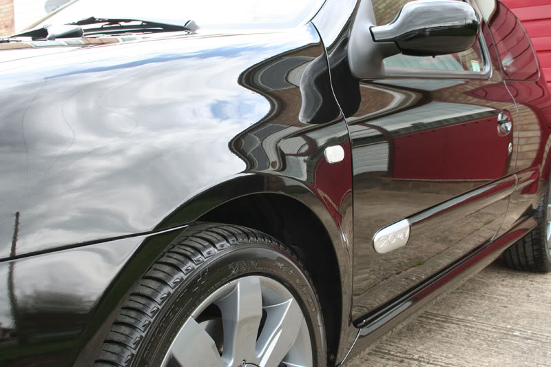

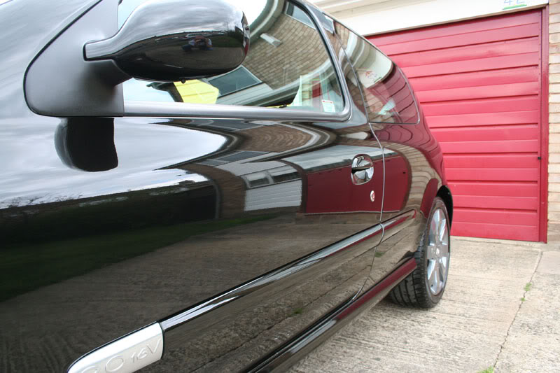

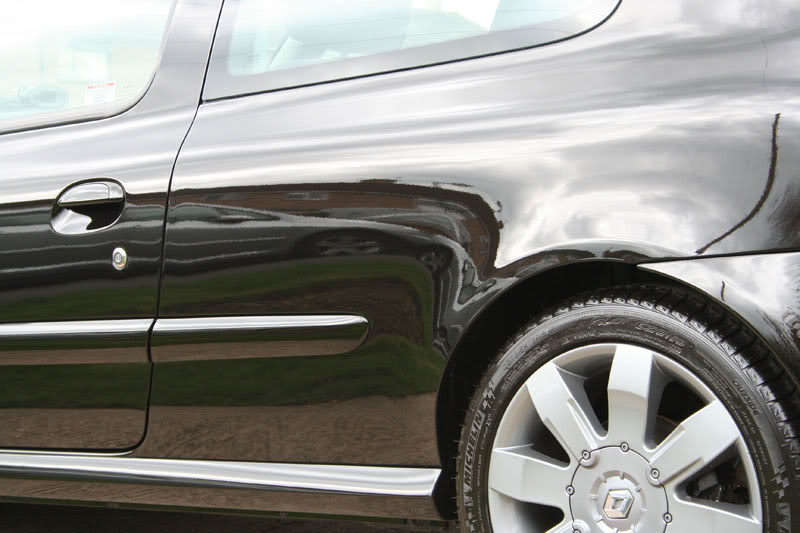

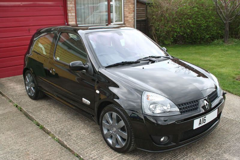

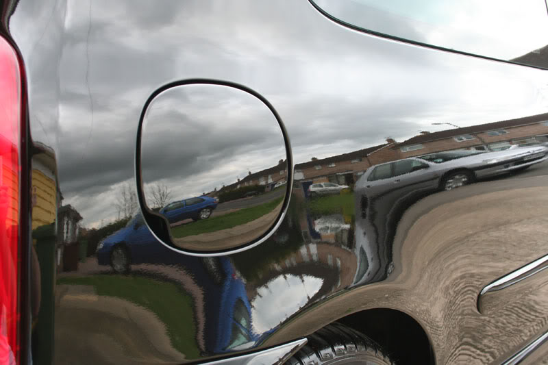

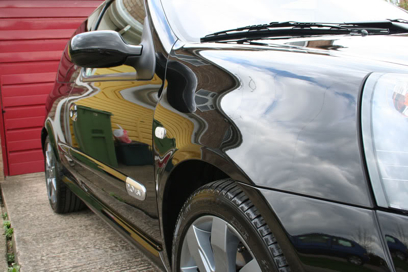

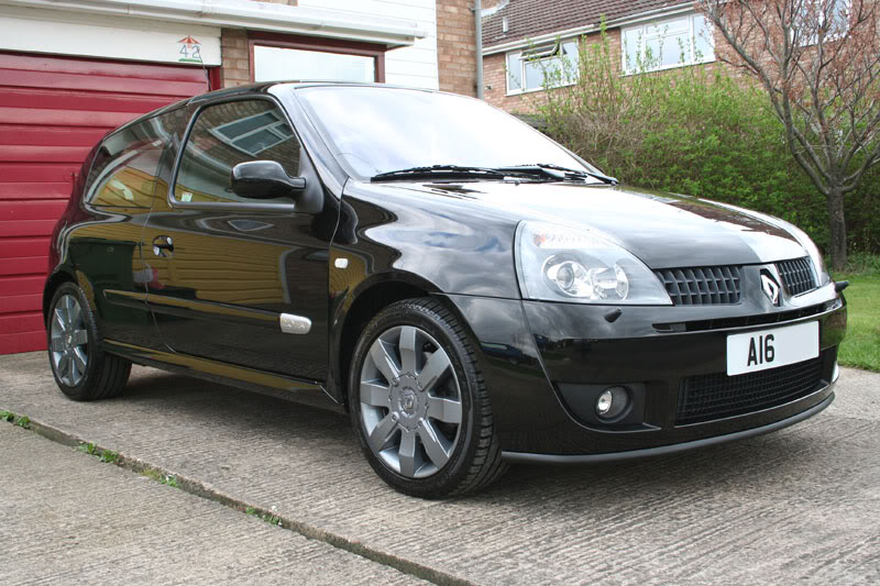

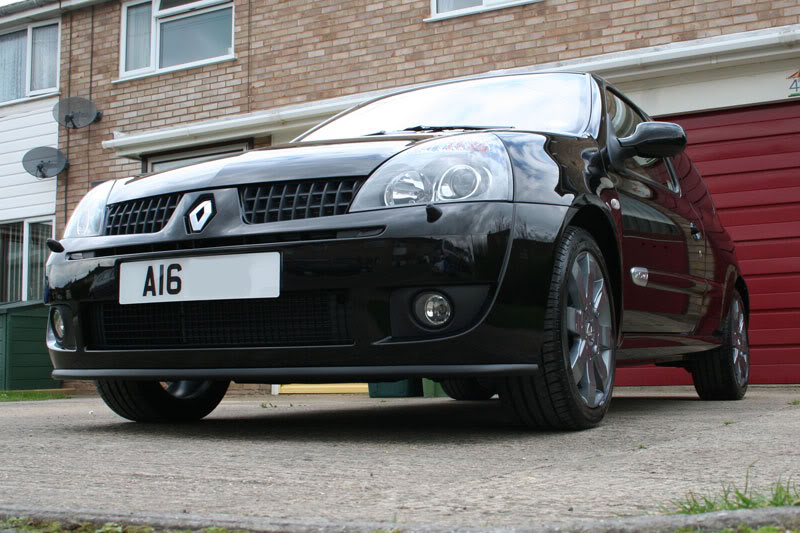

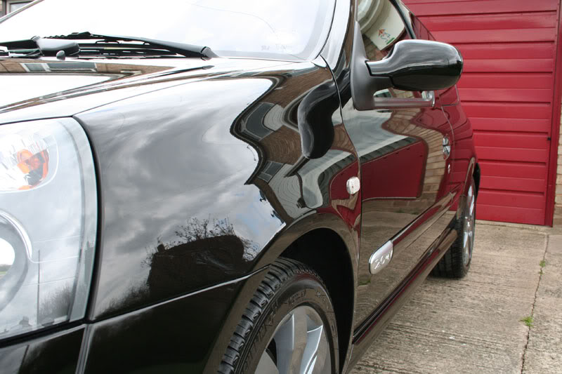

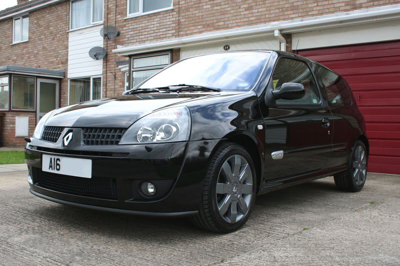

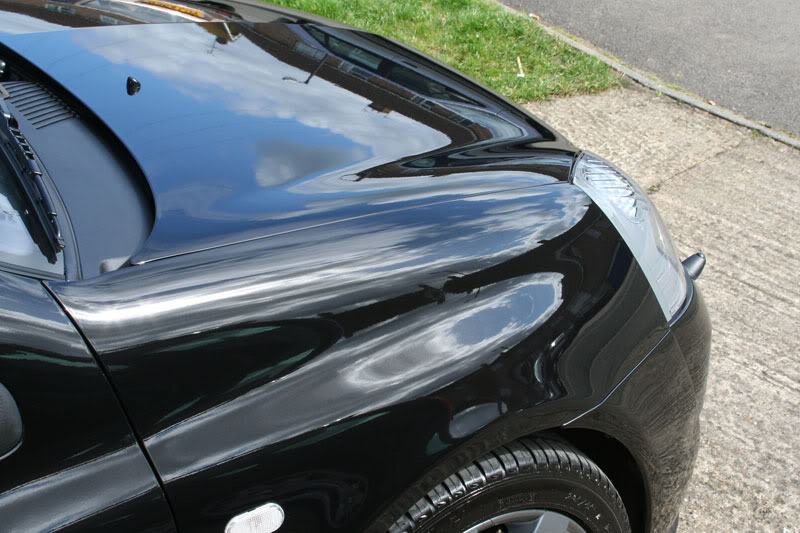

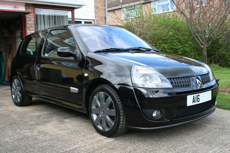

Took the Easter break as the chance to start to get the 182 ready for the up coming shows.
First time I have used any real cut to the paint since I brought it, but thought it was time to remove the swirls. Went a bit mad with the Glazes later on as it's my own car and wanted to get it looking as good as possible and had the time.
Swirl Removal - Poorboys SSR 2.5, Light Cut Pad by PC.
Polish - Meguiars Speed Glaze 80, Polishing Pad by PC
Final Polish/Glaze - Cleakote Vanilla Moose Hand Glaze - Polishing Pad by PC
Glaze - Clearkote Red Machine Glaze - Finisihing Pad By PC.
Glaze 2 - Clearkote Yellow Moose Wax - By Hand
Sealant - Wolfgange Deep Gloss Sealant.
Car is looking the best it ever has, taken a few hours and not quite finished yet, will add another layer or two of sealant (one in the morning hopefully)and top with wax after the next wash.
The first aggressive polish has cleaned up the paint really well hoping this is all it will need this year.
Some Pics
Swirl Free and some Ugly git!
  Monaco Blue Mk2

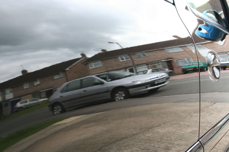

Well that looks like a mirror! lol

The mirror look is the plan, hopefully it will look beteter still with another few sealant layers and a topped with a good quality wax.

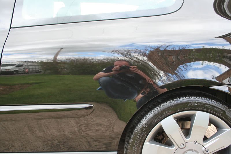

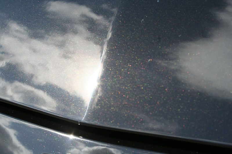

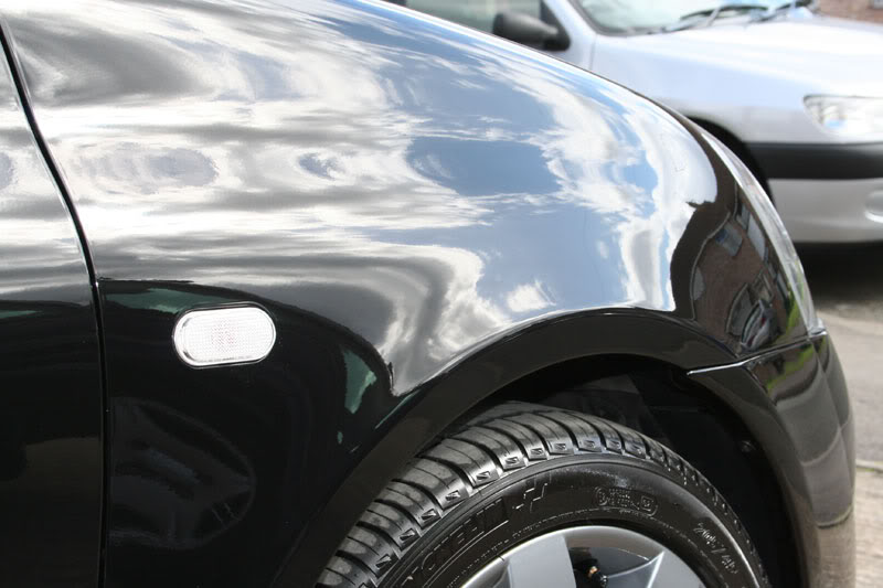

Looks great rich, the reflection off the black gold paint is wicked, almost looks like chrome is this pic of the side stripe
I spent some time doing mine yesterday not in your league tho...lol.
It will look even better in the sun today :)
  106 GTi
Cheers Dan. Paint does some odd stuff.
