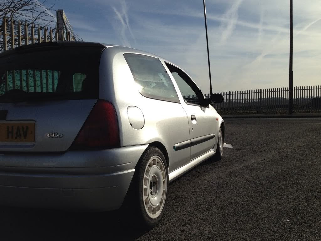

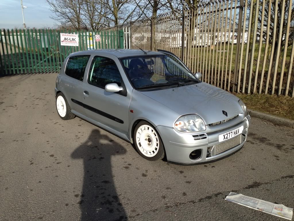

Right gave the car it's first clean since before Xmas and before the turbo build started..
Ill be the first to admit the condition isn't amazing but god it's quick ;) and looks okay for a track car.

Doesn't look particuarly pretty but looks VERY purposeful and is so much better for it.
Love it mate, only thing I will say is the offset of the fron wheels looks pretty terrible, can forgive it as it's boosted though :)

The reason the front wheels look s**t mate is I had 25mm eibach spacers which were perfect but 2 of the bolts snapped on me so had to remove will be back good soon..
Oh and I'm not too fussed about condition as its getting wrapped in next few month :)

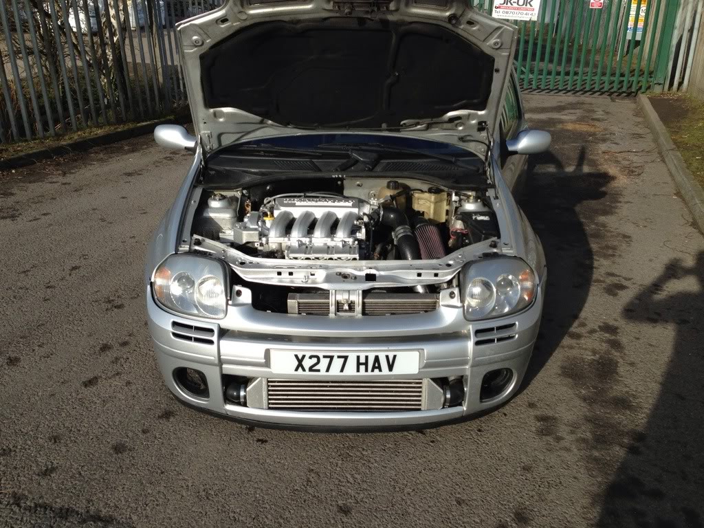

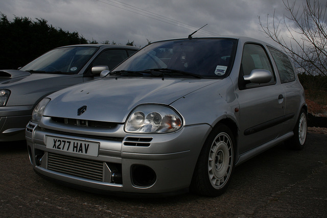

Looks great. I think you should have the intercooler sprayed black so it's more stealth looking.
  Audi A5
Intercooler sprayed black and some sort of grill to protect/hind it abit, like the one burpspeed use maybe.
Back on black f1's
spacers and it will look the nuts then!

Cheers for comments
Spacers going back on tommorow along with either black OZ's or spray the turbines black

WInrar, i considered removing my front lower grille to show the intercooler but decided against it, but seeing that now makes me change my mind!!
  PH1 loads of boost!
Looks good. My only critisism is the intercooler, looks a bit OTT. I prefer summit a bit more subtle. That's why I kept the slats in place on mine.
Spec?

I couldn't keep the slats wouldn't possibly fit way too big..

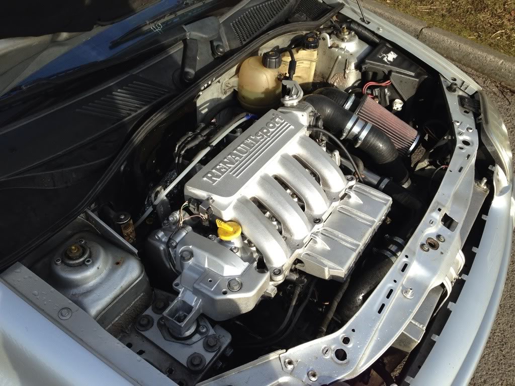

Engine:
Gt28 turbo,low boost setup at 7 psi running 242bhp mapped on omex 600
2.25" downpipe
Uprated mounts
Omp inox decatted system
Suspension:
Fk konigsports
25mm spacers front 15 rear
Brakes:
Brembo hc disks
Ds3000 pads
Braided lines

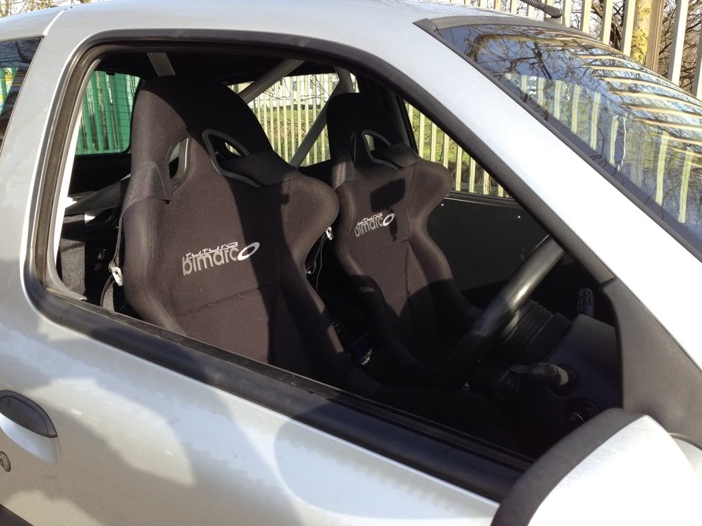

Striped with rear cage 2 bimarco futura buckets. 4 point harnesses and battery located in rear..
I know what your saying about the cooler I'm wondering if I could somehow have it painted Matt black to disguise it abit although its going to be my complete track car soon

Looks sweet. Kind of spec I'd like.
But as a road car think the cooler would need re thinking but track car no worries looks great.
