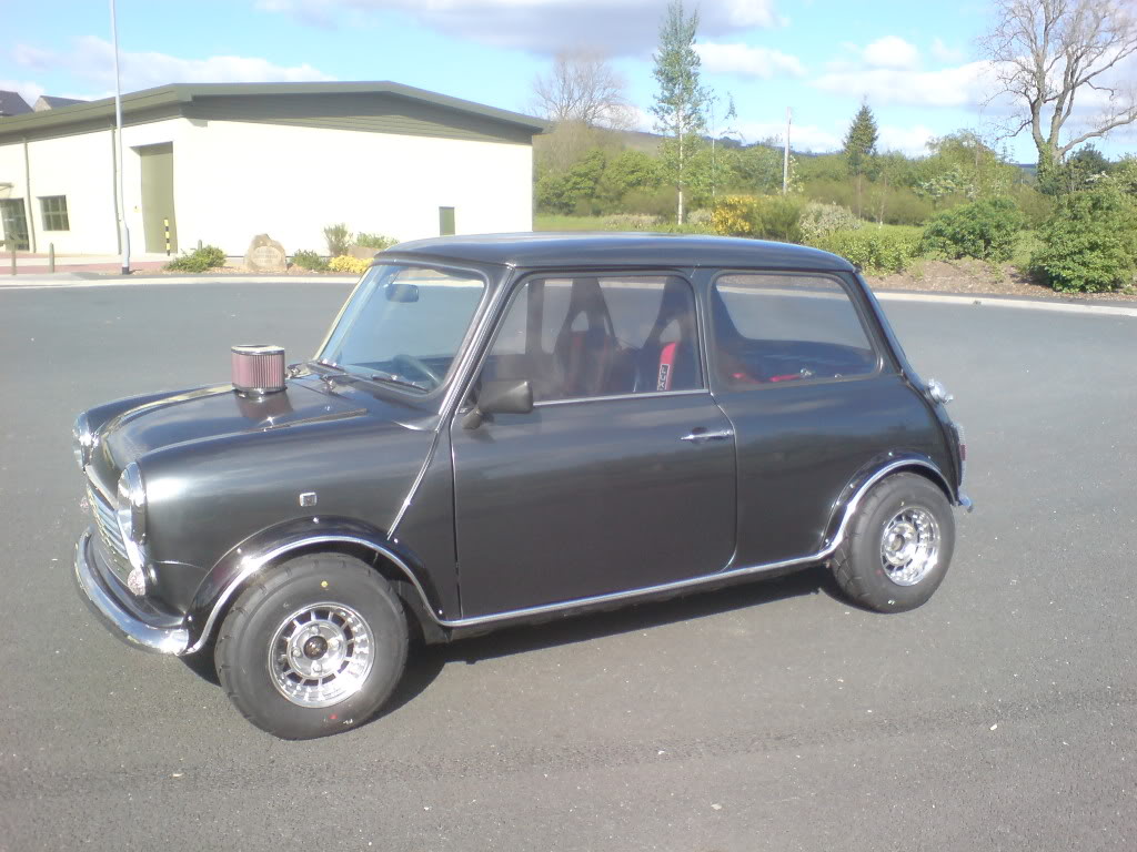

I remember mine well when going to install the pipe at the end of the build and realising it had to be the first component fitted into the box due to the new route of the pipe as opposed to the standard one which came in and out with ease ha ha!
You still run them today in 2011, My mini would not make it round the 1st corner with out one. O and its much quicker than my 172 to.
