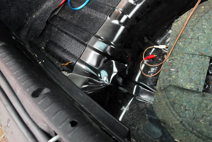

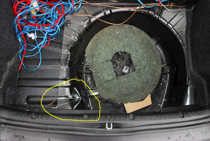

A couple of months ago, my dad took my car out to go into town (Doesn't normall drive mine but is covered 3rd party on it). While in town a woman decided to ram it up the arse. He got out the car, she accepted it was her fault, gave her details and left. My car was totally drivable, looked like there was hardly any damage, just a slight cracked bumper and big scratch. Eventually after a load of hassle through lawyers she has now accepted liability and direct line came and had a look at it to see what needed doing... It was booked into the garage today, but before taking it in I though i'd take out my false floor, amp and sub so they had full access to the boot and so they couldn't damage it. I found a lovely surprise in my boot!...

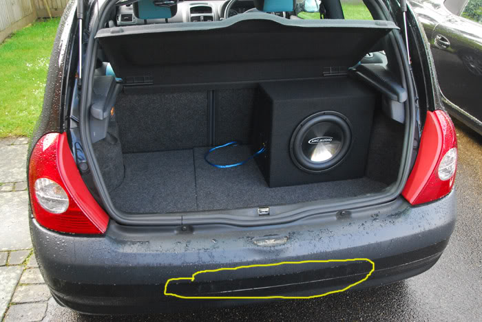

As you can see, hardly any external damage (insurance company said it needed a new rear bumper):

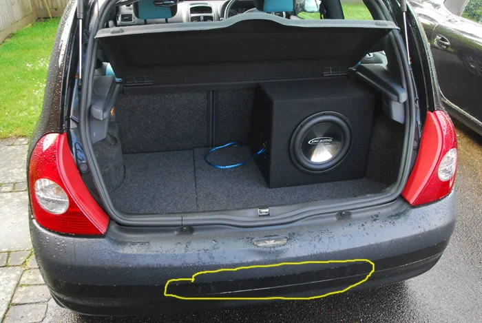

Lovely surprise!:

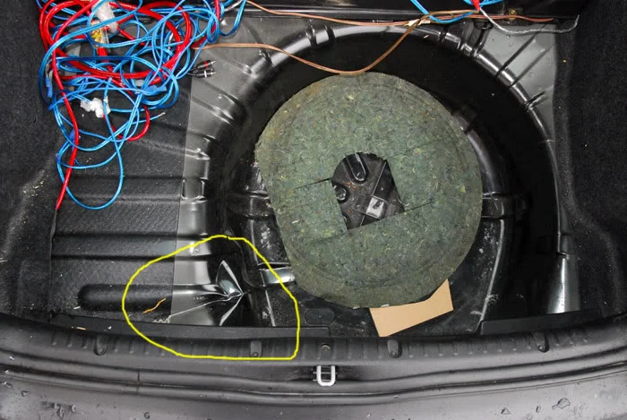

Again:

Yeah, well the insurance lads said that it needed a new rear bumper, and there was some damage to the rear sill too?

Thats nowhere near a write off..................cars are designed to crumple up absorb energy.
At most rear bumper, rear panel............do not attempt to change floor get a bodyshop (good one) to sort out crease.
Must of been a good wack????????????????
Get the assesor back out!!!!!!!!!!!!!!!!!
When mine was rear ended it was a lot worse than that, they will just replace the boot floor and what ever else is damaged... no where near a write off.

exactly the same as mine mate.....women who sold it said it hadnt been involved in an accident, no visible damage at all......probs my own fault for not noticing when i bought it but has an identical crease to that, if a slightly bit better.....also crumpled the rear bumper plastics and those flappy things that let the air out; resulted in about a litre and a half of water in the spare wheel well.....anyway, bit of hammer action, bit of duct tape and no probs since. False floor is fine as is the system and havent had any problems since...
make sure you whip the inner plastic liners out the boot though and have a peek.
