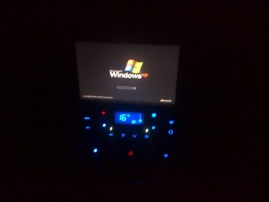

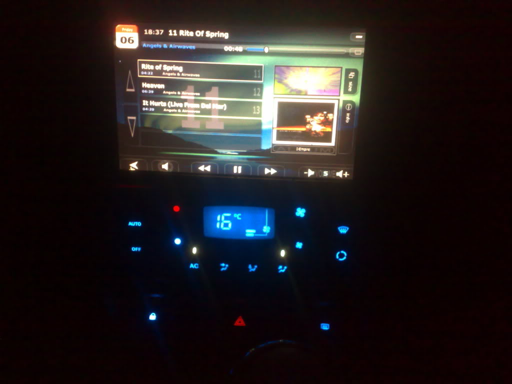

Now the dash was fitted back in... turned on and working sweet... i know the switch pannel hasnt been fitted, or the a-pillars... but this is down to these being in the process of being wrapped to match...

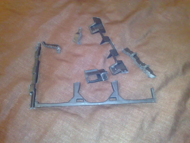

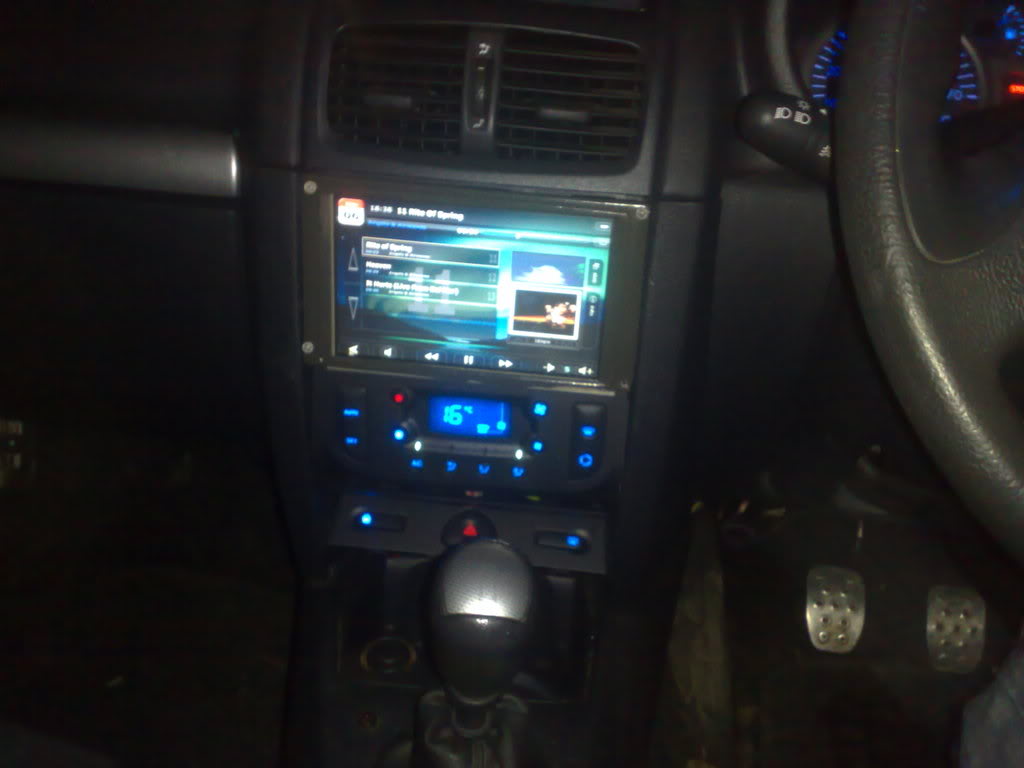

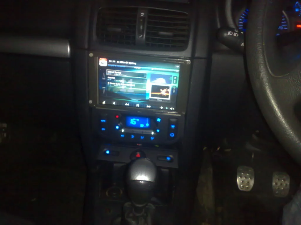

I did similar on mine when I had a PC in the car.
I didn't get rid of the vents though and put it in place of the hazard switch. There was less cutting to do!
Ignore the screws they were only temporary!!
And this is all that had to be removed for it to go there :)
