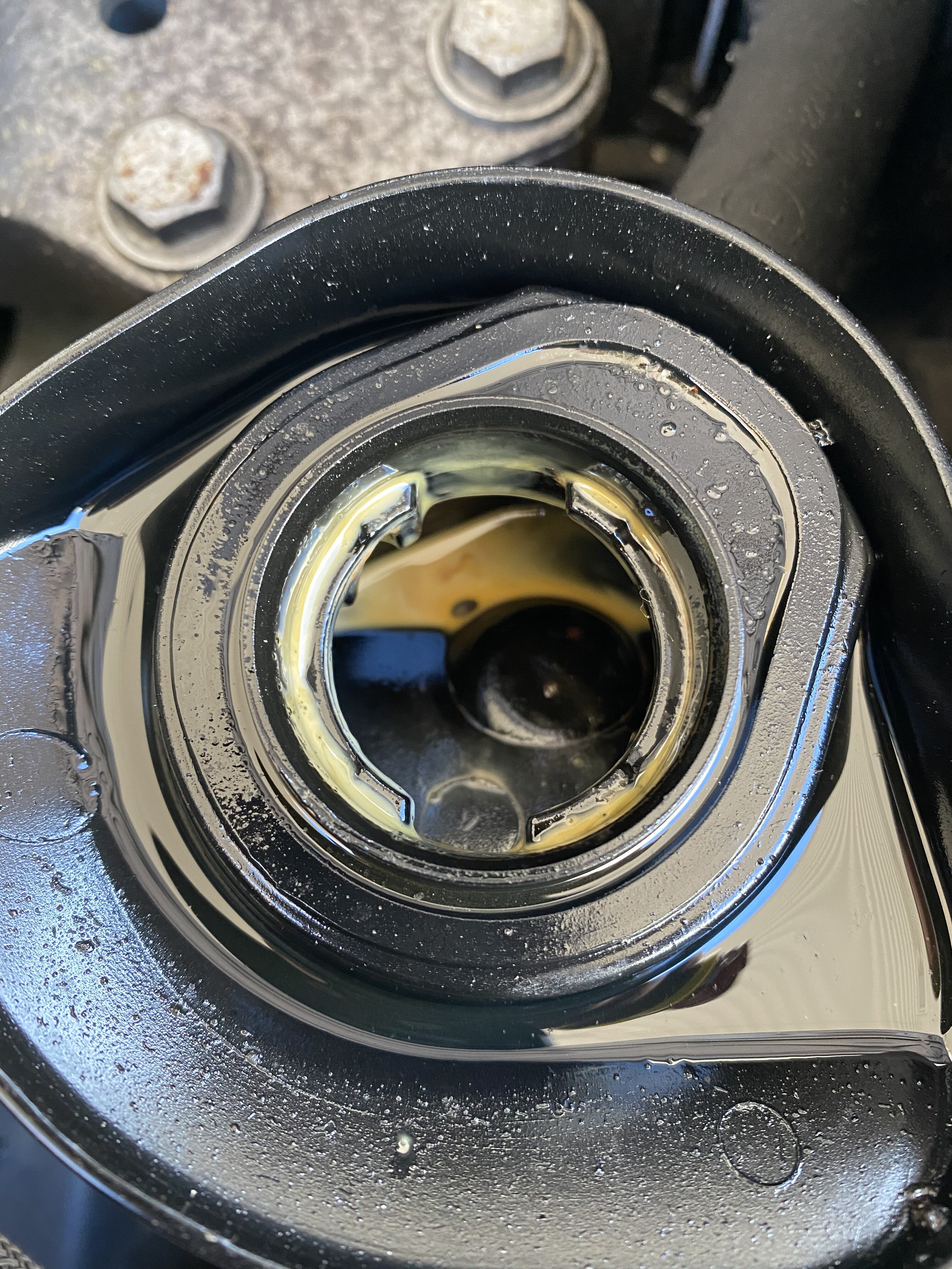

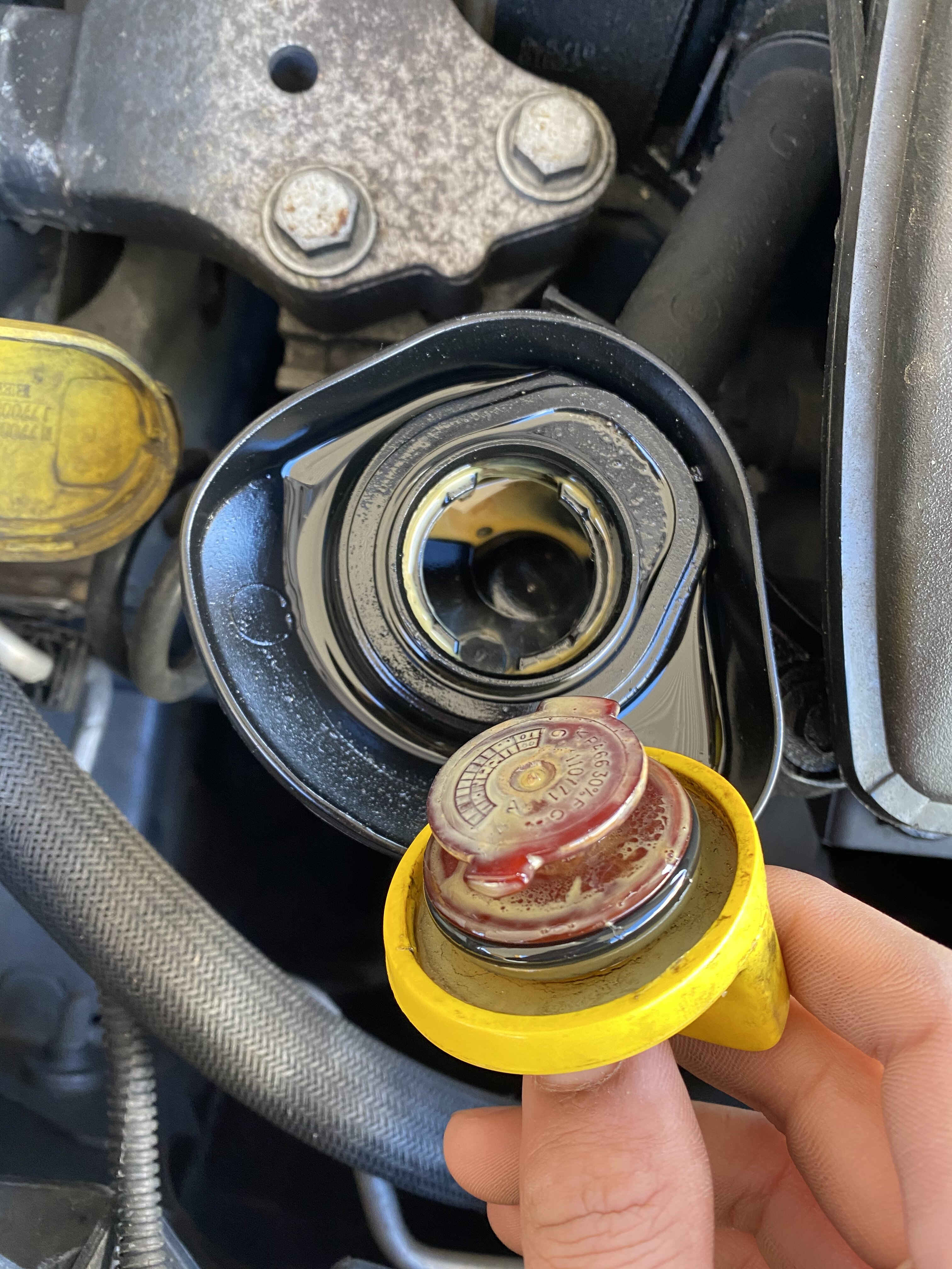

Done about 94k miles and i went to do an oil top up and theres a lot of creamy substance..?

Have you been doing a lot of short journeys? This is common and often just condensation.
If theres nothing in your coolant/on your dipstick theres nothing wrong.
Dicky Belly 3
Short drives usually lead to this as over time you're building up a lot of condensation in the oil.
The engine has to get up to temp and sustain that temp for a healthy duration before burning off any water that's in the oil.

I forgot to state, I do a lot of long journeys, the car burns a lot of oil im having to top up but no physical leaks on floor.. I noticed on the air filter theres oil as well !

Done about 94k miles and i went to do an oil top up and theres a lot of creamy substance..?View attachment 1514944View attachment 1514945

Even doing long journeys they will usually still mayo up, they need to get proper hot regularly to clear it.
1 litre per 300 miles means something is fucked, get it on a ramp and look for a leak first, but i suspect you would know it was leaking by now if it was leaking that amount, sounds like its burning it! how many miles has it done?

btw, the answer to your question in full is that your car is done. If the car isn't badly leaking oil then it IS burning oil. Whats the service history like? Do you have any record of it being serviced at all in the last 100k.

Its the sort of question that helps people to assess your question better, lack of servicing would point to a number of issues which could result in high oil consumption. Id do as Yorkshire pudding suggested above and ask the garage to check the breather before asking them to scrap the car.
