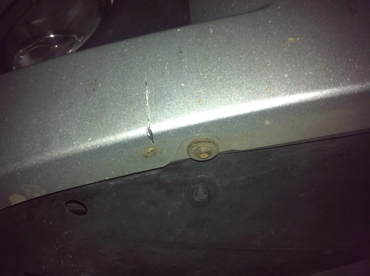

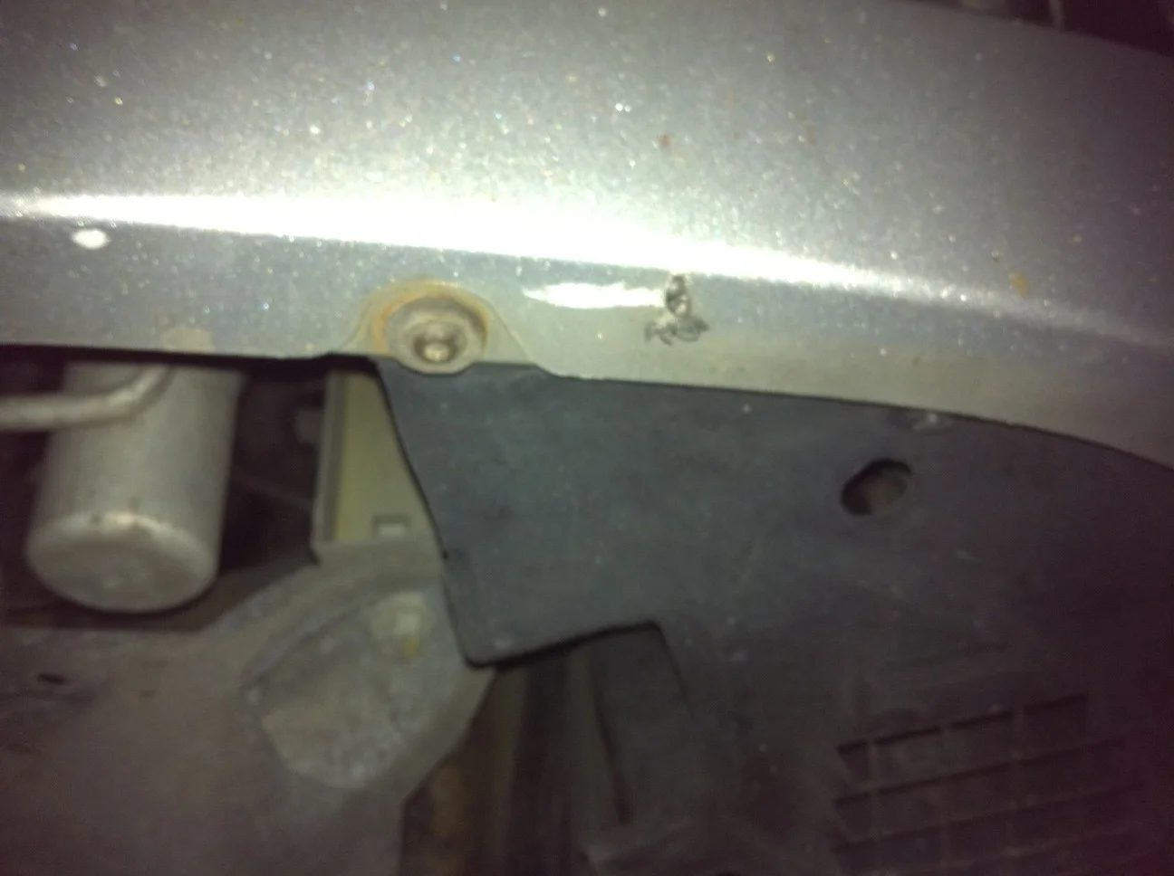

These are the only TWO holes under the front bumper that look like they might have held something on. Had a splitter on before maybe?
  clio 182

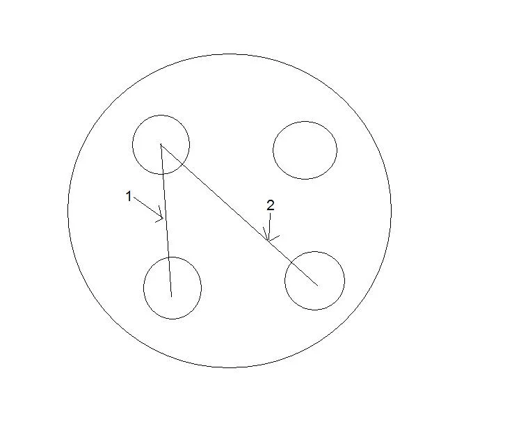

The hubs will physically look the same, but the bolt spacings will differ. You need to measure those to be 100% certain.
  V70 d5 beast
not the wheel hub bolts.. the bolts that hold your susspension shocker in place you can't miss them :)
Da
  Less
Yeah the strut - hub mounting bolts. Measure top to top, 60mm means cup pack, 54mm means no cup pack.
