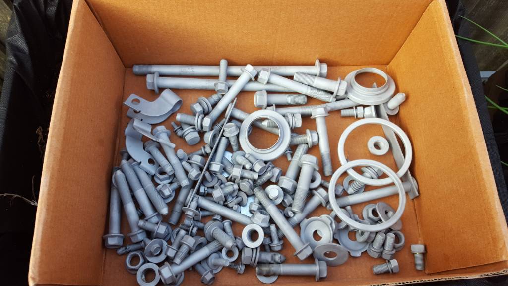

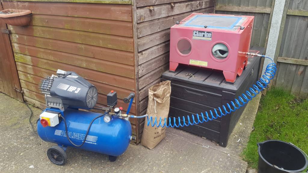

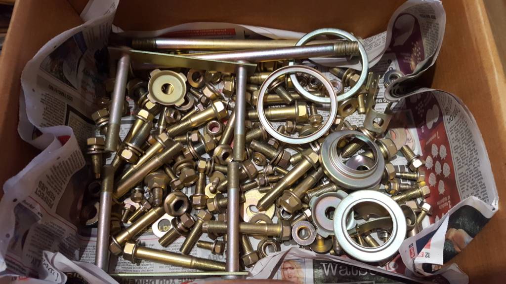

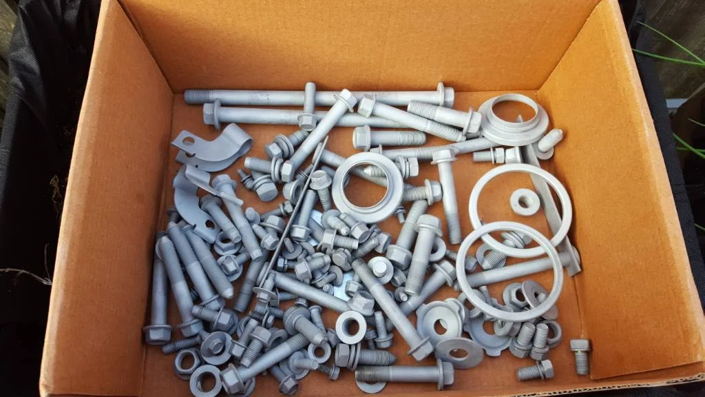

This is what I have but the compressor is far to small to keep up, I've only been blasting small parts and mainly nuts and bolts before they go off to be plated.

As others have said, buy the biggest compressor you can as a blasting cabinet will use alot of air. You'll also need high air pressure to blast the stuff effectively.
This is what I have but the compressor is far to small to keep up, I've only been blasting small parts and mainly nuts and bolts before they go off to be plated. View attachment 1347199 View attachment 1347200 View attachment 1347201
How long can you run with that Compressor? Is it 50l or something? Looks like you've still managed to get a decent finish from it
